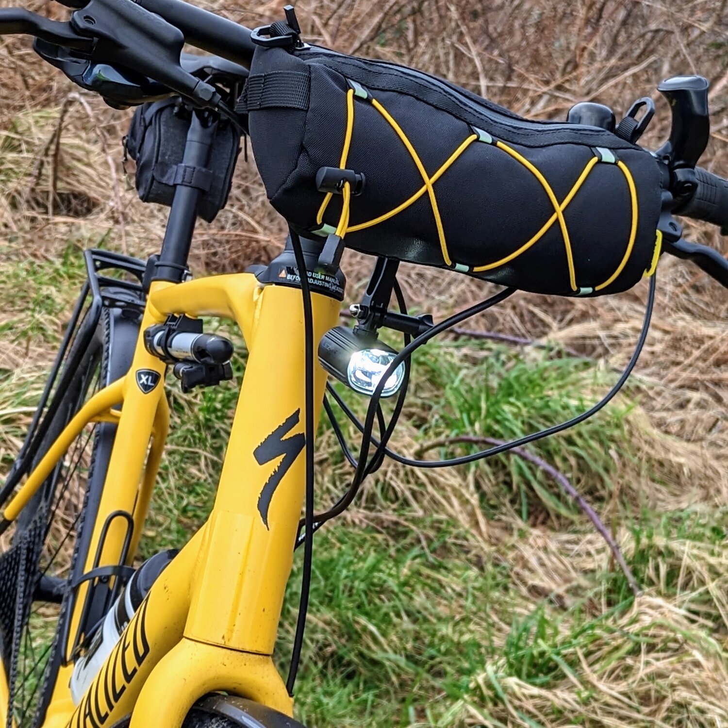

I'm a bit late to the conversation here I'm afraid ... I've just got the bag shown in the photo from Amazon (UK) where it sells for about £20. There are broadly similar bags for about £14 if you look around; although the size is the same (2.4 litres - enough for a phone and lightweight jacket and a chocolate bar or two) they don't appear to be quite as well finished. The bag straps onto the handlebars (velcro and pretty secure) with an additional strap around the light bracket and cabling. The latter strap isn't tight and carries no weight. The zip claims to be waterproof but I have yet to test it.
As you can see, the light is clear of the bag and not obscured.
Hope this might be of some help :)

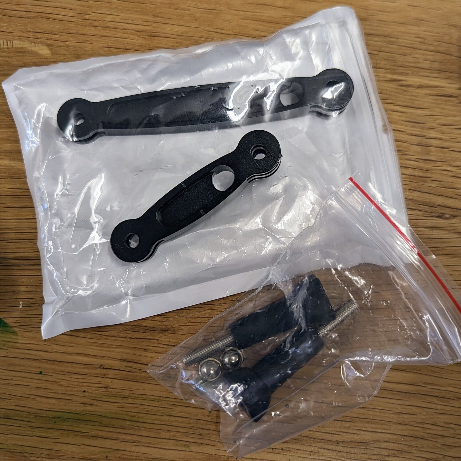

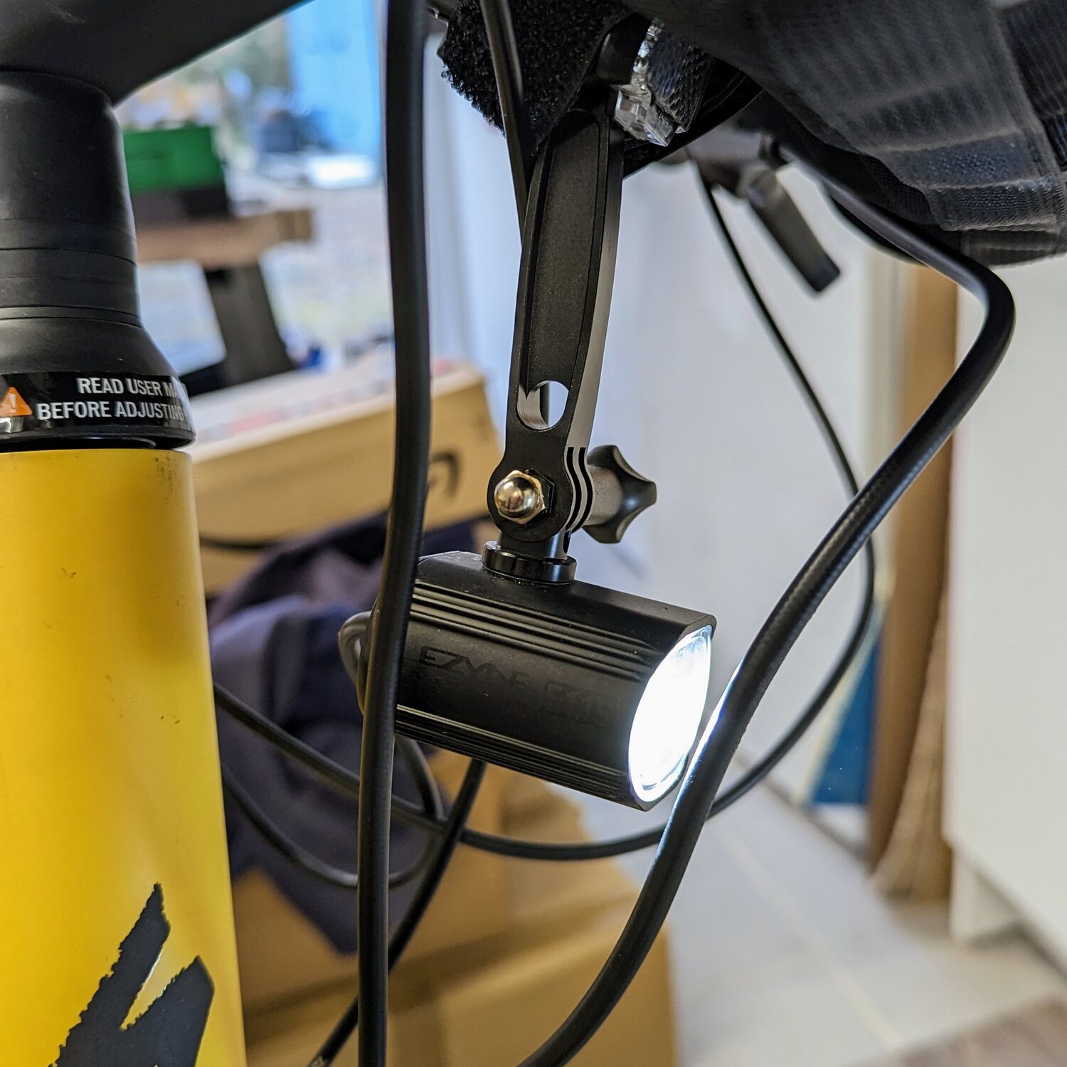

A quick follow up on this bag which I remain pleased with. I've started carrying a small pair of binoculars for birdwatching or a little Sony camera, both of which make the bag sag down a bit and obscure the light, so contradicting my statement above. A bit of searching and boosting of Amazon's profits and I sourced some GoPro extension brackets in 6, 8 and 10 cm lengths. These allow the light to be dropped out of the way of the bag and hold the light securely enough. It's worth putting some threadlocker onto the screws/bolts to hold everything tight.

What a brilliant idea!

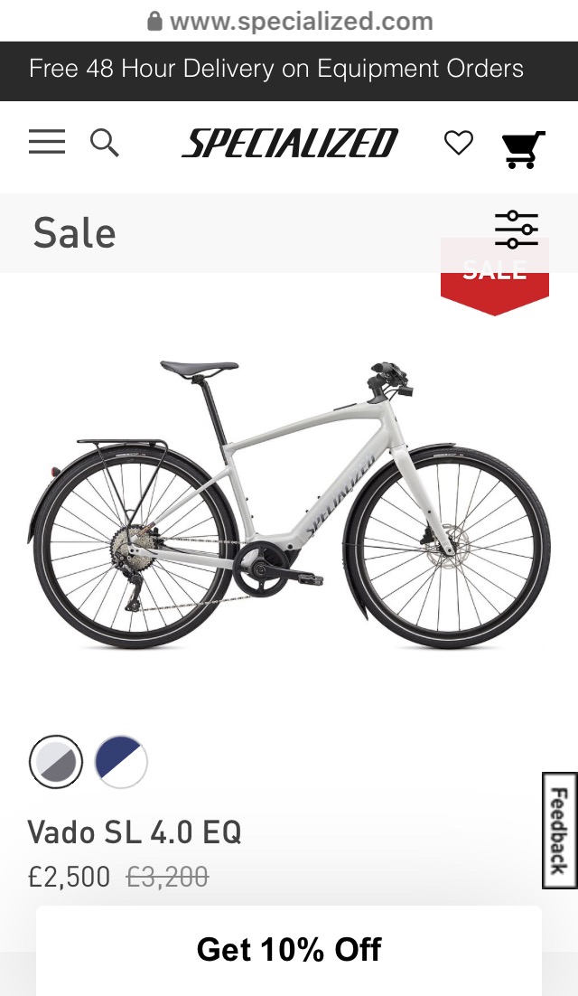

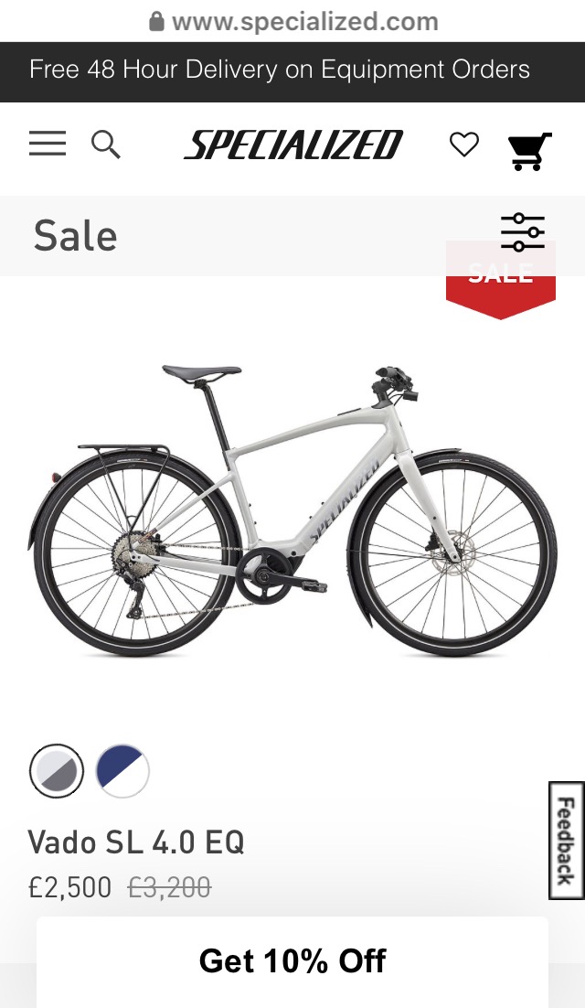

Afraid so. Prices are plummeting at the moment. Both new and second hand. Specialized UK has the Vado SL 4 at £2,500 plus 10% off. A month ago it was £3200. Even bigger drops on Creos. I've seen Vado Sl's go on ebay for £1500.Though most still go for over £2000. Over stock and low sales post the pandemic I guess. A number of shops and small bike brands have been closing down too. In the bigger picture I wonder if this a temporary fire sale or a readjustment back to pre Pandemic prices? I got my SL 4 for £2500 in October 20 and it jumped to £2800 then over £3000 in the next 6 months.
Just realised that price is for an EQ Vado SL 4 - mine was that price for the non EQ version! so an even bigger drop.
