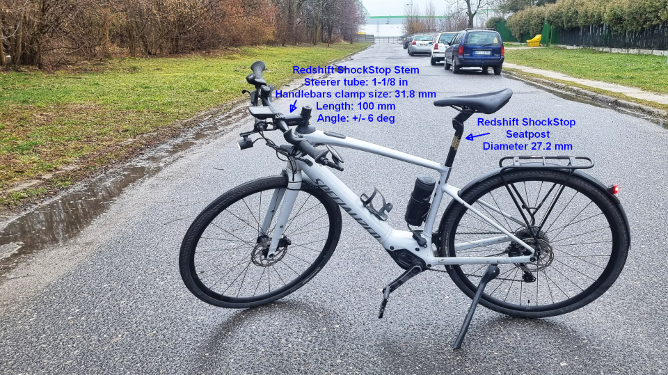

Pardon me? Are we talking about the stem or seat-post? Because the handlebars clamp size for ShockStop stem is 31.8 mm for the handlebars size used with Vado SL. 1-1/8"(28.6 mm) is the proper standard size for the steering tube (A-HEAD standard). Perhaps you are confusing these two diameters?
Because the only differences are:
  • Road bike needs a 25.4 -> 31.8 mm shim for the handlebars clamp.
  • Advanced modern MTB come with 35 mm handlebar clamp diameter.
(27.2 and 30.9 mm are diameters of the seat-post).
Before the inflation (June 2021), Specialized Warsaw claimed the cost of the carbon fork with FutureShock 1.5 as some 700 €. Bear in mind Vado SL 5.0 has also more expensive drivetrain and brakes.

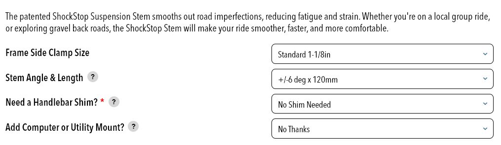

So I only need the standard version of the stem (1-1/8")?
1679038830953-png.149441
That would work for you. I was advised by Redshift to take the long 120 mm stem as it had the maximum suspension action. The choice of the stem length is of course yours. I actually chose the 100 mm one as it made me sure I would have enough of cable slack. (I know Vado SL has a lot of cable slack but I was really unsure at the time of the purchase).

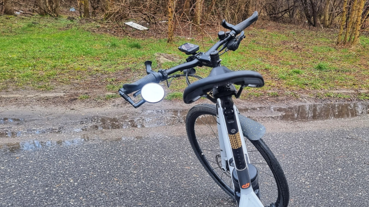

Oh no! It affects the riding position very much! Let me tell you my own experience.
I'm 173 cm tall but have short legs with my own "standover height" of 78 cm, and I have relatively long arms. I had to buy Vado SL size M for the top tube standover height but always felt my Vado to be too small otherwise. Initially, I had to ride in a really upright position, which was making headwind slow me down dramatically. Moreover, the most of my body weight was resting on the saddle, making my butt hurt.
I chose the 100 mm RS ShockStop (which is 2 cm longer than the stock stem), and that improved my riding position (now, I regret I didn't choose the 120 mm stem...) I felt better on my rides in a more sporty position, so I started experimenting...
  • Moved the handlebars as low as possible with existing steerer tube and spacers...
  • Slammed the ShockStop Stem to -6 degrees (it required relocating the elastomers)
  • Added SQlab Innerbarends...
  • Found out I needed more firm elastomers for the ShockStop (as more of my weight rested on the bars). Restored the original set of elastomers (as it were the drop bars).
All those actions made me ride in a sporty position, with my back slowly bent, the body weight shifted off the saddle. All my aches were gone, and I got more aero!
It is absolutely your choice related to the stem length. You have my word the 100 mm one works perfectly!

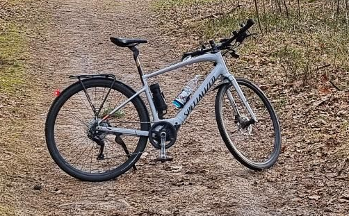

Is the -6 position only for aero sakes?
The more an aero position is just a bonus. While riding at the default configuration, I suffered:
  • Sore butt
  • Aches in lower back, shoulders, and the neck
  • Numb hands
  • Dizziness
As I was experimenting with lowering the handlebars, I could notice my pains were gradually relieved. An EBR Forum user told me about "slamming" the stem, and I did it to lower the bars even more. Of course I had to relocate the elastomer(s) in the internal chambers of the ShockStop stem. Eventually I added Innerbarends to get the flat handlebar equivalent of a gravel e-bike.
Notice the handlebars being located lower than the saddle now.

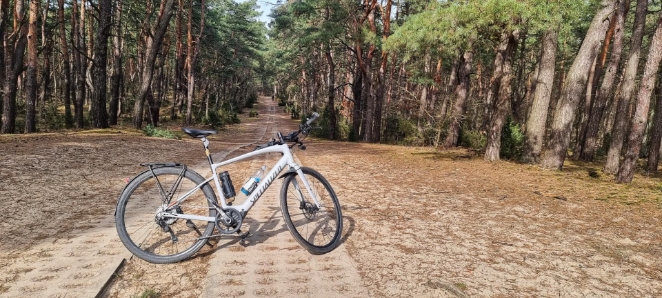

Some info for you: On Friday and on Saturday I rode two different e-bikes via almost the same route that involved forest ride. You would be surprised:
Vado SL with Redshift handled much better and felt far more comfortable than Vado 6.0 with a 45 mm travel suspension fork! (Vado is a heavy e-bike, and it was one of the reasons, still...)
