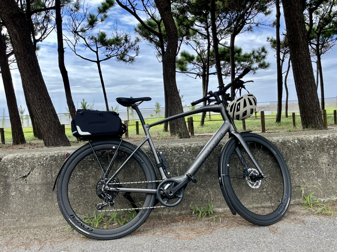

so here's my derailleur pics on a 4.0 EQ. Mostly to show the difference in tire clearance between the 32 mm Gatorskins and the 42 mm Pathfinders. My chain can be shorter because the big cog on the casette is 36 instead of the original casette so my derailleur positions aren't quite as extreme.
Oh nice! I went with the 38mm Pathfinders because I thought the 42 wouldn't fit if keeping the rack and fenders. How do the 42 do on tarmac? I wondered if the difference between the 38 and 42 was that pronounced or if it's marginal.
I tried a ride in the local forest and the 38 behaved quite well, but if there's any chance that the 42s offer an overall more polyvalent and efficient take, while fitting with the EQ gear, I may consider switching.
The 42 were too tight a fit on the rear since the clearance to the fender bolt heads was very close. I kept the fenders on and switched to 38 mm and went tubeless. I also have a fenderless Tero (that can fit 2.35 in wide tires easily so clearance isn't an issue). Once I get the Tero updated to Class 3 I'll try the 42 mm pathfinders on it, also tubeless. When I used the 42 mm on the Tero previously they were quite good on the road. Of course that is compared to the stock 2.35 in Ground Controls which roll almost as well enough but are very noisy.
Thanks for your experience. It's confirmed, putting on the 42mm will require some hassle and buying to replace the fenders.
Thanks in advance for the review of the 42mm :)
