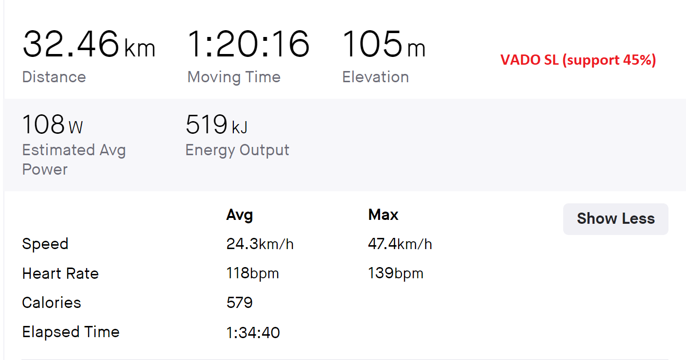

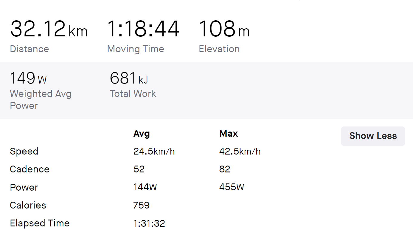

Yes, the data is contrary to what I feel when riding these two bulls. Let's go like this, I make the same route with Vado SL, with the fact that I will transfer the data to Strava with MC (BIKE). I provide the data.
As I promised, I made the same route with Vado SL, with the fact that I downloaded the data from MC. In the extension, a comparison with different data sources (Strava first, MC second).
Remark;
the distance differs in 0.3km,
caloric expenditure at the end of riding on TCU I read 670?
Correctly. The TCU and Strava take the same rider's energy input but have to divide the value by the human body thermal efficiency, which is an arbitrarily selected figure. Strava assumes different human body efficiency than the TCU/TCD.
If you would like to compare kcal for Vado and Vado SL, always compare the data using exactly the same data source.

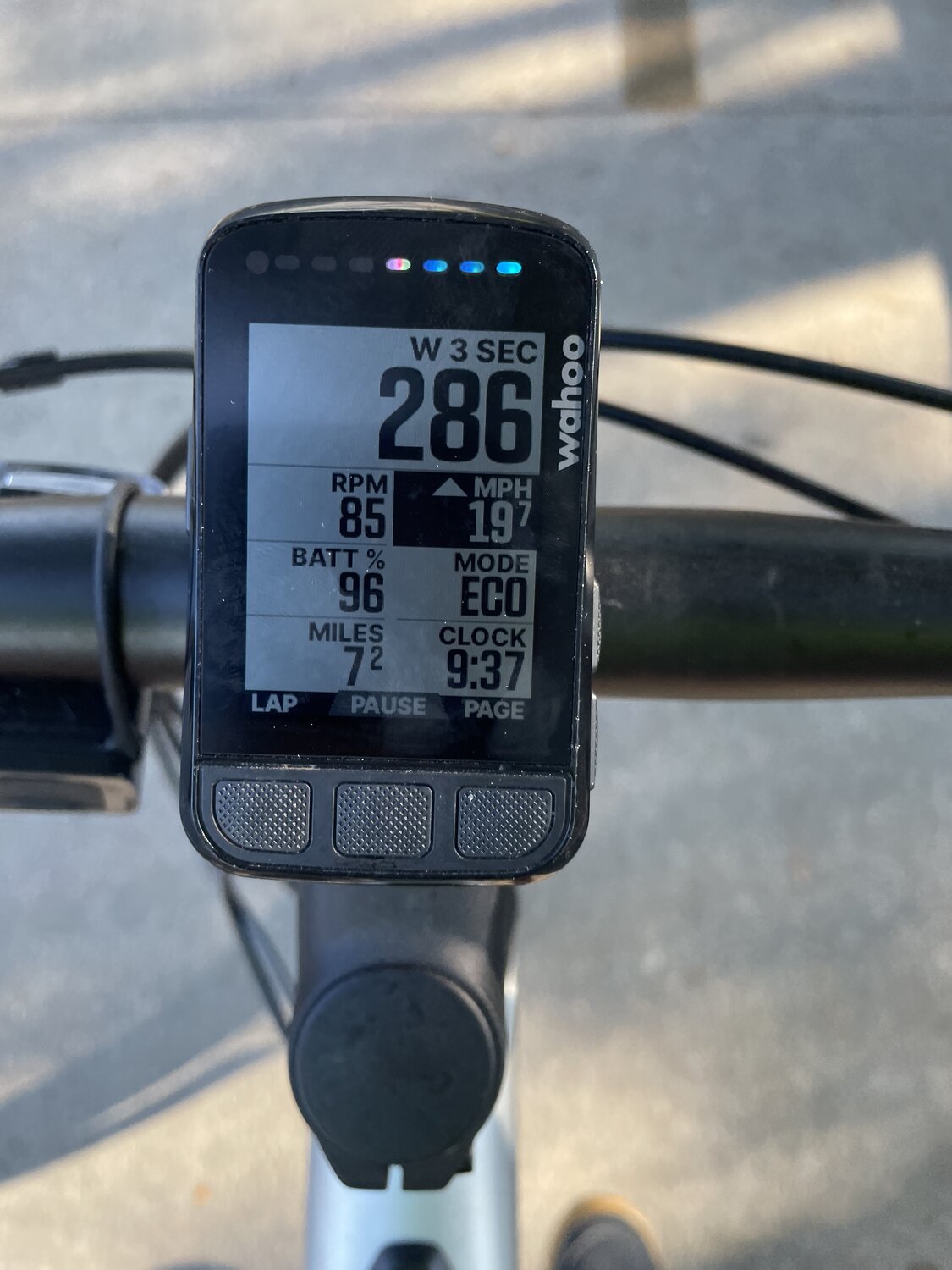

I have been using Wahoo Bolt on both my Vado SL 5.0 and my Roubaix. I really like that the Wahoo displayed all the data for the E-bike but it would not auto pause like it does when used on my Roubaix. I contacted Wahoo as was told it was a "known issue". Ok, well here is a work around for those of you using Wahoo on Specialized E-bikes.
1. Turn on the Wahoo
2. Start the ride BEFORE turning on your bike and connecting to the Wahoo
3. Turn on your bike and ride. Auto Pause would work normally.
I discovered this by accident when pausing my ride to get coffee and turning the bike off. When I started my ride again the auto pause feature was working. Hope this makes the Wahoo more satisfying for those of you using it.

Thank you!
For a couple of weeks now Wahoo activates Auto Stop normally for my Specialized e-bikes. It must have been a device software update that you might have missed?
I pretty sure the Wahoo is current but not so sure about the Vado. Ive heard from another European user who has no problem as well.
Scott, the software in my Vado and Vado SL has not been updated for a long time. However, I was using Roam and Bolt v2 alternately and had no Auto Stop for many months. Now, Auto Stop started working out of nothing! No reason! I update both the Companion app and the Wahoo firmware regularly though.

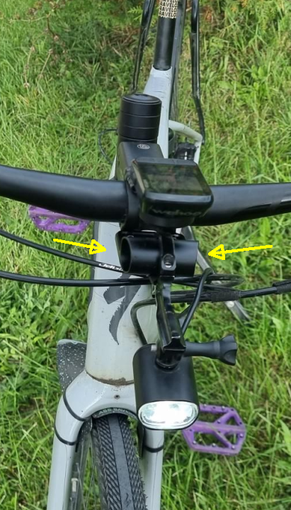

I have completed building my Redshift ShockStop system. Now, both Computer Mount and Utility Mount are attached to the ShockStop stem. I have relocated a GoPro Mount from the bars to the Utility Mount, not without issues! The GoPro Mount is 31.8 mm (1 1/4") while the Utility Mount is 25.4 mm (1"). Redshift sells a shim to make up the difference. Unfortunately, Redshift online store for Europe has no Utility Mount available, so I had to buy the UM from Amazon (no shim offered there). Then, I had to make my own shim of a piece of rubber. That was not that easy!
Eventually, my stock Lezyne headlight is past the cables, centrally, and very far forward.

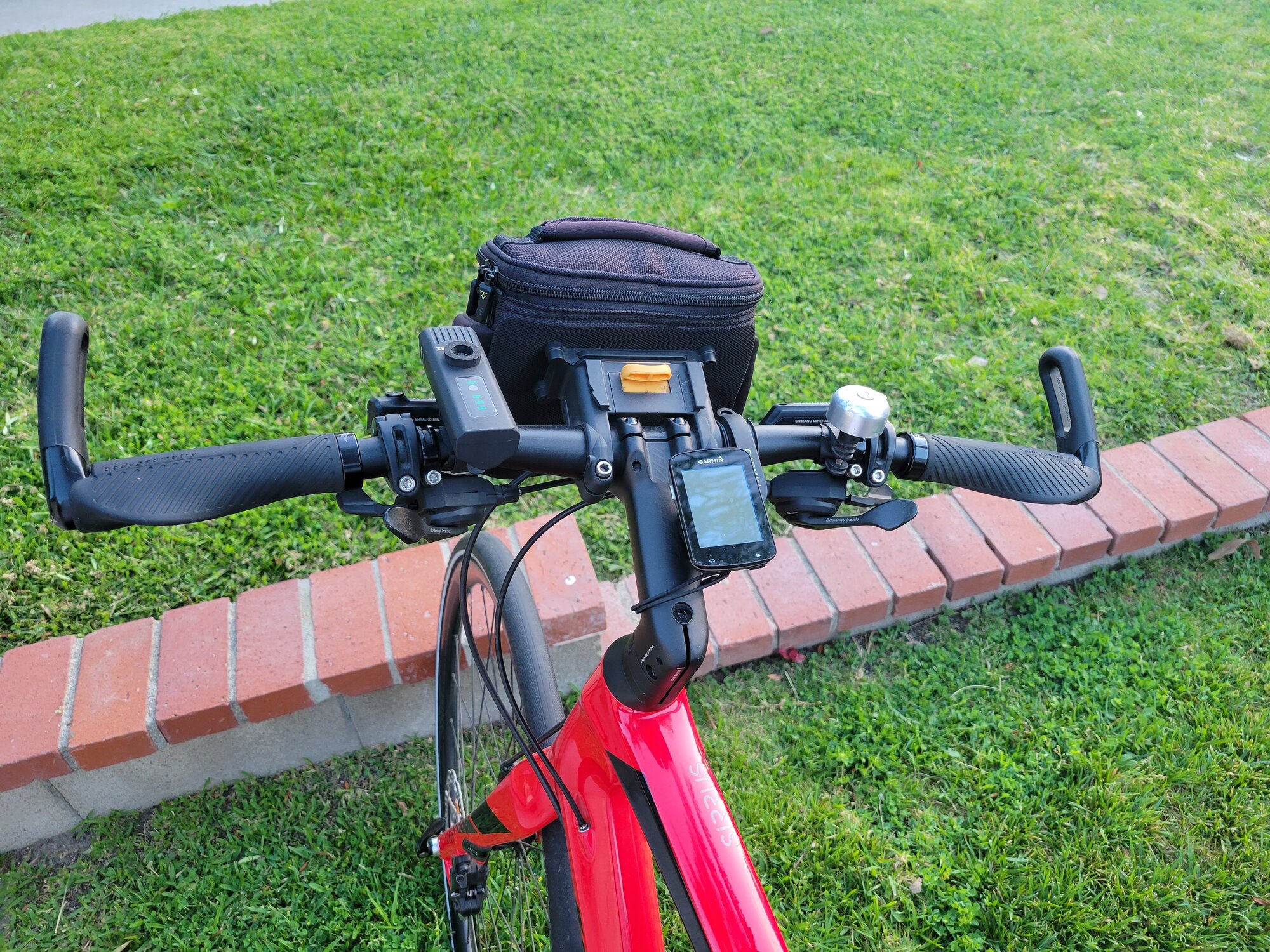

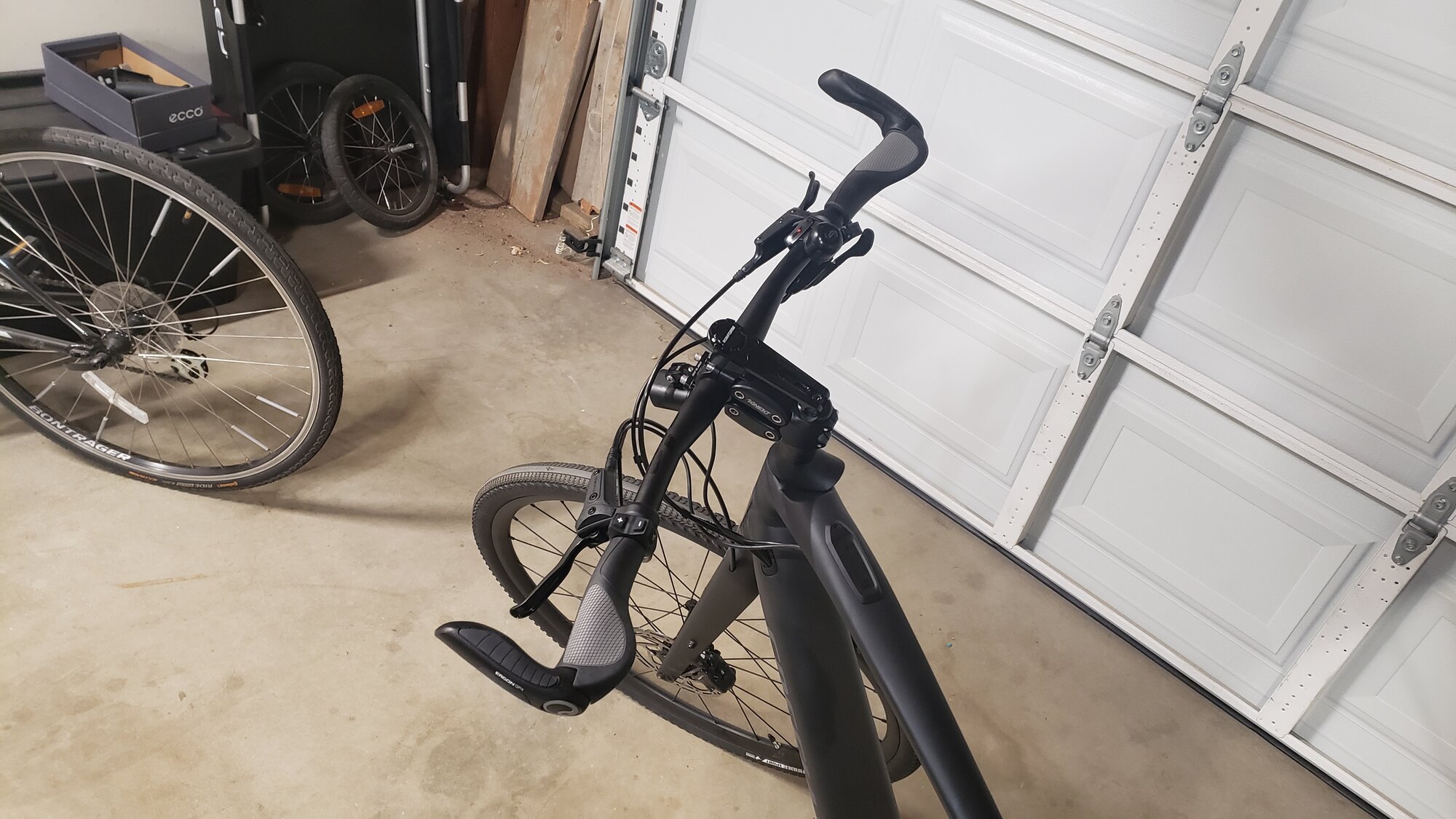

thanks to everyone that has contributed to the SL Thread i am new here and reading and learning a lot, I am very happy with my 4.0 Eq now just looking to add bar ends like the ones that come on Specialized Sirrus bikes I wish i would had taken them off before selling the bike if you know where i can find these let me know TIA
I own a 2012 Specialized Sirrus Elite. Do you have a photograph of the specific part you're looking for?
Is it just the little plastic end caps that close off the holes on the handlebar ends?
This looks like them. Model is Targa.
Might be tricky to find any:
Thanks no look at the picture I uploaded its the bar ends handles
Yes Richard those are it I can't find them
