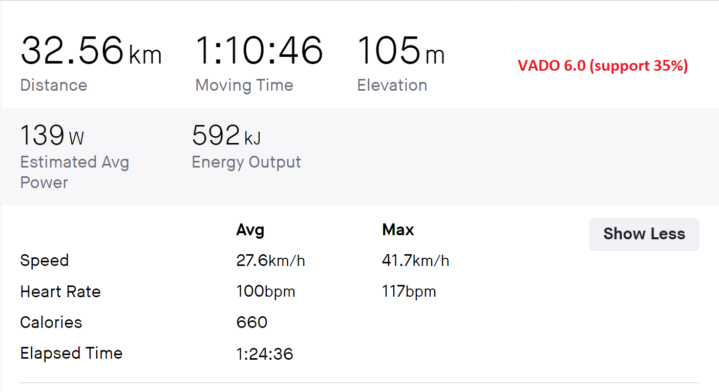

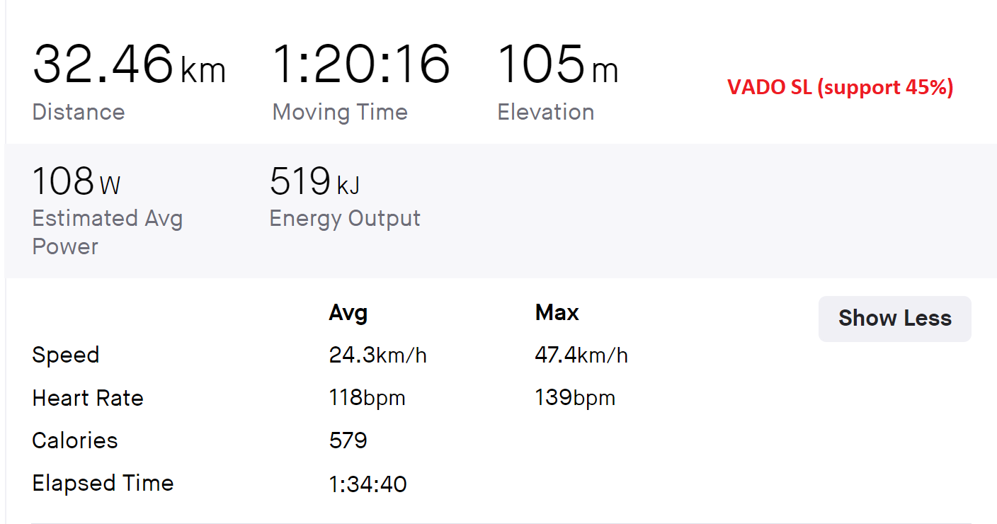

Hi,
I follow topics, but due to lack of time I rarely comment.
However, to contribute to the community with my experience. Namely, I own two Vado SL & 6.0 and below I have put two identical routes with the stated parameters of STRAVA.
Data is collected by Apple Watch.
It's interesting to see that the heart rate is higher on the SL (and it feels like I'm using more effort), while the 6.0 burns more calories.
By the way, with the mentioned support, I pull it out of the battery; - SL 90 KM - 6.0 80KM

Hi,
that’s because strava is primarily using speed to determine the amount of work you’re doing - and riding faster takes much more energy. what strava doesn’t realize is that the bike is actually providing that extra energy.
unless you use the built-in power meter on the bike (which actually measures your energy contribution to the ride!) the calories figure in strava is completely meaningless!

Igor: First of all -- long time no see, friend! It's good to have you back!
Now: You are relying on Apple Watch. If you had your data transferred from the e-bikes to Strava (for example, by the BLEvo app), and you had this support set for your e-bikes:
  • 30/30% for Vado 6.0
  • 60/60% for Vado SL
(The above give about the same assistance expressed in Watts)
Then you would have noticed your own leg power, heart rate and calories would be about the same. Note: Both Specialized e-bikes have a leg power meter and calculate calories based on the energy you have input by pedalling.
If the assistance is 35/35% for Vado 6.0 and it is 45/45% for Vado SL, then Vado 6.0 has as much power as Vado SL would have at 70/70%. So your Vado 6.0:
  • Is faster than Vado SL
  • You heart rate is slower on Vado 6.0
  • You burn less calories on Vado 6.0.
The factor that made your data misleading was the Apple Watch, as it has no idea how much of energy you actually input by pedalling. Your e-bikes know that precisely.

Yes, the data is contrary to what I feel when riding these two bulls. Let's go like this, I make the same route with Vado SL, with the fact that I will transfer the data to Strava with MC (BIKE). I provide the data.
Best regards, Stefan. you make an immense contribution to this topic.
Also use the data of MC in Specialized "Ride" app (@mschwett can explain how to do it). For an experiment, use 35/35% assistance for Vado 6.0 and 70/70% for Vado SL. You might get surprised!
