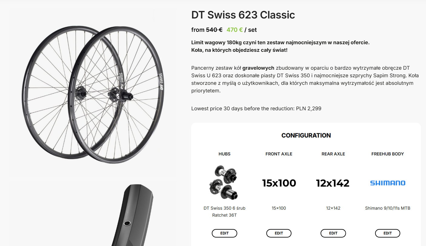

I also asked for an advice at a gravel cycling group. The same man who convinced me the Wheeltop derailleur was a good thing also convinced me to contact a wheel builder by name Lemon Bike. So I got an offer:
  • DT Swiss U623 rim (29", e-MTB, 25 mm internal rim width, total system weight limit 180 kg, 32 spoke holes), RDU623CDAB32SA9807
  • DT Swiss 350 Classic rear hub, 12x148 mm, 32 spoke flanges, Centerlock, Star Ratchet 24T, steel freehub (HG freehub), H350TCDSR32SA9853S
  • Sapim Strong spokes with Sapim Polyax Double Square nipples, 32 pcs.
That should be a super strong wheel! The price is by a margin higher than the HU 1900 ready wheel I considered earlier.
I will ask for the shipment for after 16th April when I'm back home.

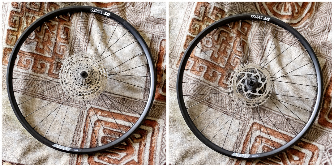

Here It Is!
  • DT Swiss U623 rim, 25-622
  • DT Swiss 350 rear hub, 12x148 mm, Centerlock (new model: Hybrid)
  • Steel HG freehub body
  • 32 Sapim Strong 290 mm spokes
  • Brass nipples
  • Tubeless tape
  • Presta valve adapter
  • Maximum system weight 180 kg
  • ASME classification: 2 (gravel)
I armed the wheel with
  • A custom 11-speed, 11-51T cassette, custom, based on CS-M5100 (gears 1-6) and CS-M8000 (gears 7-11)
  • A 160 mm Tektro brake rotor, Specialized e-bike magnet bracket.
Than I completed the wheel with a Specialized Rhombus Pro 42-622 tyre and an inner tube.
As I was installing the wheel back on my Fearless, I had a little panic attack :) but all went well. Setting off for a test ride soon.
Dismantling the cassette was a good thing. It was not only full of grime but I could also remove some twig that was entangled in the cassette from the back! Moving the magnet holder was an opportunity to clean the magnet, which was extremely dirty as well :)
Ooh, let it work... I'm setting off for a 100 km gravel group ride I've organized tomorrow!

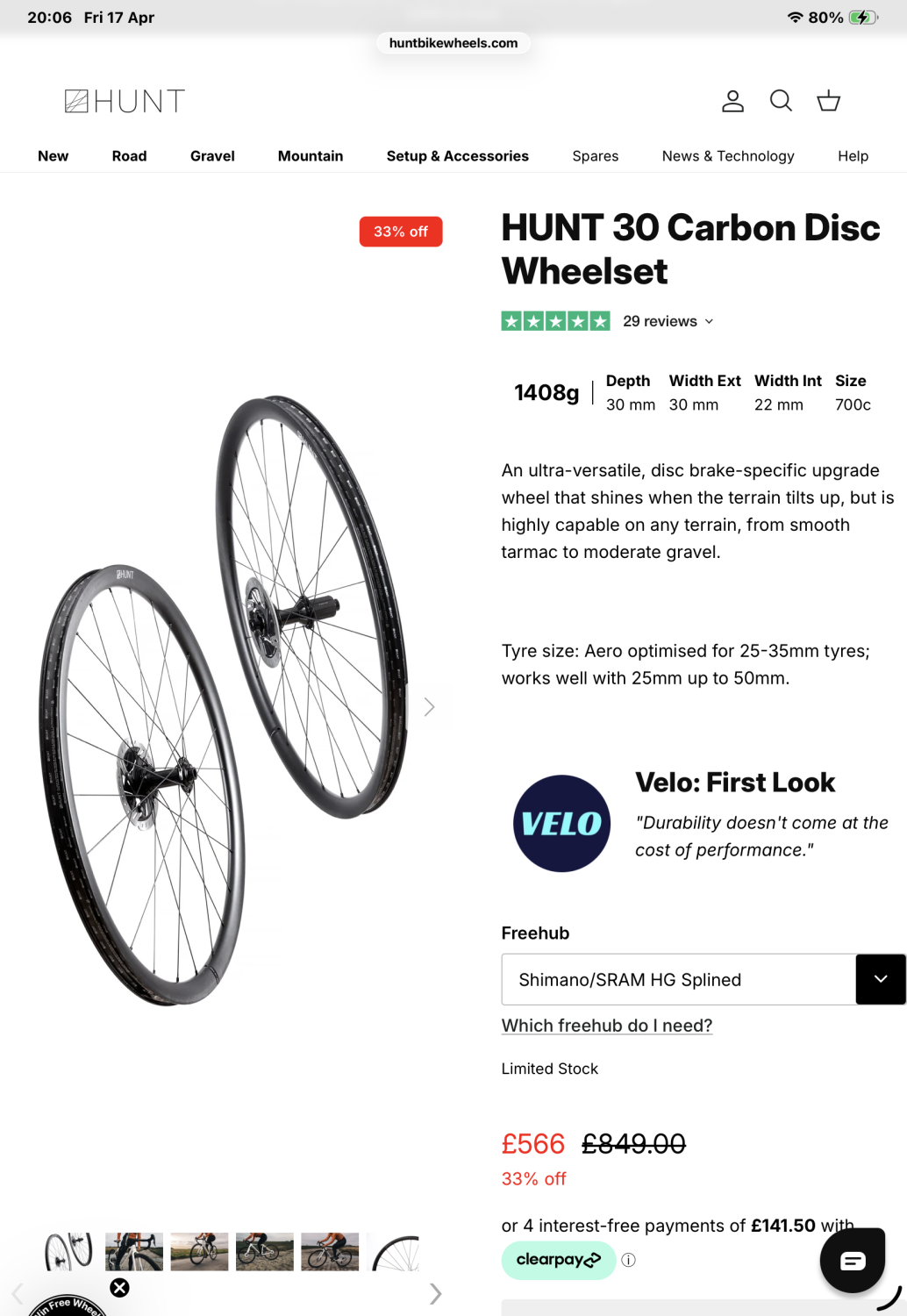

I put some Hunt carbon wheels on my SL2 recently. Despite the 700g reduction in weight (per wheel) I can’t say I’ve felt much difference in performance Other than the bike being easier to accelerate from standstill. They are rates as being suited to road and light gravel so not for the rides you do Stefan! At £500 and weighing just 1400g they were well priced.
Yes per set. Increased price to £566 now as they had an extra 10% deal on top of the 33%. Seem to get good reviews…….time will tell.

An excellent price as for carbon wheels from a well known brand! Regarding my Lemon Bike wheels, the builder company offers them to e-bikers and bike-packers. Comparing the weight per a wheelset: yours 1400 g, mine 2360. The U623 set can be bought for an equivalent of 410 quids. I simply didn't need the front wheel and had some custom requirements (like, a steel freehub body as the alloy ones by DT tend to errode).
