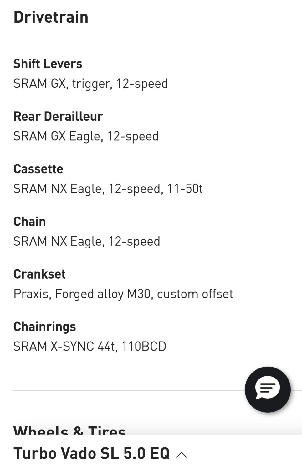

What freehub/cassette type does your current SRAM drivetrain use?

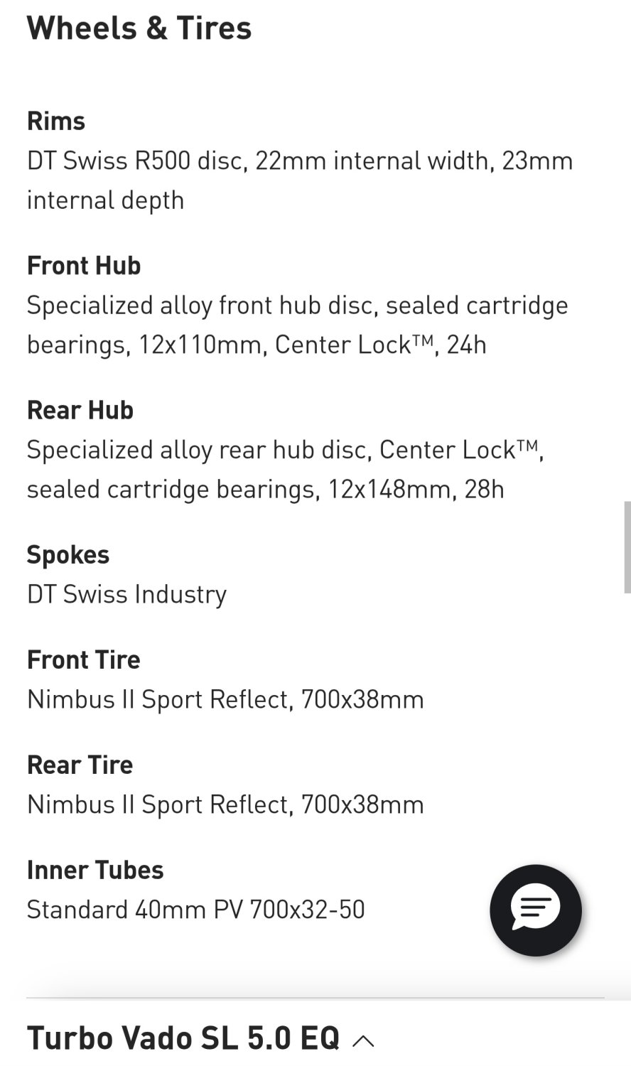

Thanks! Official specs below if that helps.
Running 38 mm tubeless Spec Pathfinder Pros now — said to be the largest tires possible given my fenders.
