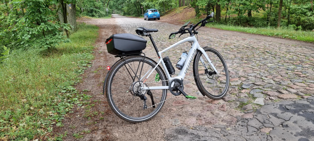

Now, I might need your advice :) The rear wheel of my Vado SL (28", 12x148 mm, Thru-Axle, Centerlock, 21 mm internal width, 28 spokes) has almost given up. Yes, it might be trued but I know how it ends (it ends up badly soon!) The wheel was used for almost 5 years. I'm a heavy rider and often ride in rough terrain. I happen to take a pannier with me, which adds up to the weight as well.
