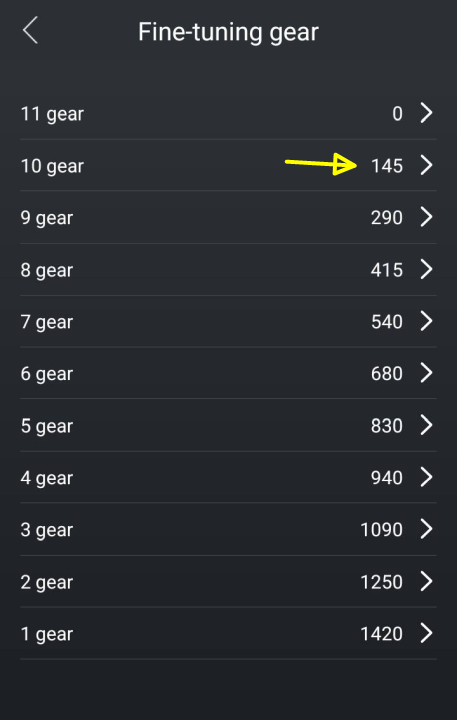

My table of the derailleur adjustments. The gears are listed from the granny gear (1st) to the hardest gear (11th), The major adjustment was done for Gear 10 (down from 170). (The adjustments to 9th and 8th were minimal). No adjustments for 1st-7th.
