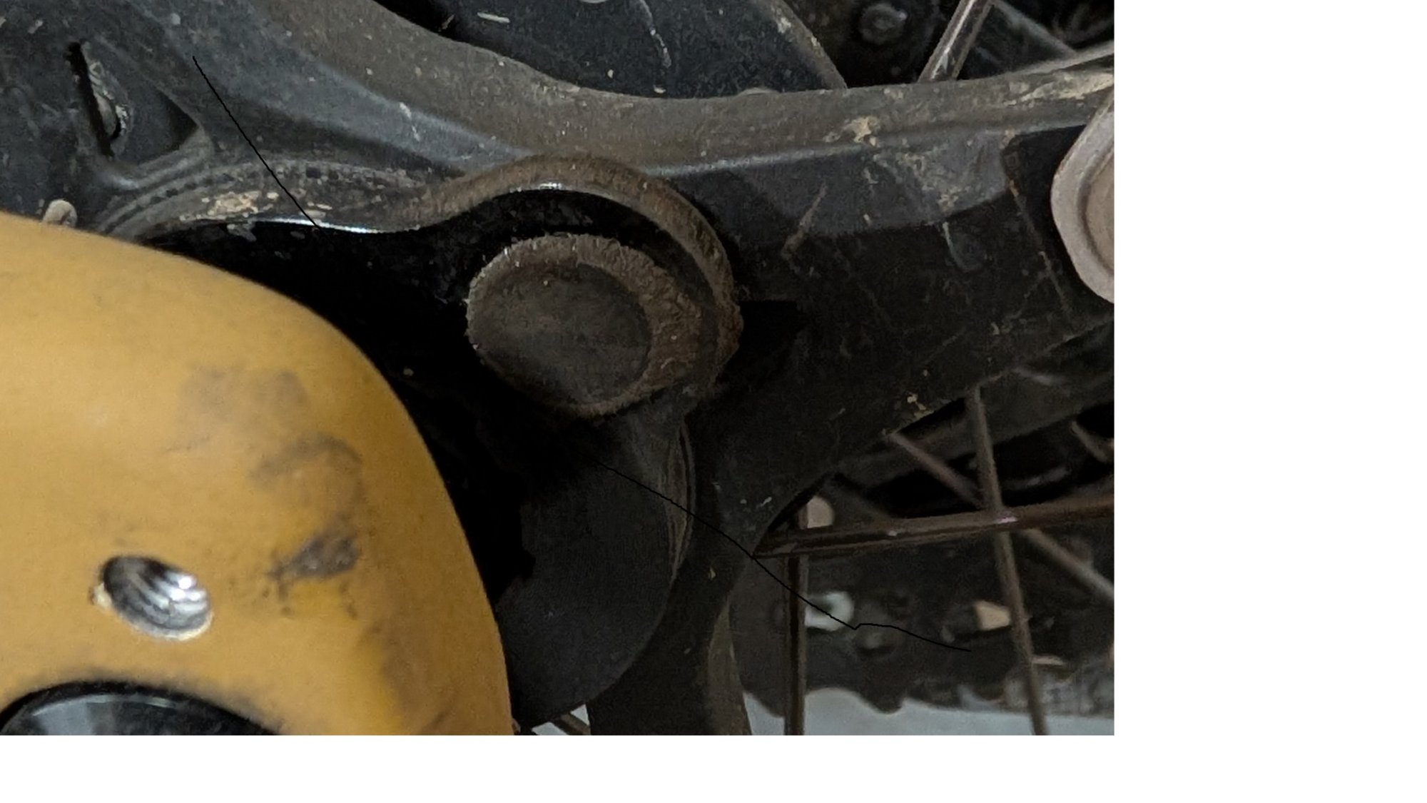

No defective (or damaged) parts found, so no basis for a warranty claim with Tektro. The mechanic's seen one other SL 1 with the same recurring rear brake problem (one piston sticking against the rotor).
He's thinking now that the magnetic rear wheel sensor has magnetized one of the steel pistons, causing metallic brake dust to cake on it and eventually block its retraction. Our many steep hills, my tendency to favor the rear brake, and my frequent riding on sandy hard pack probably aren't helping.
He's working up some options for a middle-tier brake upgrade without steel pistons. The SL 1's combo of flat bars and flat rear caliper mount limits the possibilities.
Kudos to your lbs for what would be extremely reasonable charge for the piston clean. No way that happens with any of the lbs around here. I would discount his magnetized steel piston theory tho. A wheel sensor magnet is not powerful enough to magnetize a piston that is so far way. I wouldn't prioritize an upgrade solely to get a non magnetic piston.
What I can see happening is that the magnet does attract a lot of metallic dust. Just took a pic of the sensor on my creo shown below. Get enough of that dust on the magnet and at high speed, wheel rotational centrifigal force will throw some of that dust off and some will find its way into the brakes.
Regardless of the wheel magnet, brake parts are open and constantly exposed to contamination. If the pistons/seals are indeed in good condition, it's likely that whatever conditions you are riding in contribute to the ongoing sticky piston issues you may be having.
