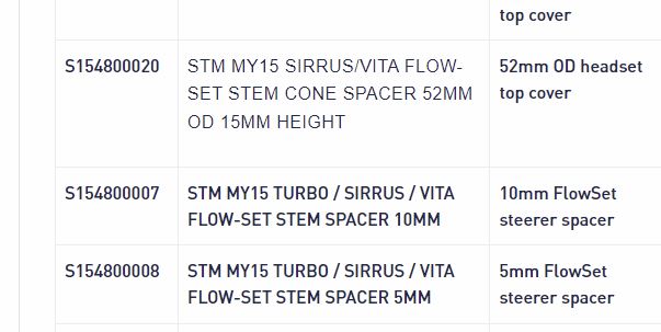

Does anyone know the part number for a spacer set that will fit the Specialized Flowset stem that comes on Vado/Como bikes? All I need is to add one 2.5mm but they are shaped oddly.
these are what specialized lists for the MY2020/2021 vado. seems like it's the same going back quite a few years.
Since the bike may come with both the stem and handlebar mounts you can probably tell them how you want it when you order it. Agree with you that the stem mount with the cable routing looks much cleaner and I may swap mine in that way.

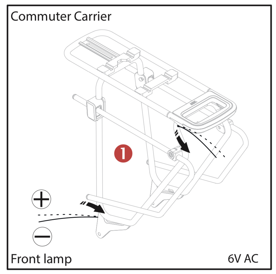

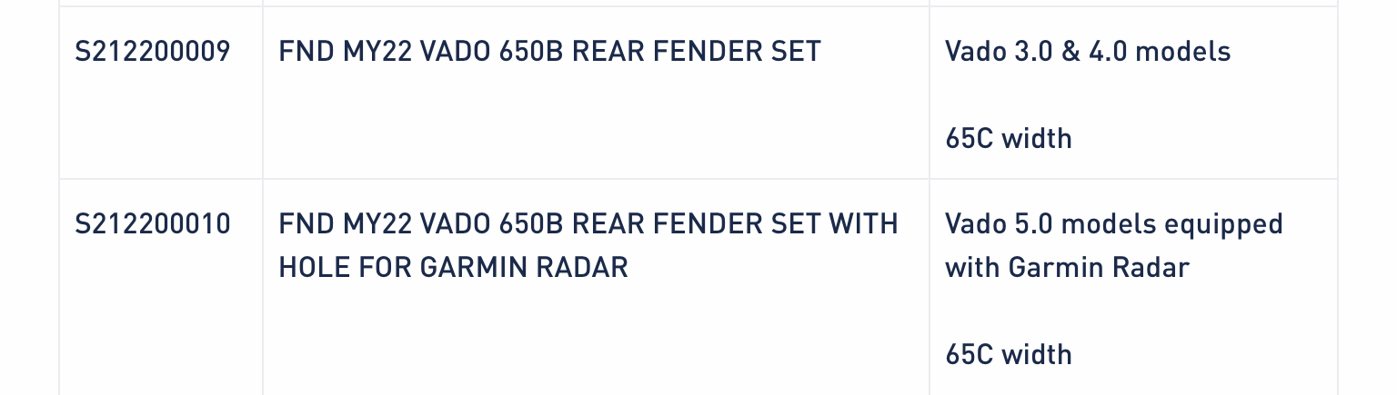

What’s the routing path for the wires powering the tail light and Varia?
Up through the inside of the fender? Or separate with the tail light wiring coming up thru the rack on the left side?
Was curious since after diving down a rabbit hole it seems wiring routes might be separate? One inside fender and over along chainstay and inside rack tubing?
Different rear fender for 5.0 vs 4.0/3.0 per https://support.specialized.com/turbovado/en/service-maintenance/replacement-parts
Then this page links (click on Spanninga Commuter Glow) to https://spanninga.com/product/commuter-glow/
The manual shown there suggests a thru-rack wire routing to the left chainstay.
And thus my curiosity.
