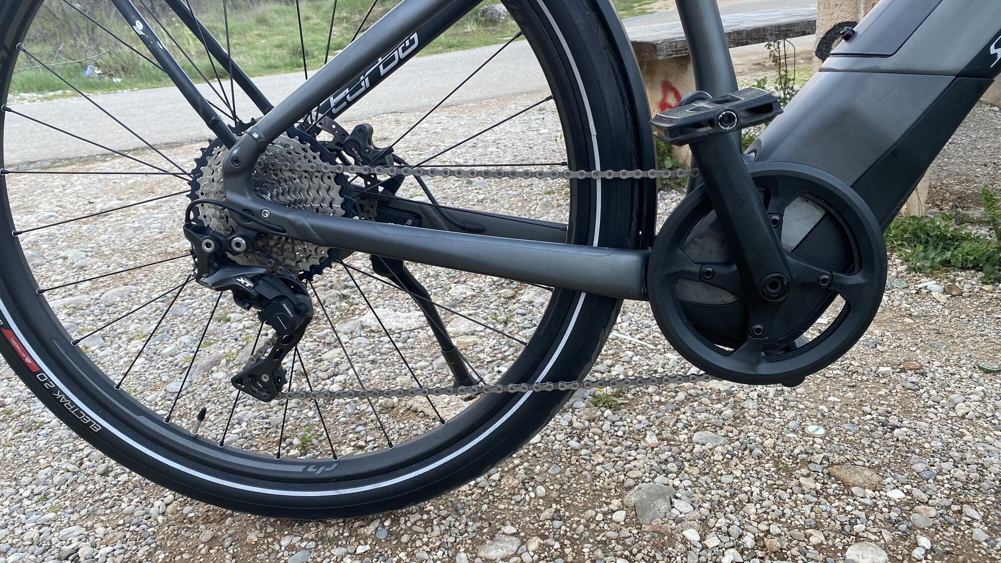

btw, anybody know what can i mount on the frame where the battery is? i mean the 2 screws where u can mount a bottle.
on the upper frame it is easy to mount the bottle but between these 2 frames, the space is very tiny
You need so-called "side-loaded water-bottle cage". So you insert the bottle either from the right or the left side, depending on the cage you have bought,
Ah, possible. My older Vado ST has far more space there.
I have the Specialized roll cage so I can choose which way to load my bottle. It’s about 4” from frame to top of cage. The mid step only has about 3-3.5” of clearance without getting precise. The top tube is where I think they intend that to go. But my wife just packs hers because she uses that space to stand when she’s off pedal and it would crunch her bits if she used it for water. Short people problems.

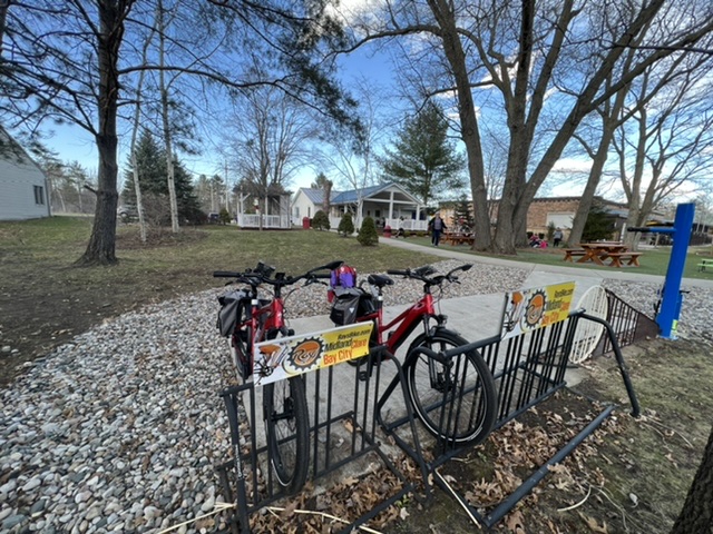

Did another 15 mile family ride after work today on the new Vado 5.0 IGH. Finally sunny and 62-64 F. Stopped to share an ice cream on the way.
We parked at our LBS to start our trip. My 21mm pedal extenders came in so my clown feet could fit properly on the pedals. Figured I’d put them on before the ride. Unfortunately, the new Vado pedals don’t have wrench flats. They tighten with an Allen key behind the crank arm. So I upgraded sooner than planned.
Picked up a new set of Specialized Bennies Platform Pedals. So much better than the stock sandpaper style nylon pedals. Even better that my feet finally fit!
