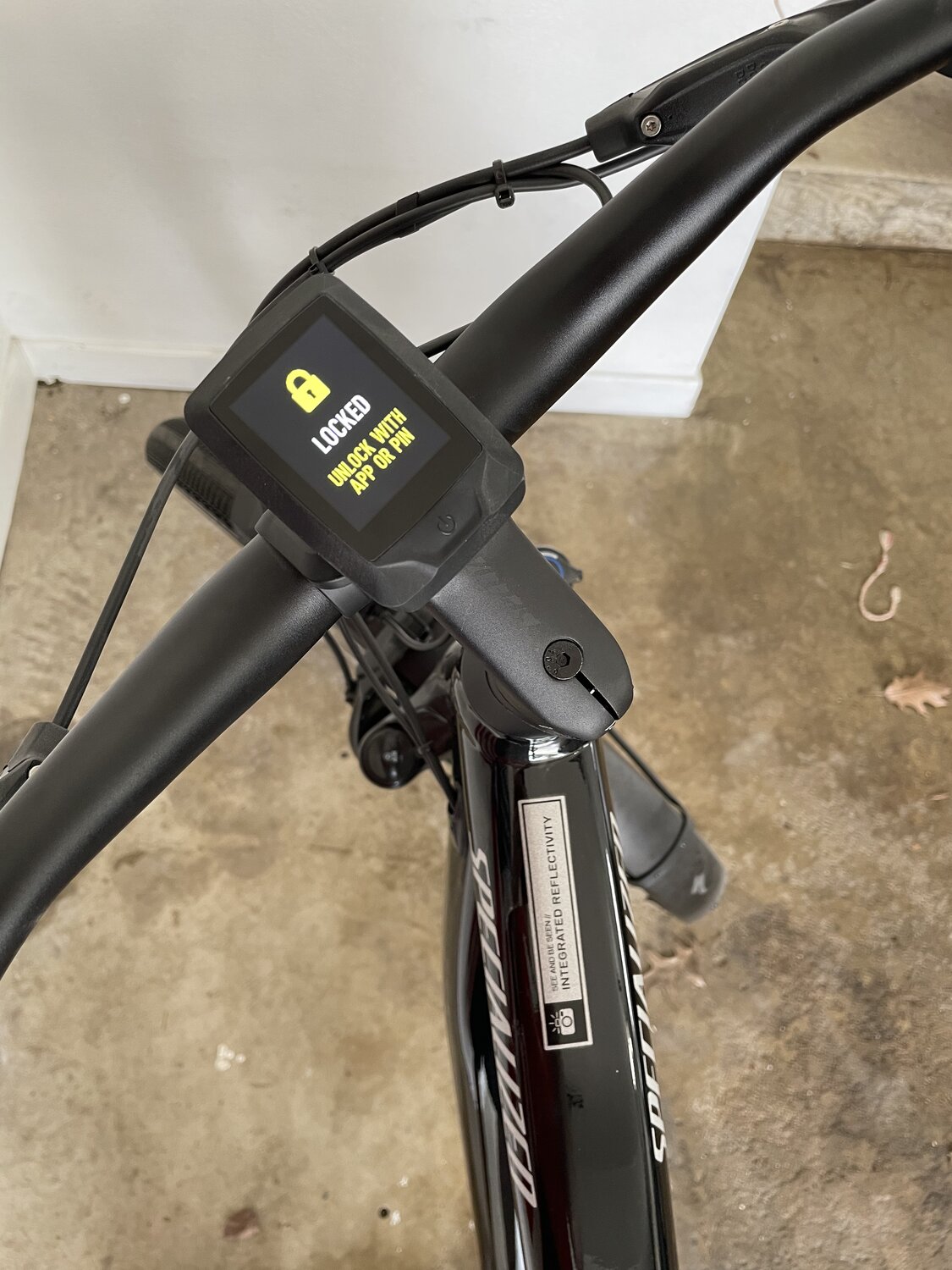

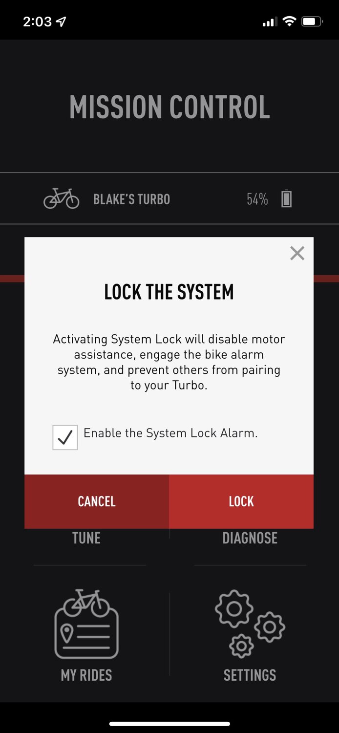

Has anyone gotten the alarm feature to work on a new Vado? The System Lock functionality works fine, but I haven’t been able to get the alarm to sound regardless of how much I move the bike. My Vado 5.0 was delivered in March 2022, so I think it should have this feature on the bike.
I have tried contacting Specialized rider care via emails, tickets, and a few phone calls over the last 2 weeks, but it seems they’re back to just ignoring customers. My LBS that took delivery doesn’t know anything about the feature.
While I have no direct knowledge, a recently released firmware update is supposed to fix this feature.

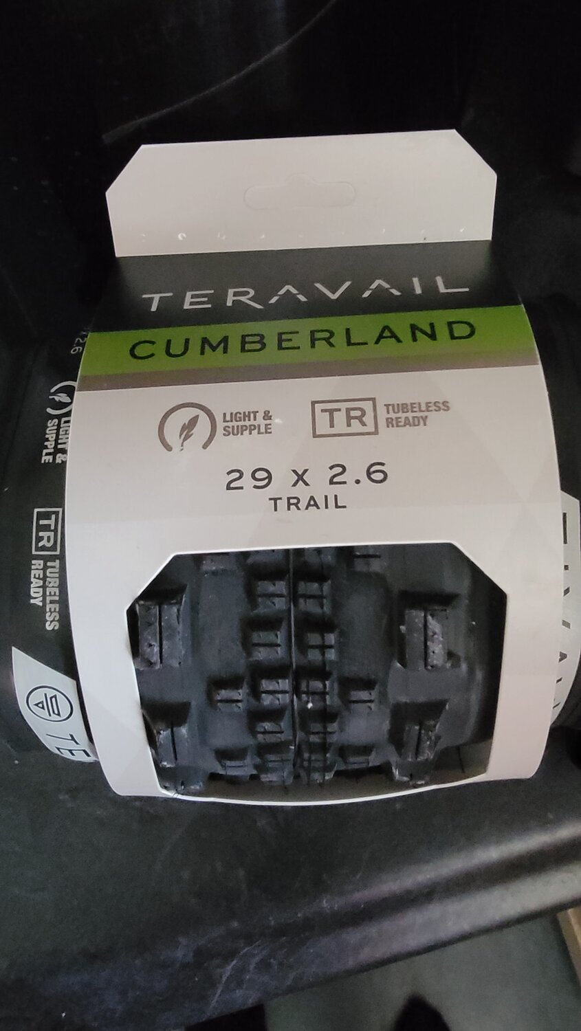

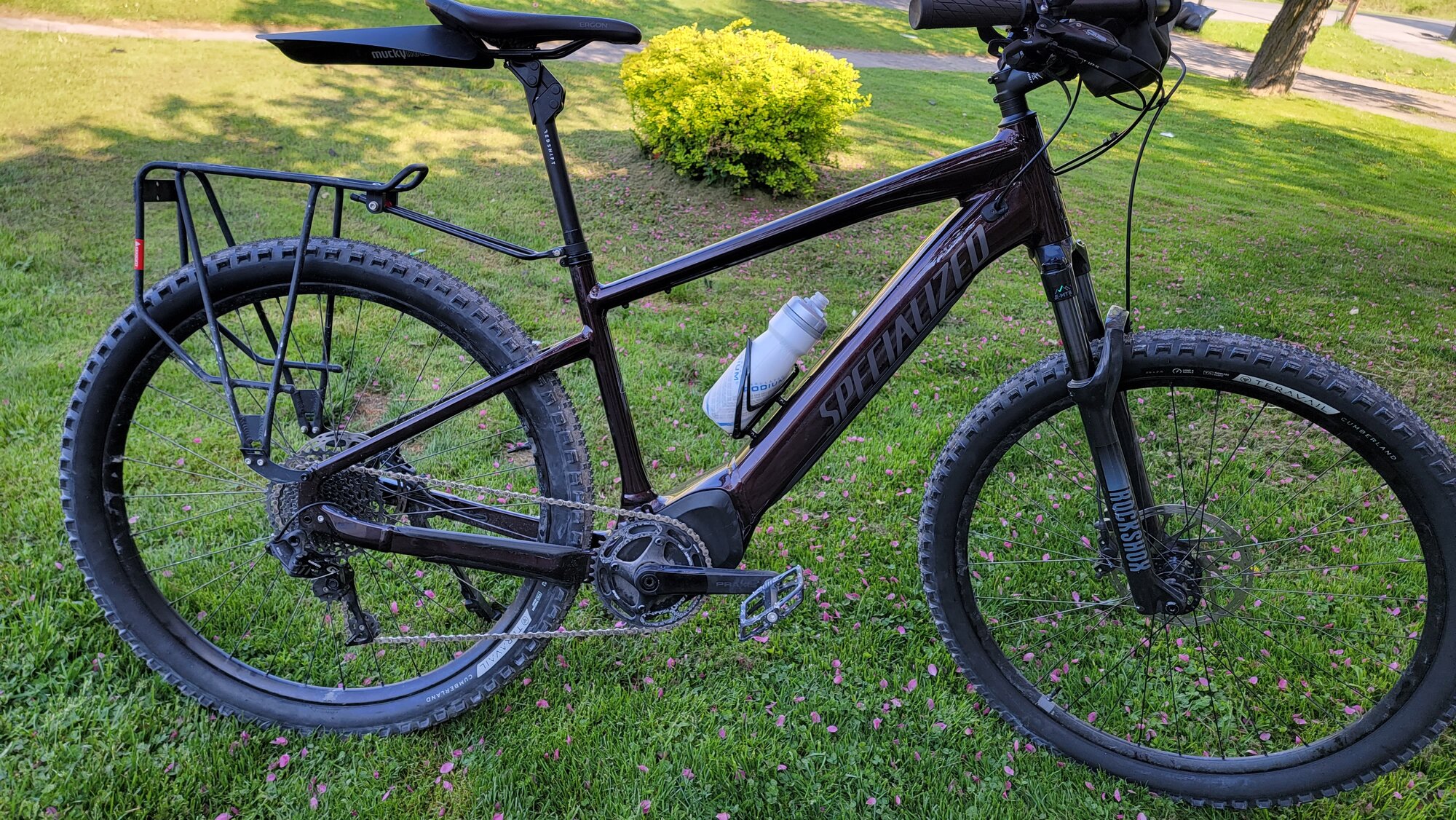

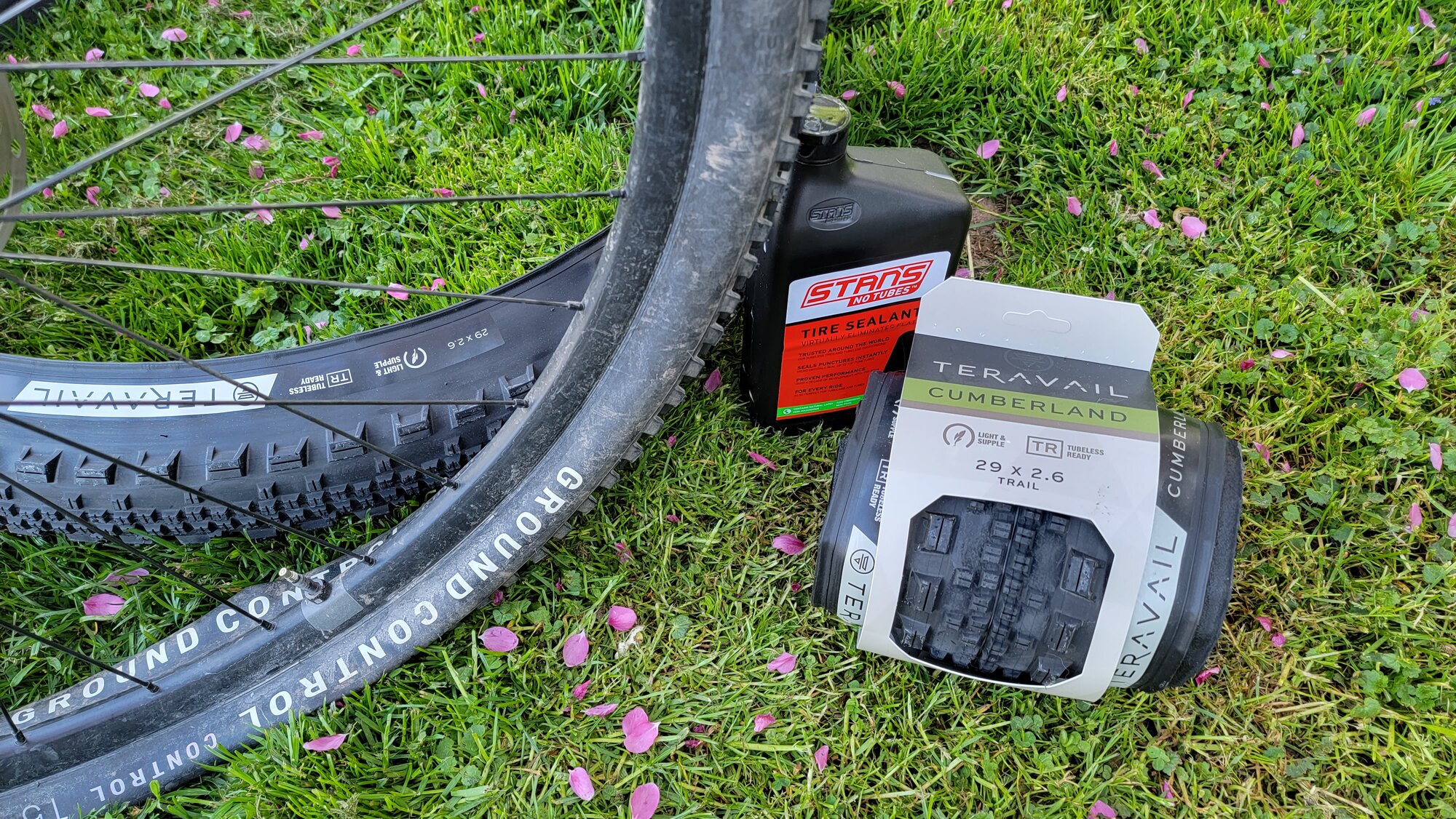

I mounted Teravail Cumberland 2.6 tires on the 25mm rims today (yes the Tero comes with skinny 25mm rims for some reason).
I've had my Tero 5.0 for a few weeks now and have put 300+ miles on it. Something has always felt a bit off when it comes to comfort/performance on my usual gravel trail commute.
I feel like the Ground Control tires slide around too much, and I've almost spilled doing a simple slow u-turn. I also didn't think they were giving enough comfort. They are set up tubeless and I've tried different air pressures. I just think these tires are "ok" at everything, but dusty crushed gravel is their weakest point.
After doing a bunch of research I found the Tero can fit 2.6 tires, and the Teravail Cumberlands look like good gravel tires for the Summer. They have small tight spaced knobs down the center, which should be good for gravel and pavement, with large wide spaced knobs on the outside for cornering bite.
I took off the front tire and thought "wow this rim is narrow for an EMTB". I looked at the bike specs online, and yes for some reason this bike comes with only 25mm rims. Somehow I overlooked that spec.
I was hesitant about mounting 2.6 tires onto 25mm rims, but I've read many people doing it without issues... and many people preferring that setup. I have to expect the tire profile to be a bit more rounded than it would be with a wider rim.
The tires did mount very snuggly and seated on the first try. I took it for a slow short ride to work the sealant around. These tires already feel more "supple". I'll be going on a longer test ride later today. Fingers crossed they work out as planned. I also think they look good on this bike.
On a side note, the Ground Controls are very light and get good reviews. I'm wondering if they would perform better with wider rims.

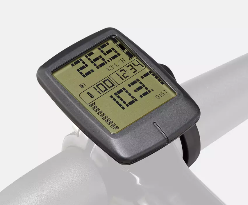

This is how the display looks like but it will have wires connected to it.
The TCD-w display shows the pairing code when you try to pair your smartphone via Mission Control app.
