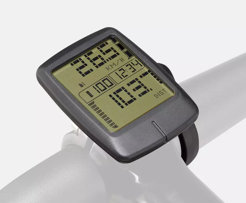

This is how the display looks like but it will have wires connected to it.
The TCD-w display shows the pairing code when you try to pair your smartphone via Mission Control app.

Yes that is the display. I went for a quick ride on it yesterday and it was definitely that one and not the bloks. It was raining hard though so it was a very brief first visit. Can definitely ask after mileage and see if by chance they still have the app connected. Thanks again for the helpful replies!

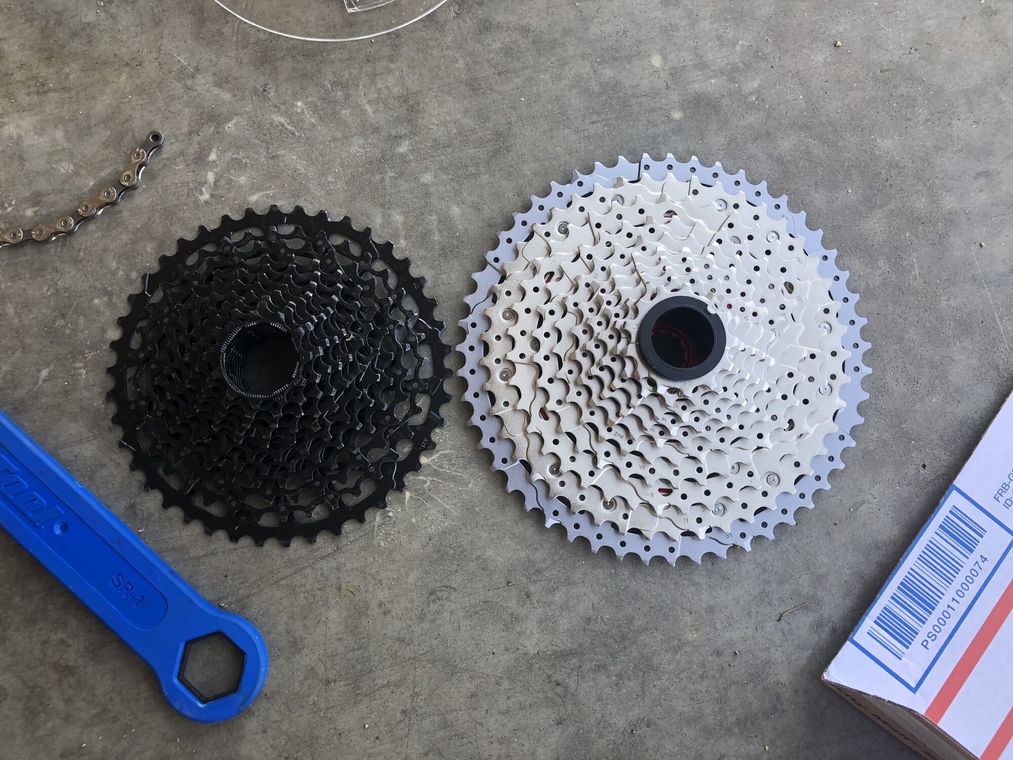

Time for some lower gears on the Vado.
Did a 65-mile ride today with about ~4,000 feet of climbing; the 51-tooth is really nice for the hills I ride in in southwest Wisconsin.
Time for some lower gears on the Vado. View attachment 123312
Or you can get a Praxis 36t chain ring and don't have to extend the chain and will probably work with the current chain length and move your cog engagement 2 rings closer to inline with the front chainring. Probably easier on the chain also. The perceived power increase because of the leverage advantage is noticeable also. If you have the oem aluminum chainring I wouldn't hesitate to change it out for the steel Praxis.
I did contemplate a smaller chainring, Marcela and Stefan- and wouldn’t be opposed to going that route.
My idea of going with a bigger rear cassette was to get some lower gear inches, but not lose any on the top.
Realistically, the amount of time I spend in Turbo roaring around at 28 MPH 🙂 is pretty limited, so I think a smaller crank ring would suit me just fine.
You already own the wide-range cassette. Please make some calculations with bikecalc.com to determine the ideal chainring size for your needs. While I must use the 38-46T in the mountains, I love the 42T chainring here in the plains, as I can hit 25 mph with good cadence but still the low gears are adequate for occasional hills in the greater area where I'm riding.
Your last sentence was my conclusion. Also the smaller chainring will reduce the cog tooth spacing slightly so there is not as much of a jump from one to the other on cadence. With my 36t cog I can easily do 20 mph and usually cruise around at the 10-15 range. If you are a 48t chain ring now the difference is very noticeable, if you're 40t not so much and going with the different cogs would probably be better.
Yesterday we had some calm wind and I was out on the Como so I made some observations, with the tires low on pressure and the 36t chainring.
On the flat cruising around at 12-14 mph was pretty easy, the lever arm of the crank with the smaller chainring I think may give 1-2 mph. At around 16-17 mph wind resistance starts to be noticed. At full power and 90 cadence on the flat gives about 22-23 mph.
With this in mind, a 40t chainring may be optimum if wanting more top end. But I still like the 36t pretty well. 38t would probably be a good choice also. I don't see any need for the 48t, the motors can't use it imo.
