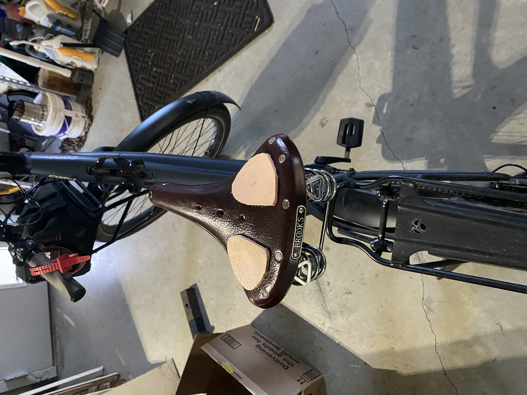

My B67 was getting a little soft in the upholstery department. To keep stretching it wouldn't do it any good and one alternative was to cut the center out for relief but didn't want to go that route yet. So I found some thick leather and glued a couple pieces on. Seems to work, elevates the needed parts. You can't tell it in the picture but it has taken the curve of the sit bones already and is much more comfy than when first installed, the leather was pretty thick.
I think my downfall was to apply neatsfoot oil to an already 'relatively' soft saddle. I again tried the Thudbuster with this saddle and decided against the extra suspension other than the springs on the seat. Otherwise it's a good match for the bike and my ass.

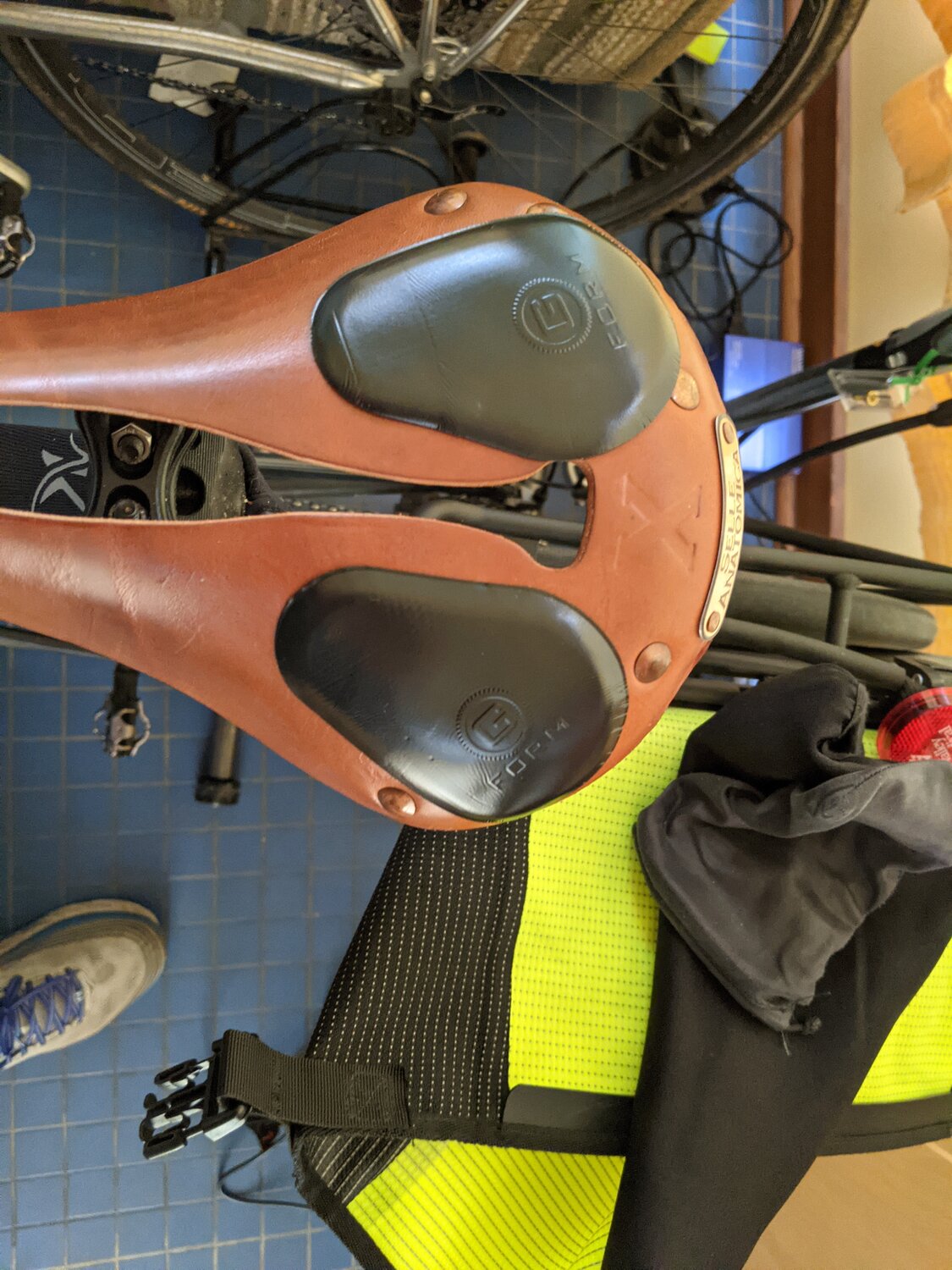

I have added these to my saddle. They are no longer produced by the company unfortunately. I have been all over Amazon looking for similar products. Some foot inserts are similar.
That's interesting Kahn. Were those made for the bike seat or you multipurposed? That's a fairly large cutout, didn't know they took up that much real estate. I've cut on a couple but not that much. I might even have one in there already cutout by the producer, I'll have to check. I found the cutout seats get a little floppy, takes good underpinnings to keep what is left in the proper order.
Selle Anatomica is the saddle. Those cushions were made for bike saddles. There was also a smaller coin size piece that you could stick to the one shown to give a bit more cushion. What was/is nice is that the material tapers down so it does not create a dramatic edge.
