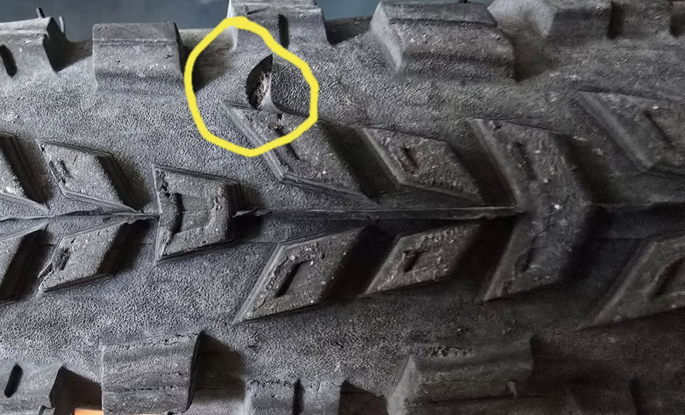

Here's how my rear Specialized Rhombus Pro tyre was cut on our ride in Bolimowski Landscape Park.
My brother suspects a shard of glass as the cause. He tells me to protect the tyre from the inside by an automotive tyre patch and special cement. Will do it! This tyre is too expensive to go to waste!

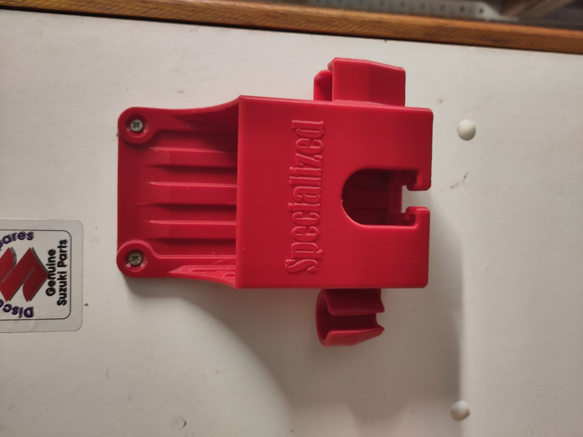

Last week I was due to go for a 30 mile ride so I decided to fully charge the battery on my Vado SL. Switched on the charger and after a pop noise it's completely dead. Checked everything with multimeter and new fuse. Nothing. The bike and charger is kept in a dry garage. The bike is standard not fiddled with. I contacted the LBS they confirmed the charger had expired. It's only 3 years old, I'm disappointed with the longevity of this device with a replacement costing me £95!
The LBS has raised a complaint on my behalf let's see what happens
I think specialised should back off from slim as possible and put some heat management in their chargers.
My Yamaha charger is larger, same charging current and is practically unheated after a full charge, the specialised is the limit of my heat endurance when held
I own two SL chargers. Both have worked for over 4 years now, no issue.
I own two full power Specialized chargers. Both have worked for almost 6 years now.
Electronics does break sometimes. I "love" reading comments like "Specialized should" backed with no experience.
TBH I hadn't thought about the overheating concept. My charger lived in this hanger even whilst charging. It seems that may have been the problem. Warning to others who may have one?
