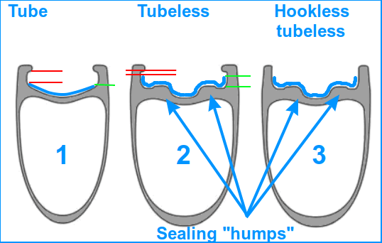

Like everyone - I've struggled with mounting a tire to a rim. I've learned one trick that has helped me. There's a small well (indentation) in a rim. Runs down the middle. After getting one side of the tire mounted, put that side into the small well. Seems like only a small indentation but if you can keep most of the tire in it, makes it easier to put on the remaining side. No soap. Just red hands.
Yes Karl! That is one of the good points to do. The part of the rim is called a "channel" or "well" I think. However, what Ollie Alex also said was: "Work slowly, in small increments. Hold the already inserted tyre bead with one hand and work with the tyre lever bit by bit on the other side". He also said "start opposite of the valve". My big surprise was the last piece of the bead jumped into the place with a minimal effort of my thumbs!
It was Alex!
Most rim types have that dent in the middle for exact that reason.
