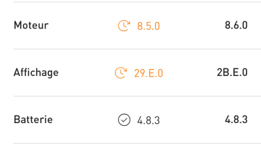

Do you know how to check the engine version and MasterMind version? I'm sure I was able to do it on my Como 3, because I had to go to the dealer to update it. But I can't find the version anymore (neither on my Como 3 nor on my Como 5).
The motor on the Como 5 is Specialized 2.2.
The Mastermind version is irrelevant.
@Palmthree: I read about riding hands-free (I never do it on an e-bike even if I could do it as a kid on a simple bike). Have you learnt the proper cornering technique yet? :)
I've got an update (for my Como 3) in february ; I had to go to a shop (and pay 25€) to upgrade my version (Motor / Display / Battery).
