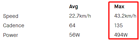

I am able to deliver so much power by doing so I simply disappear at distance -- without increasing the assistance! (On my last Sunday group ride, I managed the cadence of 135 but cannot maintain it for long).
My show. The power indicated here is the pedalling power.

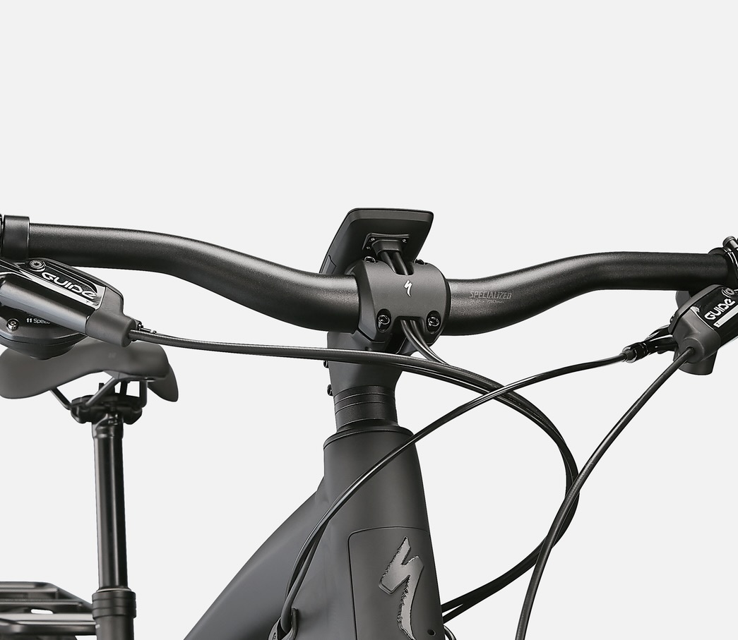

Well this is curious...

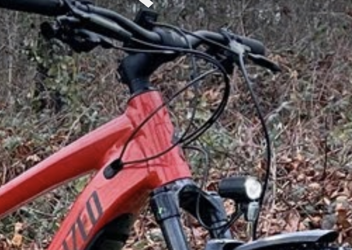

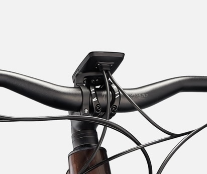

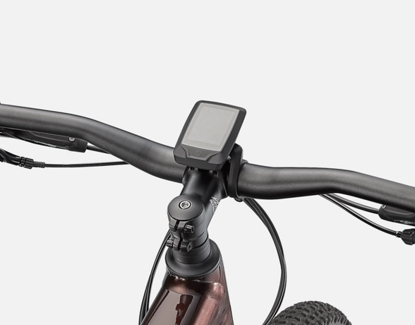

I watched the EBR Youtube review of the Tero 4.0EQ and it seemed like they have a different mount for the TCD-w.
The non-EQ models sold in the US appear to use the TCD MTB mount that attached to the handlebars, while this mount appears to attach between the stem and handlebar much like how the Trek/Bontrager Blendr system mounts attach. This new mount also appears to allow tilting up/down without any tools.
On the UK site they show the cables routing behind a one piece front handlebar clamp, though the video shows the cables outside the clamp.
It'd be interesting to see if they'd sell those bits to folks who didn't buy the EQ model.
It does seem a cleaner setup than the MTB mount.
Here's the review:
it’s a nice bike! but what a mess of cables 😒
Yeah, bad enough having two hydraulic lines plus shifter, but then you add the TCD-w wire to the motor, and the wire to the handlebar remote.
Then on the 4.0 EQ model add cable for the dropper seat post and wire for the headlight.
All sorts of stuff going every which way.
Not keen on the headlight-on-a-bit-of-wire contraption either, but since the EQ model isn't available in the US I guess I needn't be concerned about that. :)
and what is the one on the far right of the image, appears to go from the left shifter area directly to the fork?
View attachment 117773View attachment 117774
Here's the review:

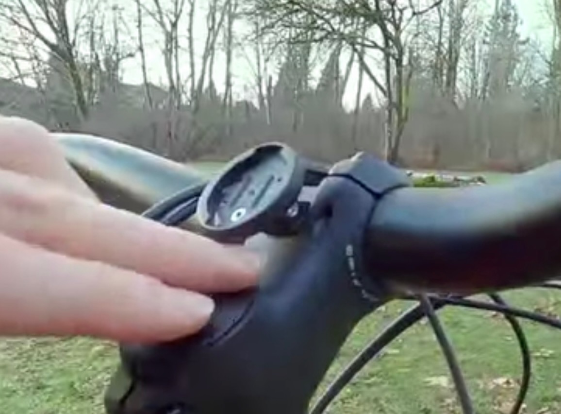

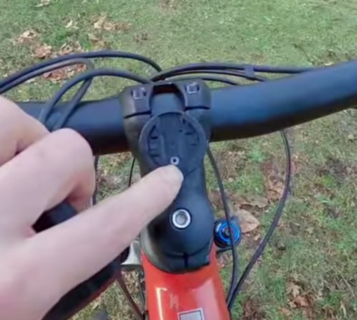

I have a couple of the stem/handlebar garmin mounts that I don't use. One was in the uninstalled extra parts from my 4.0 SL eq. Since I didnt know what it was I just used a regular garmin mount and I'm fine with that. The second came with my Tero. They did put the mtn bike mount on for the Mastermind but also included the stem mount in the extra parts. So I don't use that one either. If you want one of them, let me know and I can mail them to you.
Sounds like the mount is interchangeable with Garmin quarter-turn? Interesting…
i appreciate your very kind offer. I’ve not yet purchased an ebike, though, so I’m unsure how I’ll outfit it.
Yes, Specialized uses the same mount for their handlebar computer as Garmin
Since the bike may come with both the stem and handlebar mounts you can probably tell them how you want it when you order it. Agree with you that the stem mount with the cable routing looks much cleaner and I may swap mine in that way.
