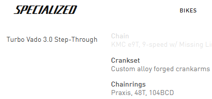

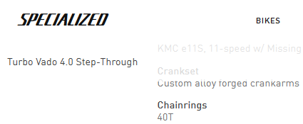

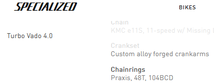

I think Court didn't check and was going by the spec sheet. Here's what it shows on the U.S. Specialized site for the three 2022 Vado bikes mentioned:
Factoring in the comparisons in the pictures of the bikes and the Polish site specs saying 48T for the 4.0 ST, I think the U.S. site is in error and that it's actually a 48T on the 4.0 Step-Through. But I can't be certain.
I stopped by Work Horse Bicycles in Monterey, CA, on Sunday, February 27th, and they had two new 2022 Vado 4.0 STs on the floor - and both had the Praxis 48t chainring on them. I doubt the shop would change them out so I think the only reasonable explanation for why both had the larger chainring is that the spec sheet is wrong.

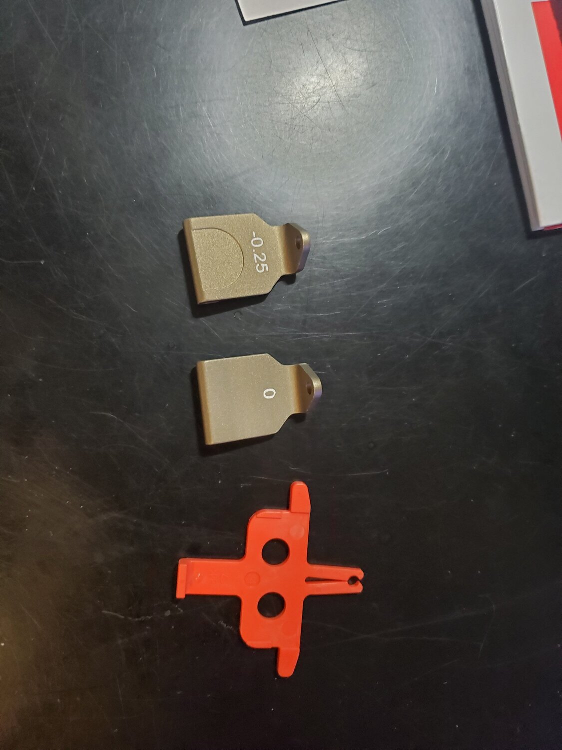

Thank You Stefan and thanks for the response on my introductory post as well...I will get some pics soon. I hear what you are saying on the weight distribution but my back and wrists won't allow me to hunch over too much so I tend to sit more upright, will change the seat if need be for more comfort in that area! Meanwhile I wonder if anyone can tell me the purpose of these 3 tools that were in my parts bag? Thanks and now on to my lock and alarm research!

I think the bottom one is to place into the disc brake caliper to prevent them from locking closed if you remove the wheel. If you inadvertantly grasp the brake levers while working on the wheel-less bike, the brakes will close and have to be pried open CAREFULLY. The spacer prevents that. At least, that's what I was told. Haven't seen those others.

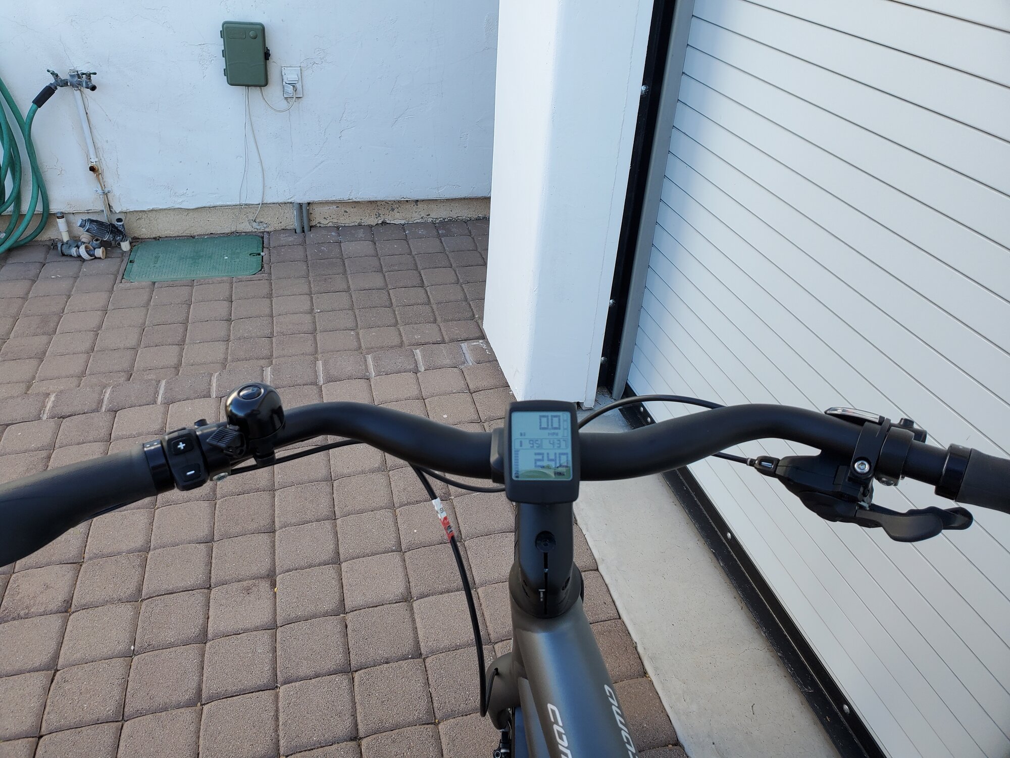

Really enjoying the new Como, I don't want my ride to end! Does anyone know if there is a way to customize the display so that everything you want to see it on the same screen? Right now I have to change screens to see what I want, there are 4 items per screen so when I'm on MPH I also get stuff I don't need like Max MPH etc. I'd like to be able to see current speed and trip ODO on the same page. Maybe I'll be able to do it once I download Mission Control?

From the docs with my wireless version, the display can be changed although pressing and re-pressing those awful buttons is not something I feel like attempting.
@bigb : Download Mission Control. Connect it to your Como. If it is anything like my Tero, then select Tune>Customize Display. You will be presented with several customizable formats. showing up to 6 items at a time. Screens can also be added.
I just want to mention the number of data fields per a data page is limited by any cycling computer. The reason is good visibility on a small surface of the display.
^This
It looks as if @bigb wants to edit the display pages of the TCD, the small computer shown in his picture. While Mission Control can also be altered to display other things, some folks keep their larger phones off the handlebars.
I hope this link works
I think that there are youtube videos, too.
You are totally right @kahn! I didn't look at the picture from @bigb as it didn't display at the time I read his post.
To explain: the Como display of @bigb is Generation 1 TCD-w. It is highly customizable using the display buttons but it has a limited set of data fields per data page.
@ReedM has Generation 2 TCD-w which is customizable from Mission Control and allows up to 6 data fields per data page.
