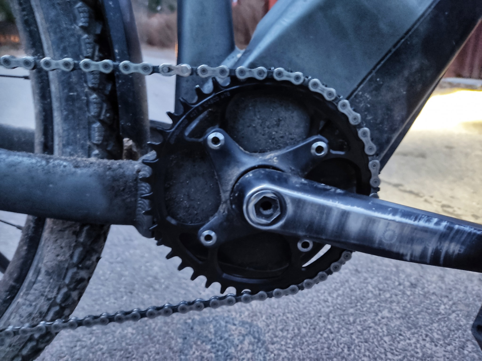

Garbaruk 42T chainring installed! Since I had been swapping chainrings on my Vado before, it was a fairly easy work. Moreover, I didn't need to replace the chain! The one I have installed is 124 links; it was a tad too long for the old 38T ring, and is within acceptable limits for the 42T one!
I even could re-use the existing 8x8 mm steel chainring bolts. My Vado can still accelerate perfectly, it is still a great climber but it is easier for me to get on a higher speed now. I expect I would be riding in lower gears now, which is good for the cassette longevity.

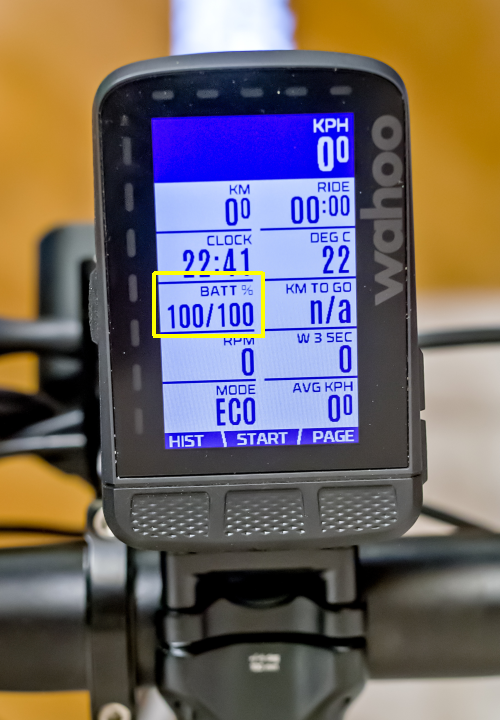

BikeOn, the way of reporting of the combined battery charge (as 150%) is the most confusing for me. Both Wahoo ELEMNT (and I think Garmin Edge too) as well as BLEvo app give individual charge for each battery. It is very clear and helps planning the battery strategy easier!

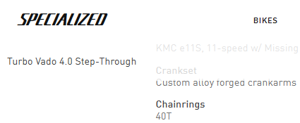

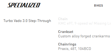

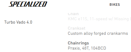

In reference to the new 2022 models of the Vado, I see the new EBR review of the Vado 4.0 Step-Through says it has a 40T chainring. Court even states verbally that it's a 40T. Specialized's website confirms that. Yet, the Specialized website says the Vado 4.0 Step-Over has a 48T chainring, and the Vado 3.0 Step-Through has a 48T chainring. It doesn't make sense to me why that one model would be different than the other two, and the pictures don't look like the chainring in the 4.0 Step-Through is any smaller that those others with the 48T. It makes me wonder if this 40T info is incorrect. Anyone know for sure?
that is odd. there are a number of differences in those bikes; the 5.0 models having a 48t makes some sense since they have a 20nM torque advantage, roughly proportional to the 40/48 difference. the 4.0 step over being 48t is mysterious, and the 3.0 is a 9 speed alivio drivetrain, even less torque (50nM) so no idea why that one wouldn’t have the 40t. perhaps the expectation of not doing any heavy duty climbing?
or, it’s a mistake and they’re all 48t. the photos (or are they renderings?) on the specialized site clearly show the same size chainring (or within a very small margin, not as much as an 8t diff) for the 2022 4.0 step through and step over.
Which is amusing, as the Polish Spec website gives this information:
I have checked it carefully: it is the 2022 model with Mastermind.
And Court shows the same e-bike (U.S.) and confirms it is a 40T chainring there.
If someone's not wrong, I would attribute this oddity to the known phrase "*Specifications are subject to change without notice" :) What is especially interesting there is the Euro version should come with a smaller chainring than the U.S. variety. The reason is, Euro e-bikes are restricted at 25 km/h and simply do not need a large chainring; a smaller chainring would improve the climbing properties of Vado in turn.
Strange.
I think Court didn't check and was going by the spec sheet. Here's what it shows on the U.S. Specialized site for the three 2022 Vado bikes mentioned:
Factoring in the comparisons in the pictures of the bikes and the Polish site specs saying 48T for the 4.0 ST, I think the U.S. site is in error and that it's actually a 48T on the 4.0 Step-Through. But I can't be certain.
