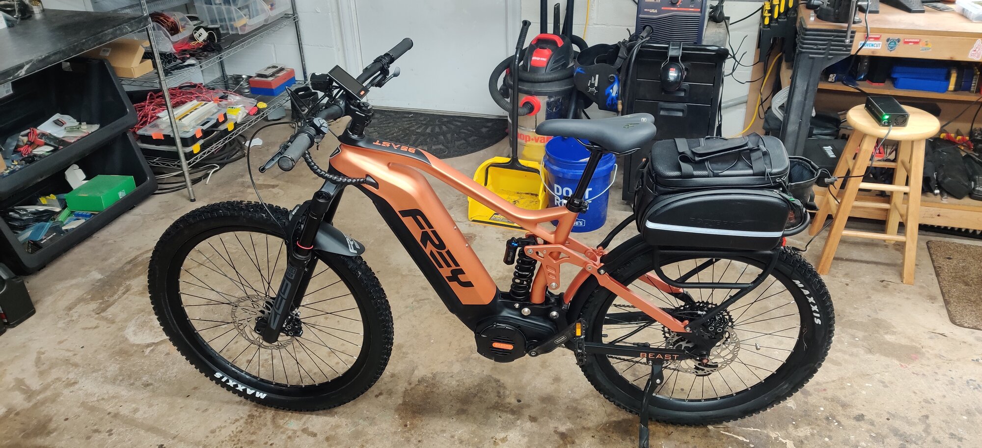

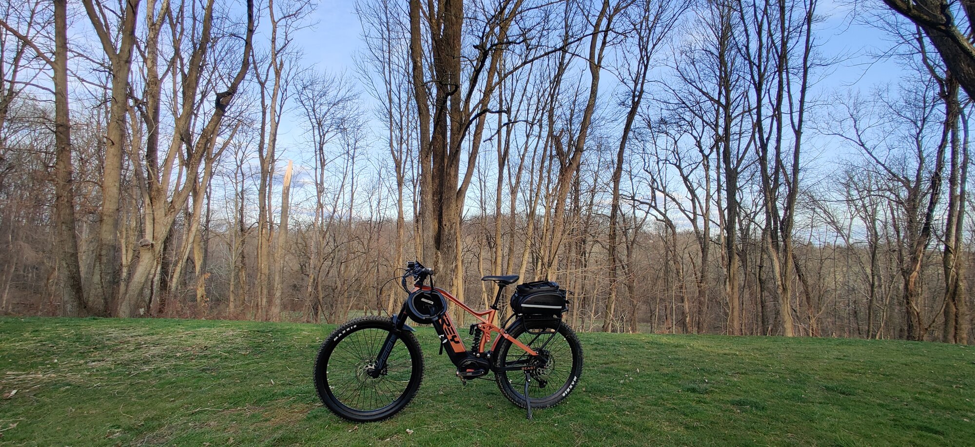

Hey Frey folk, I made an introduction post in the at subforum, but figured it would be create a thread here if anyone has any questions. There wasn't much material or videos available when I purchased mine.
It has been such a blast. I live in a rural area, so there are so many places to ride, including my property. I find that I rarely need much petal assist, this thing has so much torque!
I've gotten it pretty filthy a few times. I am also new to mountain biking in general. I haven't had any issues, but I'll try to add my experiences to this thread. I also plan to make a couple videos eventually since there isn't much on YouTube.

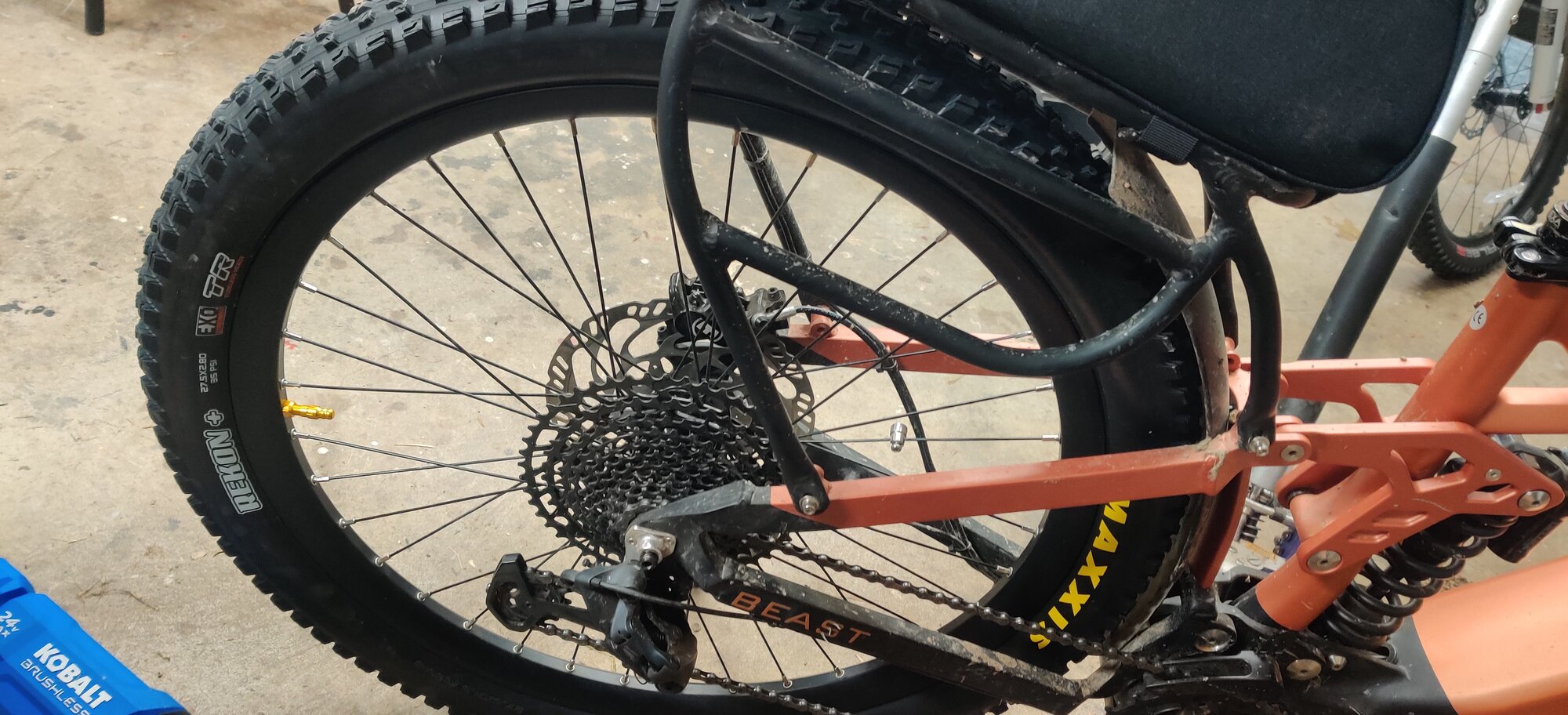

Thanks for your replies. I´ve been considering getting this bike, but the possible lack of mudguard mounting points (I live in Finland where mud is constantly present) and possibly annoying motor whine have made me reconsider. I know you´ve had yours only a short while so you probably can´t comment but another thing that I wonder is how does the drivetrain take all that massive amount of torque ( was it 160 nM). I mean would I need to change the chain and the cassette every 1000 km
I did just change my chain, I have about 800 km. I really beat the crap out of my chain though, before I got the hang of what I was doing. I also crashed pretty good, no issue except bent hanger that I had to fix. The motor is almost silent depending on on PAS and gear... and I think the torque of the motor helps. When the RPMS get going on the motor, then you hear it much much more.

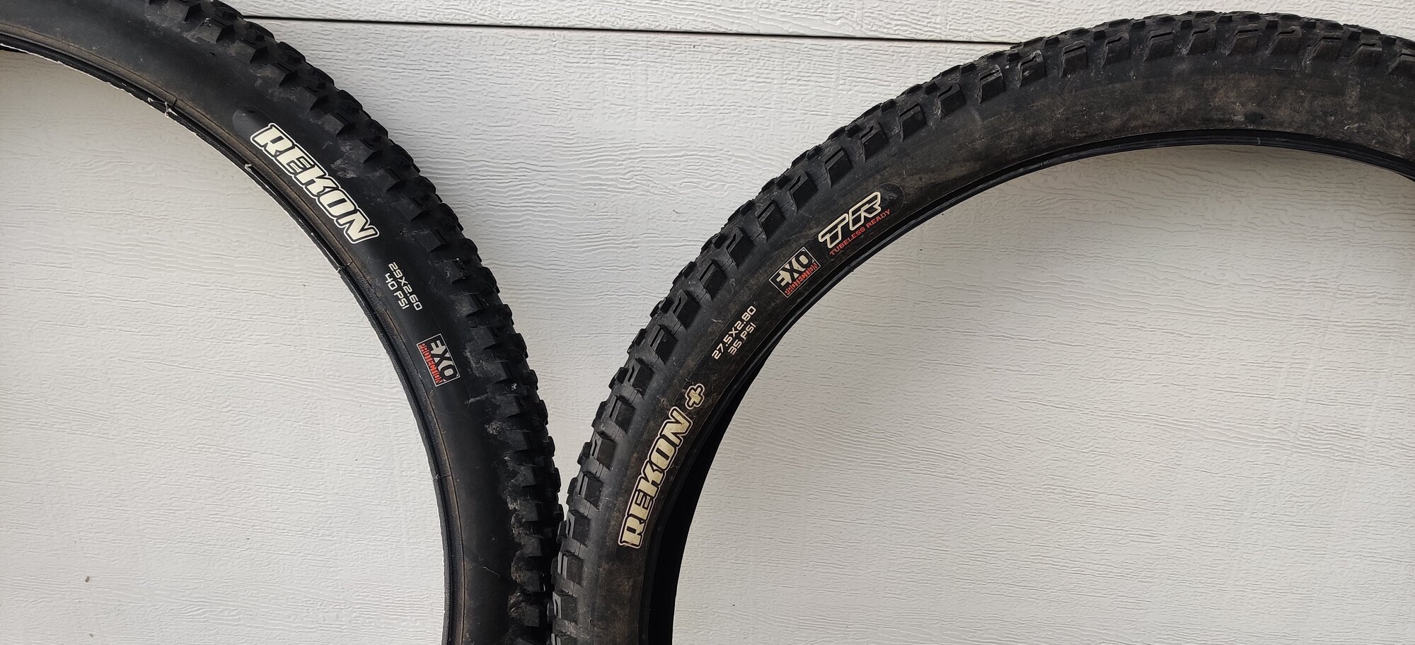

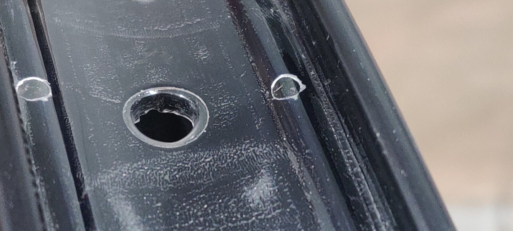

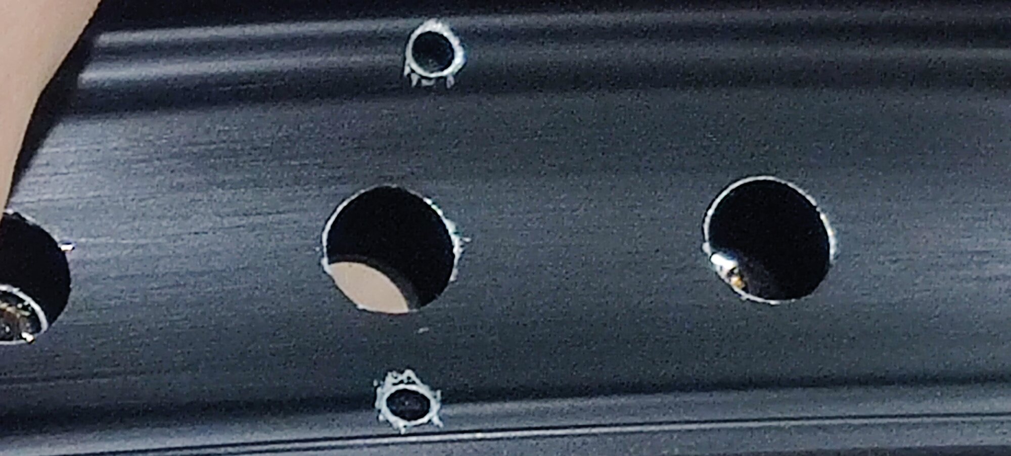

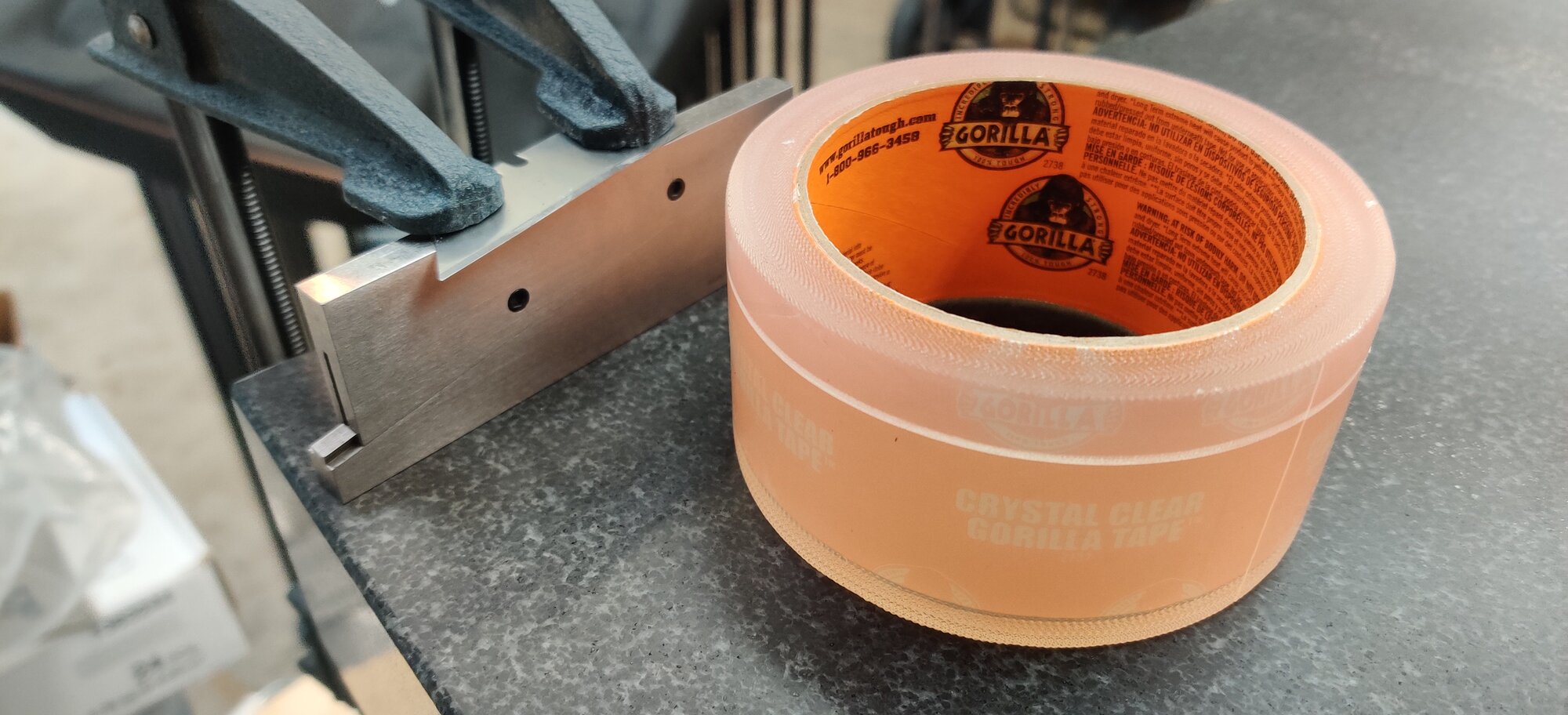

Update... After many punctured innertubes, I decided to go the tubeless route. I ordered 34mm WTB tape that I believe is just rebranded Tesa tape. After some research, I decided that 38mm would be better since there are holes near the edge of the rim, see pictures. I bought Gorilla Clear tape that I see recommended and cut it to size (see pics).
It would have been nice if I noticed that my front tire was NOT tubeless ready... so I'll have to wait a week for the Maxxis Rekon+ 29x2.8 EXO/TR that I ordered (wasted 120 ml of Orange Seal Endurance too, lame). Does anyone recommend a better tire? I went through 4 rear tubes and 1 in the front with the as equipped Rekons. I did miss a thorn that got me twice, but the life of the tires isn't impressive (to be fair, I don't have any frame of reference other than box store cheap bikes). The rear tire was beat up with quite a few tears (I do not ride on any crazy trails either, usually riding with my young daughter on her Woom Up). Speaking of the Woom Up, it has Schwalbe Rocket Rons and they have had zero issues thus far.

Deburring the outer holes, not sure why they would put holes that close to the sidewall.
Melting the tape for the schraeder valve hole.

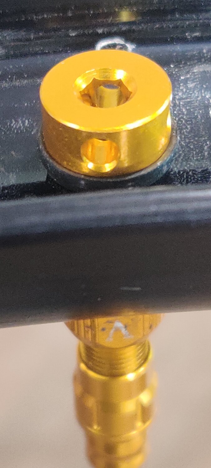

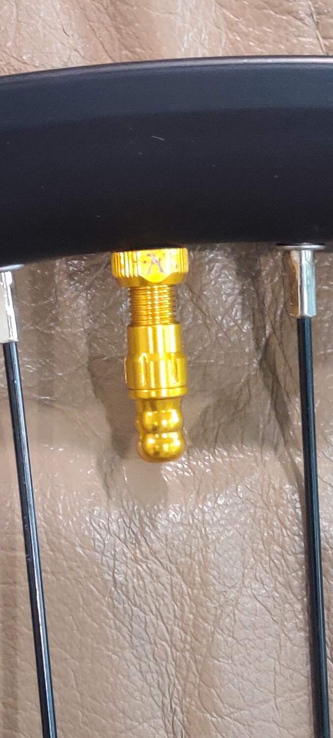

Shraeder valves with de-coring tool cap, from Amazon (VeloTubes Premium 44mm)

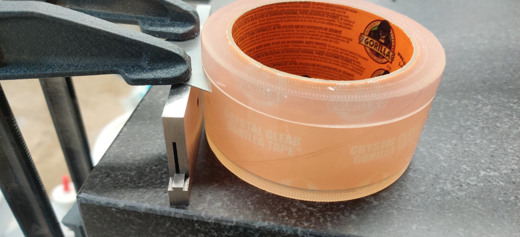

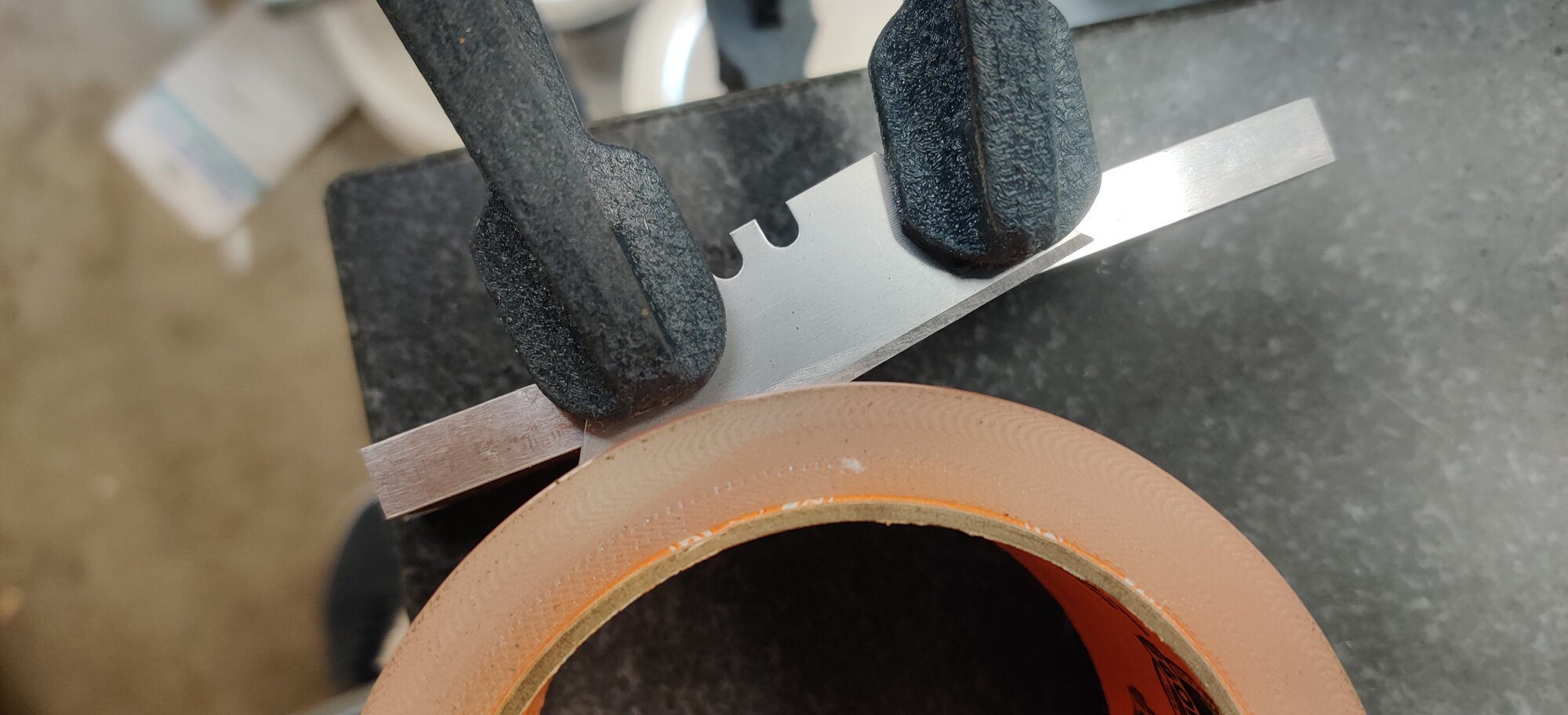

Here is my death contraption to cut the tape to size. It worked great, but I also took care to not put myself in slicing danger by dragging the tape parallel to the blade. This way, if I slipped, my hands came towards me and not the blade.

Edit: here are the original tires:

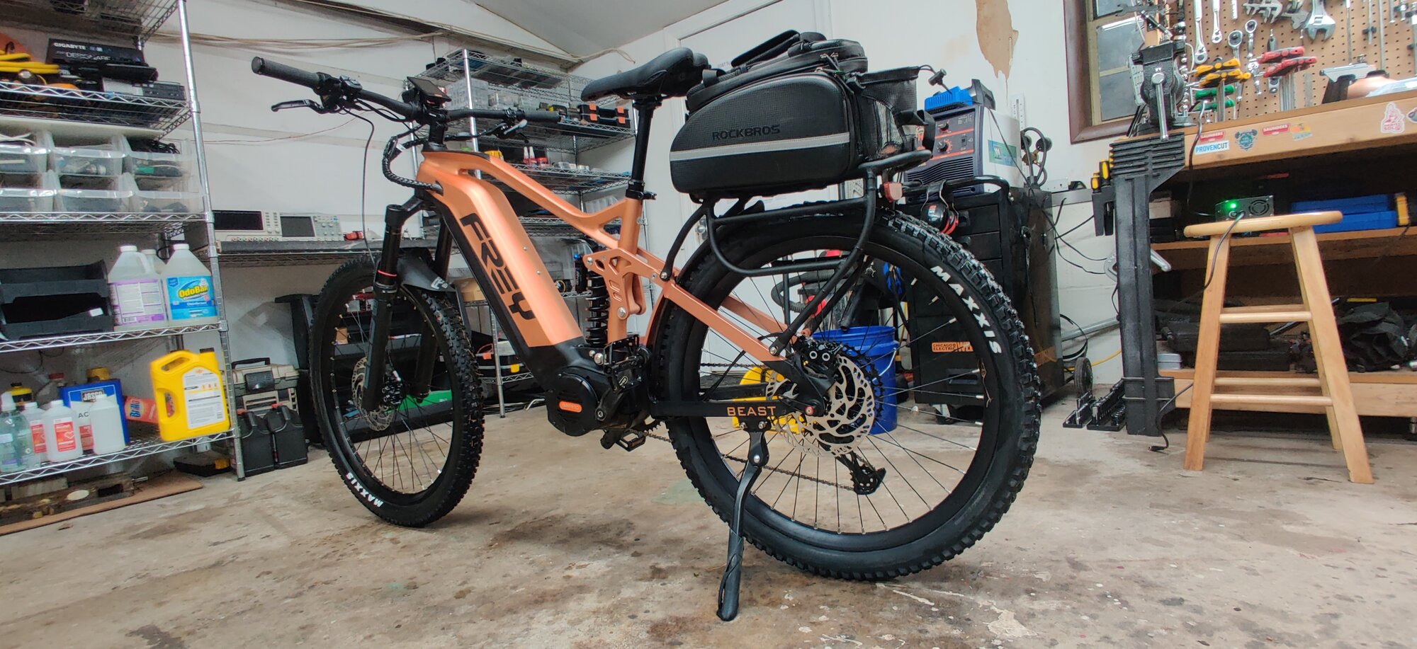

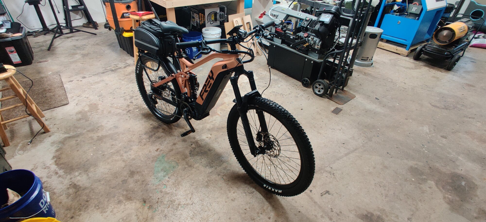

It appears your left hand brake lever activates your front brake, not your rear brake. Did you swap this over as this is different to mine?
Also your stem has 3 spacers under it, whereas mine has five. Perhaps due to a frame size difference - mine is XL.
I do have a Large size frame. I did not swap my brake levers, it came that way... That's typically how they are in the US, right=rear brake (by law maybe).
