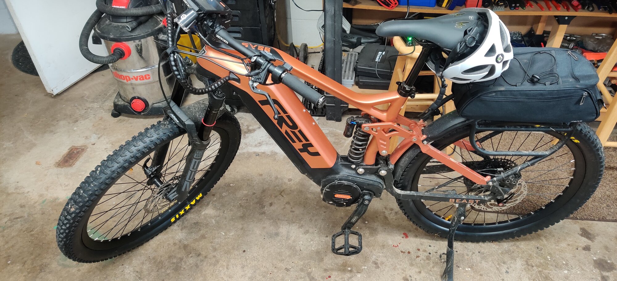

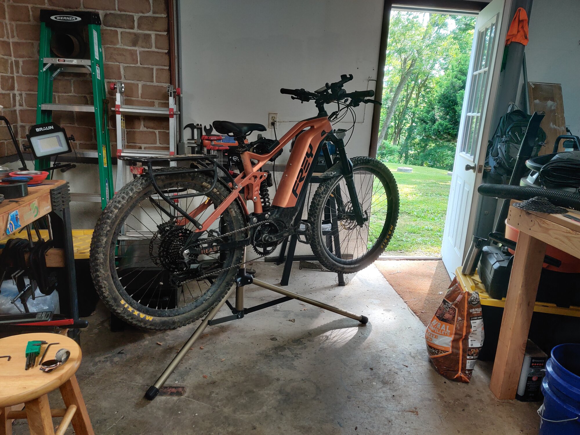

So far, lots of fun with my Frey Beast.
I do have a Large size frame. I did not swap my brake levers, it came that way... That's typically how they are in the US, right=rear brake (by law maybe).
Interesting as I wouldn’t have thought it mattered, but must have something to do with the side of the road you ride on which is the opposite side to the land down under.

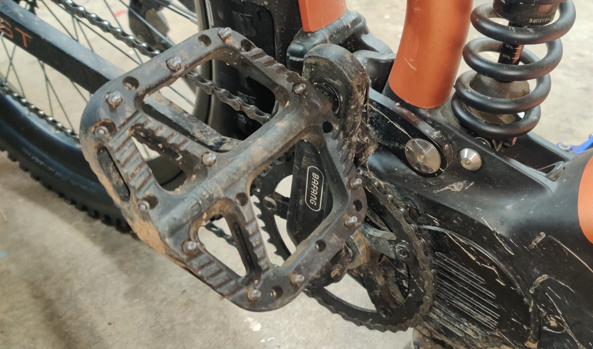

I ditched the stock pedals for some OneUp Composites. So much better grip... And yes, I have already smacked one of those huge spikes into my shin jumping some ramps with my feet not set correctly (stupid mistake). Worth it though.
Yes, I need to wash my bike, I'm a bum.

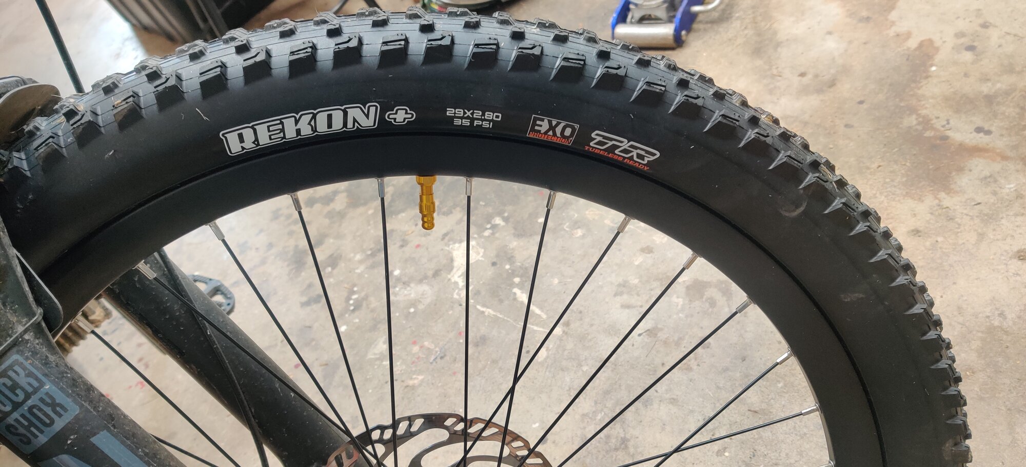

The new Rekon+ EXO TR front tire is on now. I had air leaking at the rim seam so I re-taped it, this time going 42mm wide so it was under each bead hook. Let me tell you, the clear Gorilla tape definitely leaves a residue, and the rim was is in my hot garage for a while too (usually softens the adhesives). It was fairly easy to scrub off with a scrub brush and some Zepp floor stripper concentrate that I had on hand, about 10 minutes. Needless to say, I order some Whisky tape 45mm wide to try next time. It has held air overnight so that's a relief.

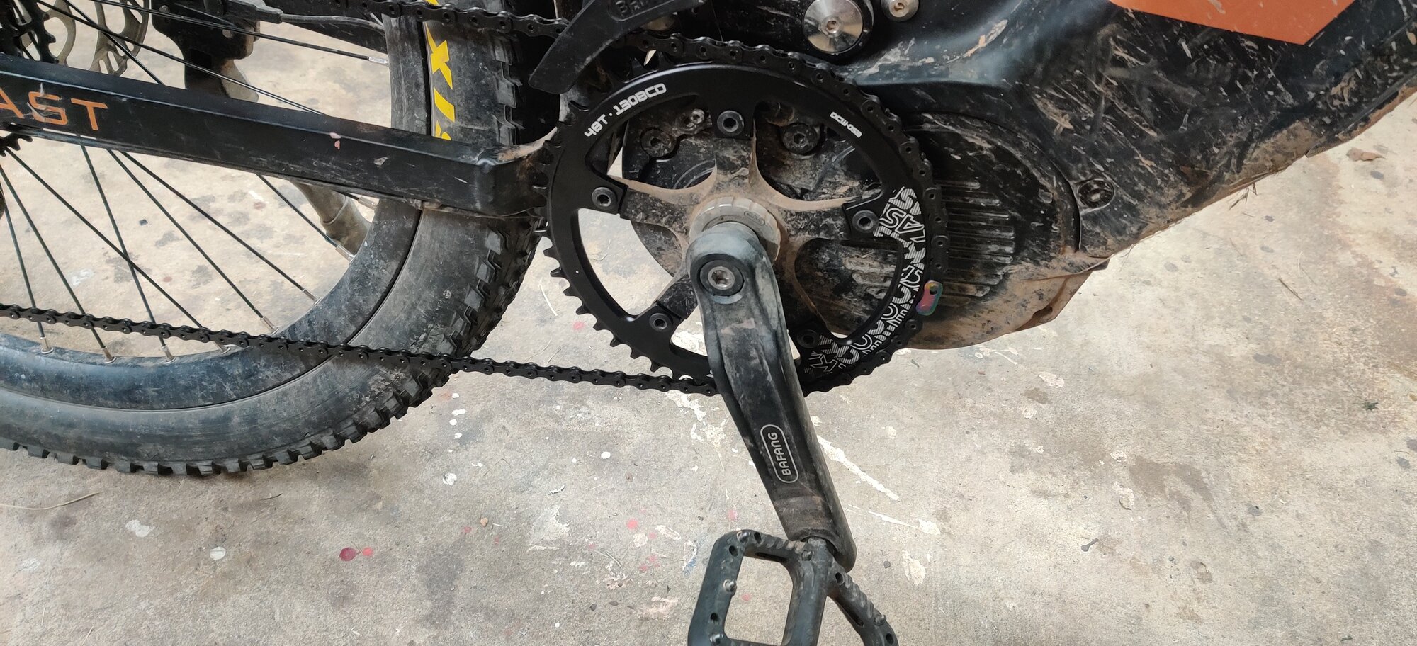

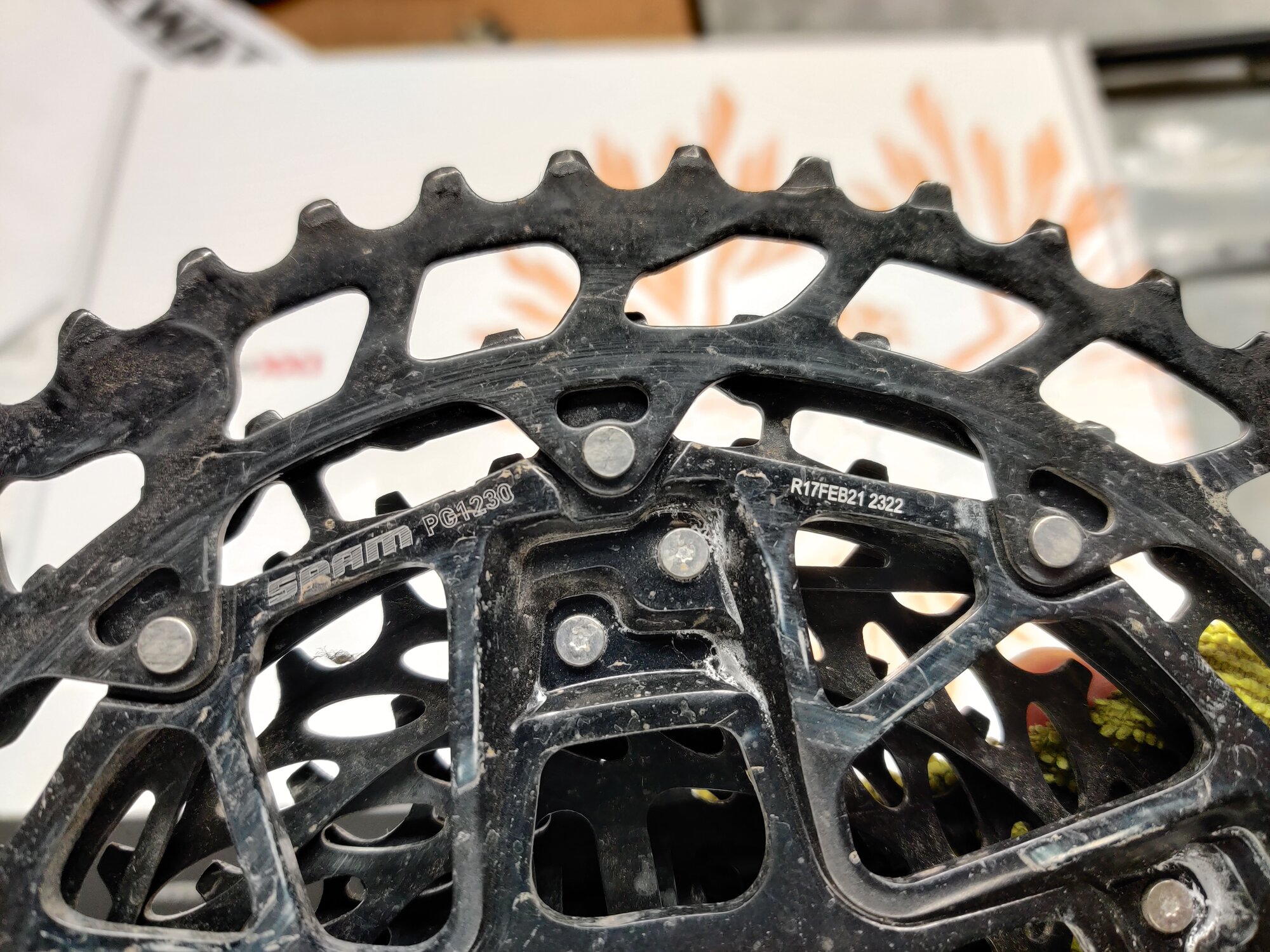

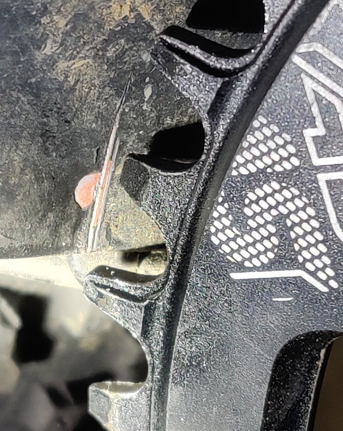

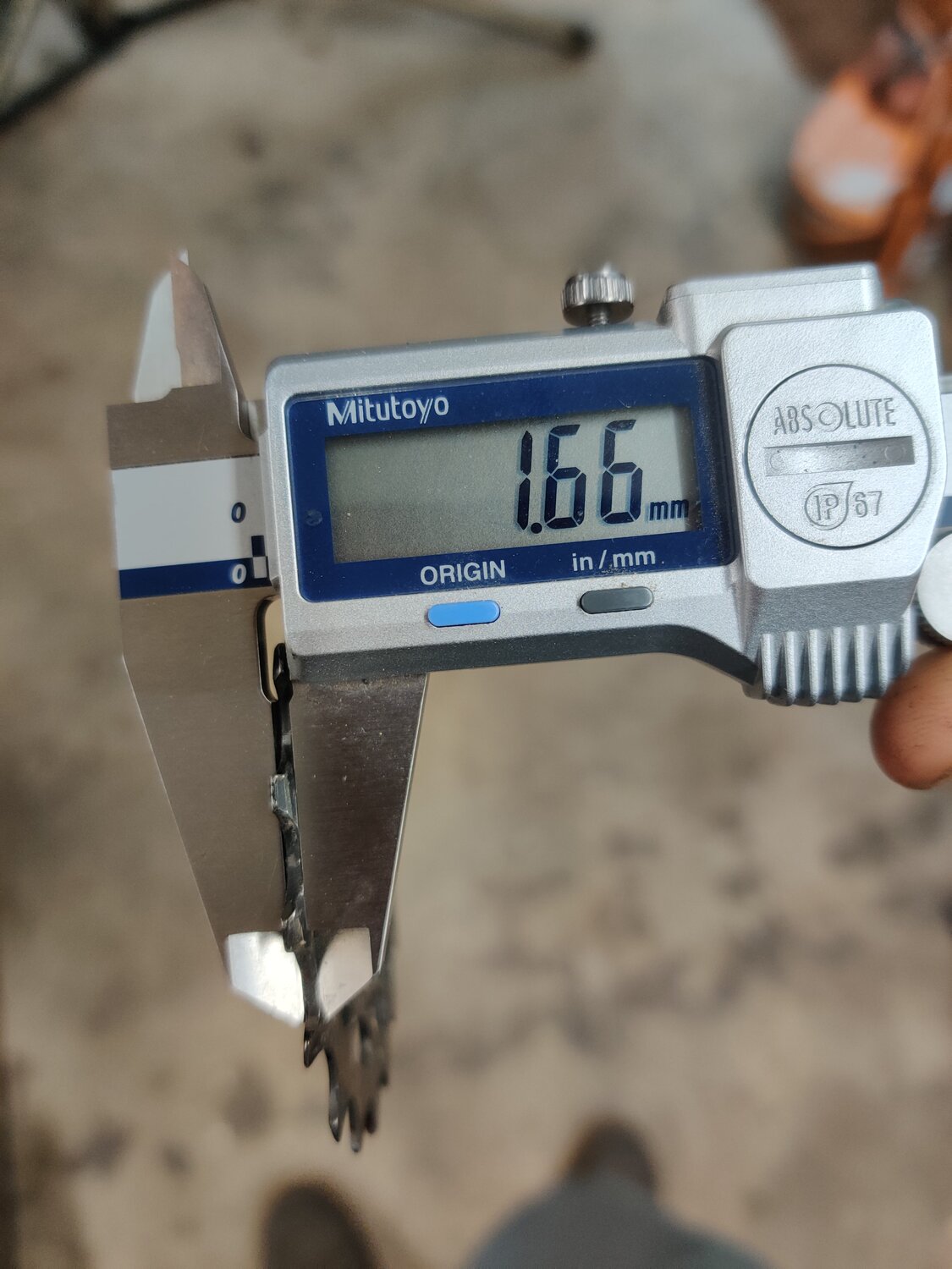

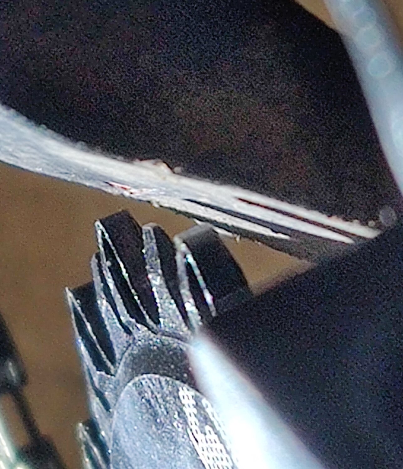

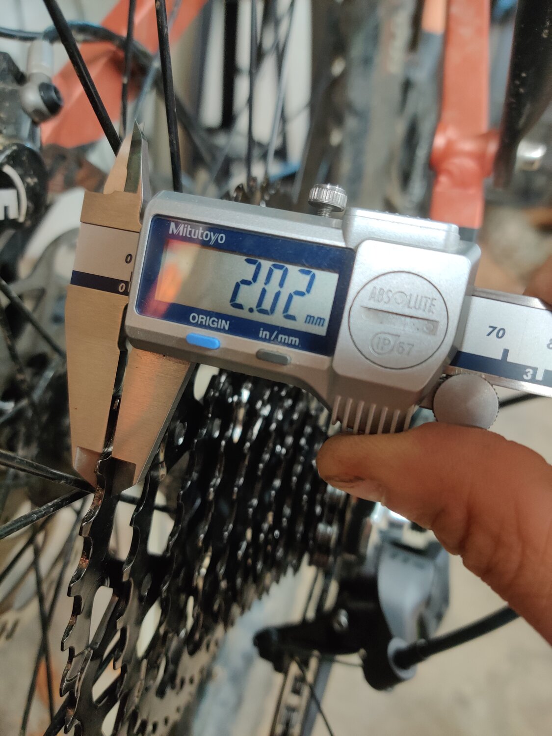

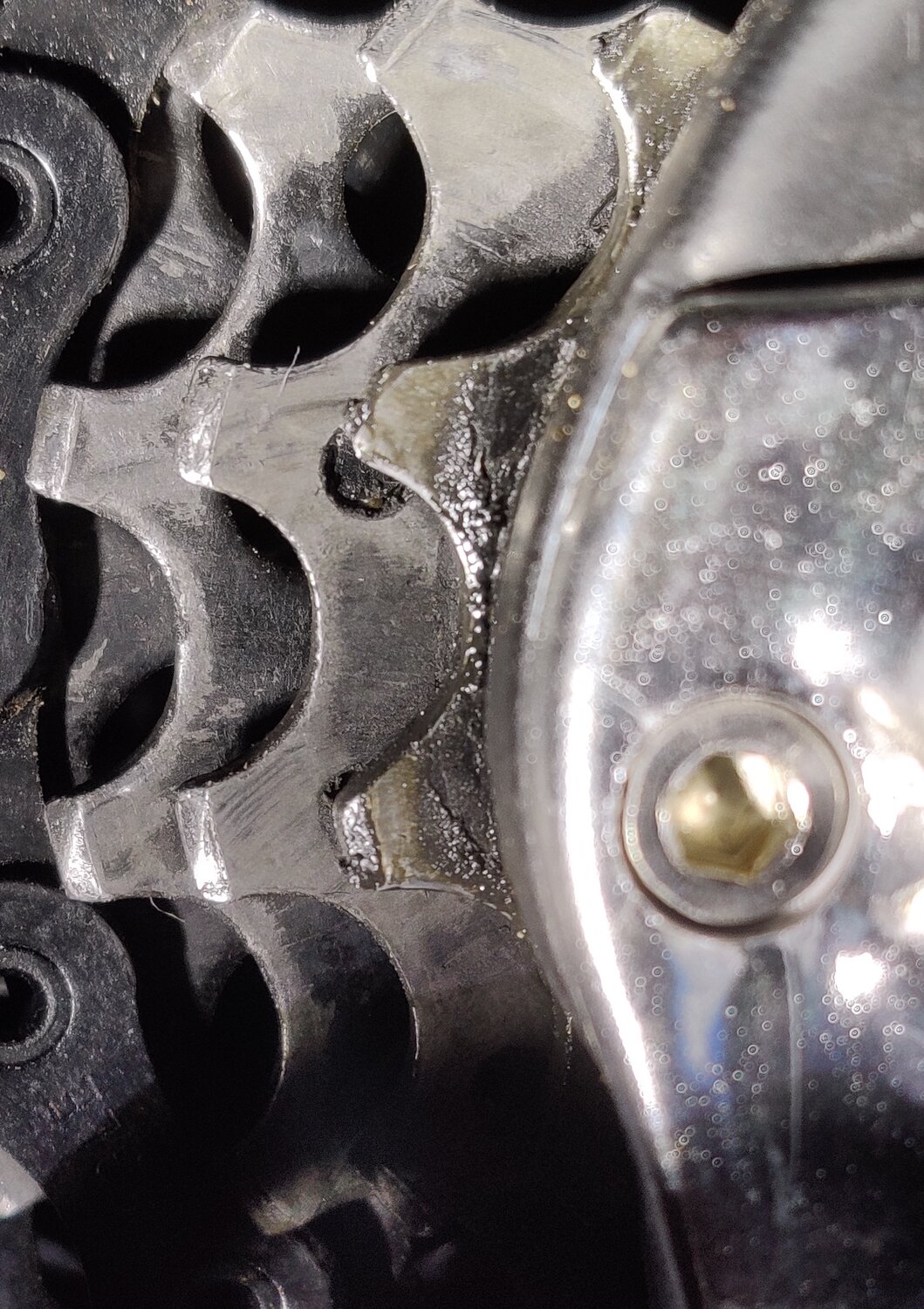

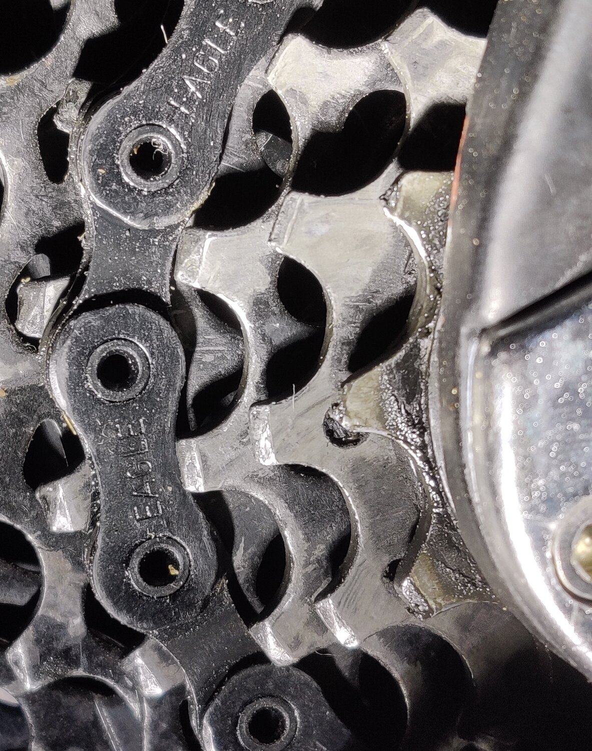

I joined the 48T front chainring gang (I don't notice much of a difference?!? I noticed mine barely rubs the triangle when removing all load from the suspension)... Replaced my chain with an XX1 variant. I think I've chewed up my high gears on the cassette, they skip now with a new chain. The form doesn't look bad, but I'm no expert. Hopefully this weekend I can go double check chain length (added 4 links) and derailleur adjustment to fix. I ordered an XG-1299 XX1 Eagle cassette just in case.
I find it difficult to get the cable tension correct for the derailleur... I've been thinking about going AXS. Unfortunately, this is not a UDH setup, so no T-Type unless the hole is opened up, which would weaken the mounting point somewhat. I need to check the SRAM docs to see if there are any guidelines for the minimum material. I will probably just get the older non t-type if I go this route.
I resized my chain today, and adjusted my derailleur... It was a bit of wasted effort as a better inspection of my cassette revealed some nasty wear on the smallest sprocket (though, I see this form on some new Eagle cassettes too ???). I do have it shifting quite smoothly, just in time to replace the cassette. I also snapped some pictures of the 48T chainring clearance. Under gravity alone, the chainring does not rub, with a rider, there is plenty of clearance. Lifting the bike in the air allows it to very barely rub (maybe 0.1mm).
I don’t have the rubbing issue with the Wolf Tooth chainring, so I suspect the offset is slightly different?
Is your chainring steel like stock or Ali?

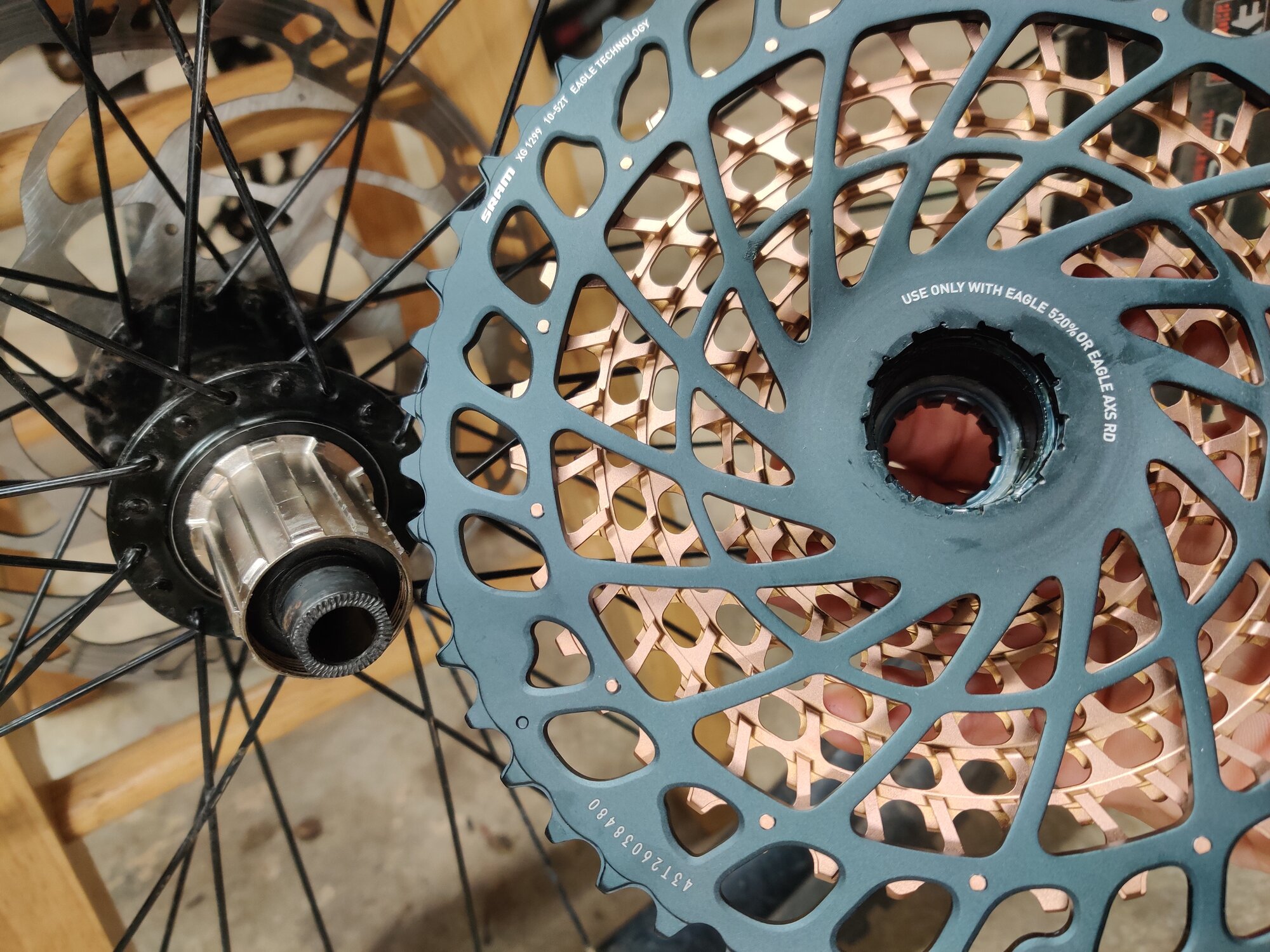

Thank you for the info. I went to mount my XX1 cassette, and low and behold I have an NX cassette, which uses a different driver (Shimano HG?). I need to order a Sram XD driver to finish the swap. I'm sure it seems like I have more money than brains at this point, but in reality I have little of either.

I don't know if I'll be able to find a freehub driver to fit the quanta hub, I bought one that is close, a bit too large, and may machine it to fit the pawl diameter.
In the meantime, I purchased another NX cassette and tuned the derailleur. Riding great again.

As I've educated myself on drivetrains and started a DIY build, I feel kind of silly ordering the XX1 cassette without understanding the freehub style. Regardless, for my type of riding so far, I make zero use of the most of the lowest gears (big cogs). My DIY bike is a 9 speed (cheap L-Twoo A5) using a Toseven DM01 motor.

I've ordered a 44 tooth chainring. There's no offset on my 48T (or stock steel), but it does rub when the rear triangle is fully relaxed.

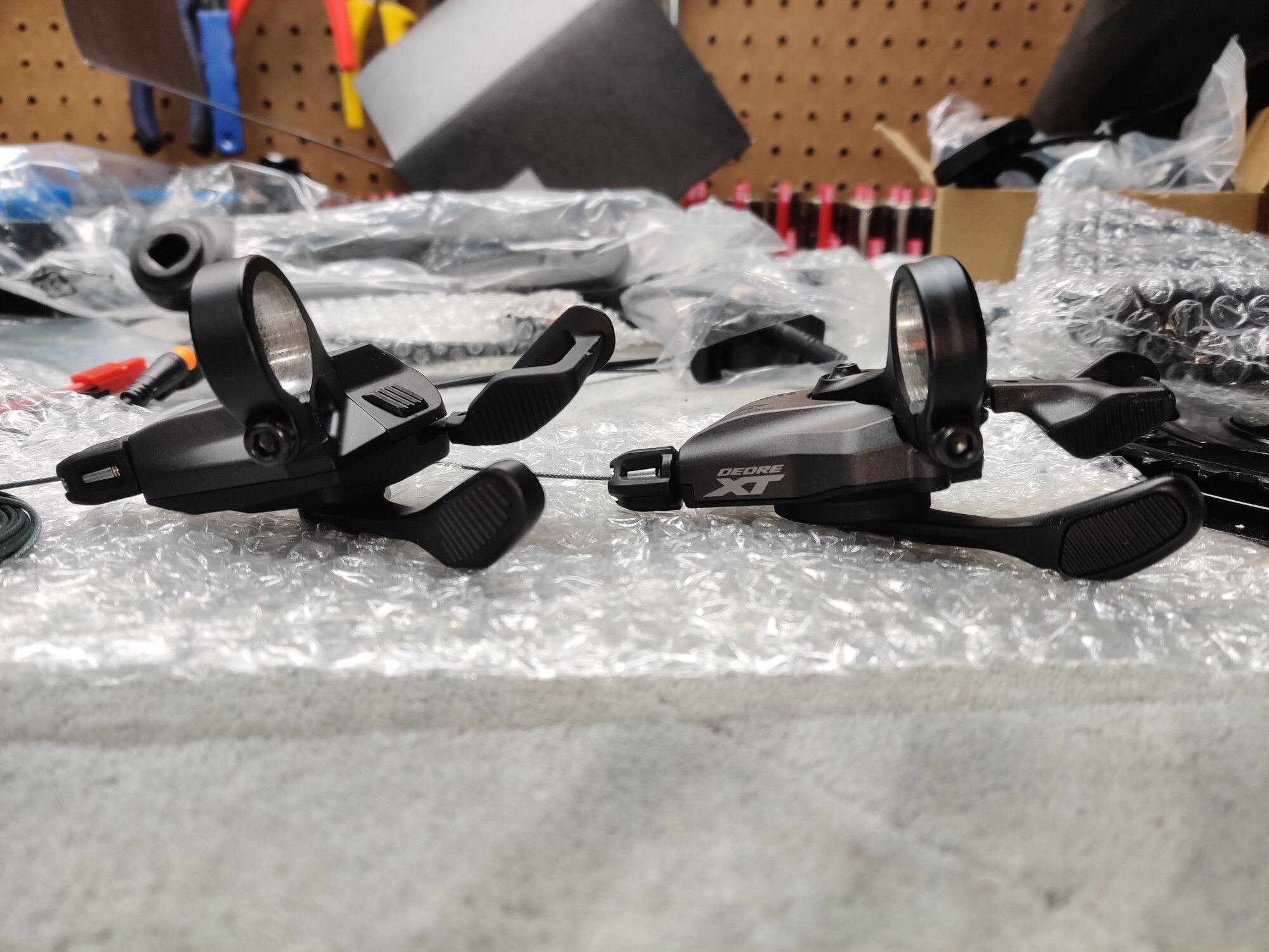

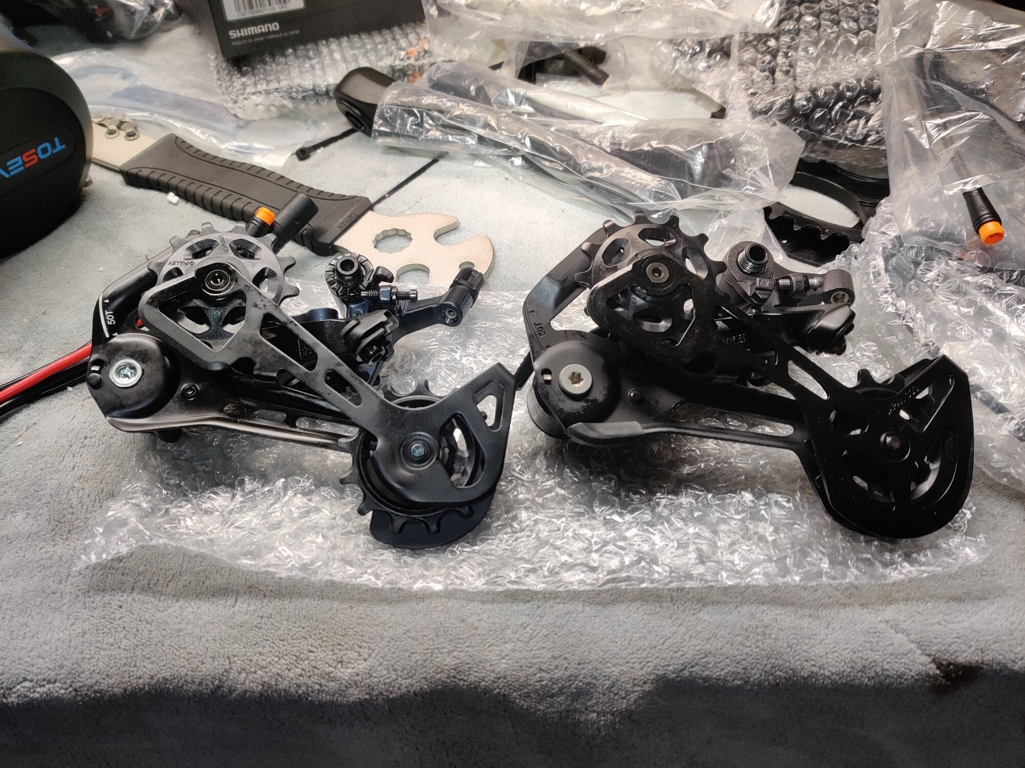

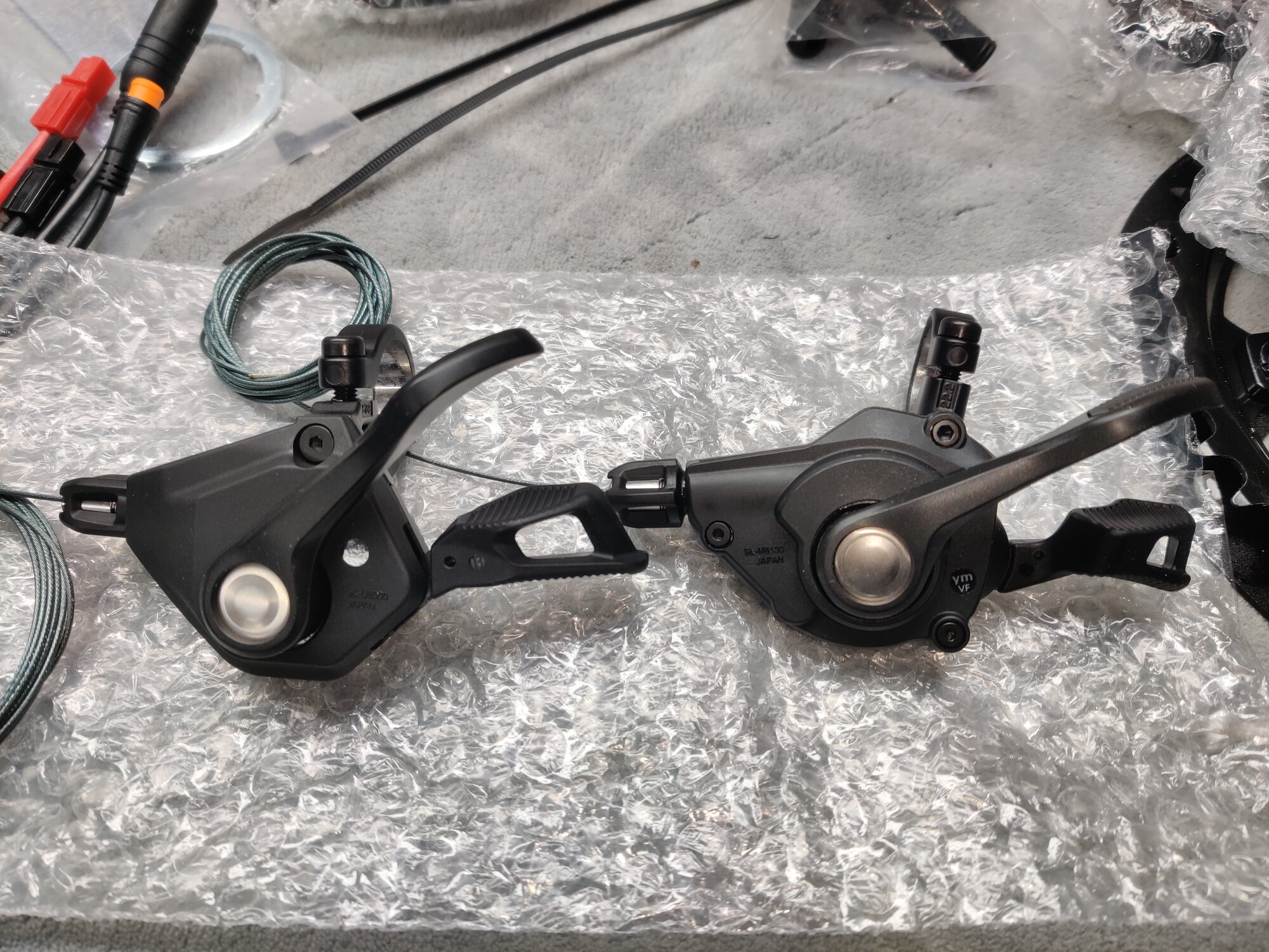

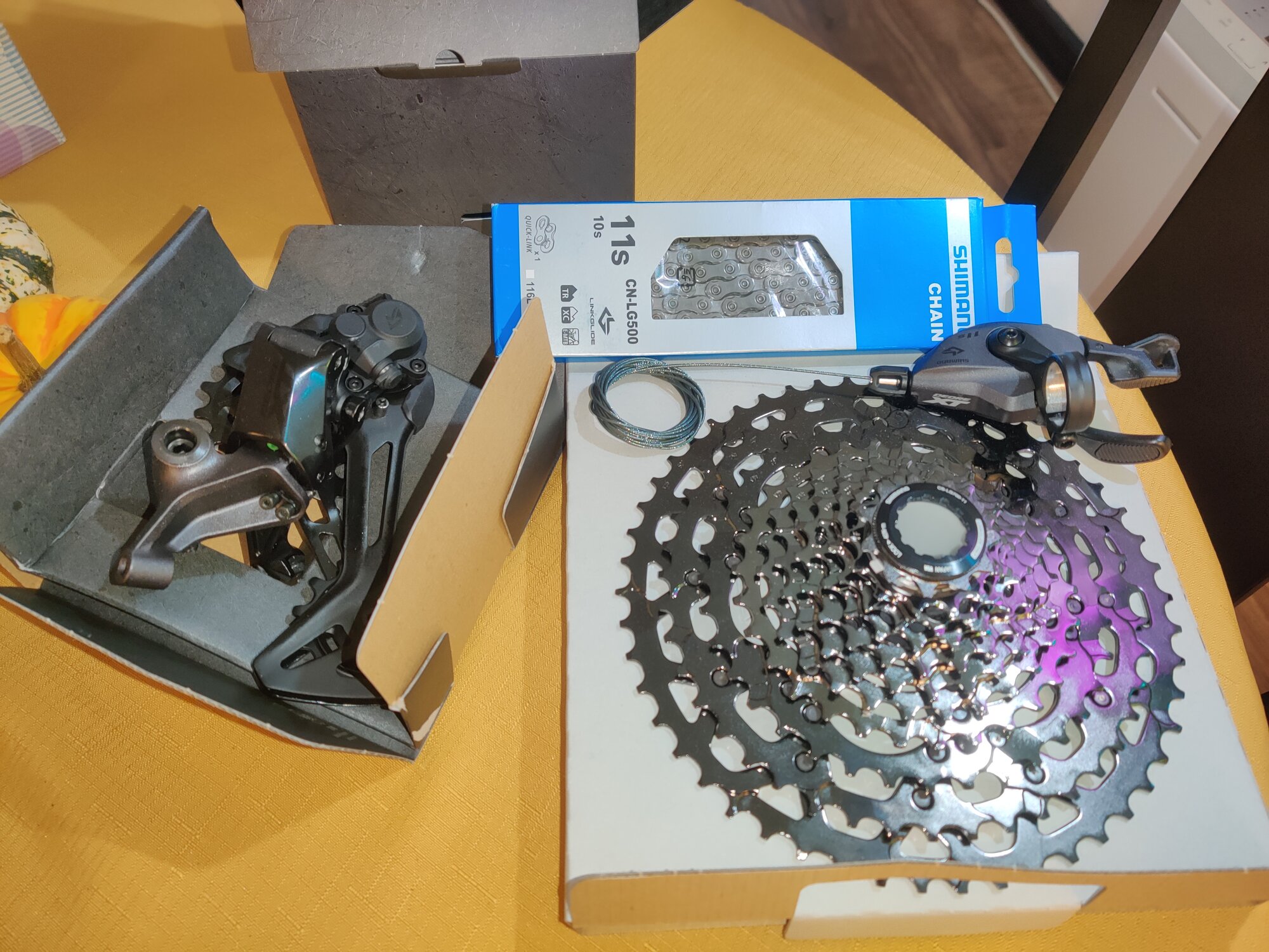

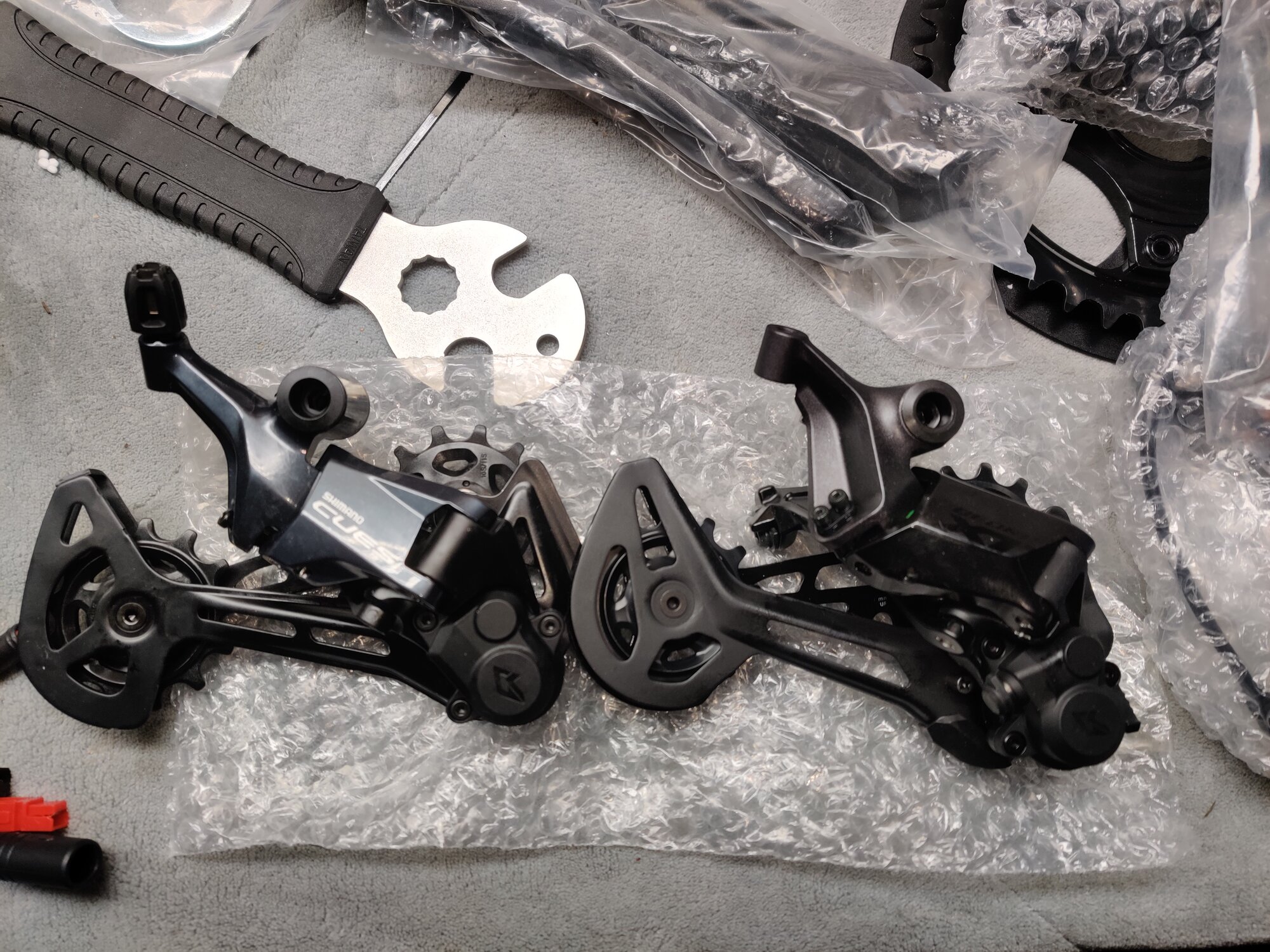

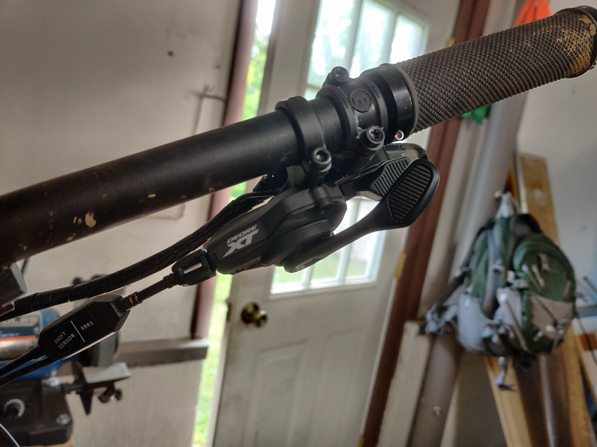

Ok, I took the plunge on Shimano 11 speed link glide.
Parts:
  • Rear derailleur: Deore XT RD-M8130-SGS.
  • Cassette: CS-LG700-11.
  • Shifter: SL-M8130-R11.
  • Chain: CN-LG500.

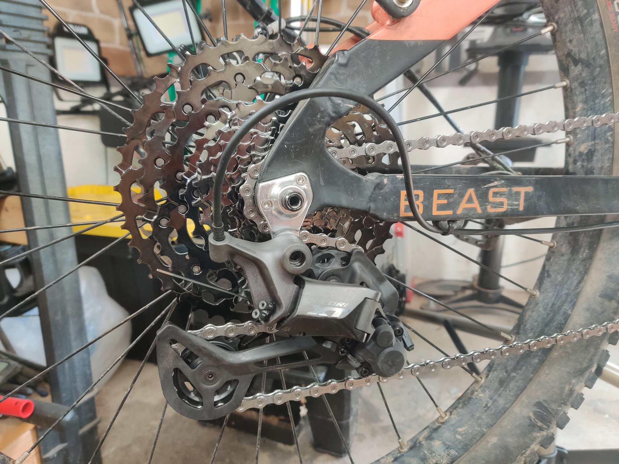

Since it makes the most sense to wait until I wear out the NX cassette before swapping, I will probably not end up waiting 🤡. Let's see if I can hold off for now. I still need my new cable housing anyway.
Edit: it came with some cable housing 😰.
Here's a comparison of Deore XT 8130 and Cues U8000 for anyone interested. Did some searching on the web and saw a claim that they are the same. They definitely are not the same, the XT is higher quality as expected.
