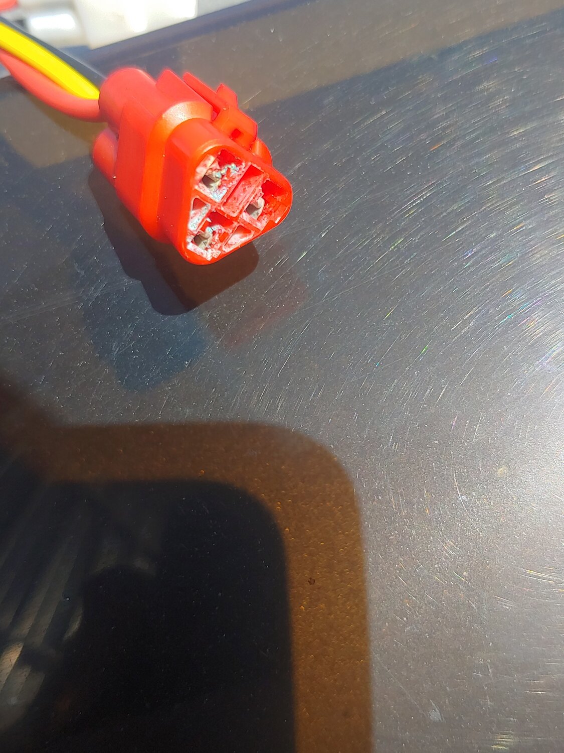

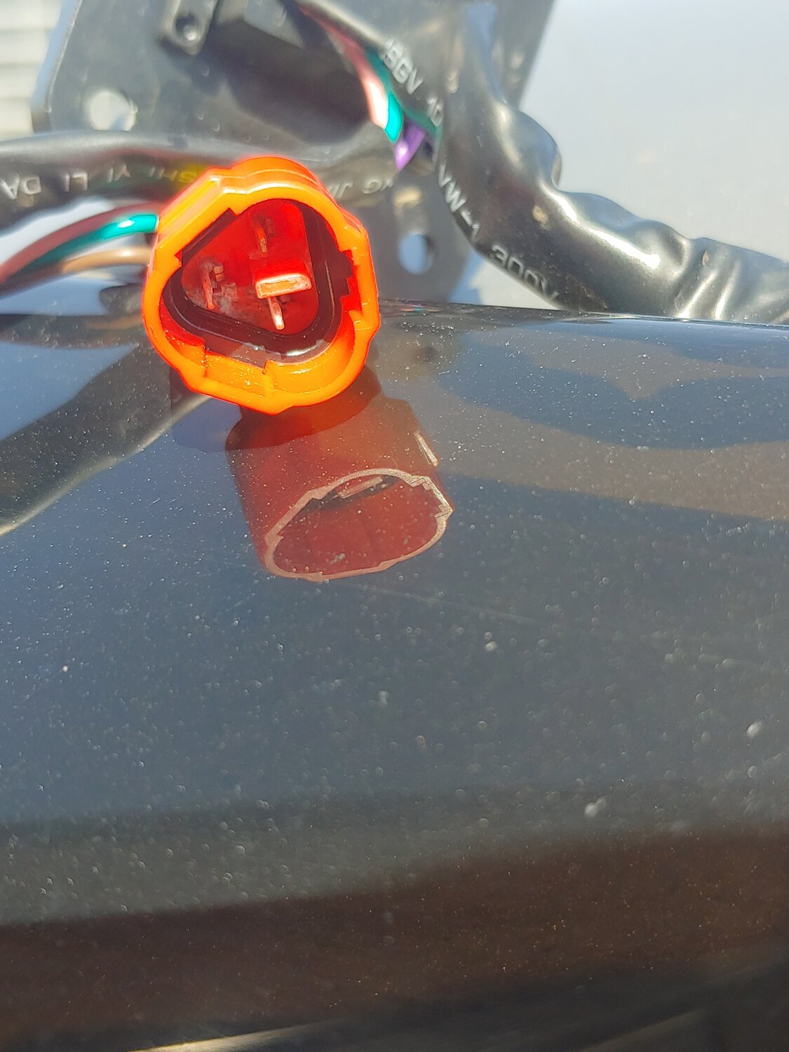

The tech at the shop where I dropped off the Trance discovered a corroded connector below the charging socket bracket which he feels is to blame for the Trance’s brief but unexpected power shut down. I believe it’s the main power wire coming directly from the motor. He cleaned the affected connector, applied dielectric grease, updated the firmware and installed the new wire harness. I’ll pick the bike up tomorrow morning and give it a thorough test ride. Big thumbs up to Don at Red’s in Lacombe, AB for sleuthing the mystery out of this specific bug.👏👍
View attachment 85368View attachment 85369
That corrosion occurred very, very, quickly. You got the bike mid February if memory serves me correctly. With all the snow riding, it must have got in there and just sat.
Is your garage heated?
I have doubts that it could have been snow. However, I did slosh through some pretty wicked wet gloop a couple of times back in March along the Heritage Trail. One memorable ride was at night when thaw conditions were well underway. If that's the case, then I have little faith in how these bikes are put together. :( Our garage is insulated but not heated so it still remains relatively cold in there throughout the winter season and the battery was removed each time when I returned home from a ride.
