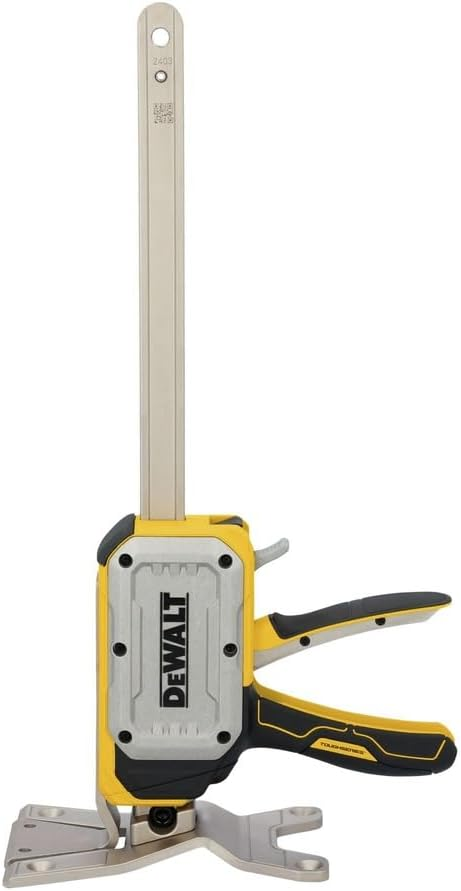

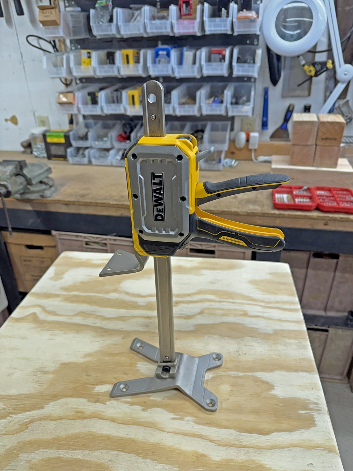

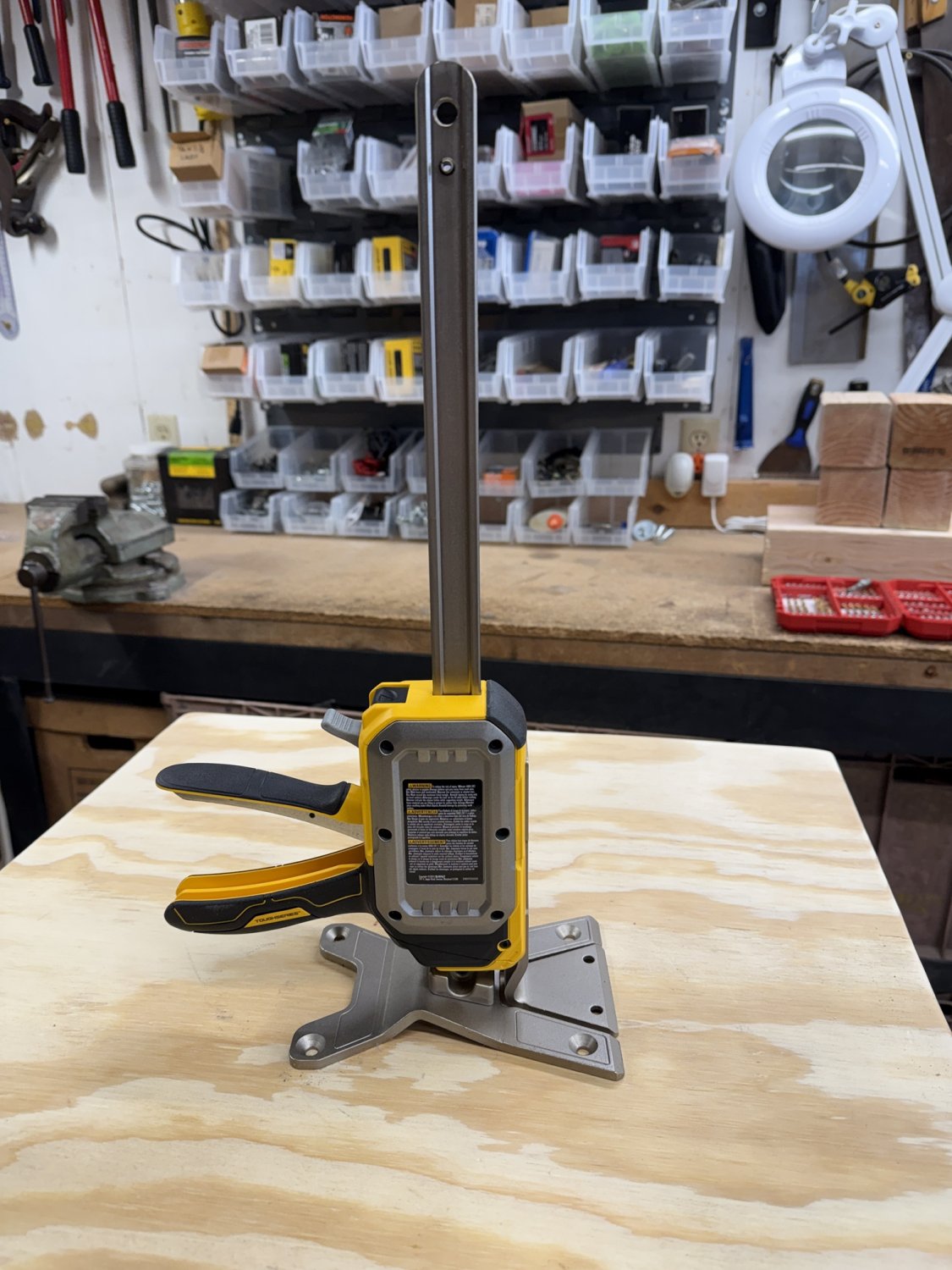

Picked up a couple of these on sale last week:
Among other uses, they work great for making quick bike adjustments without putting the bike on the work stand. With the bike supported by the kick stand, I just put this hand jack under the bottom bracket and lift the rear wheel off the ground an inch or so.

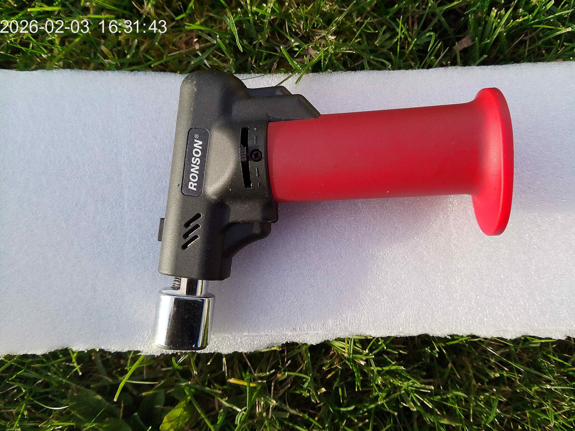

Soldering 20-30 amp or 16-14 gauge discharge wires with even a good soldering iron with a fresh tip can be a pain. You need to heat them for 3 or four minutes and might end up with a grey surface (bad) instead of a bright surface (good) and have to redo it. All electrical conductors also conduct heat away. So, I took a tip from people with high developed meh-heads, also folks like Richard Pryor and Whitney Houston and am using a little butane torch. Both fuel delivery and oxygen mix, with a top carb, are adjustable. The point of the blue flame makes the process take about four seconds. It always looks shined and nice. If I recall it was $6.35 in a Tractor Supply check-out bin. Maybe for truckers looking for a 2 AM pick-me-up. What is funny is that the huge gleaming downtown electric bike shop does not own a multimeter or a soldering iron. They cannot diagnose or fix stuff. Only using guess work to start replacing parts. Oh, it might be the $1200 battery, lets order one and see it that works! It will take three weeks of prime ride time to get here. Nope that didn't work so, let's order a new display and try that. With no rides from April 15th to June 2nd.

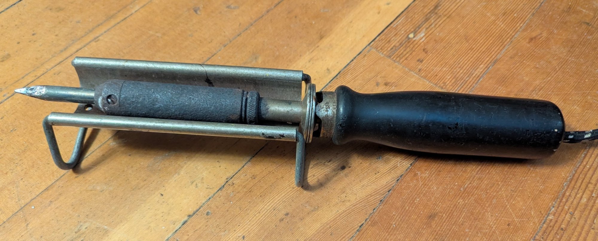

The mass of the tip is important. I have a temperature-controlled pencil iron of just a few watts. It came with assorted tips. With the right tip and temp, it's good on 14 gauge. For bigger stuff, I use a much bigger tip that attaches to a propane torch.
In 7th grade we learned to make boxes of tin-plated steel. Cut with tin snips. Bend with a brake. Take an iron with a tip about an inch in diameter and two inches long. Clean it with sandpaper, add flux, and stick it in a toaster-size electric furnace on the bench. When it's hot, melt and wick solder from a bar. Run the tip of the iron along a seam of your box. The method must have been foolproof because it worked for me!
True dat.... a larger chisel point works much better for larger wires and connectors than a small pencil tip.

No 3 - 4 minutes of heating necessary if you use the right temperature, +400°c. and it's more like 10 seconds at most.. especially if you use a quality low temp solder for electronics.

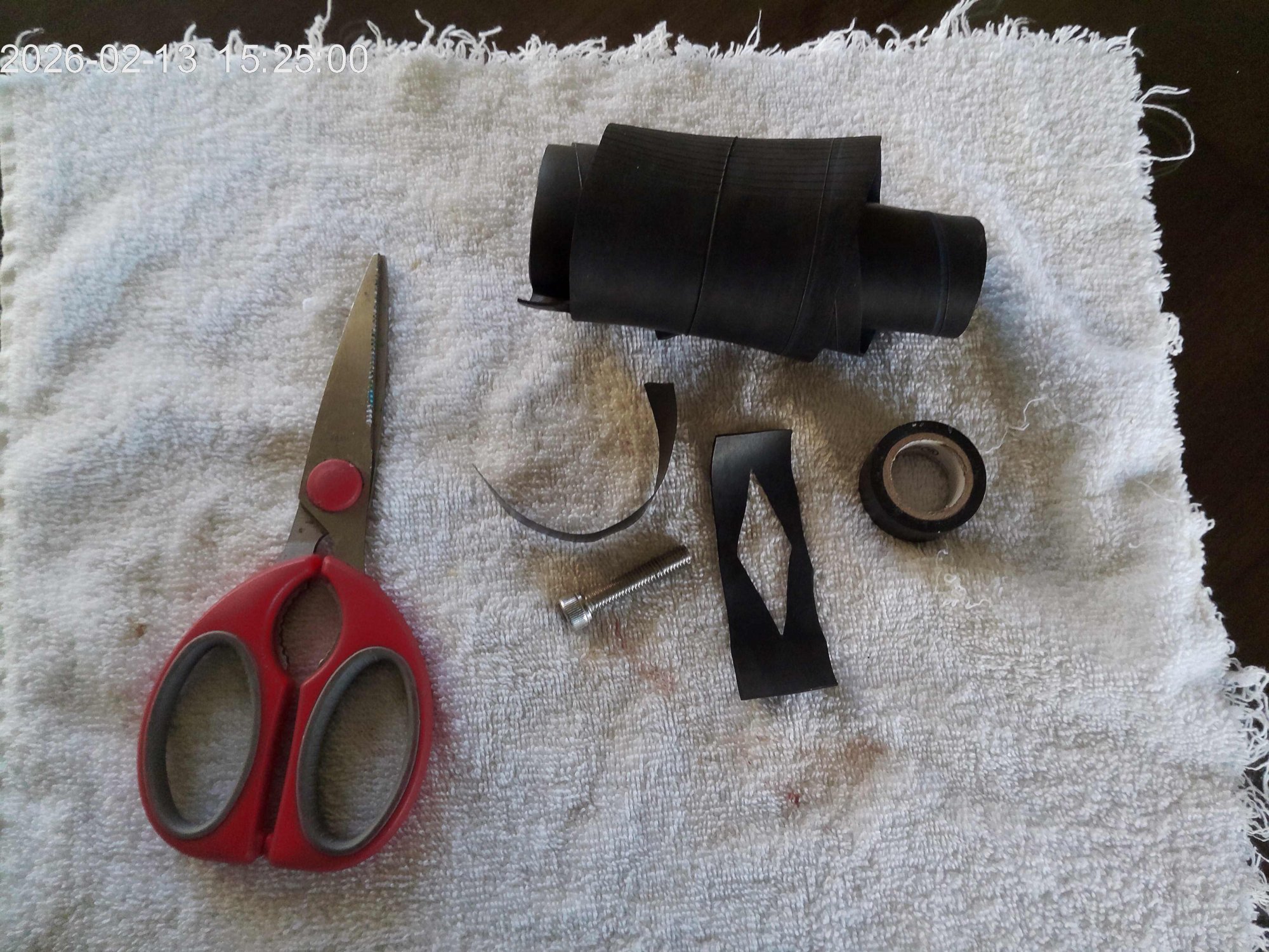

Mid-drive motor mount. It goes between the top front of the motor and the down tube. The diamond makes it self-centered.
