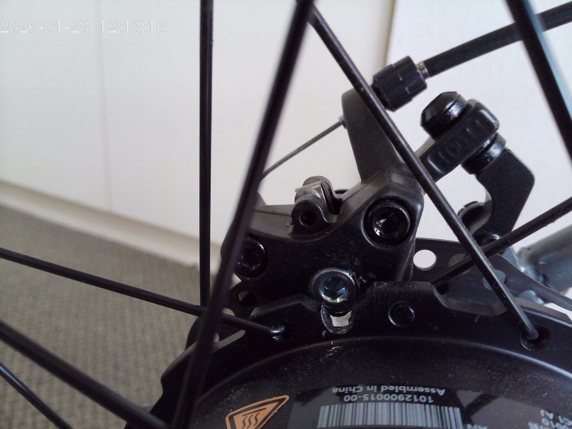

Sometimes hub-drive bikes come in that have an inboard pad adjuster that is not possible to access. 95% of hub-drives with mechanical brakes are out of adjustment and barely work. So, what is to be done? Here I drilled the rim of the motor for access painted it black and then put a white dot on it to quickly find the access port.
I am not sure what to think of that. It works and I doubt it compromised the hub, but I probably would have taken a different approach if it were my bike. Most likely I'd pull the caliper off and adjust it while waiting for the new hydraulic brakes to come in.
Bend ball end allen key also does the job in my experience
In some cases it is higher than 45 degrees and won't work. The customer is 135 kg and lives on a hill. He couldn't stop. I have shown him how to adjust the inner pads and the notch will make it easy. The ball end 5mm hex worked on his other bike.
What bike manufacturers make brake adjusters inaccessible? I've had 3 hub-drive bikes with Tektro mechanical brakes. I usually took the proper hex bit from my 3/8" drive set, snapped it on a 6" extension, went to the other side of the bike, and stuck it between the spokes. Straight shot.
It's not the fault of the brake manufacturer. Hub motors have a much larger diameter than a standard bicycle hub.
As I say, I've had 3 bikes with hub motors and mechanical brakes. Two had direct-drive motors, with larger diameters than my 750 W geared motor. On each, the adjustor was a straight shot for a 6" driver shaft. I wonder if the problem comes from e-bike manufacturers using disk calipers intended for push bikes.
I'd install a larger rotor and have better braking and better access to the adjustment screw instead of hacking things.
Probably less work as well... but that's just me 🙃

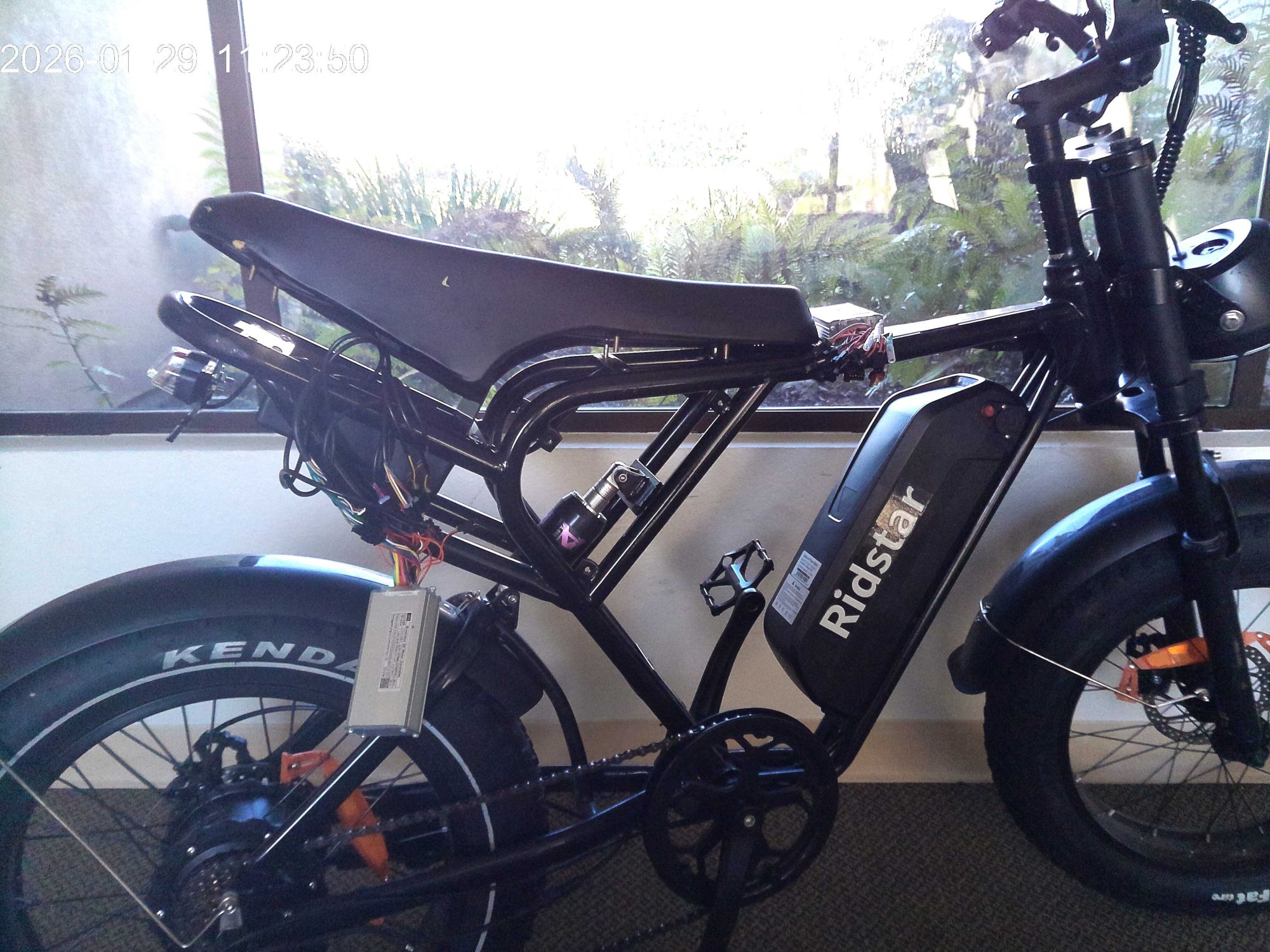

The guy tightened the cones all the way so they were nice and secure. It is like the lady who tightened all the screws in her derailleur, including the limits and B. I am working on another POS now called a Ridstar. It has a fried controller. The lady is giving me a very nice tip because last time she was in I shook hands with her teen grandson an treated him with respect.

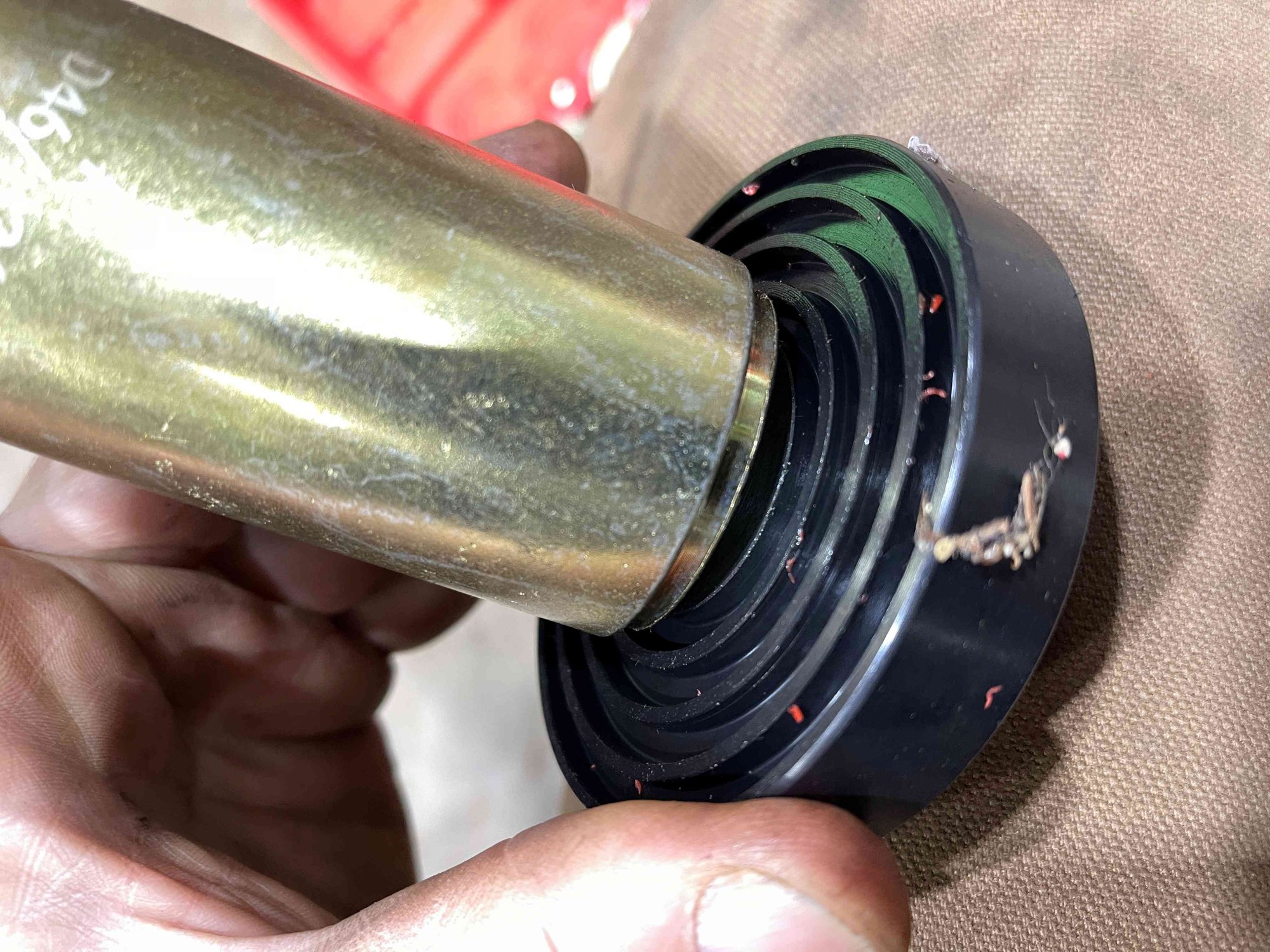

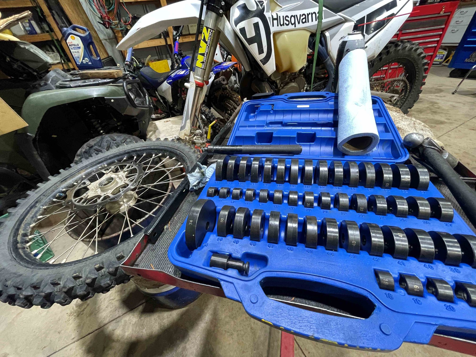

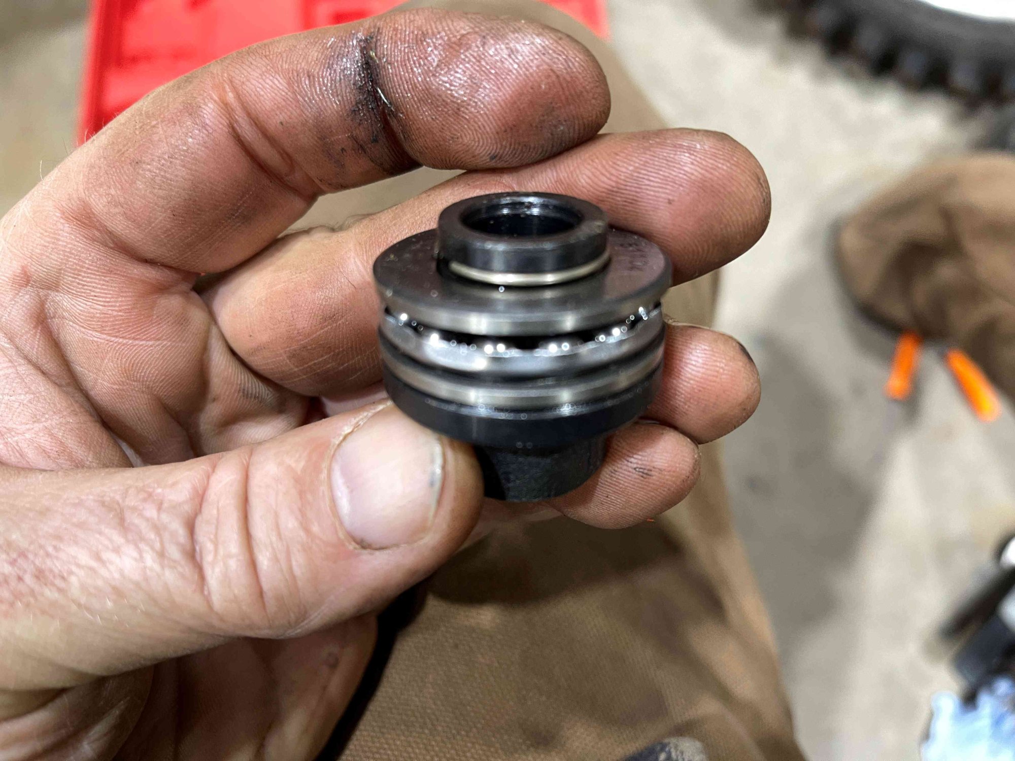

Here is a gem that adapts to so many situations involving pressing or driving. I wish I had this stepped metric set YEARS ago!
I press a lot of bushings, bearings and seals and these make it a pleasure with a PERFECT fit.
I bought this one from Vevor about 2 years ago. This one includes a blind bearing puller that I already had. The other set comes as the drivers only. https://www.vevor.com/wheel-hubs-be...ver-removal-tool-set-52-16-pcs-p_010228143821
I have had to grind some metal from the internal bearing puller arms to eliminate the small bit of taper contact to the inside of some bearings and the metal is a bit softer than I would like on the press pieces, but if you avoid hammer blows and treat them respectfully they will last a lifetime.

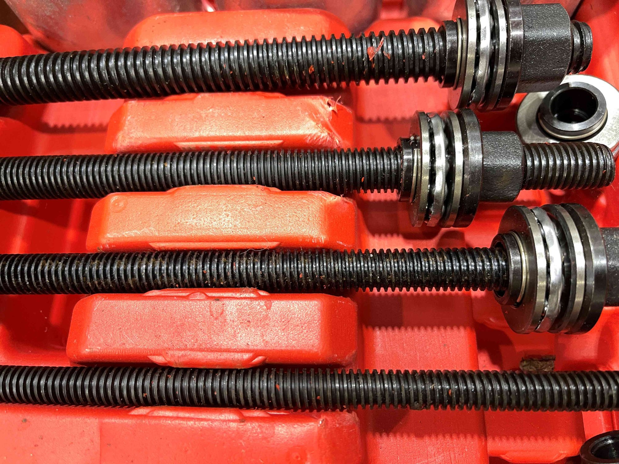

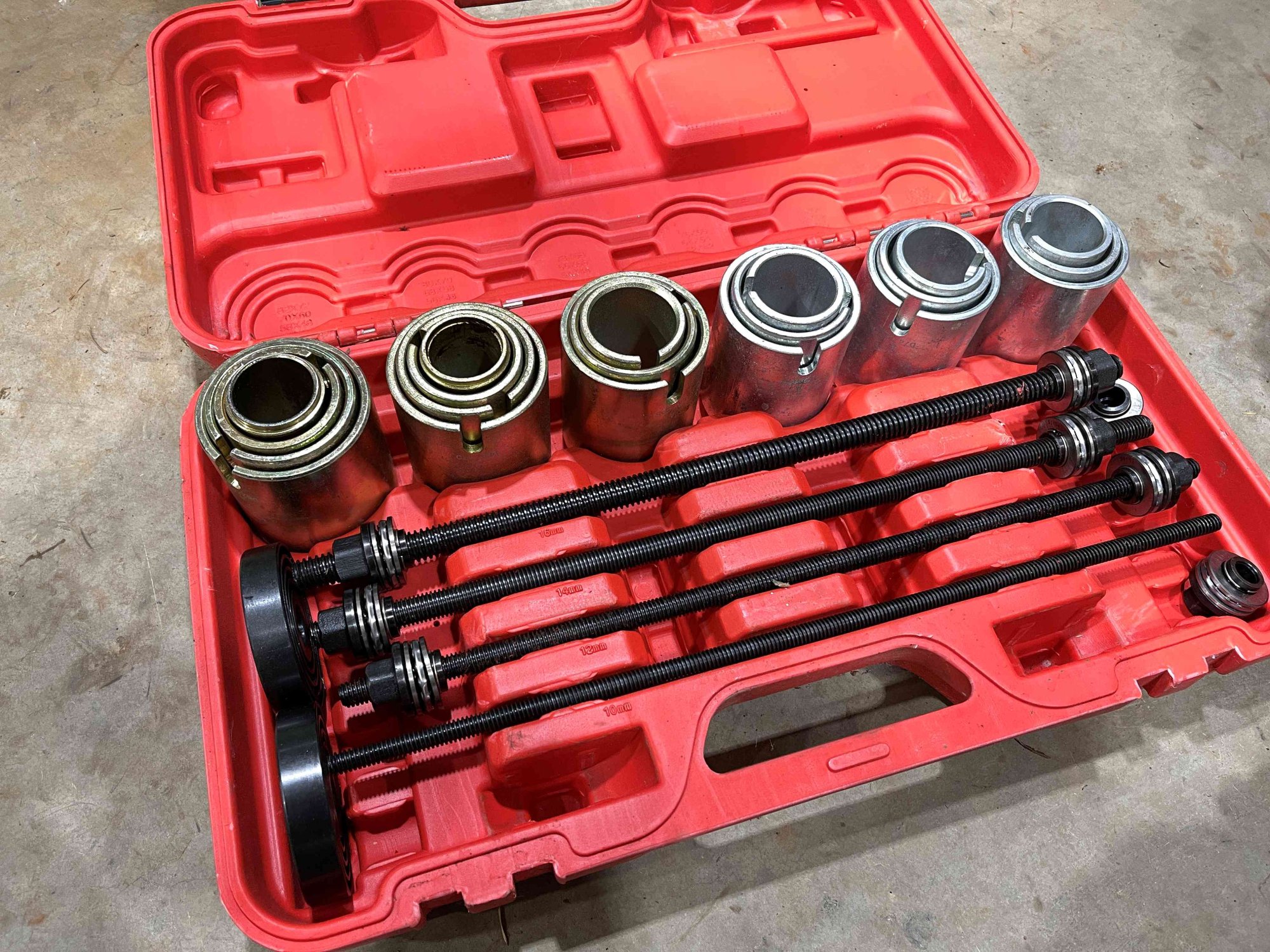

Here is a second press set that has a very useful force screw with bearing heads. The sleaves nest into the press heads and keeps the force screws very centered while under loads.
I would like to have a second set to machine angles upon for pressing many types of automotive bushings that have tapered surfaces. (I will actively avoid such torture jobs until compelled to do so)
Most of these press pieces will be too large for any bicycle shop procedure other than steering head bearing pressing, but many guys on here work on more than just bicycles.

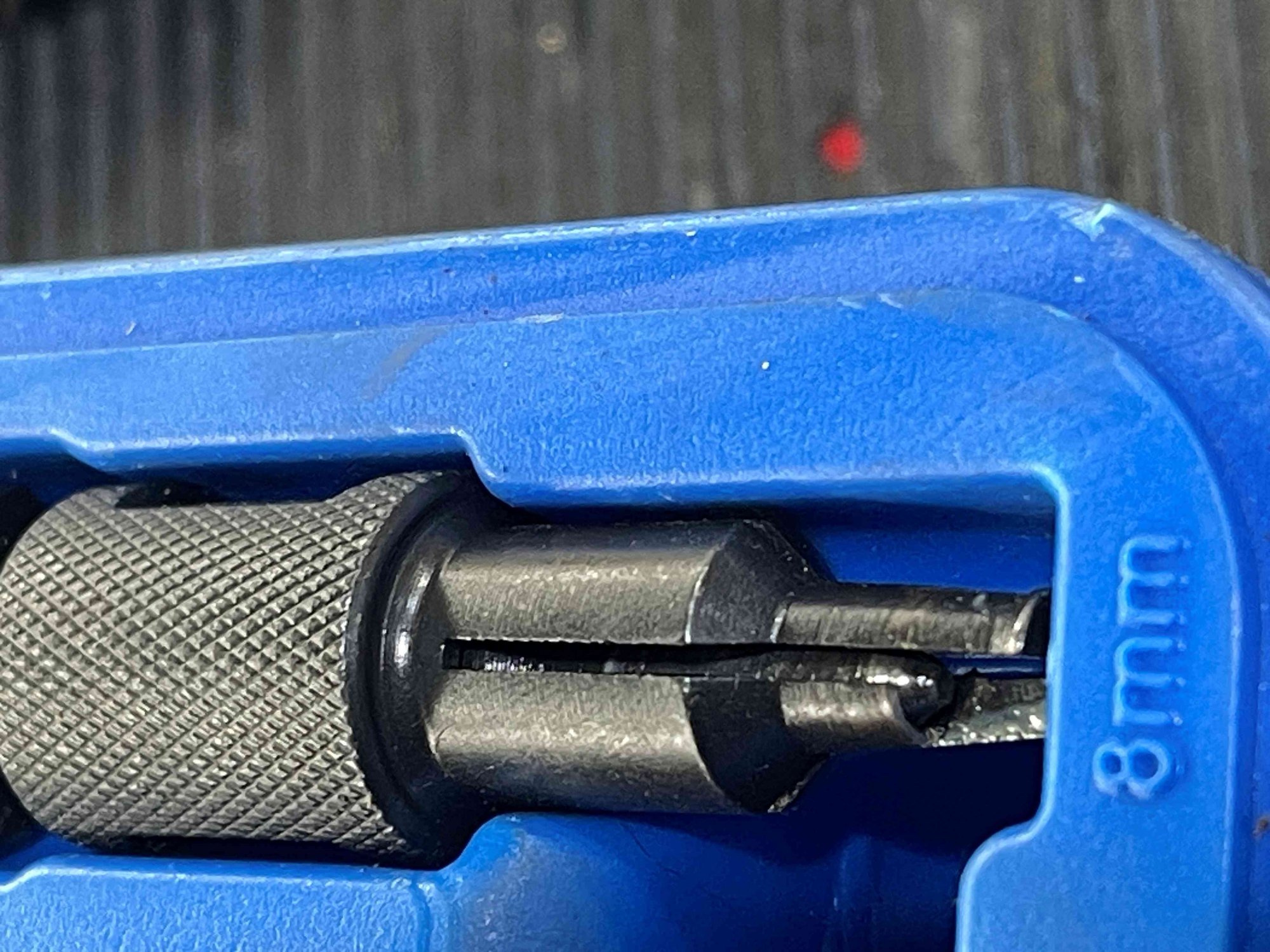

Here is an example of forcing the blind bearing puller without lightly grinding the sides to fit the taper of the bearing being pulled.
My oldest son that shares the shop with me and does part time work in here, tried to pull a waterpump bearing from a motorcycle case without gently grinding the puller to fit the bearing. It took a lot of force to break it with the use of a slide hammer. He is not known for being very mechanically gentle or patient!

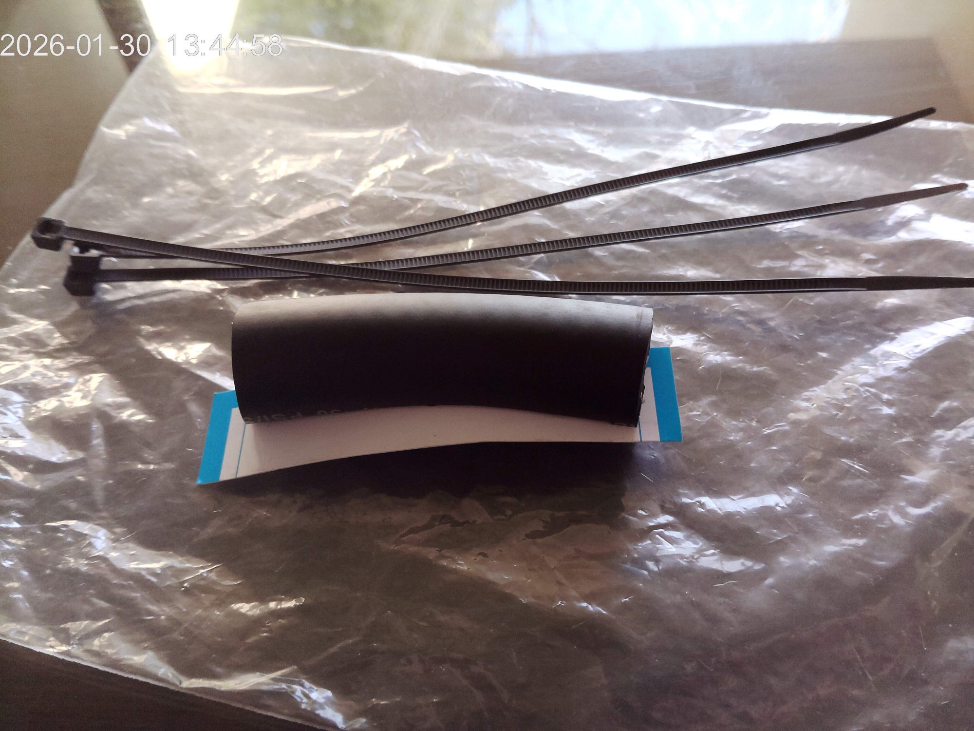

I made a long cargo bike electric last Saturday. It just has a Tourney derailleur, no clutch. Over bumps the chain rattles against the stay and it bugs him. So I made him this kit out of automotive heater hose to place at the contact point. He had not written a review so I called him today asking how the bike is and if he has any questions. I am giving this kit for free. And he will write the review.
