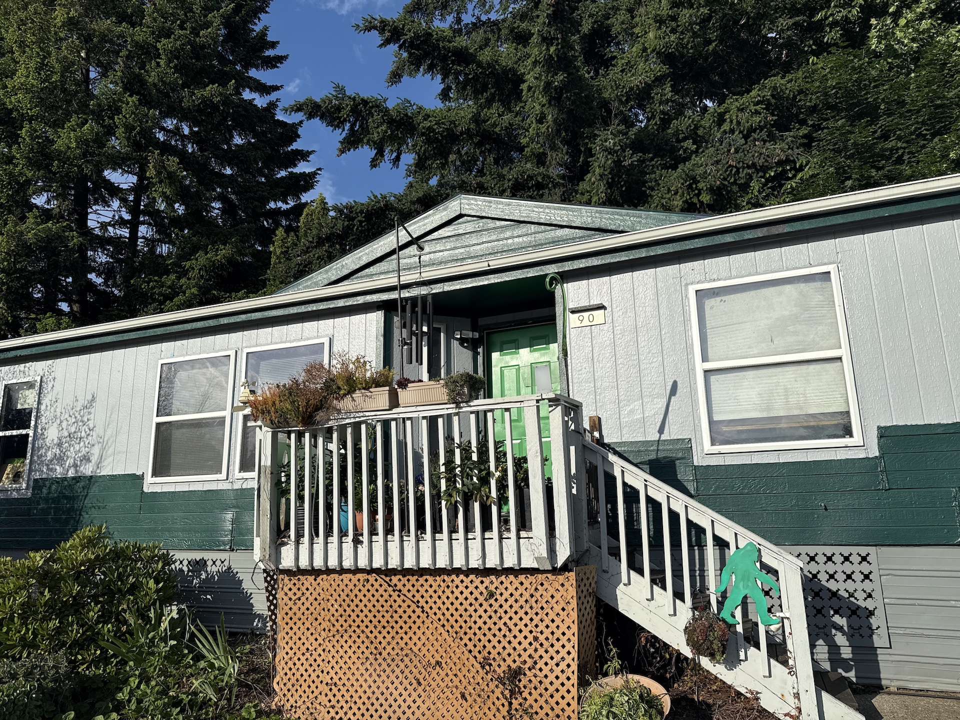

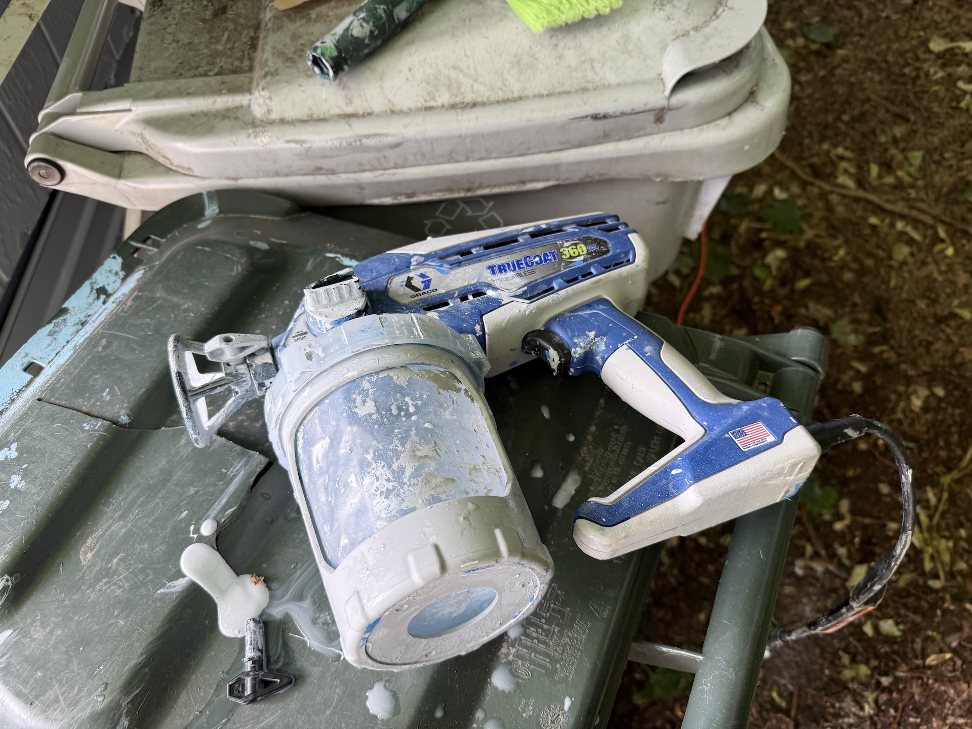

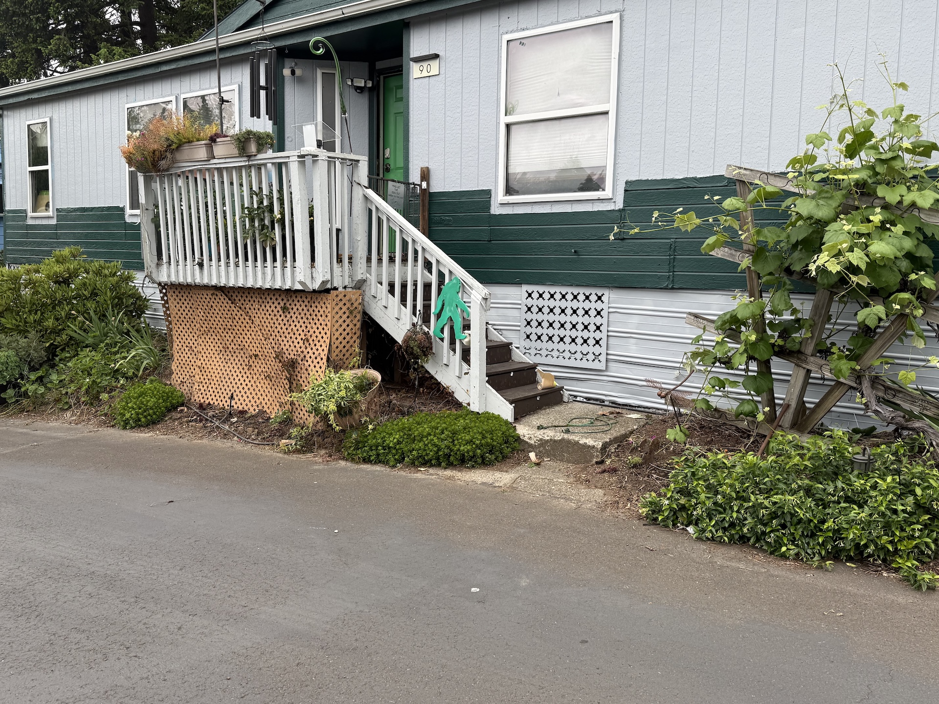

Got this airless sprayer for a job painting these big letters I made for a customer. But it put out so much paint that it was not practical. So it sat around for the last 3 years. I finally had to break down and paint the house. I debated on painting it and painting everything gray, but I used a roller and brush instead. But I painted the skirting today with it. about 200 feet of it in less than 2 hours, about 1/2 or more time was used refilling the small tank.
You can see the before and after. a good roller and paint, I can paint just as smoothly as the sprayer, just slower. I started painting my small garage, only 14x14, one wall, but realised the neighbor's truck would end up getting painted, so I rolled the rest. The paint is a little spotty as it was not fully dry.

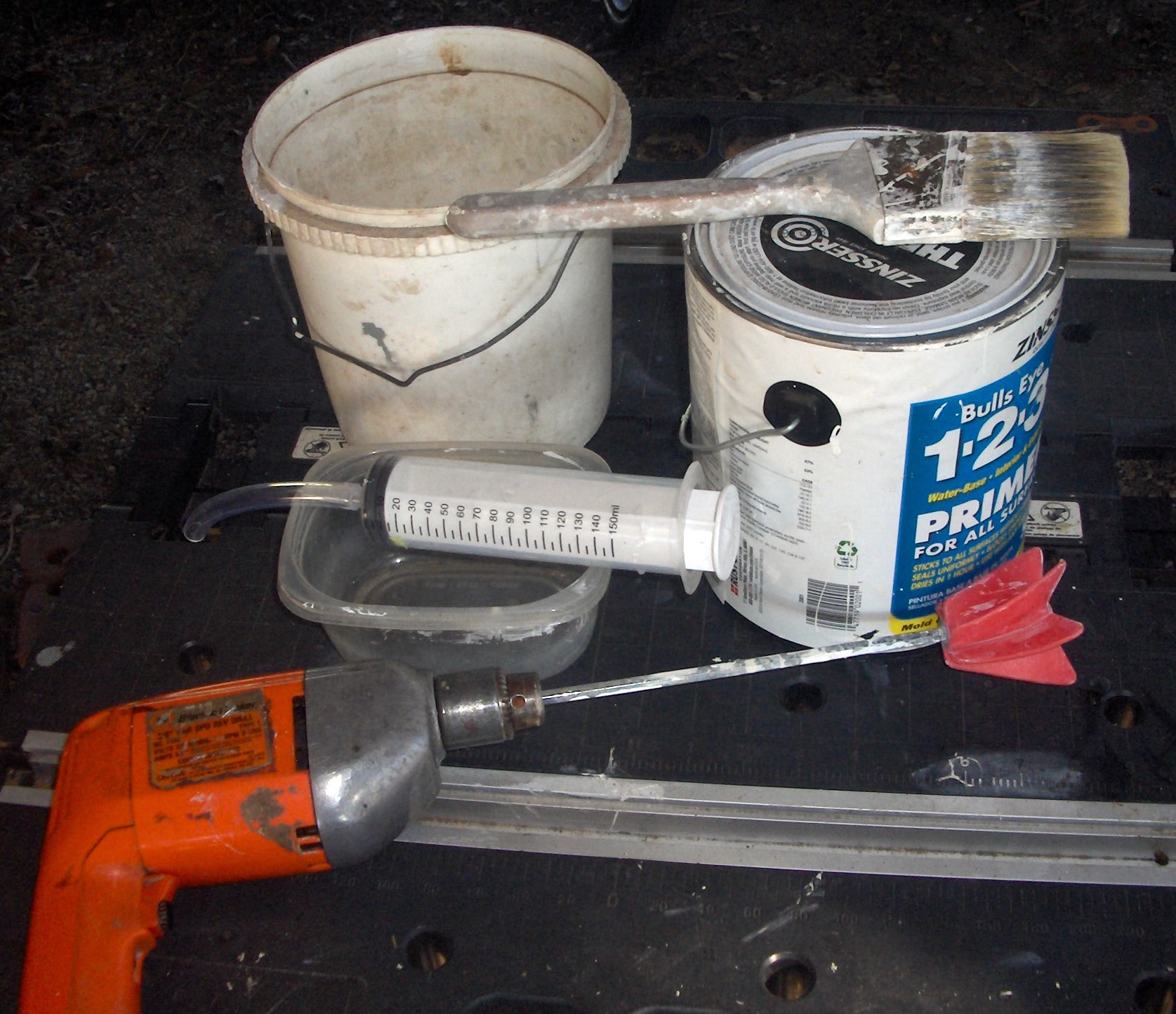

I began ladling paint into a quart-sized plastic LLoyd's Barbecue tub. Suppose it took half a gallon to cover 200 square feet. Suppose it took an hour. That's how long the paint in the pail would have been stiffening when you finished. Instead, I might ladle a pint into the tub to do the first 50 square feet. I'd brush the excess out of the ladle, drop the ladle into water, and put the lid on the can. Holding the little tub in my other hand made reloading the brush much quicker than using a pail, whether I held the pail or set it down. The tub would be empty within 15 minutes. Not exposing more paint than I could use in 15 minutes meant more consistent viscosity and an easier cleanup.
I clean the mating surfaces of the rim and lid and apply a film of silicone grease. That way if I need the same paint ten years later, I can remove the lid without damage and the paint will still be good. I switched from ladles to syringes because a syringe is better for keeping the rim clean and it's easier to clean. Yesterday I wanted to prime 30 square feet, indoors and out. The lid came off easily. I mixed, cleaned the mixer with the brush, and dropped the mixer into the pail with enough water to keep the painty part wet. I have a vinyl tube on the syringe to pick up paint without getting the outside of the syringe wet. For that job, I estimated 10 oz, or 2 syringes. Some paint clung to the walls of the tube. I dropped the syringe into the pail so water would keep air out of the tube. I used a 24 oz Glad food storage container instead of the slightly larger barbecue tub. Painting didn't take long and cleanup took 2 or 3 minutes.

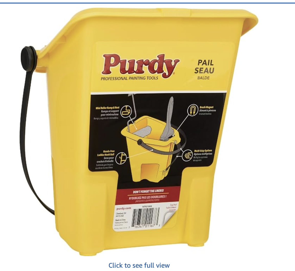

I use these pails, they work for rollers and brushes. I bought ladder hooks so I can carry two up and hook them on the ladder so I don't have to hold them. Also bought the liners. Don't even have to wash the bucket, saves a huge amount of time

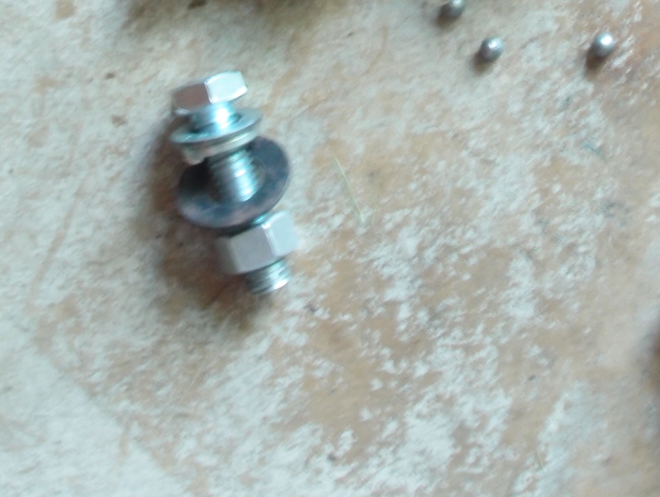

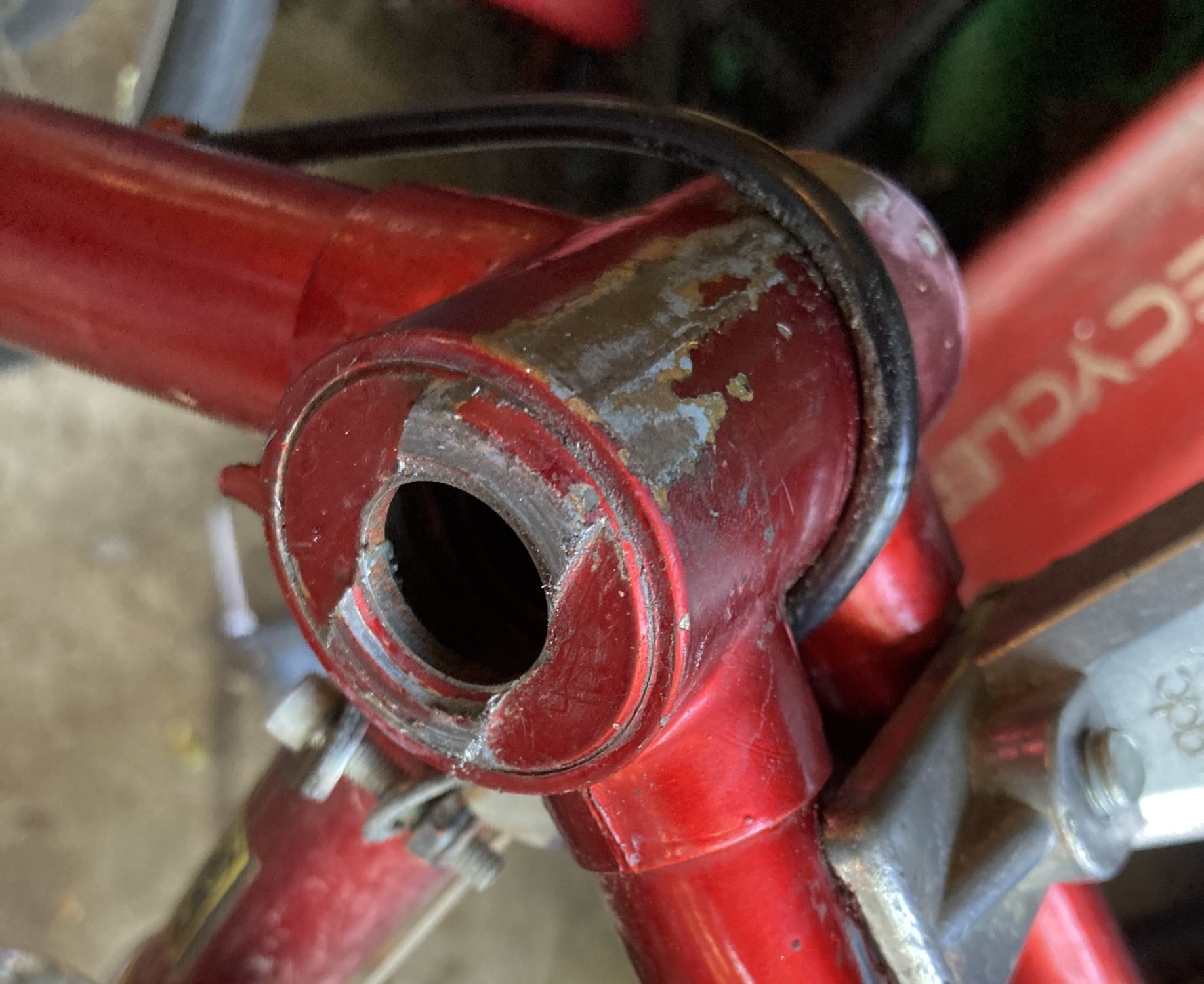

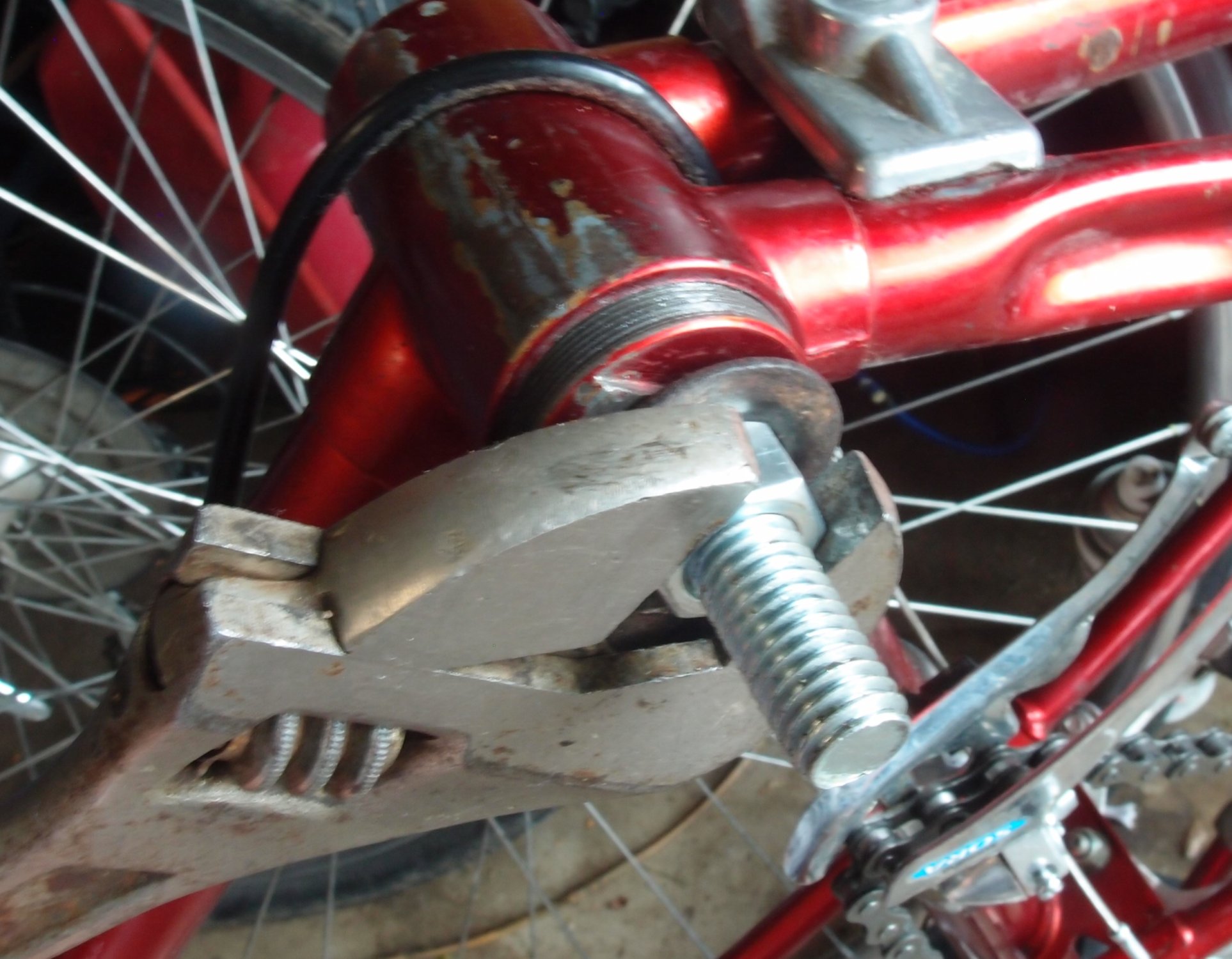

Older bike, drive side BB cover. How to get it out.
RJ the Bike Guy puts a screw/nut combo thru it. TIghtens the nut and since this is a left hand thread, it loosens the assembly,

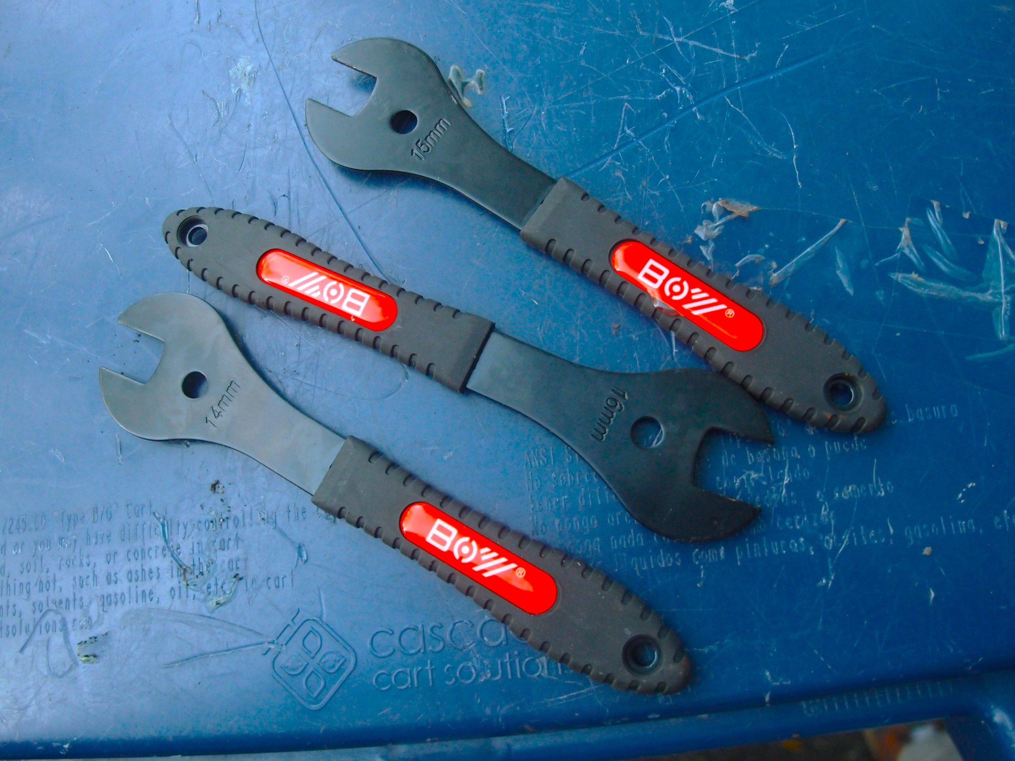

Yeah, it works. Park sells a wrench for this job, which I have, but that works only after you use big time torque to break the part loose,
Hope to be slipping a To-seven DM02 in the hole,

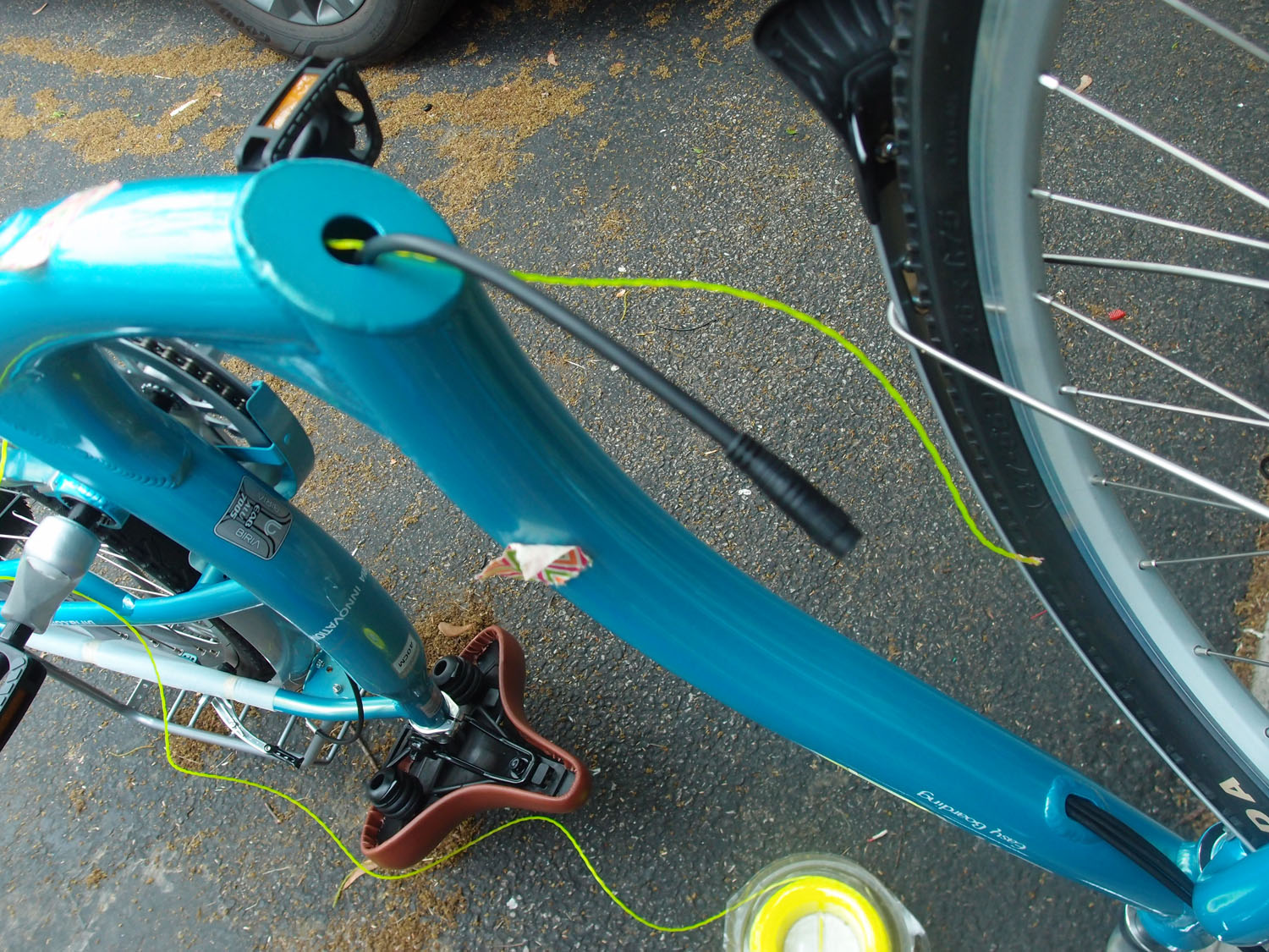

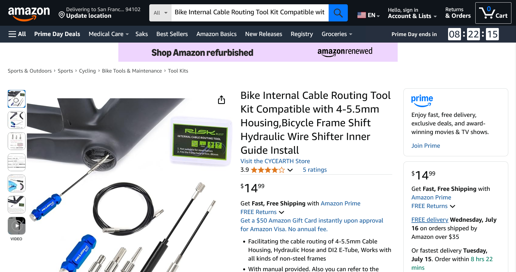

15 bucks for a cable routing fish tool, huh? I looked on my wall and found a roll of weed whacker line. Pulled the 4:1 harness thru the frame with it and some tape,
The problem is when you have to "push" the cable through.
I've used coat hangers for feeding things though other things, cuz you can bend and steer it as it's pushing through.
It's always a good idea to use the old cable to pull the new cable or a string through, but when you have to push something through, it gets tricky.
I am trying to get it from the motor up the down tube to by the head/steer tube and out the port there. But there is an internal lip and I just cannot get it with shift cable and magnets. When I do I can chop the connector of the 4mm display wire and pull it down to solder it in the motor. I am going to yank the motor and take another way because I am too impatient. This is a totally cool Felt GRX gravel bike that I am setting up for Mexico. I also need to mix the seaweed green metallic touch up paint because I scratched this brand new bike while removing the two piece BB/crank set.
