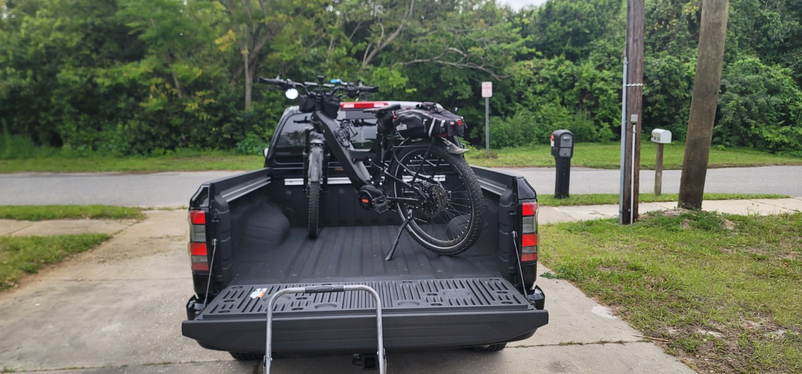

Instead of getting the 30ah battery for my C.C. I got a new '23 Frontier instead. This tool will get me further than my old Mitsubishi. Working on getting a ride88 bed rack that works with the utility track. This was me testing different ways the bike would fit.

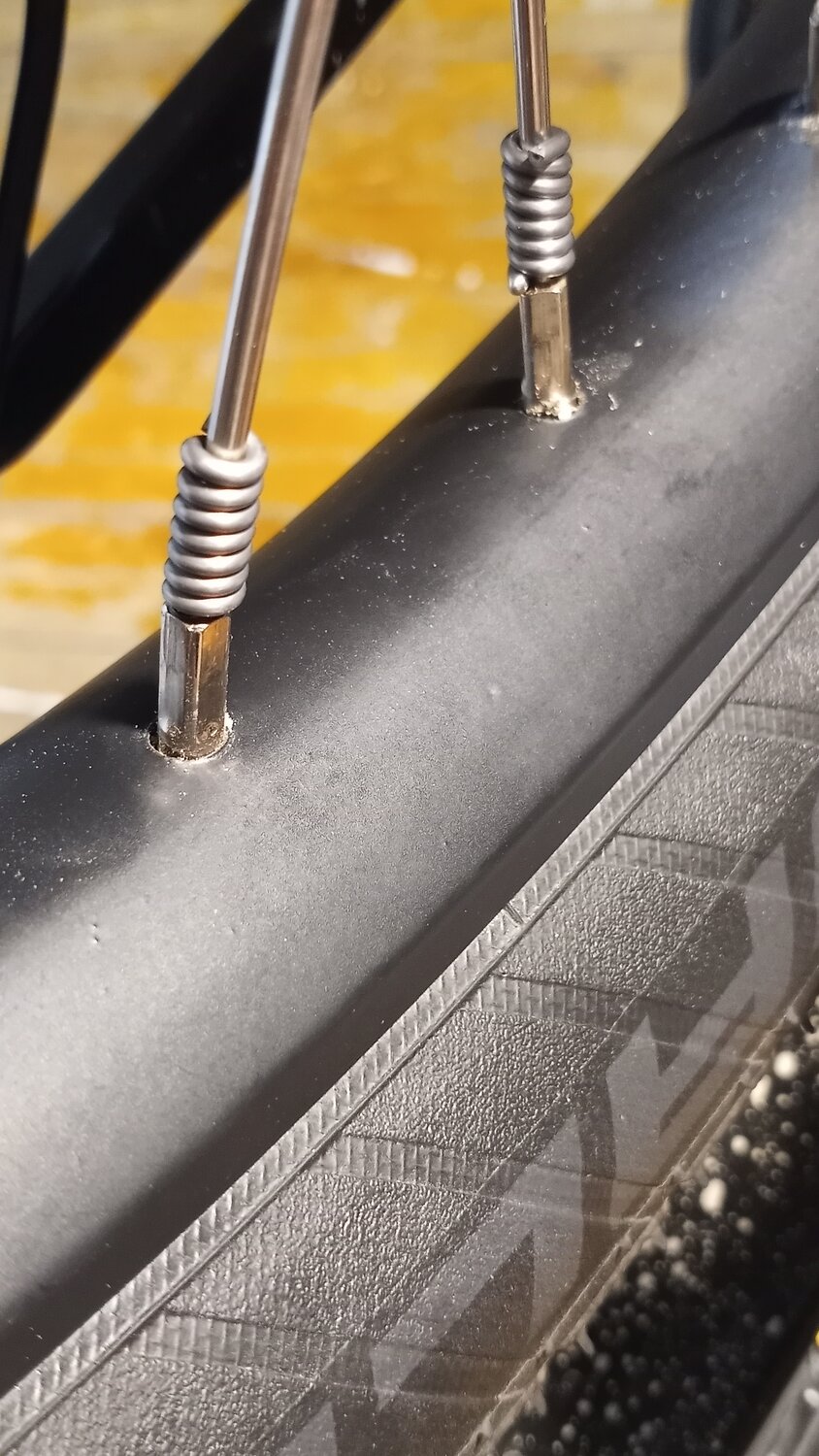

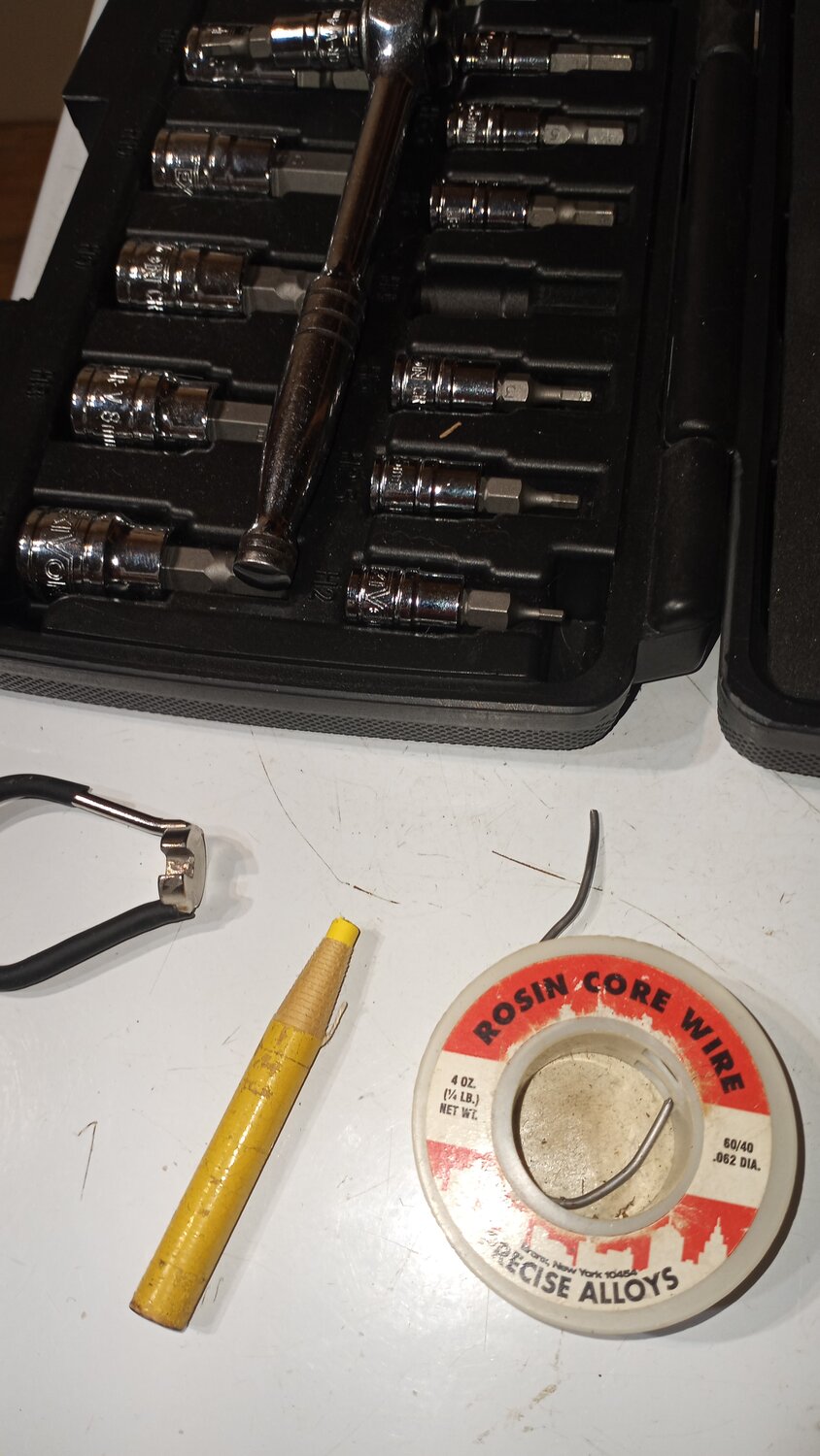

I made my own spoke weights to balance my wheels.
I was getting a speed wobble when I was riding no-hands.

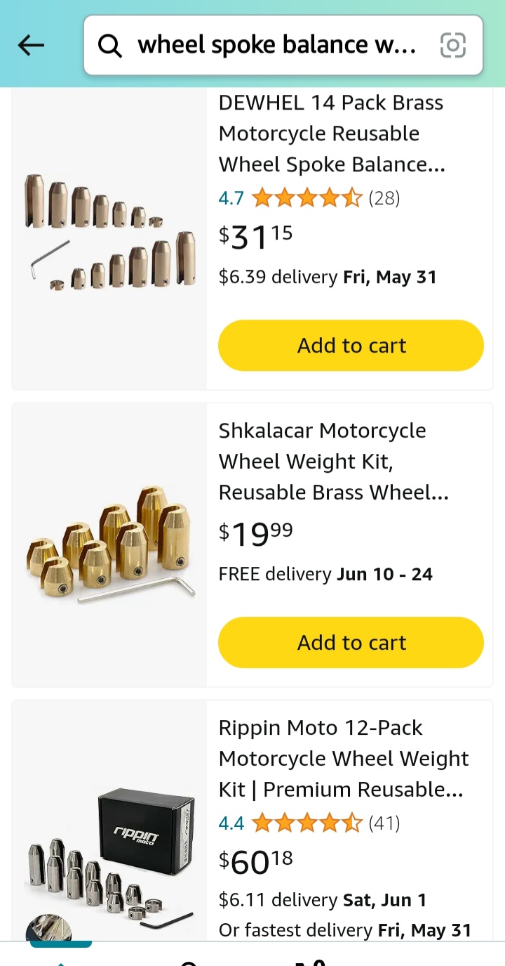

Brass spoke weights are too much money,..

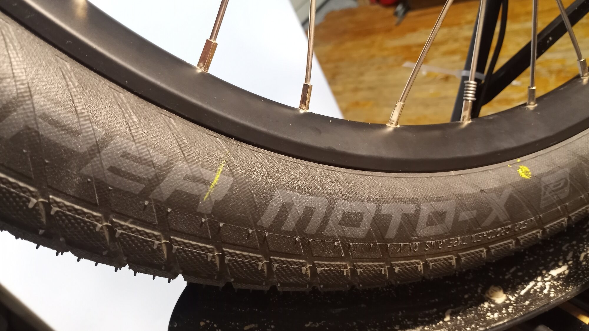

I replaced my stock nobby tires with Schwalbe Super Moto-X 27.5" X 2.8".
The tires had a slight wobble and were out of round.
My rims were almost perfectly true, and the tire bead alignment lines were dead on, but the tire tread was all over the place.
I had to warp my rims to straighten out the tire and counterweight the high spots to stop the wobble.
View attachment 176682View attachment 176683

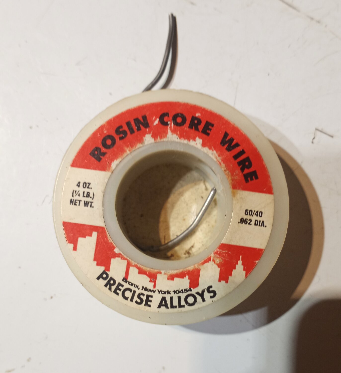

The front wheel was easy to balance, because the heaviest part of the wheel would settle at the bottom, so I could put the solder on the spoke opposite the heavy spot.
The rear hub motor has too much drag, and I couldn't find the heavy spot, so I placed the weight opposite of the high spot on the tire.
I've still got Flat-Out to put in the tires, but I didn't want it sloshing around inside the tire while I'm trying to true and balance it.

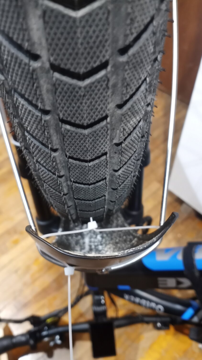

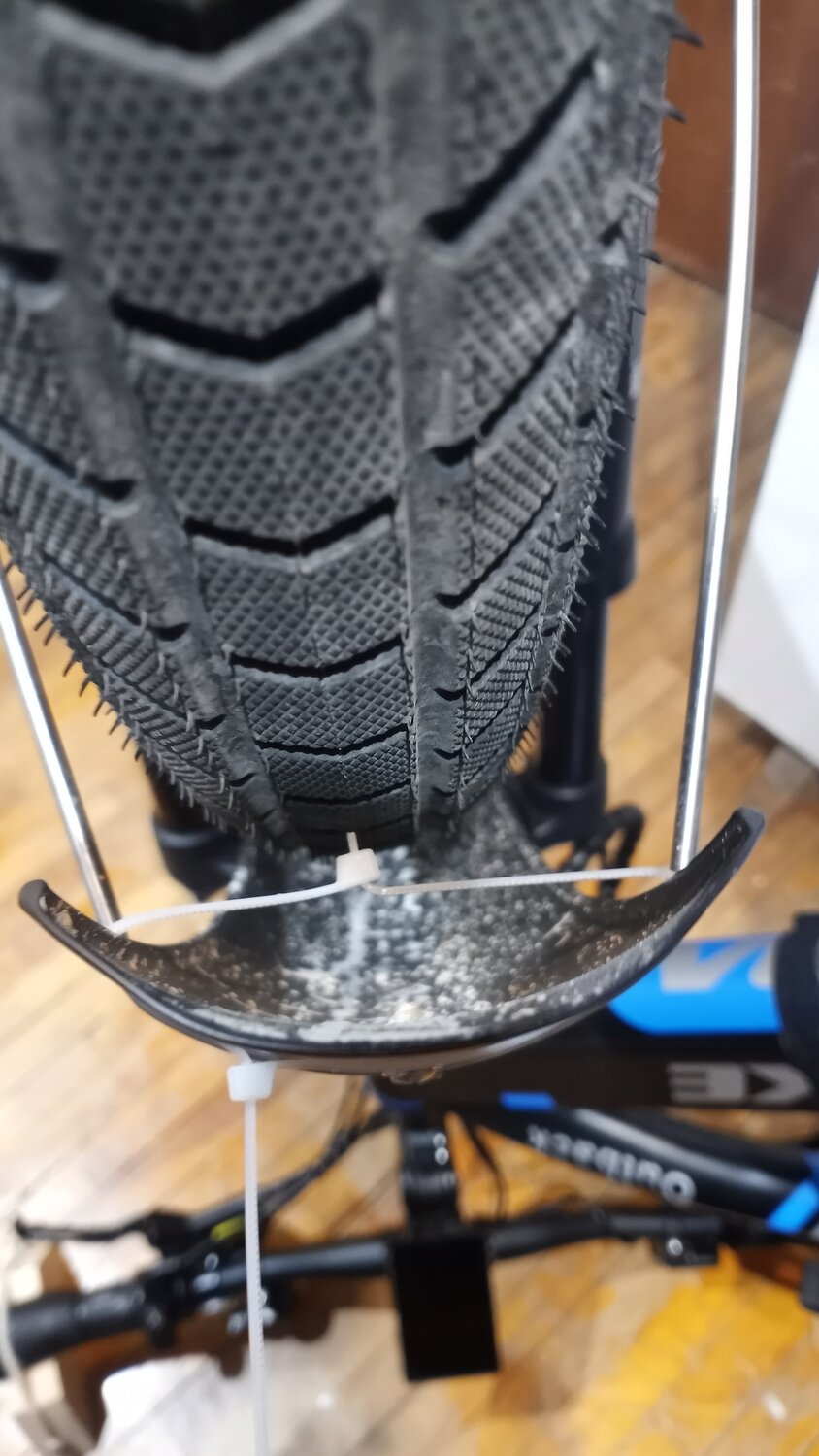

that means you need to reseatt the tire. and make sure the bead is even.
The bead is even.
The rim line indicators are aligned within 1 mm.
But the center of the tread was off by more than 3 mm, and there are high spots on the tire of more than 2 mm.
I managed to get the center of the tread straightened within 1 mm but there's not much I can do about the high spots.
Luckily the tire has a line down the center of the tread to follow for allingment.

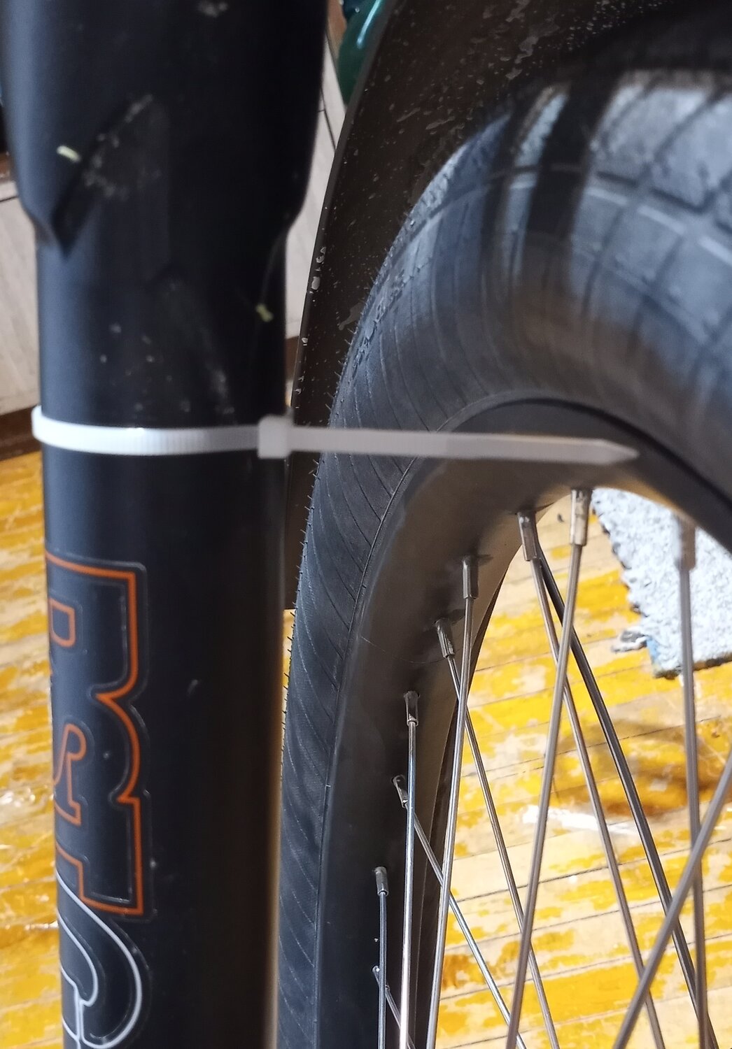

Zip ties work great for using the bike frame as a truing stand.

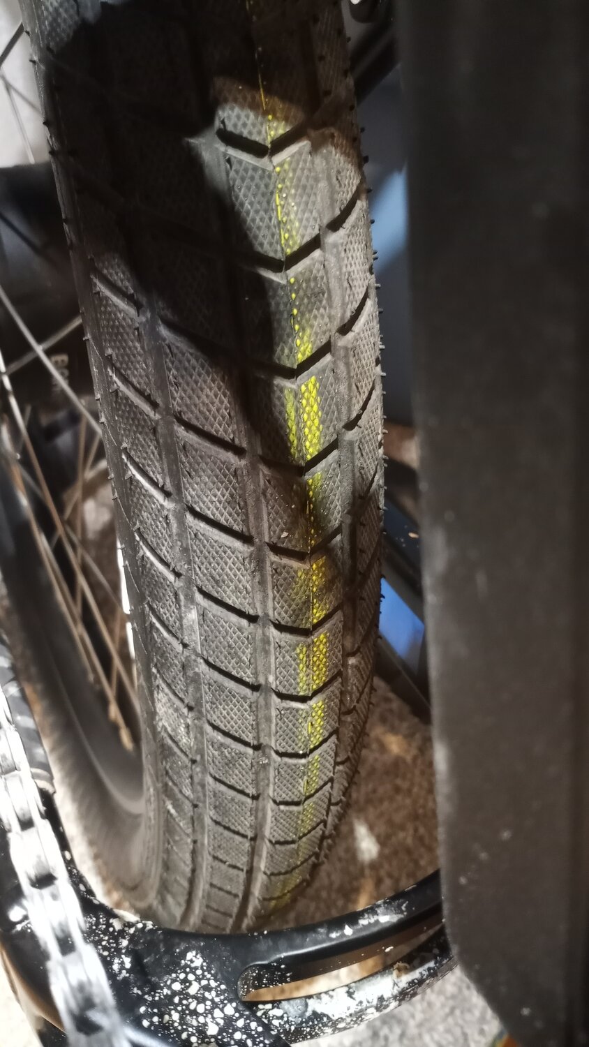

I will sometimes true a tire looking for high spots and left and right wobble. I mark these with progressive colors of grease crayons to note the progress. This is where I work part-time building and selling. It is cool to get paid to get hands-on and ride a bunch of bikes. It is all low key no pressure sales, that is why we have sold 44 eBikes so far for May. https://petalumamotorwheel.com/
Love the details, hate the concept!
Turing a tire takes like five colors and six attempts. It is a pain but worth it. Industry people think that I am nuts for doing it. But on my own bikes it makes all the difference. Just get a kid's dozen box of Crayola pastels. Track the progress of high spots and left/right spots being eliminated with the colors. Wipe off with rubbing alcohol when done. Tubeless folding tires are especially bad and require the most work. letting them sit flat first in the sun first then flipping helps. I will assemble more new bikes tomorrow.
The bead is even.
