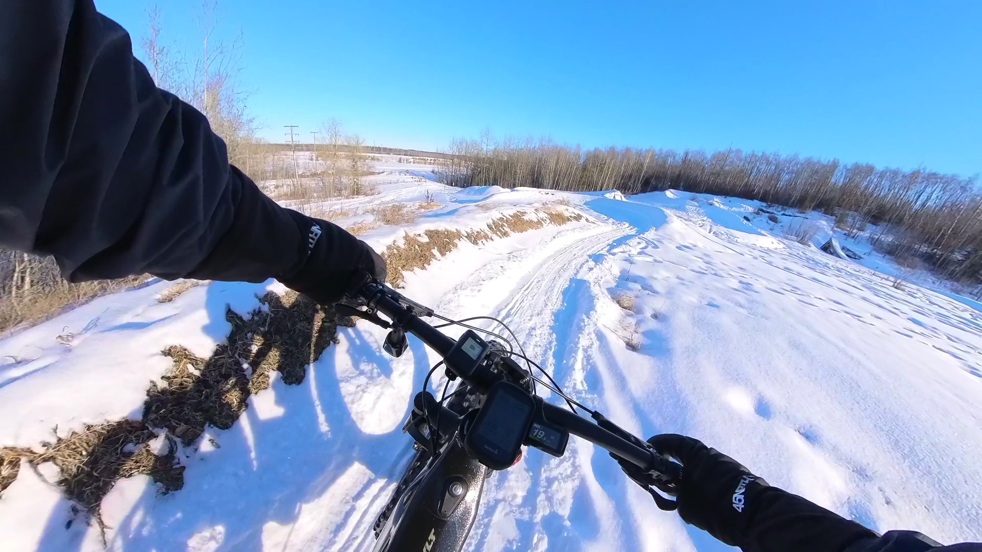

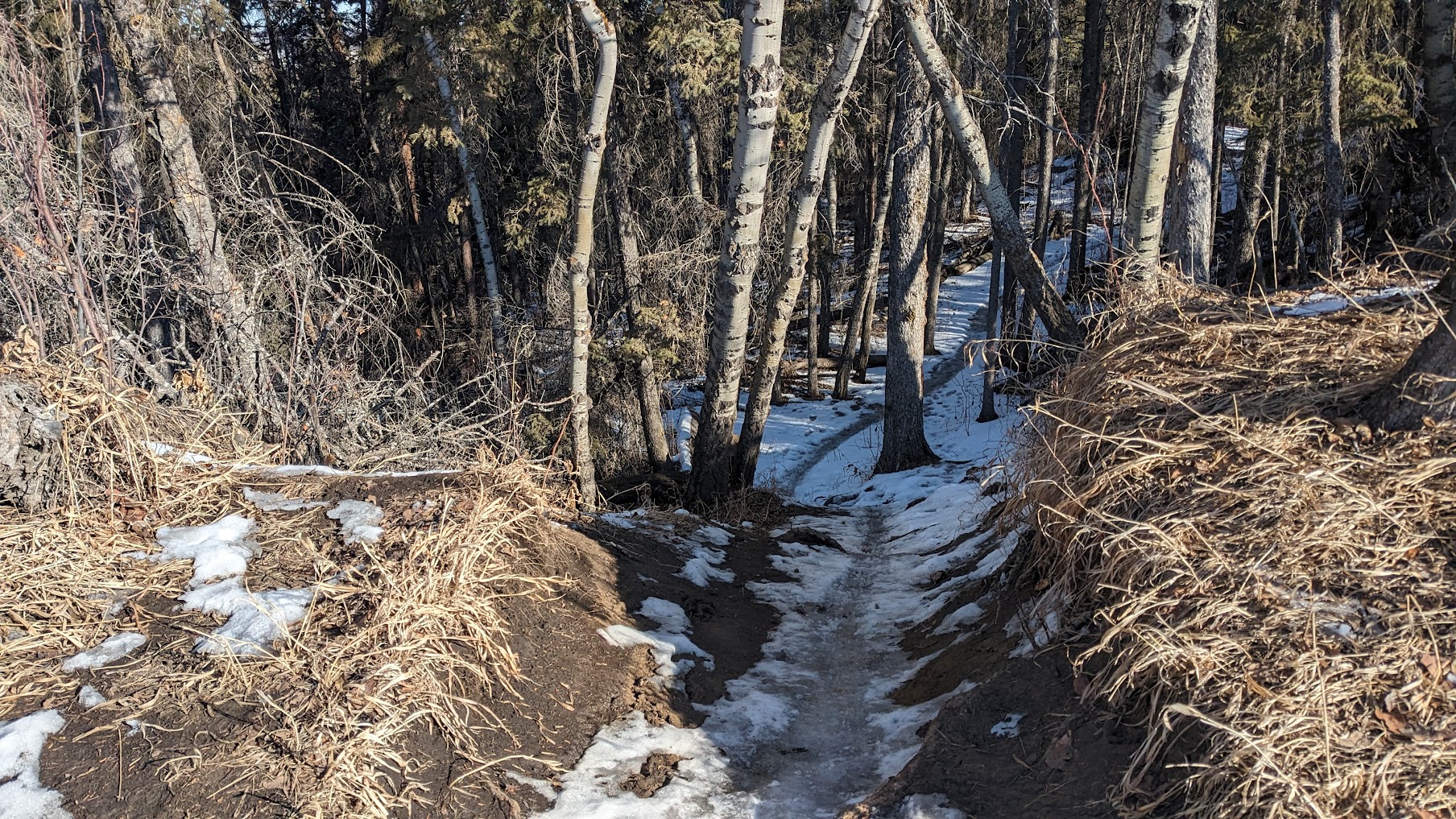

I’m not sure what if any benefit a throttle would provide in snow particularly if it’s deep or soft as the bike would simply get bogged down similar to how a RWD vehicle would react by spinning its tires. You would end up getting off the bike in those conditions regardless. A bike with walk mode might be more efficient in getting you out of tight spots but I’ve always relied on proper gearing and a slow methodical approach when climbing steeper grades (if the ground conditions aren’t in the best shape) while allowing the power of the motor to do the bulk of the work. That being said, even fat bikes have their limits when the snow is just too deep and progress is halted as the bike becomes slower and more sluggish.

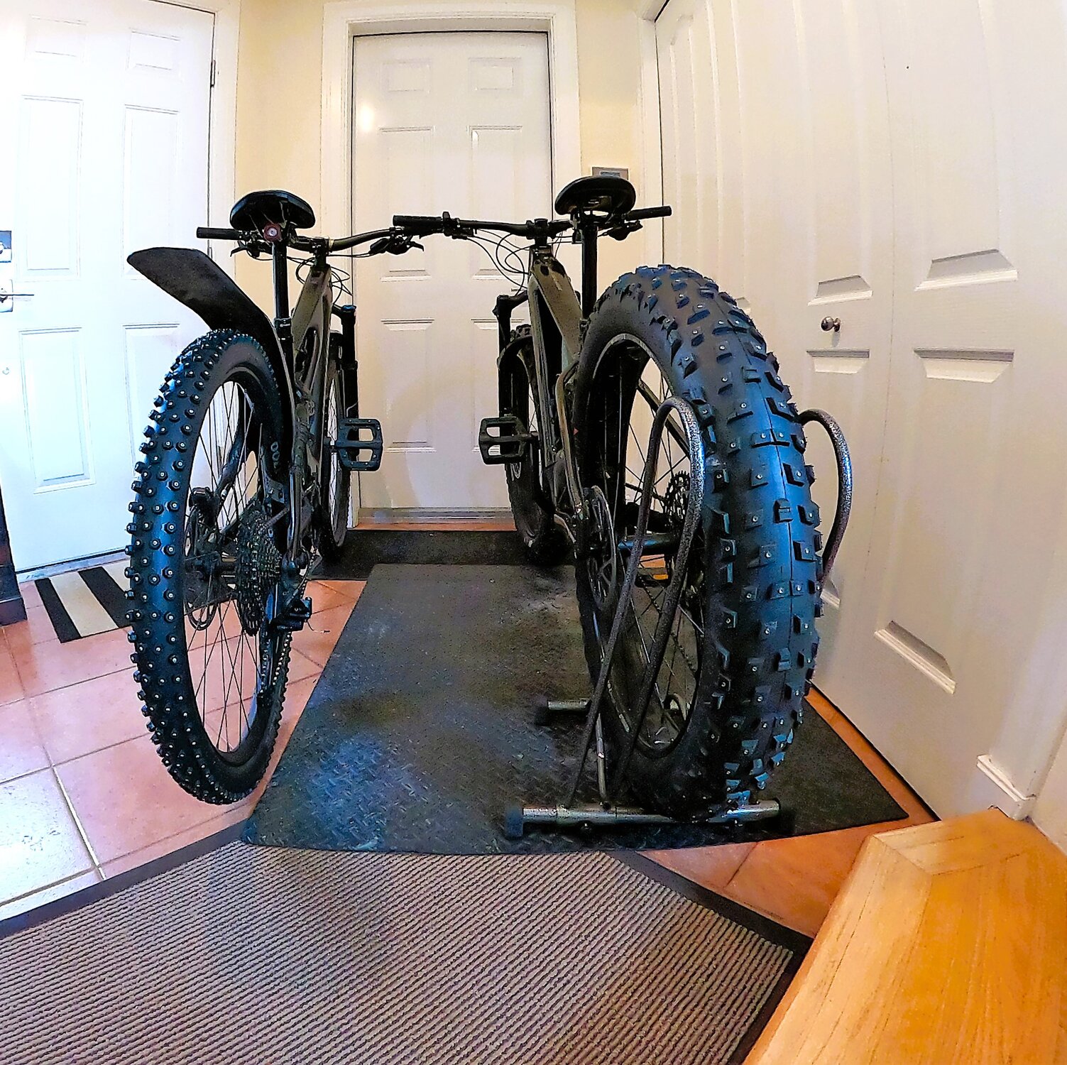

For that past 1 ½ winters, I’ve relied on my 2nd gen EP8 powered Norco Bigfoot VLT which has seen me crush through all sorts of conditions.
It’s a significant improvement from the emtb shod with narrower 2.25 Schwalbe ISP studded tires that I used to ride on. In fact, I can’t recall how many days (without the capability of a fatty) that were lost due to varying conditions which prevented me from getting out on the trails.

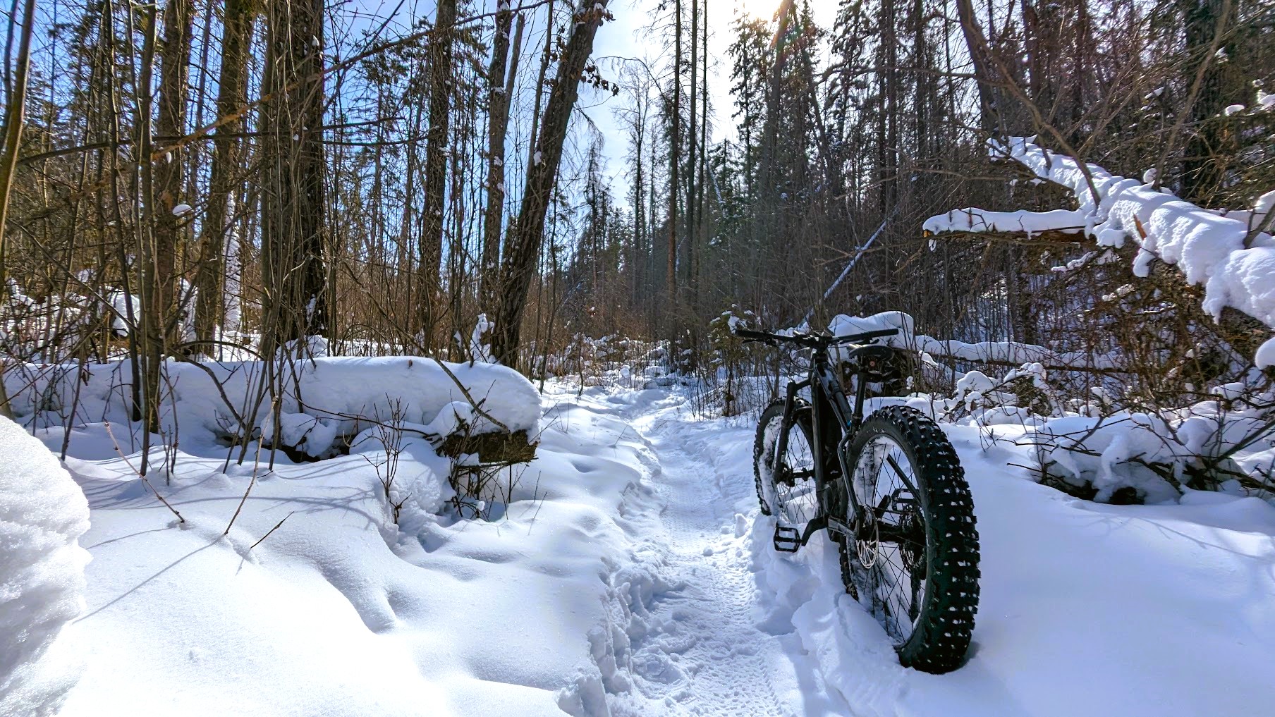

The Norco’s 4.5” wide carbide studded 45 North Wrathchilds certainly have plenty of grip on ice but its their wider stance, ability to run at extremely low psi and larger contact patch which gives one the ability to ride on top of snow and that is typically what sets a properly winter equipped fat bike apart from the rest of the field. Studded tires are terrific on hardpack or ice but do little to help when the ground is far less compact. If you have access to groomed trails all the better.
