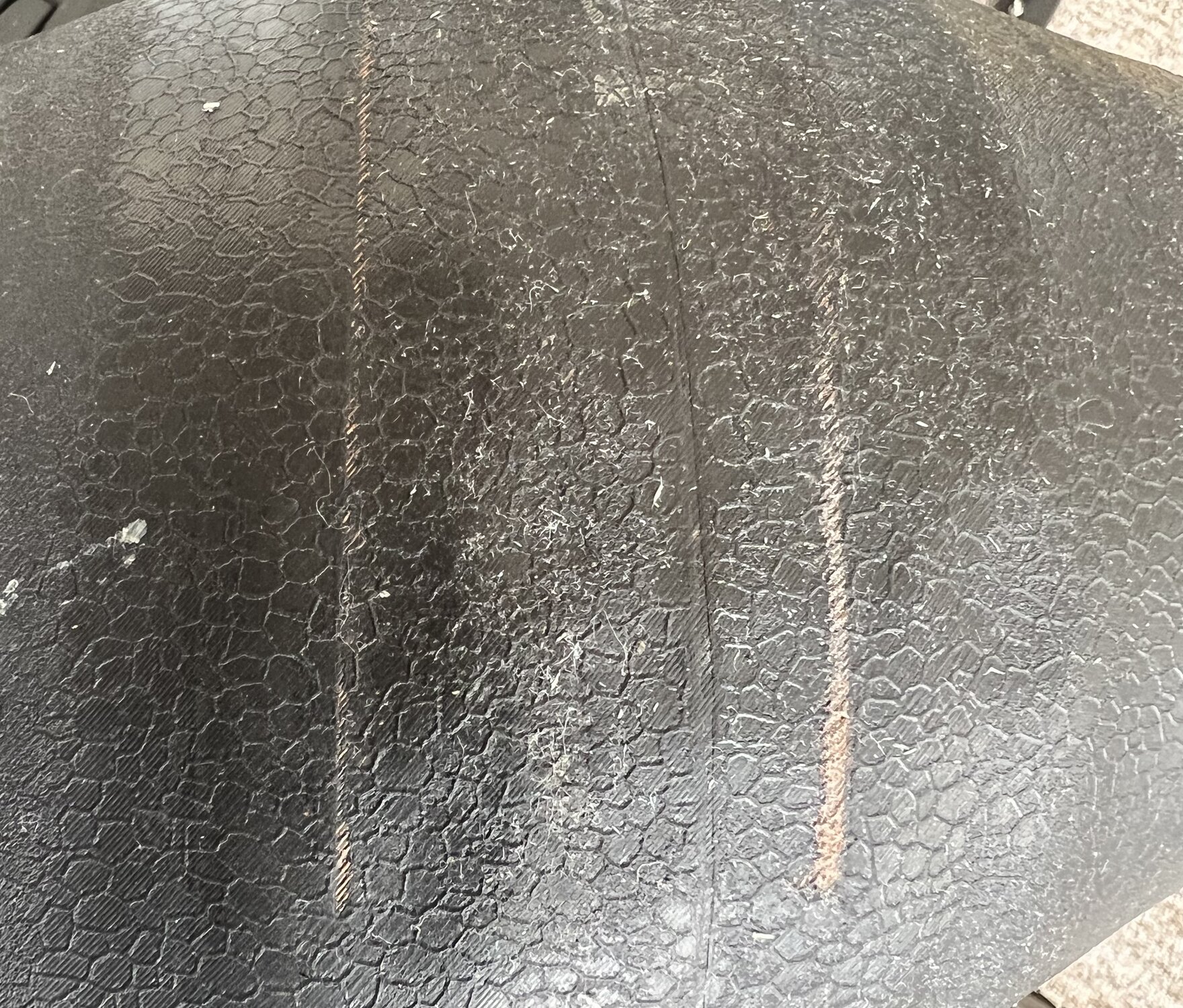

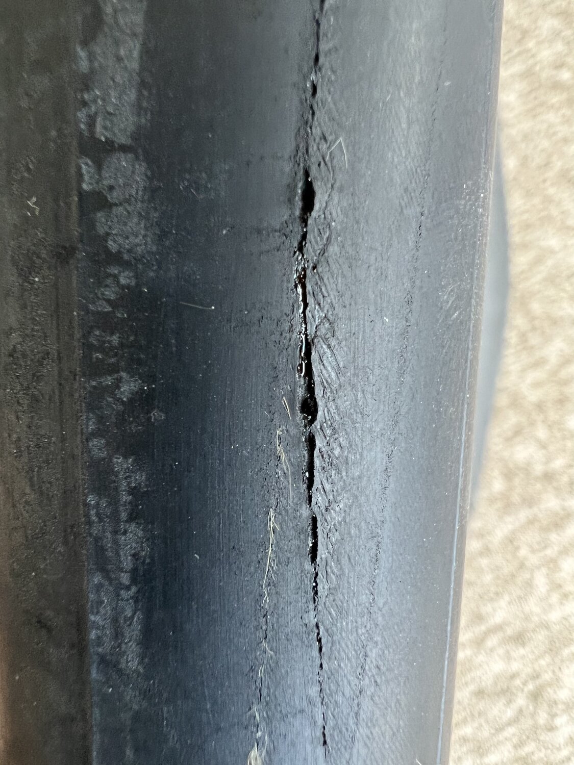

I changed my Johnny Watt tyres last year following some damage caused to them.
I was using some Kevlar tyre liners, which left grooves in the carcass, exposing the casing.
This also put similar grooves in the inner tube, which caused it to split open along the groove.
