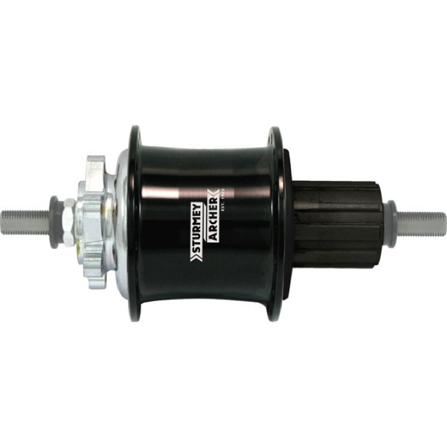

Bike packers go for the Rohloff because it is so dependable and it is sealed from the elements. I think the 14 is part of marketing. There is a market for people who think that more is better. 550% is quiet a range. Impressive. Shimano has nine eBike specific IGHs. Each is a five-speed and has a range of 263%. But, if you really want to impress the Jones's go for the Sturmey Archer three speed cassettte, disc internal hub and install a pizza sized nine-speed cassette. This will give you 27 gears and a ratio range of 680%.

@Johnny, You are on to something there that I totally overlooked! Use a duel chainring to the Sturmey Archer three hub with a nine speed cassette. That would give you 52 gears. One for each week for an entire year so it could serve as a kind of mechanical calendar. This reminds me of a Disc World character, and inventor called Bloody Stupid Johnson.
