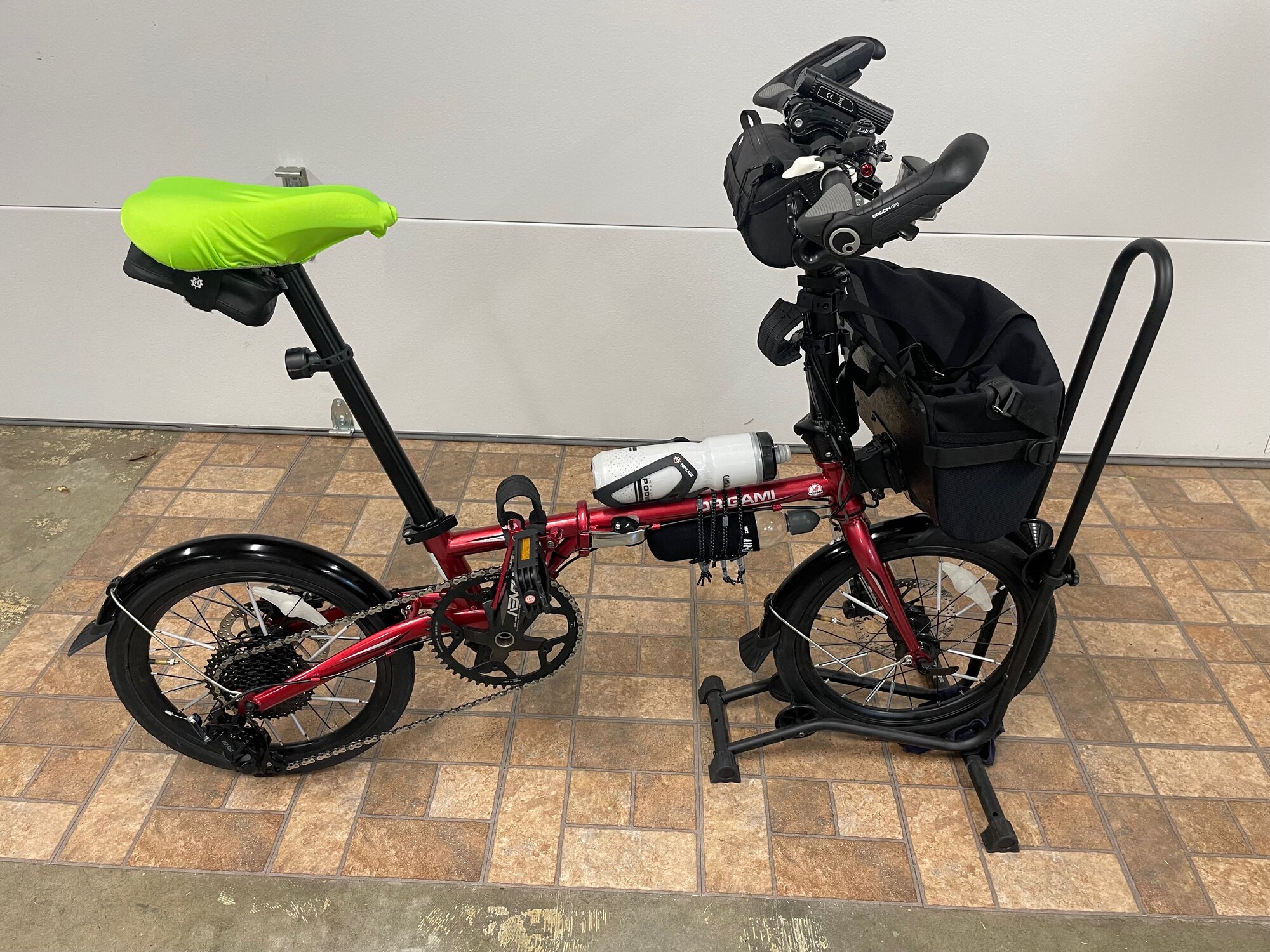

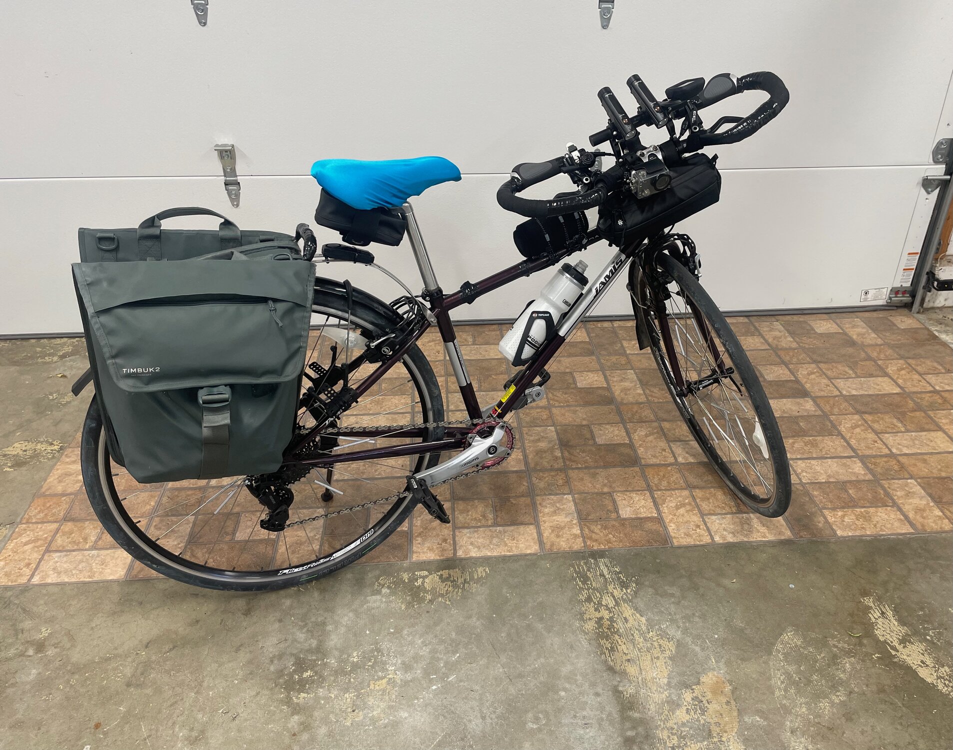

I have two bicycles: a 2012 Jamis Coda Comp chromoly hybrid and an Origami Lotus chromoly folder.
I'm 155 lbs / 70 KG.
Here are my questions:
1) Can the QIROLL adapt to either bicycle?
2) If yes, can I obtain multiple mounts to swap it depending on which bicycle I ride?

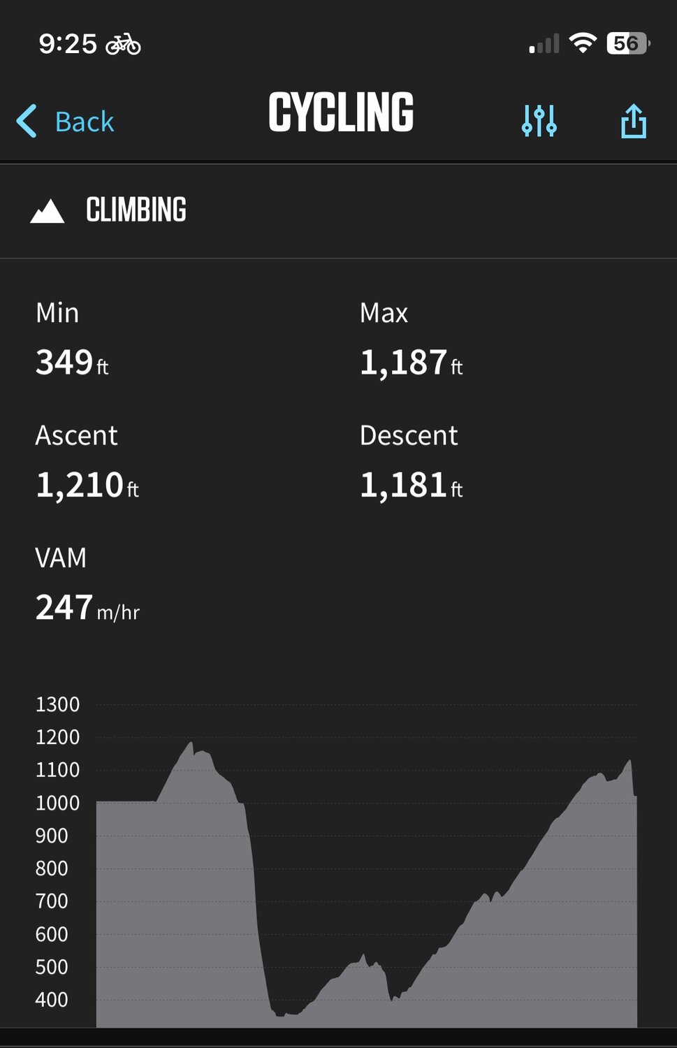

3) Will it help me up hills? I've attached a stat of my hill climbing, about 10 miles roundtrip.
4) Can the device be easily engaged/disengaged, or is it always on (always rubbing?)
5) What's the difference between the Pro and Mute versions?
Thank you!

@metanewbie,
I'm new to this as well. I just received my kit yesterday and installed it. My knowledge on this is limited.
I think the Qiroll will fit both bikes. Moving the whole kit from one bike to another is not difficult. The kit came with two sets of plates with two difference size and one extension plate. Going uphill you'd still need to peddle but it would definitely help. Once the screw is pushed in the bike the tire will always touch the roller. I think the Mute is the older version and Pro is the later version with more power.

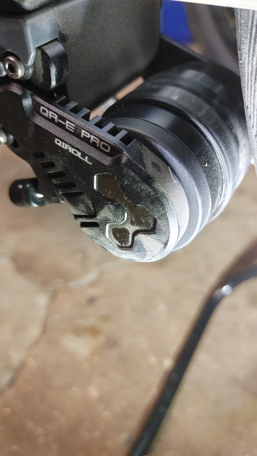

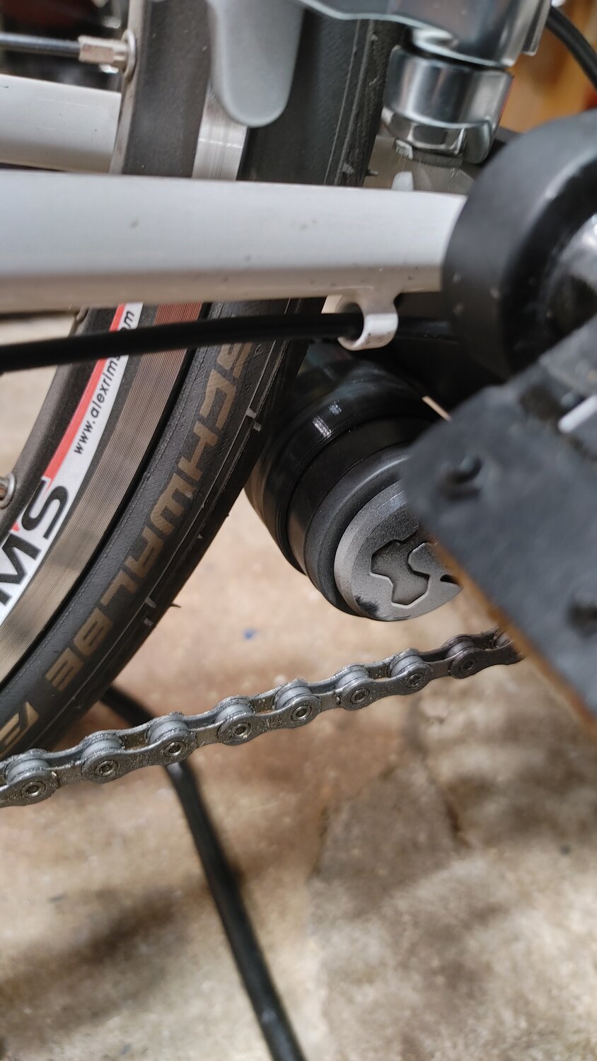

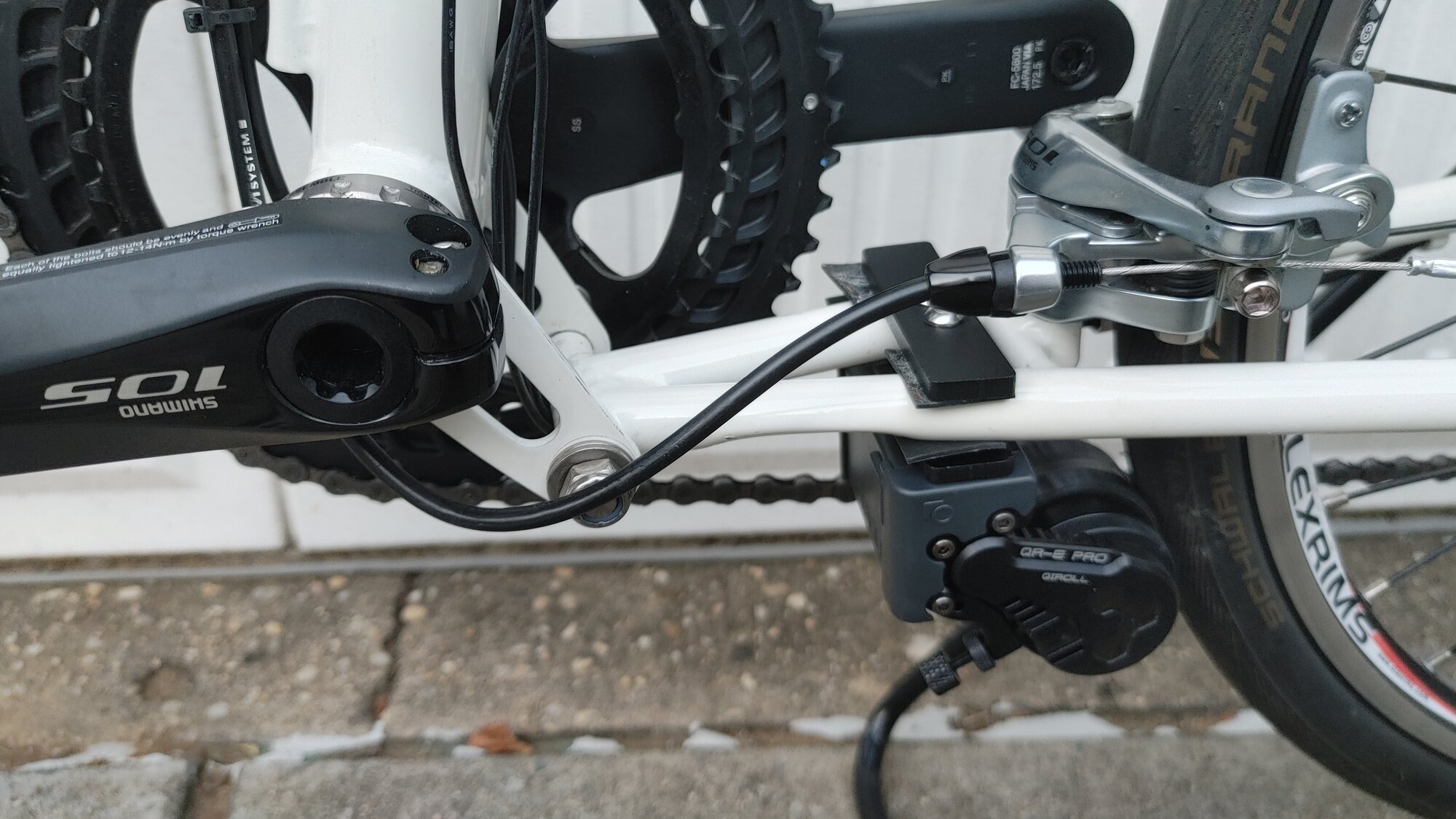

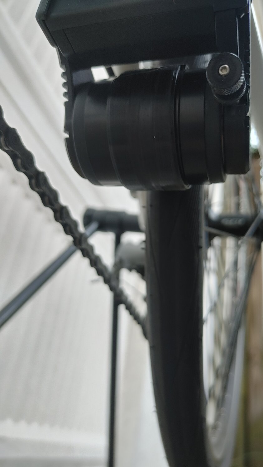

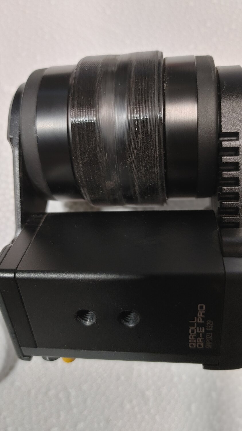

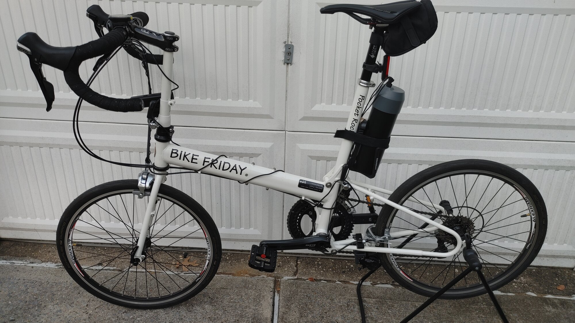

I just received this kit yesterday and tried on a Bike Friday folding bike. I tested for about 7 miles or so. I'm already seeing a groove forming on the original tape. Either I didn't position the roller correctly or the tape wears out very quickly. I can't seems to find a comfortable position for the S2 switch. I find my hands/fingers get tired very quickly pressing the square button constantly. Maybe it will work batter on a flat bar instead of a roadbike dropbar. I see a black steak on my rear tire. I think/hope it's the residue form he roller tape and not from my tire.

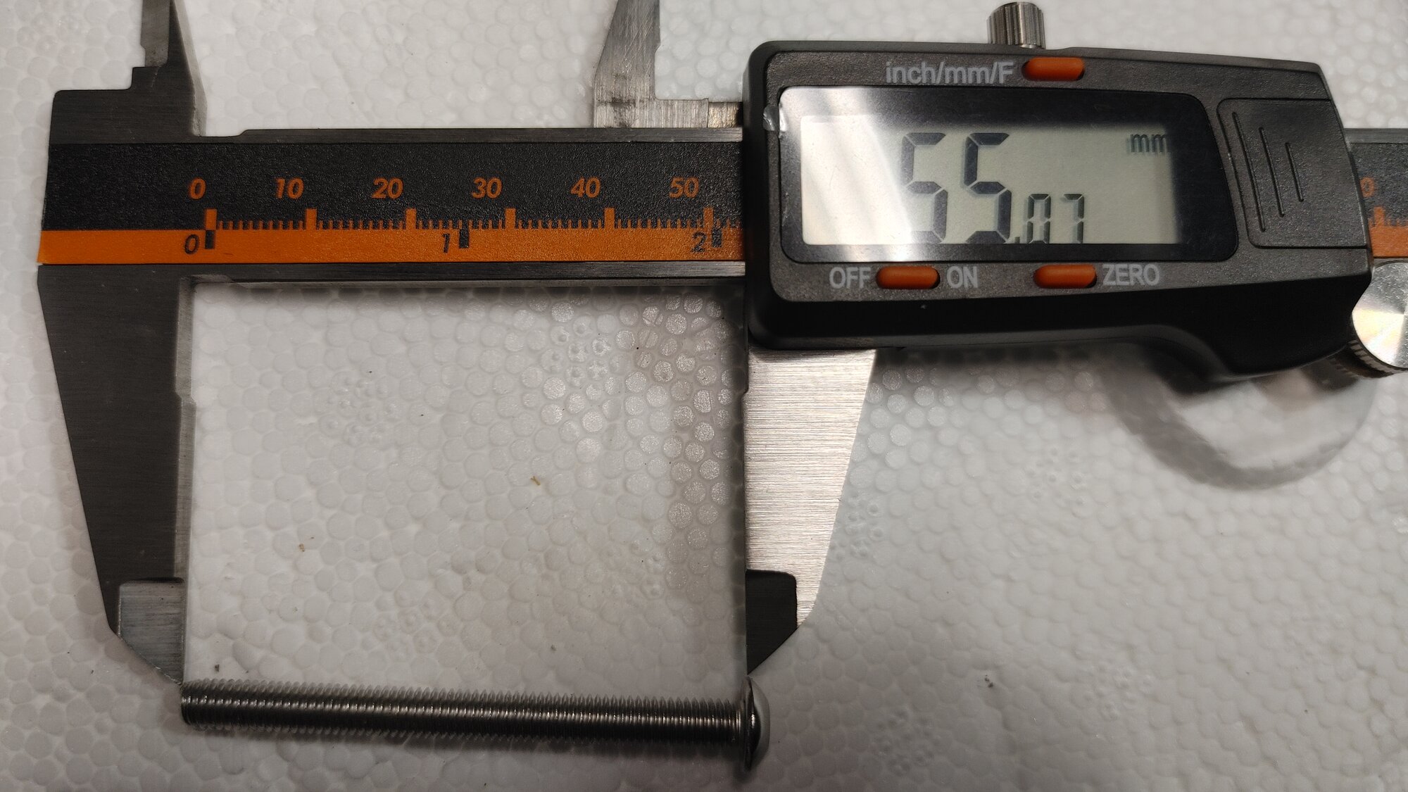

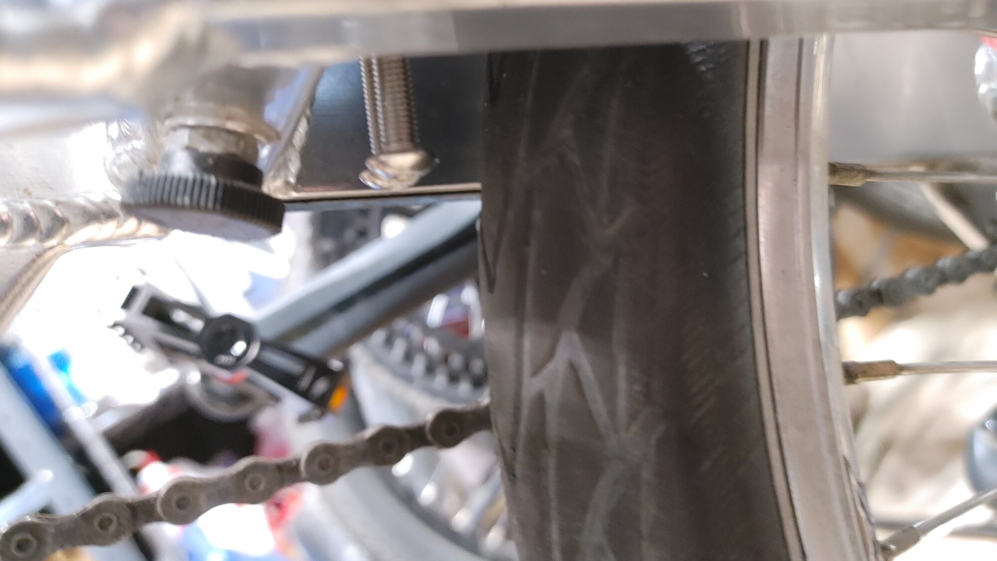

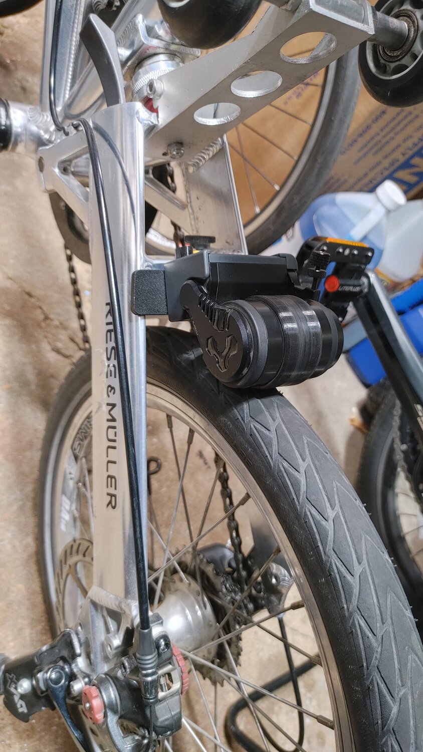

I want to mount this kit on my Birdy folding bike but the screws are too short. Does anyone know what size the screws are so I can go to an hardware store to get a longer screw? Thanks.

I just tried it twice. I have the Pro version with the B70 battery. I ordered directly from the Qiroll website. It took almost 3 weeks to get here. I find that the air in the bike tire has to be quite full/hard for this kit to work. When it's rolling, I rides great. I can get up to like 26mph or so on a flat road with me pedaling on my 20" wheels.

I would take the entire thing to a local hardware store and tell them what you need. If it has a well trained and friendly staff, they can help you match the screw/bolt types and sizes exactly, but longer as you need them.
It appears there is a quick release attachment that can be purchased, which I imagine would help with swapping it with diffferent bikes.
I'll try Ace's hardware. I might pickup some grip tape there as well.
Good idea. Someone posted the exact model and brand of tape they use. I'm sure ACE will have that or similar. Good luck, and looking foward to your results.

Given the elevation profile that you posted the Qiroll might not be the best choice. Depending, of course, on how much assist you are looking for. I live in a very hilly area and the Qiroll isn't helpful while Tongsheng TSDZ2 torque sensing mid drive works great on the same rides. Recently I rode 60 miles around the Crater Lake area with 6500ft elevation gain using the TSDZ2, I wouldn't have considered it using a Qiroll (Mute).

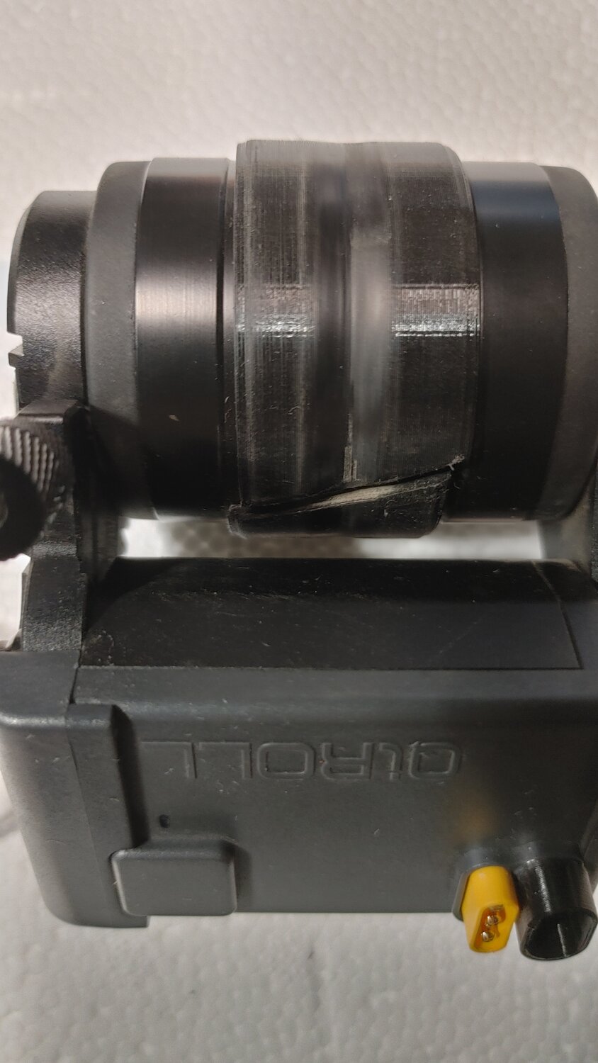

Qiroll advertises the S2 controller as an upgrade over the S1 but I'm not buying it. It gets tiresome having to press a small button continuously for assist, I found it difficult to consistently and accurately actuate the button especially while wearing cycling gloves. The discontinued S1 with lever actuation looks to me to be a better mechanism.

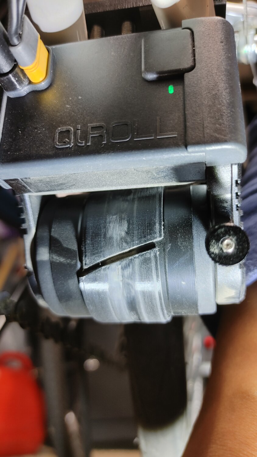

The friction "sticker" is a near complete failure and that opinion has been echoed by others. Qiroll needs to do better.
