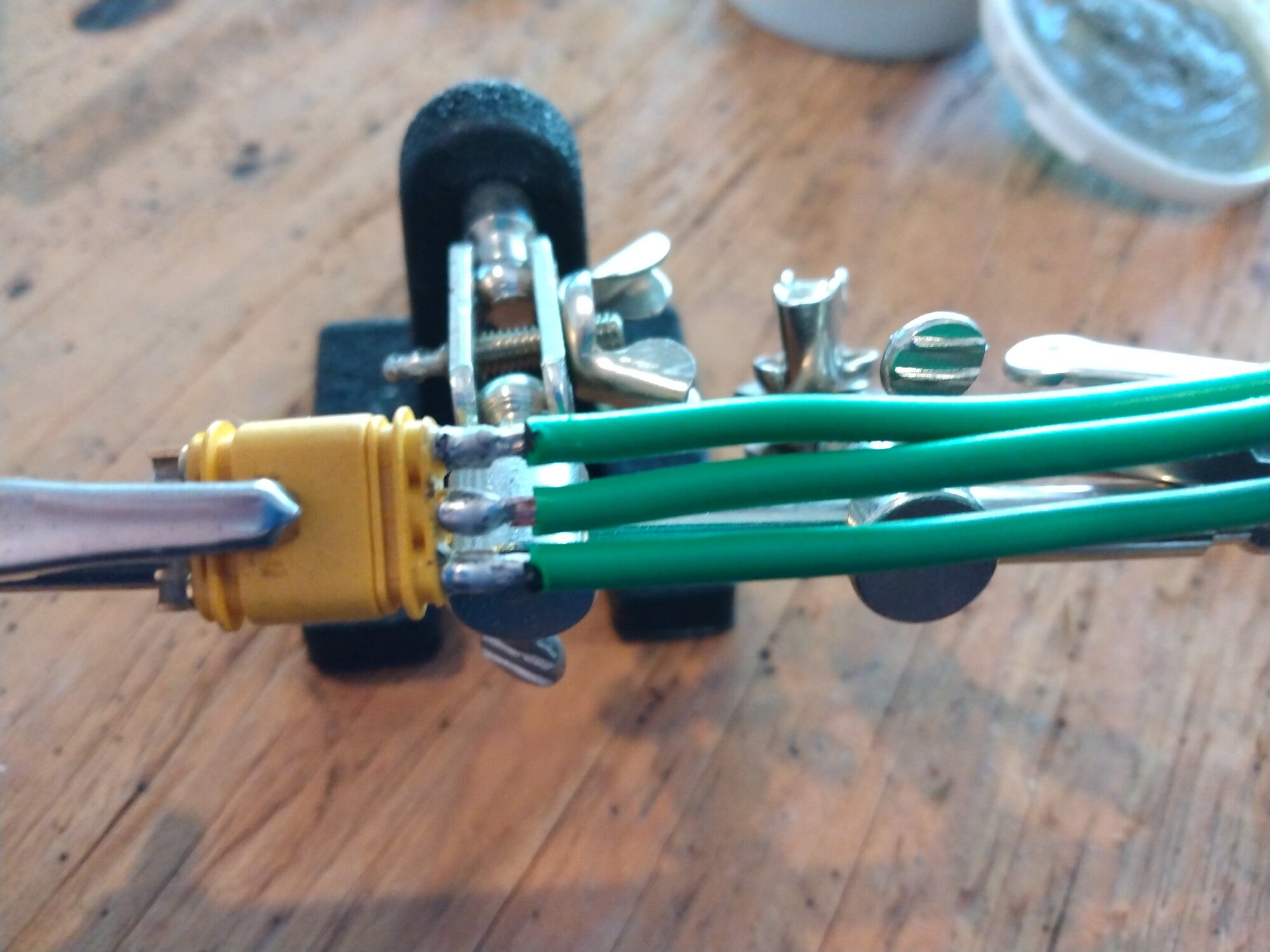

I'm not aware of a performance difference but I've been mostly riding with only the default "electronic clutch" setting rather than the two higher settings actuated with the button control. There is a decent boost with only electronic clutch and I don't even have to pedal at low speed with that setting. 16g wire has over 1.5x the cross sectional area as 18g and depending where I mount the battery I can use a cable 1/3 the length of the 24" Qiroll cable. So I guess resistance should be proportionally less. Soldering 16g wire on the tiny MD30 connectors is tedious but doable. The connectors might be the main cause for resistance, I don't know. I haven't kept track of mileage vs residual battery voltage. A voltage monitor could be wired on the power cable easily enough using positap connectors to splice in but I'm not currently inclined even though I have one in a parts bin.

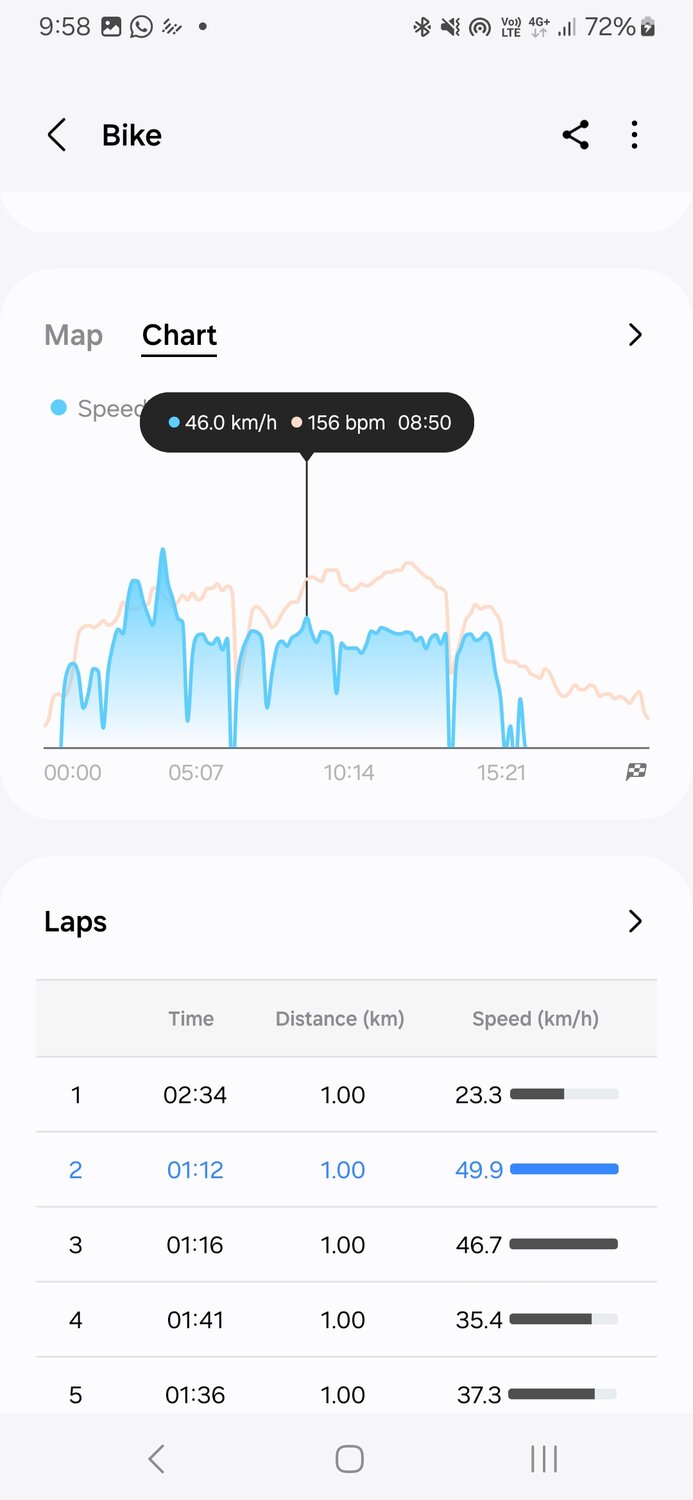

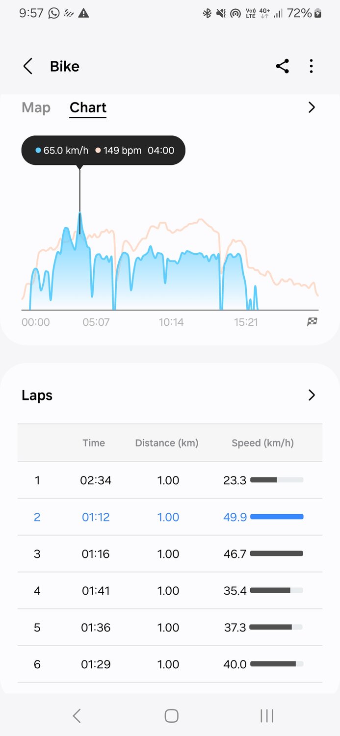

[Morning commute] - New QR-E PRO V2 performance stats (human + machine).
Did some performance measurement on new QR-E PRO (version 2) and how my body handles throughout pedaling commute to work today (with some stops at traffic lights and few slow down at traffic). It seem the new unit perform better than older PRO model at certain level.
  • New PRO have less amount of roller drag allow it to exceed 65km/h speed with rider's moderate heart rate at 149bpm. (i was chasing and drafting behind some big trucks)
  • On open road i could go up 46km/h speed with my heart rate at 156bpm + headwind, pretty much standard all the way until i reached my work place.
All i can say its easier to pedal without resistance from the roller compare to my older model based on the chart attached (Recorded via Samsung Galaxy 4 watch). Surprisingly this even having a small 320W QR-E PRO unit that performance is equivalent to the same performance + (PAS) pedaling i did on my over weighted BAFANG 750w mid drive that was previously installed on the very same bike before i made the switch. That's awesome!
Chart:

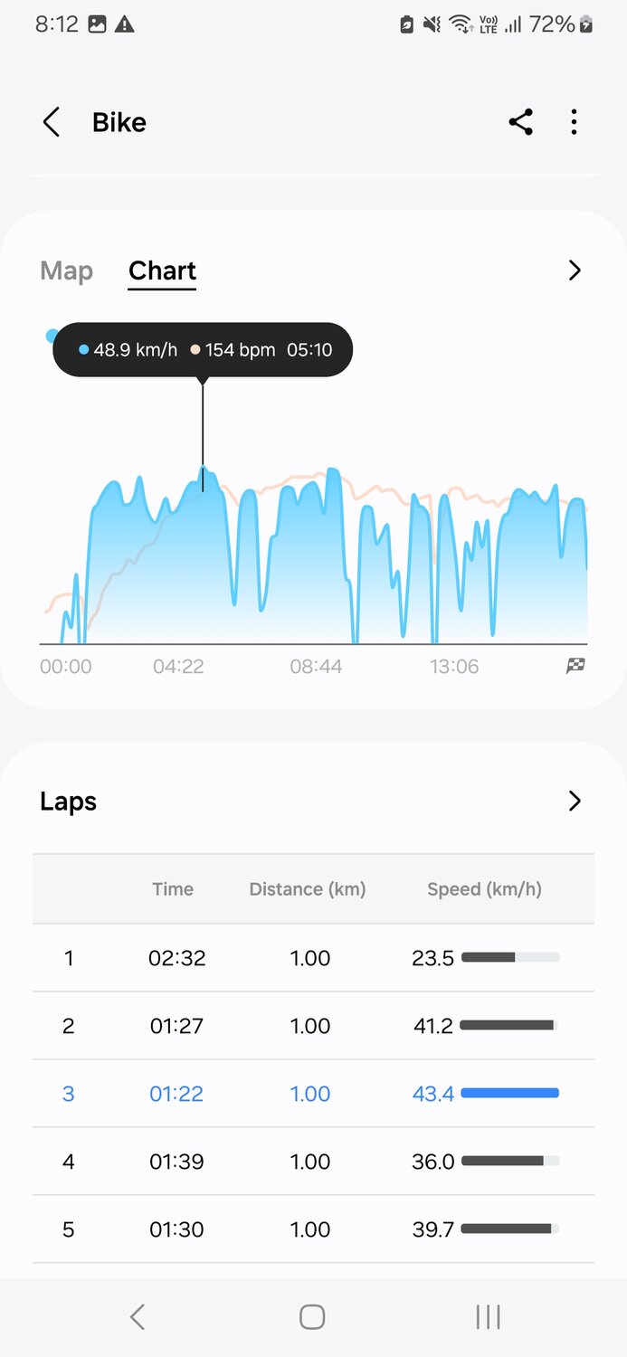

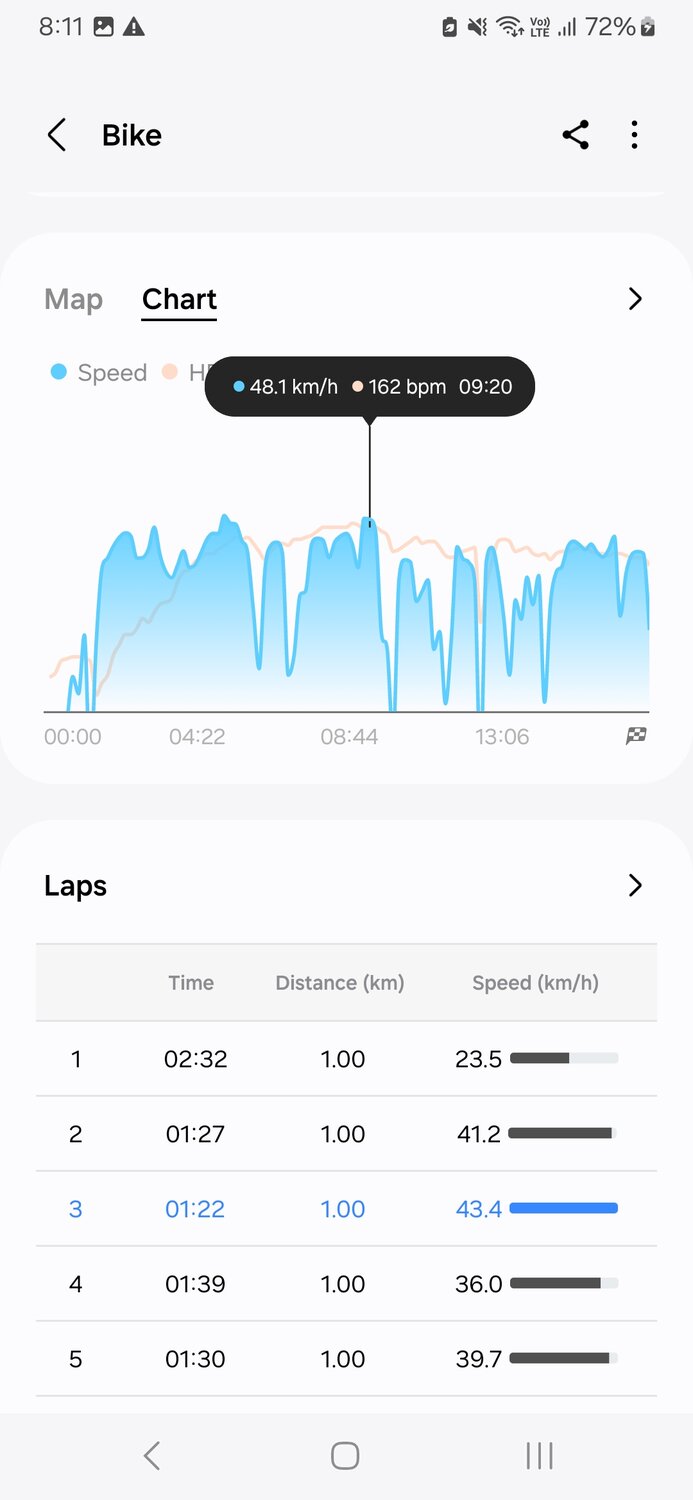

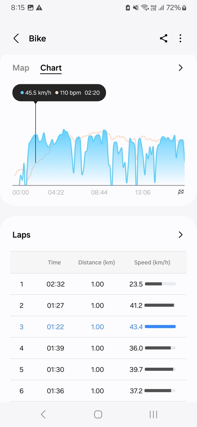

[Evening commute return home] - New QR-E PRO V2 performance stats (human + machine).
This is today evening performance chart as i ride back from office. Its seem each day the new QR-E PRO V2 seems to improve lot better after many cycles. Now its easier to accelerate at peak 45km/h~48km/h in an instant as shown from the latest chart i posted below:
Unfortunately as posted previously the roller bearing on new PRO (V2) couldn't handle the stress of speed and started to make crackling sound. The old PRO (V1) have much tougher roller bearing, does not making crackling sound but instead it started to sound like my RC electric jet engine after 2 years of usage. Now awaiting for the support to provide answer and solution. I think both QR-E have its ups and down. However the PRO have good potential as Ebike kit only if they put more quality control on the manufacturing of the roller mechanism/bearings.

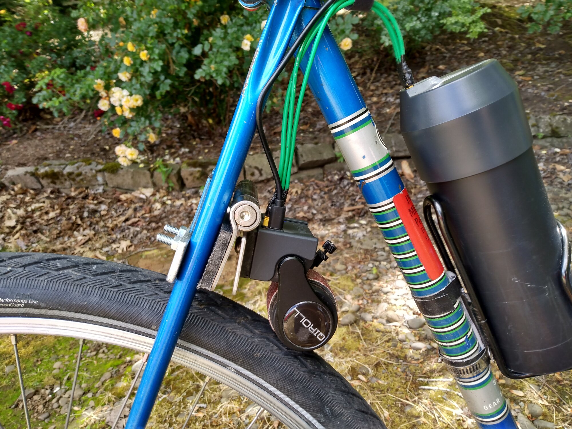

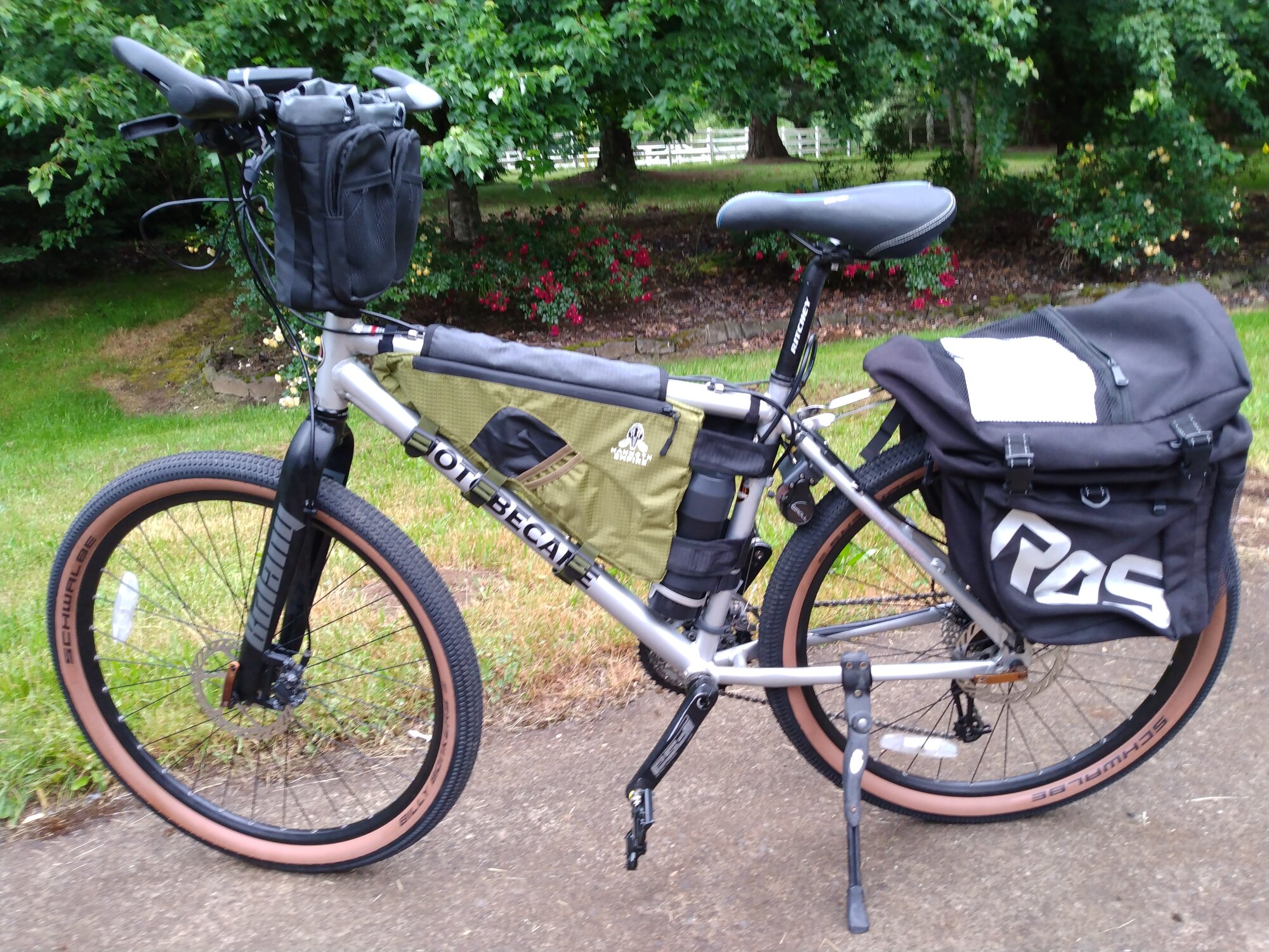

Since my knee isn't well enough to do any long rides I spent some time installing the Qiroll on my old steel frame bike that has a lot of room for easy installation on the seatstays. This 4"/10cm self closing door hinge works excellently well. Even better than the self closing gate hinge that I used before. Good adjustability and no hint of slipping (with the belt sander abrasive belt).
Nice Motobecane bike setup, looks like the bike build for long touring trip. I notice you have very long crank arm, based on my experience it does cause me knee pain...so i have shorten to 152mm crank arm length and got me optimal spin without knee stress. My MTB (Bafang) running at 155mm crank length while the white bike MERIDA (Old QR-E Pro at 160mm crank length). Btw i'm a very short rider.
You're right, 175mm crank arms on that bike. My other bikes have 170mm crank arms which seems to be sort of a default standard. I'm not sure how much difference the extra 5mm makes but it does seem like my knee is bent more on the top of the pedaling stroke with that bike. I might check Amazon for an inexpensive two piece hollow triple crankset with 160 or 165mm arms.
