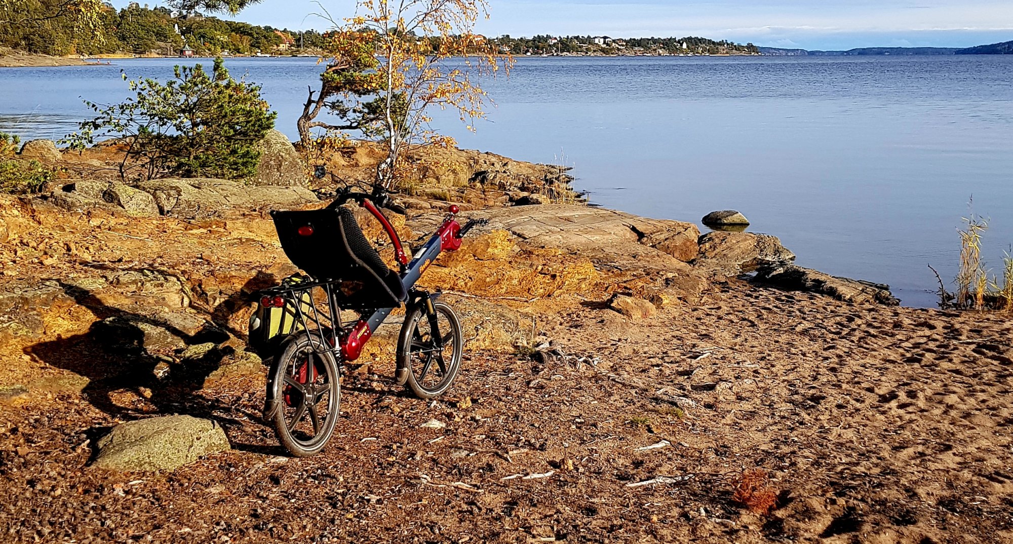

Hi Miro
It's a very unique bike for sure! As I mentioned in my other post I have a velomobile from the same company, and I just love their attention to detail and how they go back to the drawing board and re-design a bike from scratch. The quality is superb, and the enclosed design makes it a perpetuum mobile. I bought it second hand from a friend, and he's hade it for ten years and used it a lot. It was also delivered from Lübeck in Germany to Stockholm Sweden by the shop owner who cycled it here! So when my friend got it, it was well run in and tested. When I got it I opened it up, and the chains and sprockets were in mint condition! The only maintenance you have to do is an oilchange in the gearbox every year or so.
This is a bike made for care-free everyday use and long distance touring, the focus is on comfort and reliability. So it is not a lightweight bike at some 14kg stripped. It's not foldable, but for a trip it is possible to break it down in several steps by folding the frame and removing the steerer, seat and wheels. I have a carrier and a big bag that hangs at the back of the seat. For touring I also have recumbent banana bags that hang under your arms like very comfy arm-rests. If you want to read more the shop where it was bought has a lot of info, I guess you understand German: http://www.flevo.de/Entwurf_Flevobike.html I will be happy to provide more info if you want!solsidan.jpg This is my bike from a day-trip to the near-by Baltic.

Just by looking at the picture it looks like there's space enough for OM with mudguard removed of course. It would be mounted on the front fork. Though even with mudguard I think shouldn't be a problem as brompton got it too but I'm not sure if also that long.
O, yes - the kickstand can be the solution
if it is a standard kickstand flange. The mount for it is a standard feature, easiest mounting procedure, just 1 bolt. The battery can go onto one of the water bottle studs pair, that's also standard. The Bluetooth signal is fine, I tested it on the distance of 6 m.
You'll have to find a suitable place to mount the hand controller, tiny unit usually mounted on the handlebar. There are several functions you set by this unit (assist level, motor to tyre pressure, retract modes, regional modes such as US, EU, Canada, NY ... one of the functions you're not allowed to use inside EU, though it's there: the throttle). You may opt not to have this controller altogether but to use your phone instead with large display, communicating with OM through simblee for mobile. Although I strongly would recommend the hand controller.
