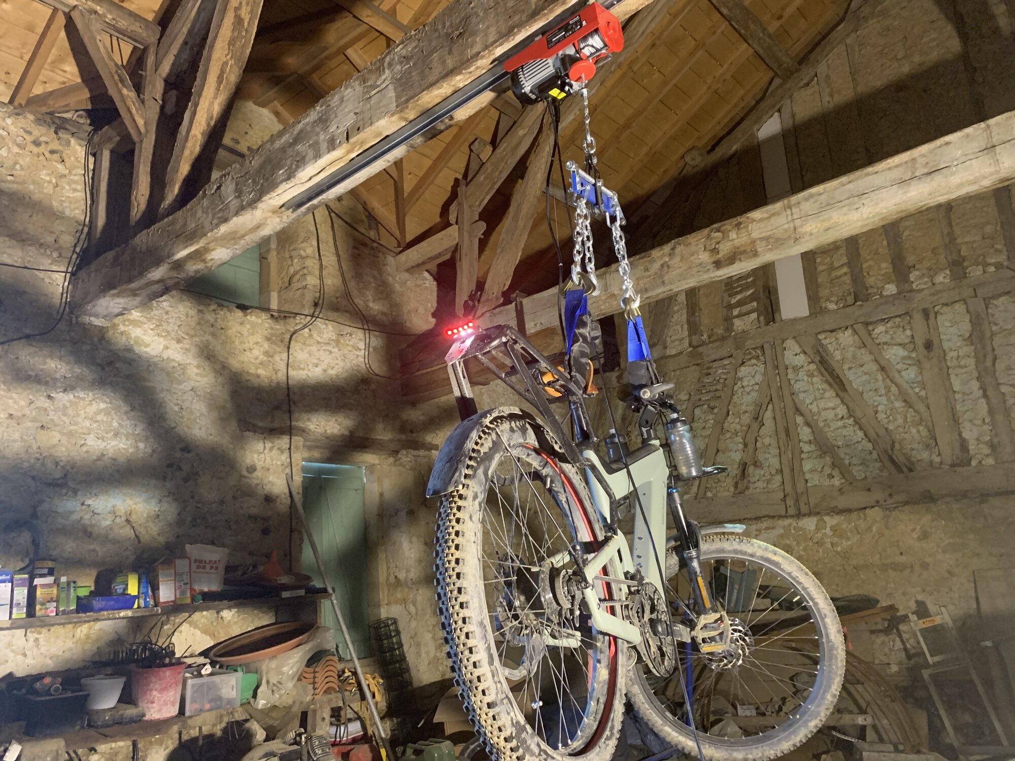

View attachment 83733I found the Superdelite too heavy to get onto my Park Tools stand so I mounted a winch. I find every task easier if the bike is at the right Can slide the winch along the bar.
I have the same bike and a Park stand as well. I found that if I take the batteries out I can lift it into the stand without too much grunting. With the batteries installed, forget it!
I love that garage! May I ask how old the walls and timbers are?

The house is late 17th century but we believe that the barns are later around 1830. The wood in the roof is typically much older as it was reused so we have lots of wood from the 17th century.
