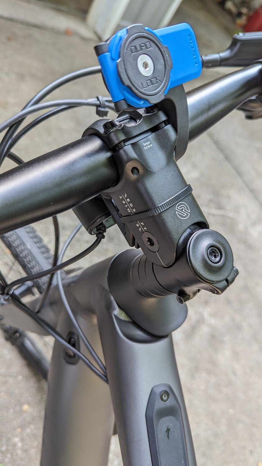

It looks good to me, however, I have never held one of these in my hand(s). This is the only photo that I have. Those with knowledge....can you take a look and let me know if you see anything that looks out of place and/or missing?

Does this stem look complete to you?....It does to me assuming that the "preload wedge" is inside (I can't see from the photo but will check in person).

Looks ok from here. I bought the 30 degree models for more upright riding. If it fits your bike you will be fine. Not too complicated of an accessory.
It looks complete. The Preload wedge is surely inside as the stem is assembled. There should be five elastomer pieces total and I think two of them are inside the stem. There is the instruction manual on the Redshift website and a very good assembly video on YT. Perhaps the seller can provide the printed leaflet to you. I am sure you will have to replace the elastomer pieces (you will probably need a single one, the colour is specified in the user manual).

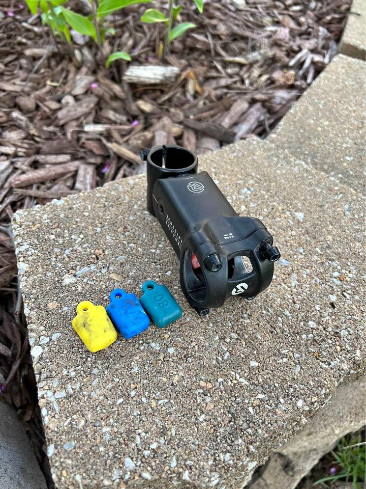

Looks right enough to me. I bought a used +30 a while back and it had almost nothing except what was inside, so I ordered a new elastomer set from redshift. Everything else sort of comes on it, as long as it’s already assembled. Make sure the lock washers for all the bolts on front and head tube side are intact with the seller? Should be 6 total.
Got it! To my surprise it looks like new (the seller's photo made it look dirty and used). The elastomers look new. The 6 locking nuts are there. All bolts are present. The plastic tool and bolt for wedge install/removal is included. I should be good to go. The gent that sold it to me re-purchased the same stem in a 120mm version. $50?....yup....all is 'right' with the world today.

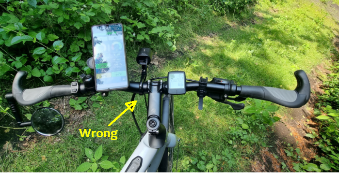

The first version of the Lezyne light placement after the purchase of the Redshift ShockStop stem. Wrong orientation. The Lezyne is directional.

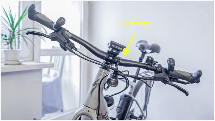

The second iteration. Added Redshift ShockStop Computer Mount and a Wahoo, relocated the GoPro mount for the lamp as to have the Lezyne in the proper orientation.

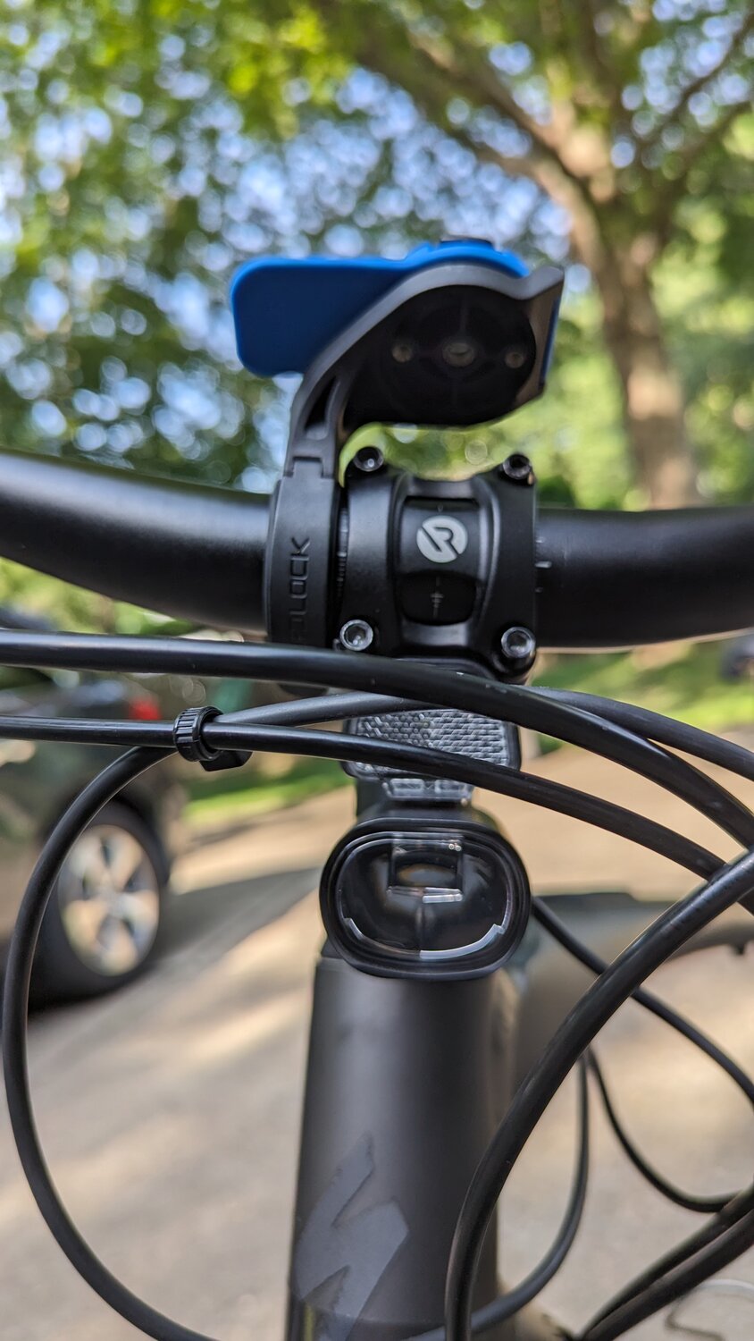

The third iteration was adding the Redshift ShockStop Utility Mount with a piece of rubber as a shim, and having all the items eventually located centrally. It took me some time to find the best solution :)
