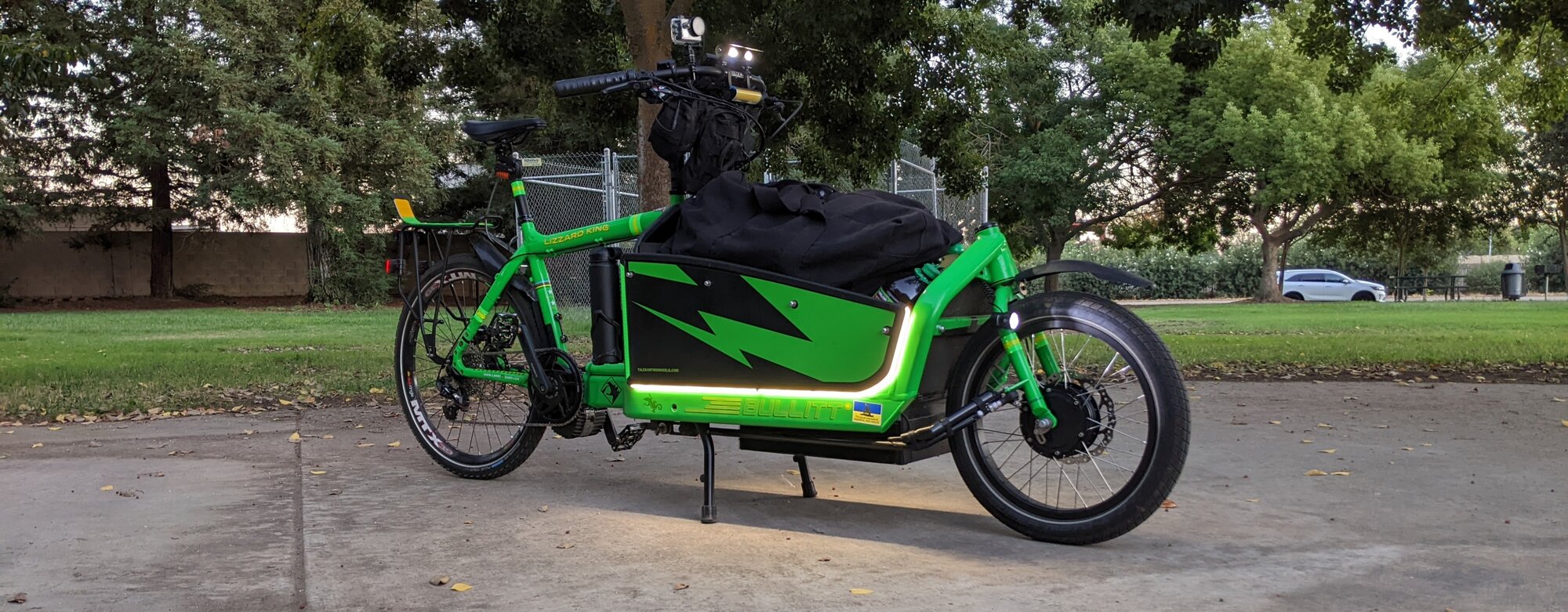

Most recently, I blew the budget several months ago and on my Bullitt I subbed out the 3 lights up top for a Fisher Fab House BBSHD-connected headlight. This thing goes from 75 to 3000 lumens via a 2-beam housing that contains one spot and one flood, side by side. I like it... but its about $250. I would not start my exploration of options with that one.

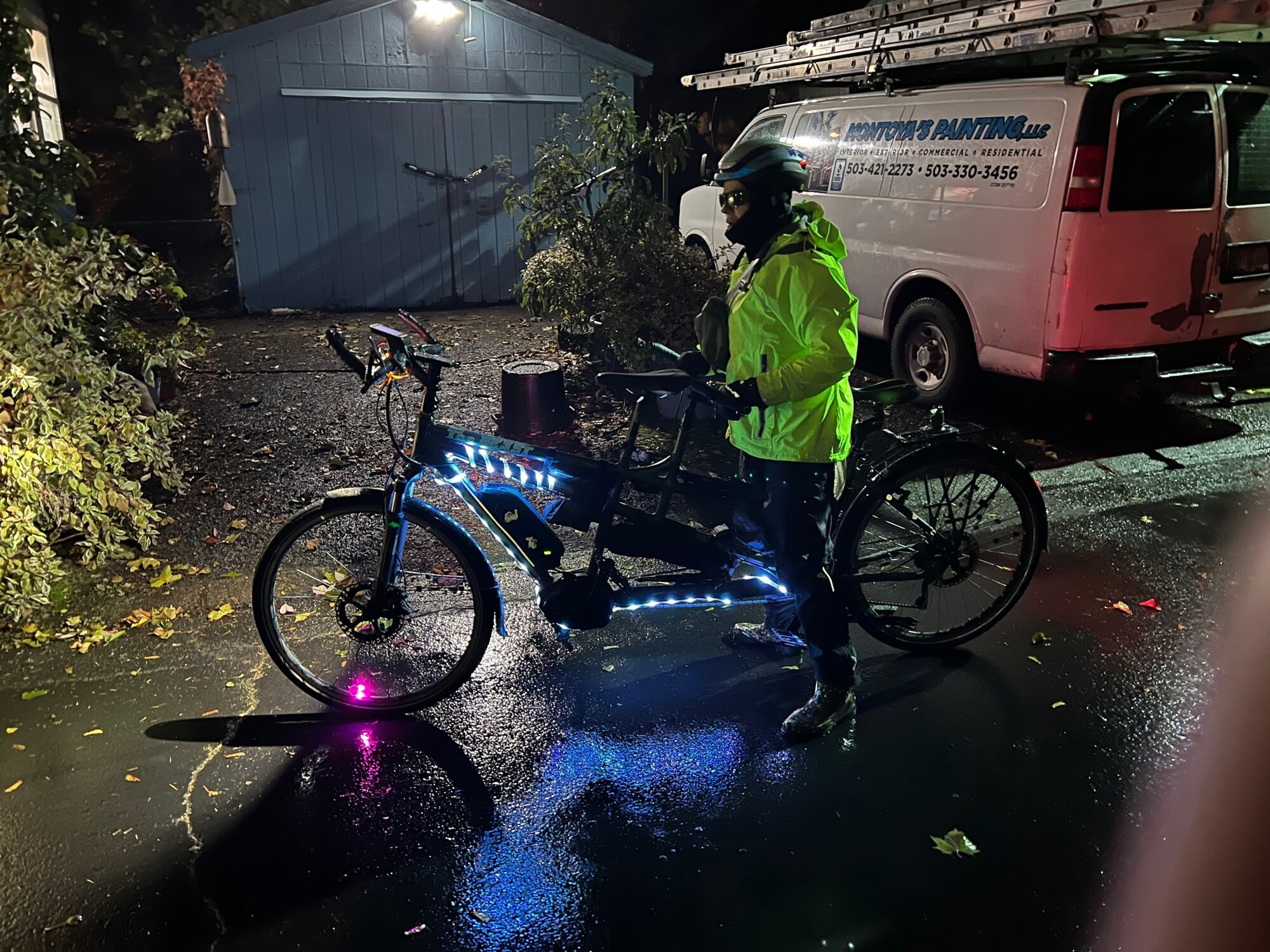

the trek headlight is really good. nice and wide and low. it has a ligh and low switch. I think it was 250 or 300 but cant remember for sure. I had it put on our tandem. I had a lights and motion 800 lumen its not bad but its the typical round circle. the trek light works on unlit bike paths pretty well. plus since it runs off the bike battery no worry about run time. but you would have to go to trek I cant fin it on their webpage.

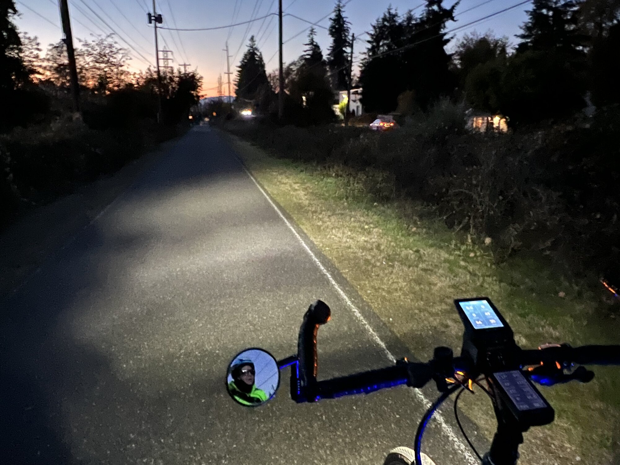

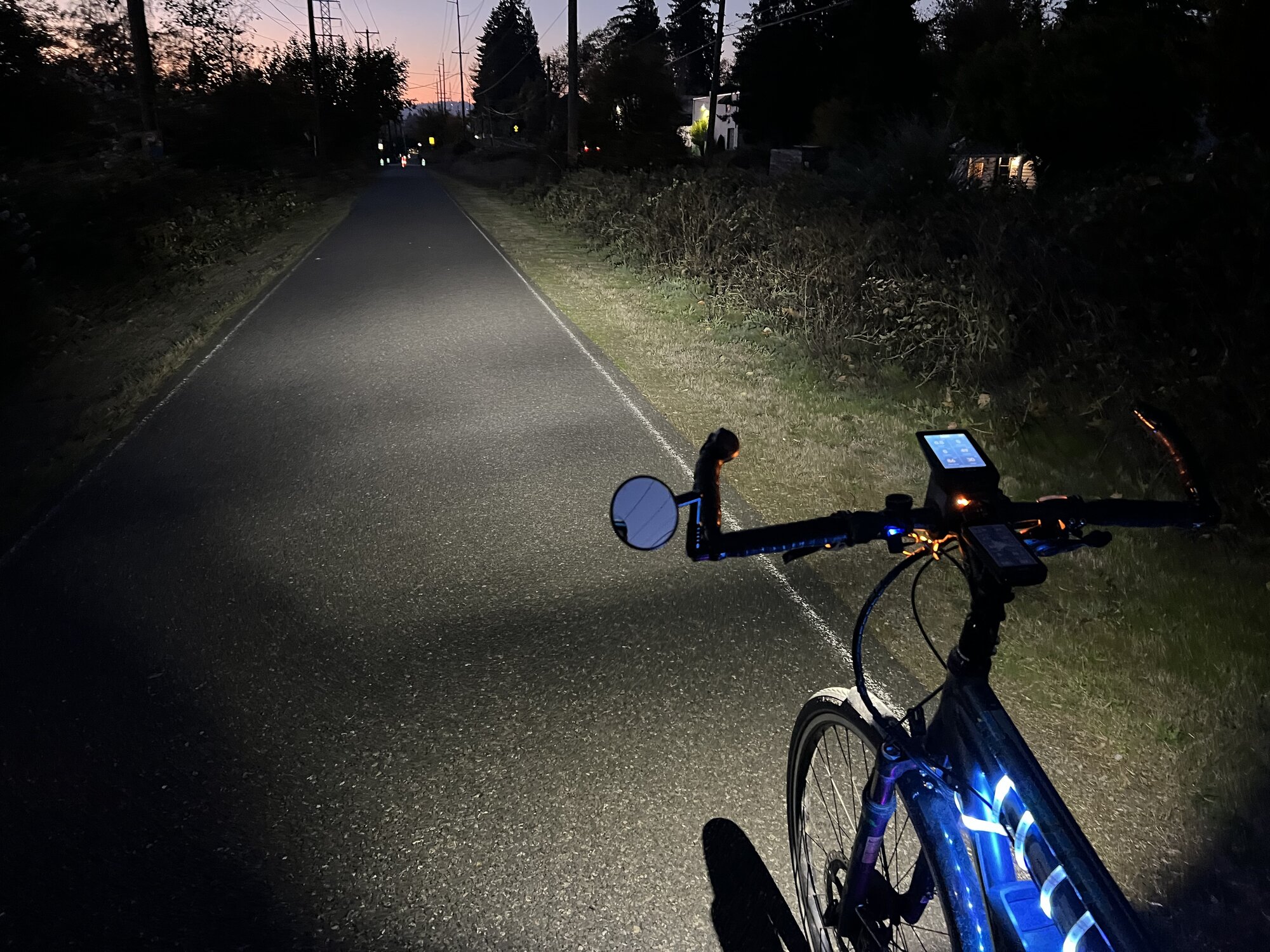

COB lights! Super cheap and super easy to install. I did a full writeup on what/how I did it at my web site. I think I paid $10 for each strip, and they are connected to a single 10000mah power bank from Amazon. I have another set sitting and waiting to install on my new bike in exactly the same way, except this time the ones I bought have built in on/off and dimmer switches. They light up the lower side of the bike like its a billboard, and create a moving blob of light on the ground that makes me much more visible to traffic.
This pic only shows them at twilight so reduced effect. But its recent enough you can also see that bike-powered Fisher Fab House light up top. The blinding look of the lights is NOT real. Thats an artifact of the camera. They're bright but not problematically so.

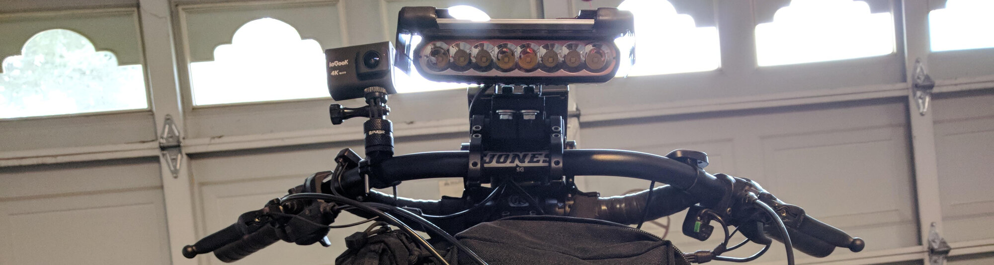

Another light that I did that could be categorized as a sort of 'light bar' is this one. I made a beam cutoff for it and it had its own mini-sized 52v battery. It works on 9-60v DC so you can use almost any ebike battery to power it. This sucker is 40w of LED power. I used a bar mount for offroad lights and just bolted it directly to those, and in turn those bolted to a simple handlebar extension (just going straight to the bars would have worked but I wanted it up higher and set back a bit). We are talking surface-of-the-sun bright here. Beautiful for trails. Not for the street. You will light up the next ZIP code with this thing, which has a mixture of spot and flood bulbs on that lineup. Only runs about $30 on Amazon but you need to spend some time and money on additional parts to make it mountable, then give it a connector that will match your battery. And of course add a battery.

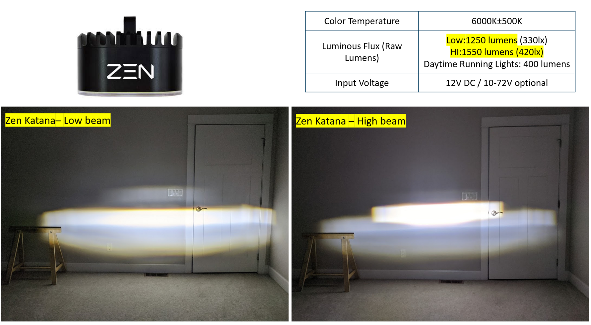

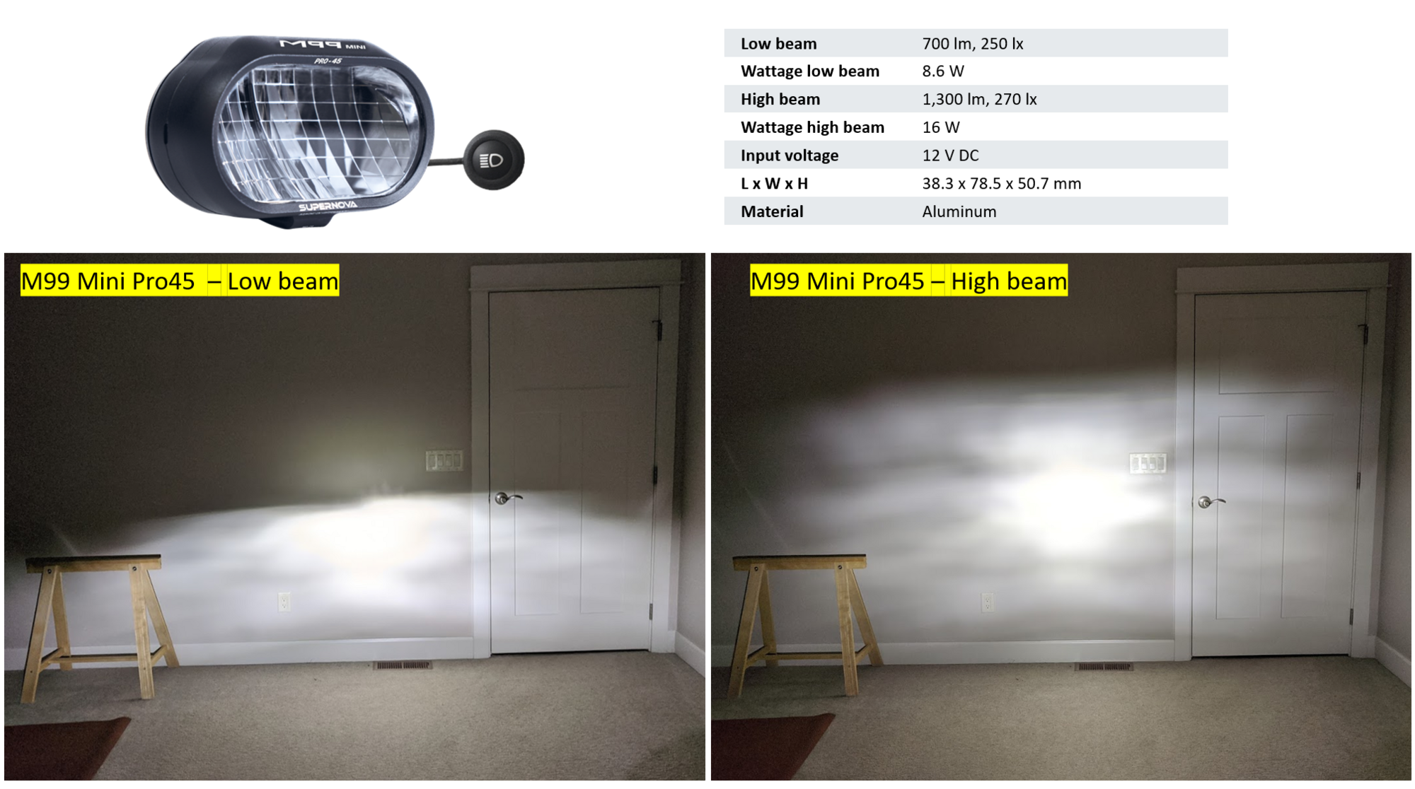

We have a solution for that. See the images below.
We use Supernova M99 light on all our Bosch E-bikes, and they offer excellent illumination and beam cutoff that doesn't bling oncoming traffic!
happy to offer if you ever need one.
We also have a custom light that is even more powerful than Supernova but I am not sure if it is compatible with your Vado.

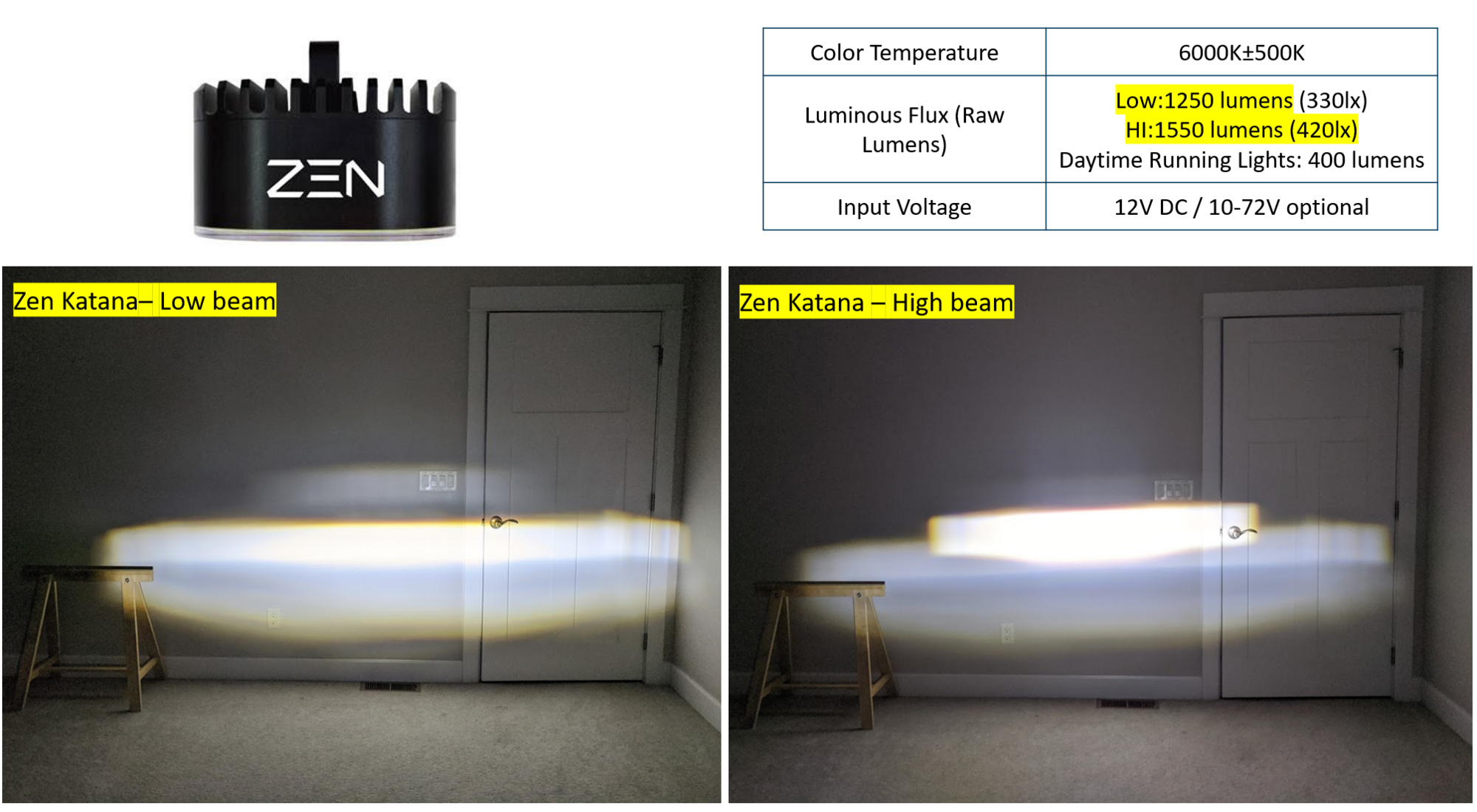

@Ravi Kempaiah thank you very much for this! That Zen Katana looks perfect for what I want - I was thinking along the lines of a proper SAE foglight for autos, and the Katana seems to mimic that for our bikes. Let me research it a bit more, and I may end up reaching out for one. Thank you again!
I did not see any specifications for the Katana on your website. The stock light on my Vado is a Lezyne Mini STVZO E65:
Wattage: 4 W
Input voltage: 6-12V
I presume the Katana is 12v, but what kind of wattage does it reqire? (I have no problem cutting existing wire and soldering new connections)
Yes, happy to offer it if it works for you. We don't sell it normally, but happy to help out a fellow EBR rider.
It depends on how much your motor controller will support in terms of Watts.
Please check Brose -specialized motor light output wattage; if it is up to 18W, it should be ok.
Here are some specs that may help. Please check the electronic details and image below.
Low Beam: 13W / High Beam: 14W
Daytime Running Light: 5W
Low Beam: 1250LM (330lx) / High Beam: 1550LM (420lx)
Daytime Running Light: 400LM

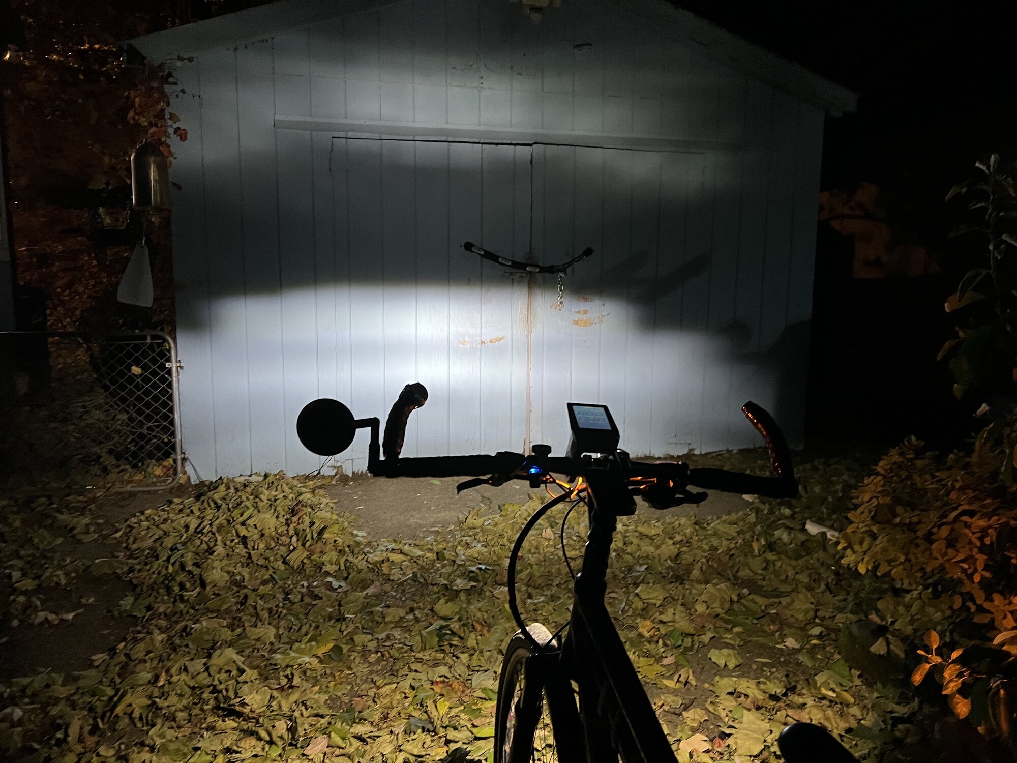

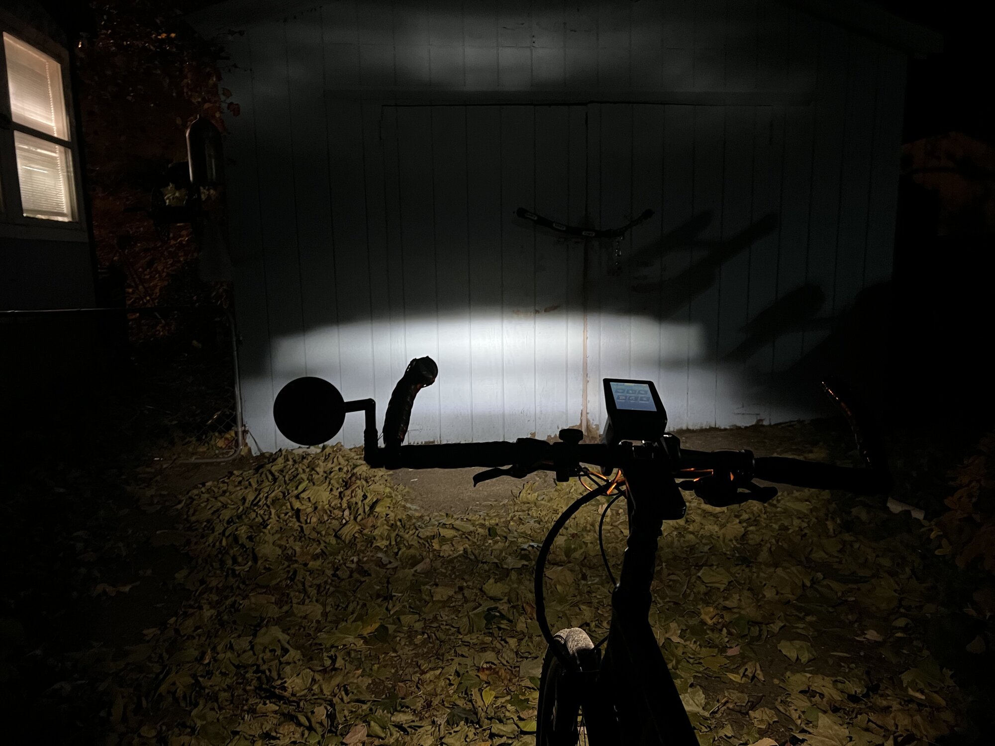

here is pics of the trek light high and low beams first time I could ride at 19mph in fill dark and feel
Is that spill several feet above the main beam from the light itself, or from the house or something else? That's one thing I'm trying to avoid: The Ion Elite has no cutoff, which renders it kind of useless and/or dangerous for approaching vehicles and pedestrians.
only a tiny bt and I have it aimed a bit up. but on regular beam hardly anything on high there is some so you have the distance.
