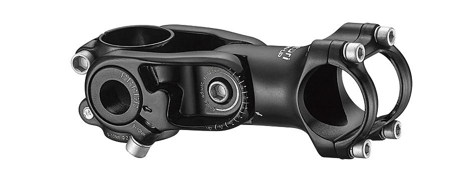

@MarciJo You have special handlebars and stem, IIRC. I assume they help with numbness ?
Thanks Art Deco,
Yes, I have been using the Sartori Turn-Up stem on all my bikes for many years. It has two adjustments and I am able to bring the handle bars significantly back and upward, so hardly any weight on my bad wrist. My situation is unique and most other cyclists don't require such a modification. The trick is to make sure there is enough cable length.
Most bike stores don't carry it but I have used either Amazon of good-old ebay.
Thanks Art Deco,
