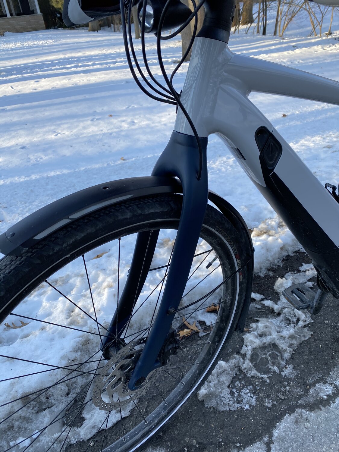

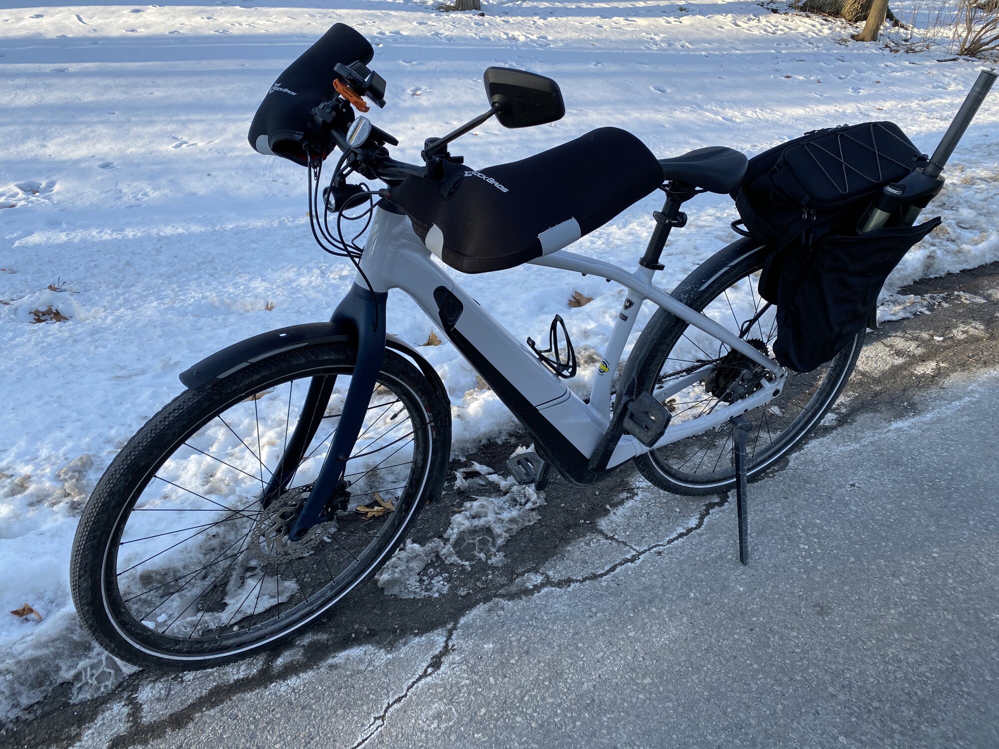

So I finally bit the bullet and did something about the front fork on my Vado. After some rather heated discussions with my LBS where they tried to convince me that I didn’t know how to adjust the fork they sourced a new fork for me. A rigid fork from a bike damaged during shipping which they sold to me for half price, $250. Everything fit as it should, cables, fenders and brakes. While I was at it I took 1/2” off each end of the bars. The bike has been transformed. The weight savings is substantial and the bike feels so light and easy to steer. I highly recommend this change for lightweight riders. There is no penalty from removing the suspension fork the ride is better without it probably due to better control. This is how the bike should have come from the factory. Lesson learned, a rigid fork is superior to a cheap suspension fork for the road or commuting. I have also purchased a Kinect seat post which I will be installing soon. If I can find a short reach suspension stem I will probably give that a try too.Let me know too, fanatic. I weigh the same as you and also find it too stiff at the lowest setting. Maybe it's a matter of installing softer springs if they're available? A full fork change could get expensive/difficult.
Looks really good!So I finally bit the bullet and did something about the front fork on my Vado. After some rather heated discussions with my LBS where they tried to convince me that I didn’t know how to adjust the fork they sourced a new fork for me. A rigid fork from a bike damaged during shipping which they sold to me for half price, $250. Everything fit as it should, cables, fenders and brakes. While I was at it I took 1/2” off each end of the bars. The bike has been transformed. The weight savings is substantial and the bike feels so light and easy to steer. I highly recommend this change for lightweight riders. There is no penalty from removing the suspension fork the ride is better without it probably due to better control. This is how the bike should have come from the factory. Lesson learned, a rigid fork is superior to a cheap suspension fork for the road or commuting. I have also purchased a Kinect seat post which I will be installing soon. If I can find a short reach suspension stem I will probably give that a try too.View attachment 78255View attachment 78256View attachment 78255View attachment 78256

Everything fit only the fork is new.What did the rigid fork come off of and what parts did you have to carry over? Same wheel assy?
They never told me what bike it came off of. I will contact them and ask. The fork is aluminum and I never got a chance to weigh it but I did lift it and it it was very light compared to the suspension fork. I would guess a 5-6 pound savings. The redshift suspension stem looks good but I am debating about the extra length. I’m not the tallest person (and getting shorter every year) and don’t want to lean further forward. I may give in and buy it anyway. The VadoSL has a very nice suspension stem but it will not fit the other Vados.@Cyklefanatic OP here from way back. This really intrigues me. What bike did the fork come off of? Is it carbon or aluminum or ??? I'm looking at getting a Redshift seatpost and would consider their stem as well with a rigid fork. I've never felt like the OEM fork was doing much good at all for my type of riding, which is now much less off-road than I had originally anticipated. I noted that the Vado SL comes with a rigid fork as well and it would be worth it on my Vado 4.0 just for the weight savings. Your bike certainly looks nice that way.

Same here. I'm going to look into it;Wow Cyclefanatic, that's really pretty! Matches perfectly with the white and black frame.

I got a chance to weigh the old fork, it’s 5.2 pounds. My guess is the rigid fork is about 1 pound so a 4 pound weight savings. Because the weight is on the fork and the fork is constantly being moved by the rider it is much more noticeable than saving weight on the frame. That light feeling when riding is what transforms the bike.Wow Cyclefanatic, that's really pretty! Matches perfectly with the white and black frame.
