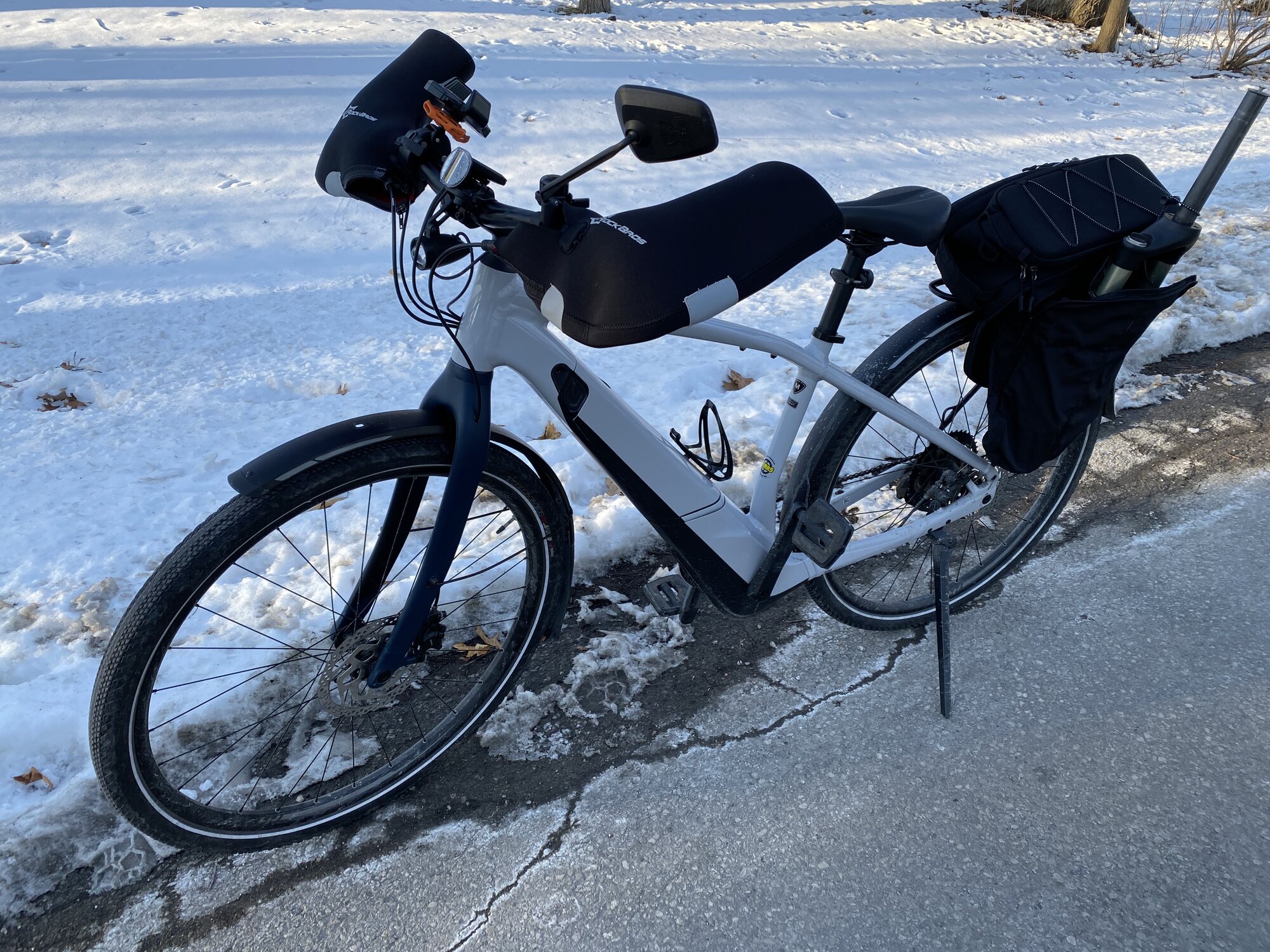

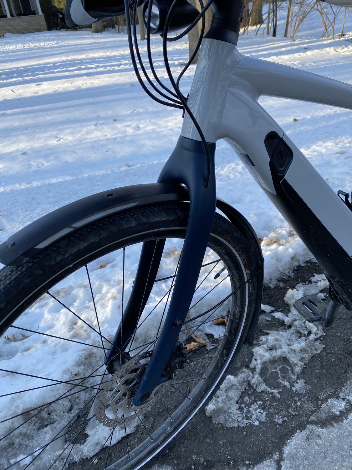

So I finally bit the bullet and did something about the front fork on my Vado. After some rather heated discussions with my LBS where they tried to convince me that I didn’t know how to adjust the fork they sourced a new fork for me. A rigid fork from a bike damaged during shipping which they sold to me for half price, $250. Everything fit as it should, cables, fenders and brakes. While I was at it I took 1/2” off each end of the bars. The bike has been transformed. The weight savings is substantial and the bike feels so light and easy to steer. I highly recommend this change for lightweight riders. There is no penalty from removing the suspension fork the ride is better without it probably due to better control. This is how the bike should have come from the factory. Lesson learned, a rigid fork is superior to a cheap suspension fork for the road or commuting. I have also purchased a Kinect seat post which I will be installing soon. If I can find a short reach suspension stem I will probably give that a try too.View attachment 78255View attachment 78256View attachment 78255View attachment 78256

Yes you can replace the front fork with an aluminum one from specialized. I did this on my Vado 4.0 and it transformed the bike. You can see a picture in this thread dated February 4 2021. Less weight and lighter steering feel. The Vado in Europe does not have a suspension fork so it is not an uncommon setup. If you weigh under 170 pounds the cheap fork that comes on the Vado is totally useless.

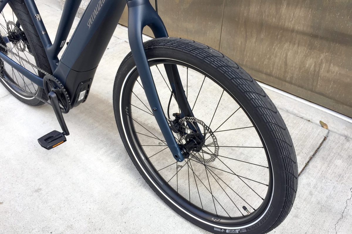

Could be this fork, Como...
  • specialized-turbo-como-2-0-rigid-alloy-fork-with-fender-bosses-1200x800-c-default.jpeg
