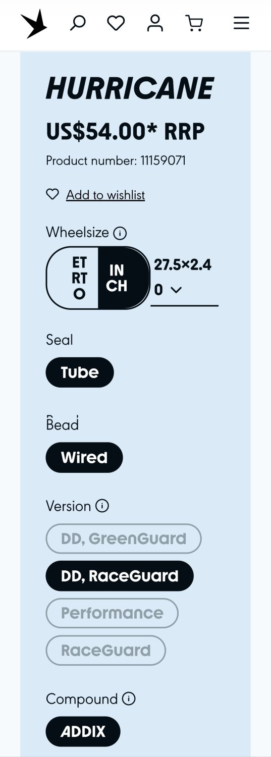

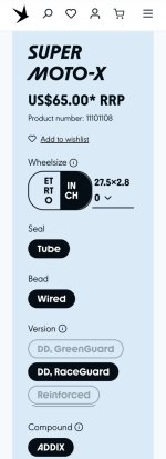

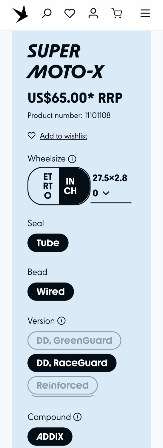

Schwalbe Hurricane, and Schwalbe Super Moto-X tires,..
All the tires were folded in half and the tire kinda turns into a figure 8. Then they folded that in half to sorta make two circles.
They didn't fold right up like a Kevlar bead.
The wire beads were bent/kinked in spots, so I bend them backwards a bit to straighten them out.
They were folded up and taped for shipping the same way that my Tannus inserts came in the mail.

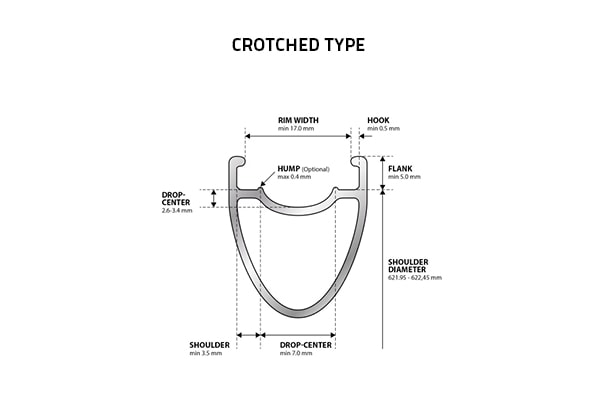

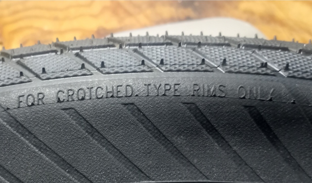

Pedaluma, I do not understand Crotched tires. Never seen one. What is the deal with that?
The rim cross section has a dedent in the middle.
You can pull the bead into it to give you room on the opposite side of the rim to pull the bead over the rim.
What is that “hump” in the tire. Looks like a partition of some kind
@PCeBiker knows. Those rims are tight and precise. Most pedal race bikes have them with carbon rims and $2,000 wheel sets. You push the tire edge bead into the center to give wiggle room to take it on or off. The center indent allows for this. You do one side, say the disc side first, flip and do the other. Pumping it will make it loudly pop as it locks the tire's bead in to the hook or crotch. The hump helps the bead stay to one side or the other as you work it. It is a channel.
