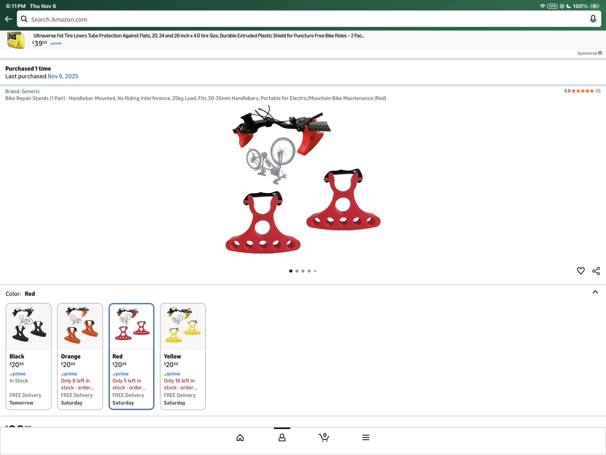

I decided to try these
You're looking to spend more on accessories than the bike! 🙃
Did you get the tires... and if so, are they on the bike?
I have the tires, tubes laying on an unused bedroom floor for about 3 days allowing them to straighten out. I will have to order about $1100 more to equal the bike. LOL You are hilarious. $20 might push me over the edge huh? 😁

Ok, I remove the mirrors, cellphone holder, drink holder and displays just easily pop off their mounts The handlebars have a 4” drop in the center so the display mounts will not be hit. Rotated the brake levers where they will not touch anything and then wrapped each end with thick buffing pads. When my wife gets home she is going to help me turn it on it’s back then starting later tonight or tomorrow I am going to start the tire and tube change and clean and lubricate the chain. Maybe I will find some of that Black Gold/Texas Tea in my back yard and cover the expenses 😁

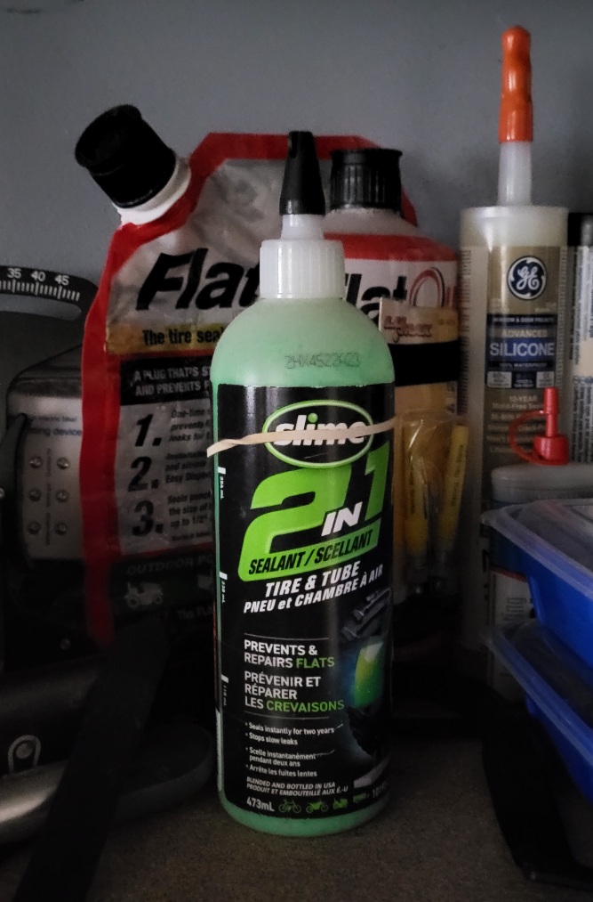

Speaking of flat tires,.. if you have a plan for if or when you get a flat, then flat protection isn't as important.
If you can get your ebike home somehow without having to fix the flat "in the field" then it's probably not worth spending hundreds of dollars on flat protection.
(but Flat-Out isn't too expensive, and it's easy enough use. A patch kit is cheap too.)
I bought some Slime I was going to use. So the consensus Flat Out is better? If so I can take the Slime back and get Flat Out.
Yeah, Flat-Out Sportsman Formula works better than Slime.
I didn't find that out until after I bought the Slime.
It's been sitting unopened on my shelf for almost 3 years,..

,.. When my wife gets home she is going to help me turn it on it’s back
Something I realized about my ebikes is that they aren't motorcycles, so you can lay them on their side without any issues.
There's no fluids that are going to spill out, (including the hydraulic brakes) so laying the bike on the floor then standing it upside-down from there can make it easier to invert the ebike.
You just need to watch your "touch points" on the floor to make sure they don't get damaged or scuffed up.
Another thing to keep in mind is to not squeeze the brake levers once the wheels are off.
That pushes the brake pads out and you'll have to push them back in to get your rotor back in the caliper.
Get the Sportsman Formula of Flat-Out.
It's meant for off-road vehicles and shouldn't be used on high speed road vehicles.
The high-speed Formula for cars, isn't the best choice for ebikes.

My favorite is Muck-Off innertube sealant. It forms polymer strings that then harden in a puncture.
From what I understand, Flat-Out and Muck-Off are very similar, and both have a polymer in it.
I remember reading that Flat-Out owns Muck-Off now, or vice versa.
Maybe Flat-Out's patent ran out and Muck-Off can now use it, or vice versa.
Something like that.
Ok, I am returning the slime and will get some Flat Out or Muck Off (will research the two and look at costs)
