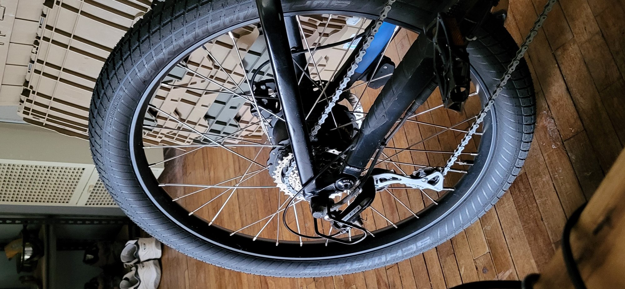

Also, knew there is nothing harmed by turning bike upside down.
I found the easiest way to invert my e-bike was to lay it down, then walk around to the other side, grab the wheels and "roll" it up onto the seat and handlebars.
I just had to watch that nothing got crunched while "rolling" it over.
A strap or bungee cord around the wheel and top tube really helps to get it upside-down without falling over.

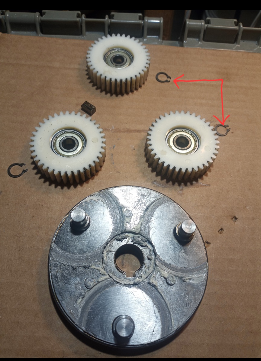

Sometimes when you drop a small part they can bounce and roll out of site in an instance, especially if they hit hard concrete.
I've done that so many times that I freeze as soon as I drop something and listen.
If I listen carefully I can usually tell which way and how far the part went.
It's the second and later bounces to listen for, so you can lock in on a direction. 😁
I used to quickly look towards where something fell, but I can find a tiny ball bearing easier by listening more than looking.
C-clips are the worst !!
They like to take off flying and land in another part of the house. 😁
I learned to get my pliers lined up in the clip then cover it with a rag to catch it before I squeeze the handles.
Then it falls outta the rag so I still need to keep listening. 😁

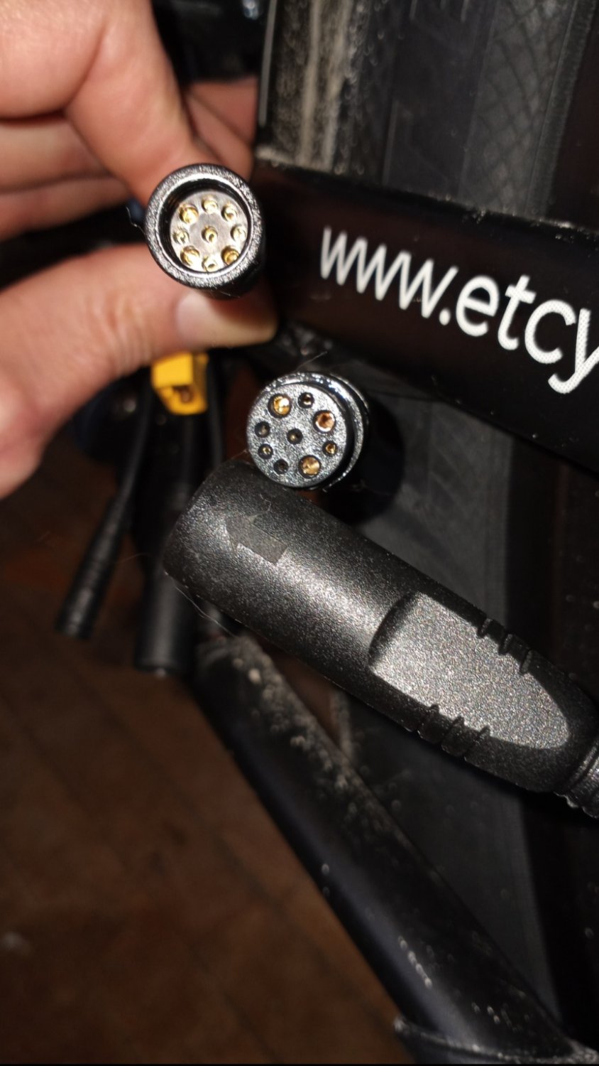

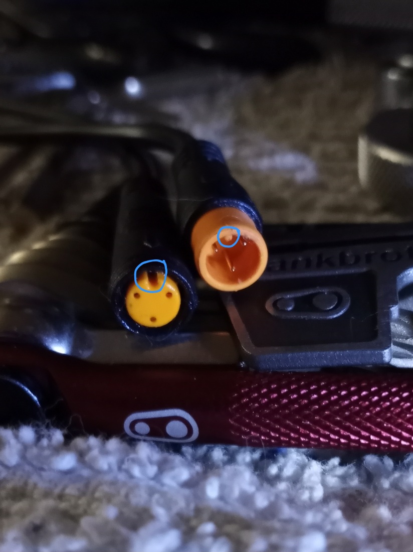

Another thing to consider is to pack your motor cable connector (and maybe all your connectors?) with dielectric grease when you reconnect it.
The stuff is messy, but you wipe it off the outside of the connector afterwards, and the connectors don't need to come apart too often.
The connectors can be difficult to get apart. Heating them up with a hairdryer helps.
They have arrows on them to show alignment, but they can be hard to see.

Yes, I had dielectric Grease at one time but been a while and have to check. Used it before working on a guy’s house with aluminum wiring (Aluminum is bad and outlawed since the early to min 1970’s) where connecting to short piece of copper wire to connect to outlet and have to pigtail the copper with the aluminum using a wire nut full of dielectric grease ( have to do this because of corrosion due to dissimilar metals). l used at work over the years at DFW International Airport in Electronics. BTW: Back in the 1990’s someone got the bright idea to install new power rails on the Airport Train system during expansion with Aluminum instead of the Steel originally used on the older parts. When they went to test the Phase Imbalance equipment that fed power it wasn’t adjusted right and to much current was pulled by the shorting bars when testing and the aluminum literally melted onto the guideway floor. The rails would sag in the hot Texas summer too. Also in a house with aluminum wiring normally if it were copper romex it would be stapled to a wall stud but with aluminum it expands and contracts with temperatures you cannot do that so it is just strung from one stud and hangs down crossing over to another stud. I used a stud finder and went to cut out a hole in the guy’s wall to add a wall light. I sawed into that aluminum romex. It was on a 20 amp breaker. If were copper it would have tripped but the aluminum just caught the romex covering and insulation in the wall on fire. I went out and manually tripped the breaker and used a fire extinguisher to put out the smoldering in the wall. I will not buy a house with that stuff in it.
No no no....
For aluminum and aluminum to copper connections you should have been using an Anti-Oxidant Compound/ Grease ... which is very different than dielectric grease as It actually improves current flow and dependant on application has micro bits of a conductive metal in it.
Additionally do not put dielectric grease on the bike connector conductors but a small amount on the plastic mating sleeves of the connectors which will increase their weather resistance but not interfere with current flow.
Right, 73 year old memory not soo good Gionnirocket. Been 1989-90 since last used. Thanks for the reminder. :)
