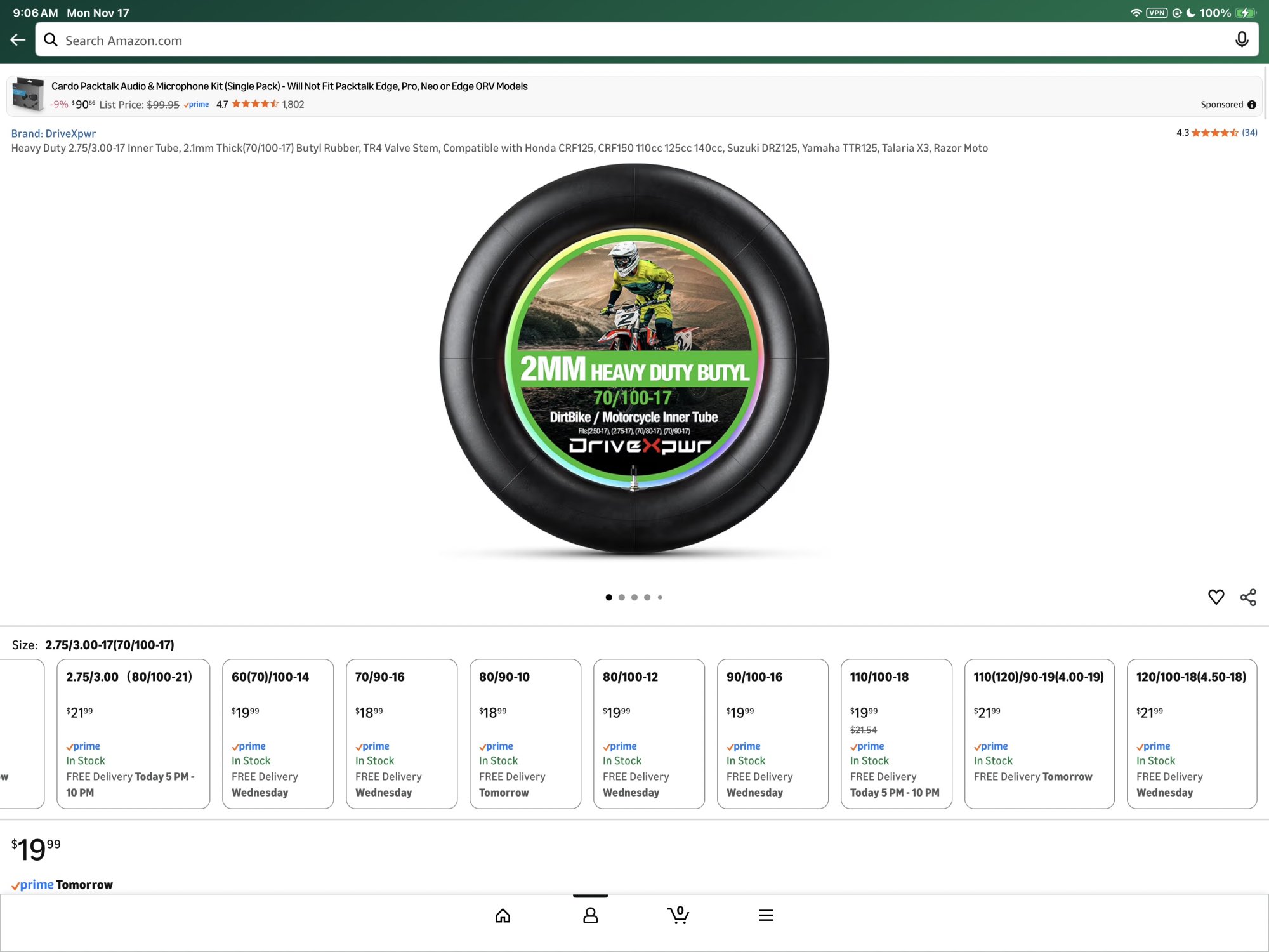

I do not understand these Tube sizings. Can anyone explain them to me please?
Amazing! Tire industry say’s“ Let’s see how many ways can we confuse the customer”. Many of us are simpletons, just put out one standard and stick by it.

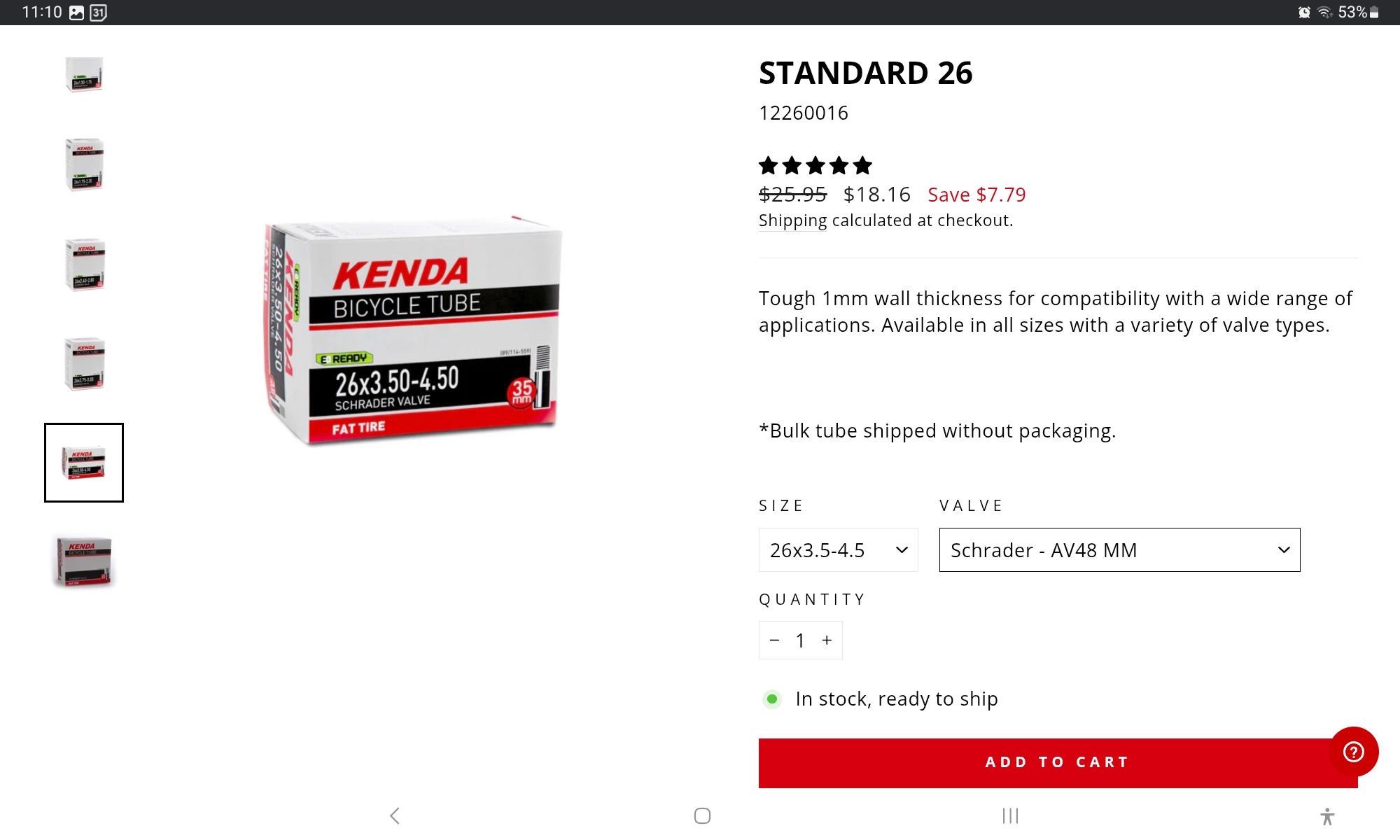

When I go to their site I find it but it will only allow me to select Presta 48mm valve. All the others are grayed out. Maybe they are just out of stock. Thank you for showing me this.
Yes if you click on my link it now states Sold Out. It was in stock this morning as I was curious and added it to my cart to see the total price.
Looks like a case of.. You snooze, you lose. But they are running a big sale + added coupons
Maybe call them and ask. Or perhaps they will back order for you.

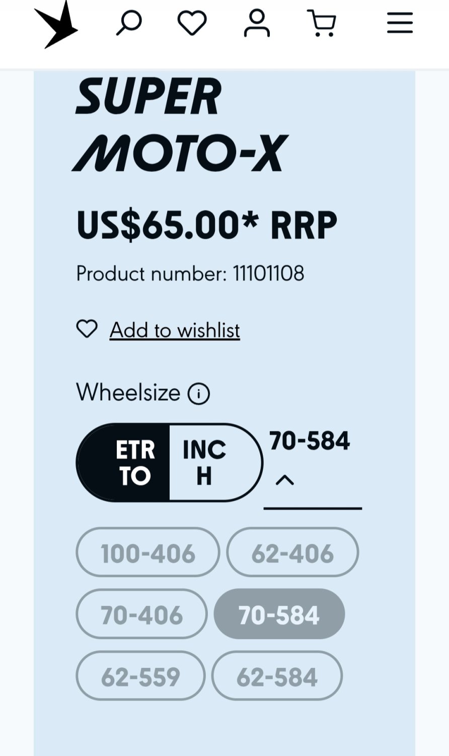

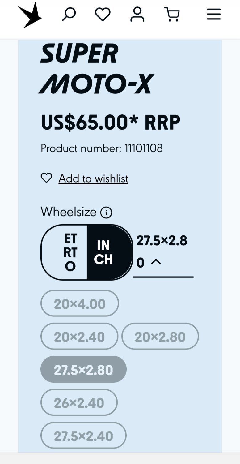

The Schwalbe website works pretty good, and will convert the sizing for you.
This is a link to my specific tires, but Schwalbe doesn't make a 26" X 4" tires. (They make a 20" version though.)
My tires shipped from England, and they had Euro sizing on them.
I used the Schwalbe converter to make sure that I had 27.5" tires.
