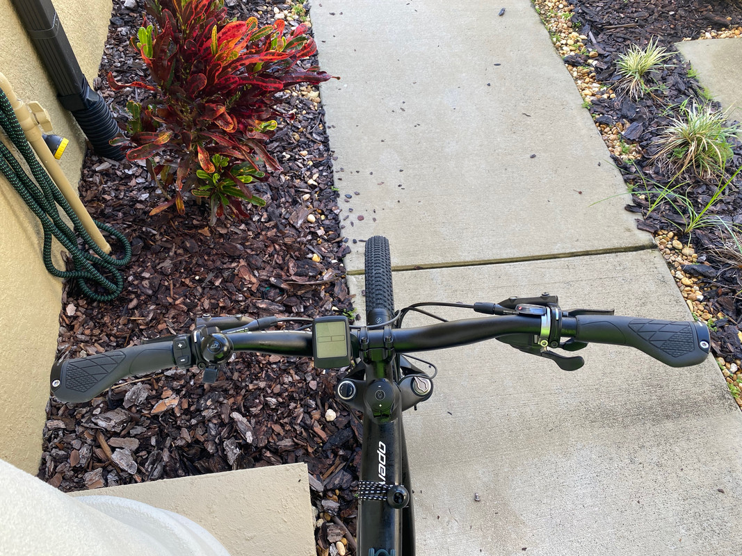

Recently I came across a suspension stem made by "Redshift" and ordered one with the 30° upright angle option. It arrived a few days ago and I installed it this morning. I have to say that I couldn't be happier with it, not only did it raise the bars to a more comfortable height it also does a wonderful job of soaking up some jarring road shock. Keep in mind the Como does not have a suspension fork as do most Vado models so this may be an unnecessary solution for raising the bars on a Vado.
