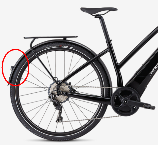

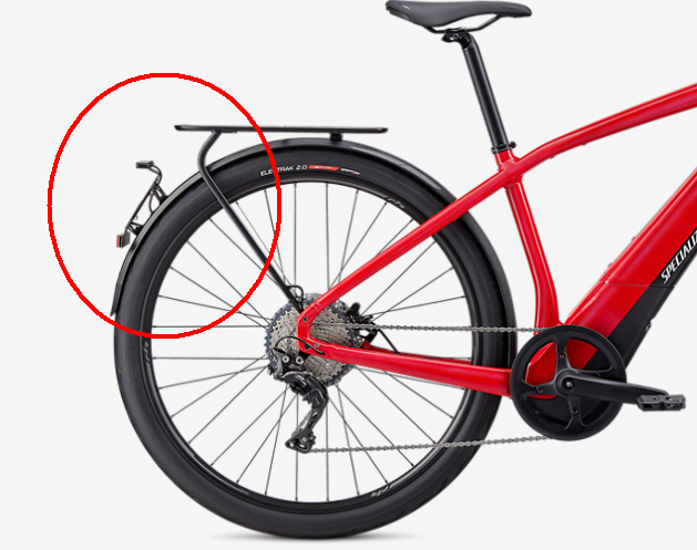

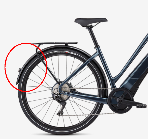

Even the 5.0 is available but I can bet the Como e-bikes sold in Poland are Class 1. What makes me think so?
Class 3 e-bikes sold in the EU are of the L1e-B class or simply they are electrical mopeds by law. One of the items required on the L1e-B is the registration plate mount. Now, see these three pictures for Turbo e-bikes available in Poland (the top models shown):
Turbo Como 5.0 PL (2019). No registration plate support. Class 1.
Turbo Vado 6.0 PL (2020). The registration plate mount exists. L1e-B (Class 3).
Turbo Vado 5.0 PL (2020). Class 1.

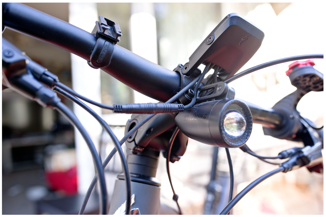

Yep, the stem mounted light has several issues. You've discovered another. I much prefer the current version with the light mounted to the fork crown. I changed my stem mounted light by adding an extension, see pic.0924191108a_Film1-1.jpg
The current version is only 205 lm compared to the 600 lm version I have got. If I had the current lamp, I would certainly mount my Cateye on the bar.
