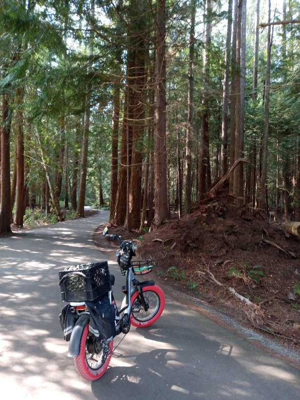

Wow - that paved ride through the woods is stunning, so jealous I can smell it from here. And the breakfast inside the last one looks pretty good too.
I like your comments because it reminds me of myself trying to stay in the bigger picture. In reality though:
0) You just got a flat.
1) The paved ride through the woods went as far as I could get the pavement into the shot. That's photography.
2) The breakfast cafe was closed when I took the shot. The cafe is up for sale. I rarely, if ever, eat in restaurants.
3) No need to be jealous, your riding range when done for pleasure uses, probably exceeds mine at the moment.
4) I got my flat in town and a new garage that I'm dealing with picked me and ebike up and drove us back to the garage.
5) My weight - 160 pounds
6) Both of my front and rear cargo spaces were loaded with boxes of medical gloves, probably about a case btw. the front rack and rear cube cargo areas.

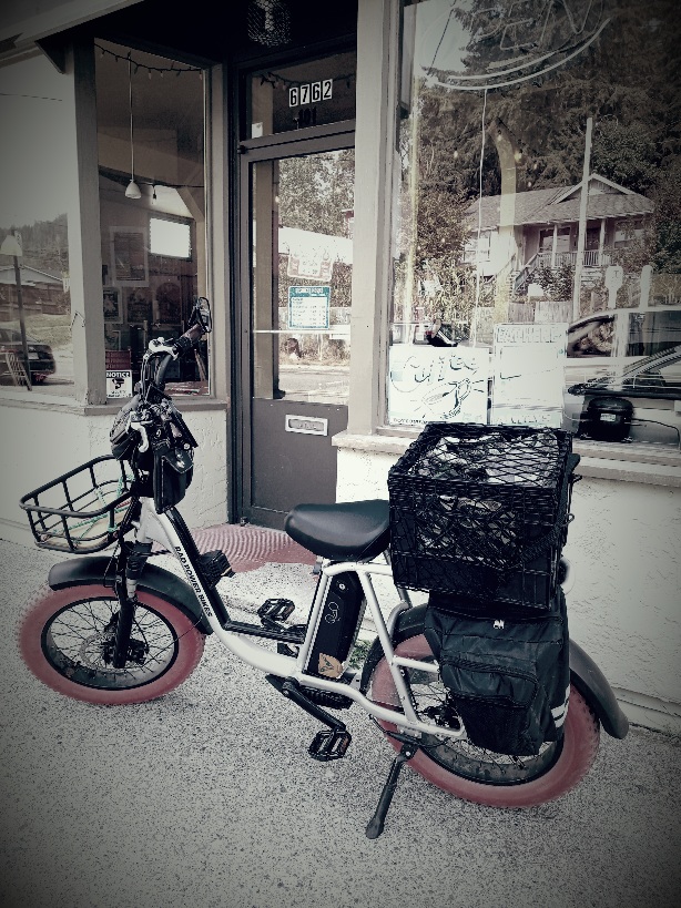

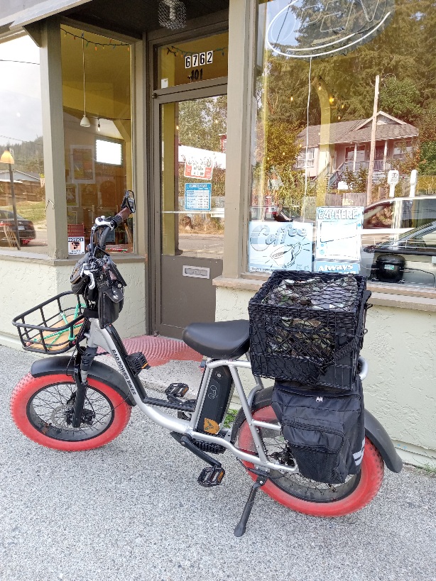

7) Most important: is it wishful thinking or just plain ignorance to mount cheap 20x4 tires on a 20xsomething rim?
whoa
Funny that Rad removed the exact rim size from the online specs - excuse me if I missed finding the correct rim information. I could swear that I read it there when I first purchased the bike almost a year ago The rim size is 3.34 or something? I'm kinda having my doubts at this point about popping a 20x4 tire on a less than rim.
The owners manual does not include specs.
Rad Power Bikes exclusive tire for the RadRunner Plus is a 20x3 - https://www.radpowerbikes.com/collections/replacement-parts/products/cst-big-boat-tire-20x3
However: RadRunner Plus Online Specs state:
Max Tire Width4"
Bike WeightTotal: 77 lb (34.9 kg)
Battery: 7.7 lb (3.5 kg)
Payload Capacity300 lb (136 kg)
I've spoken with various people who have mounted 20x4s on a slimmer than 4" rim and have made it work for them for their riding purpose.
Maybe a 20x4 just does not work for my needs on this bike. The cargo that I put this bike through likely needs the (god damn) proprietary 20x3s to keep the bead seated right while carrying cargo (duh).
The original 20x3s are now on the ebike. They are of course not knobbies but are gravel type of tires.
The tires sound like a wild cat.
