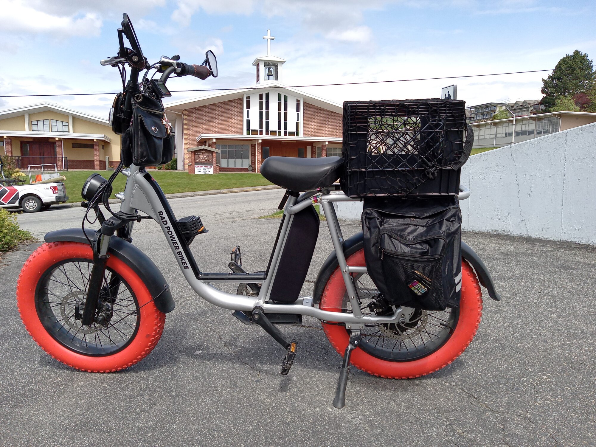

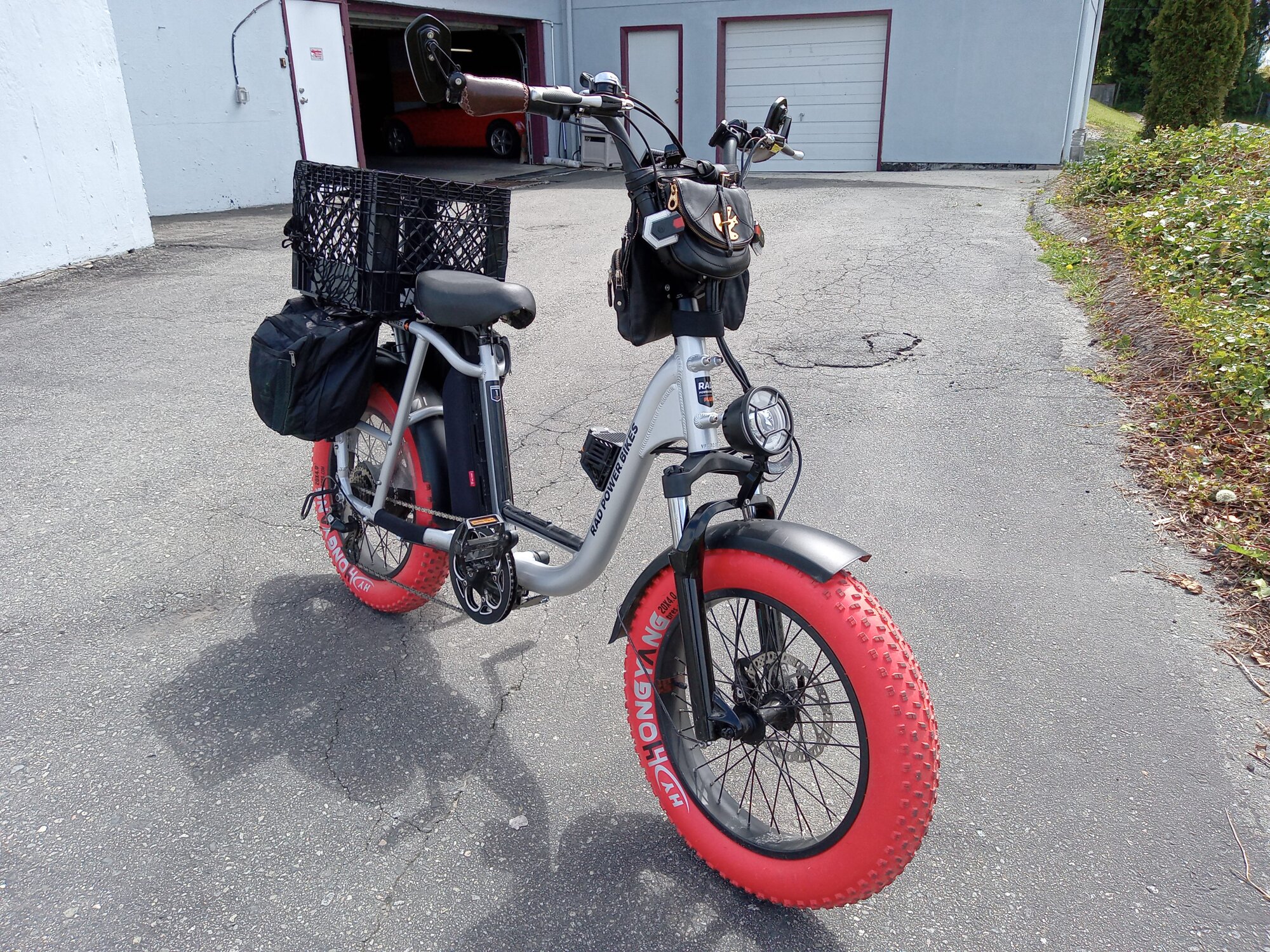

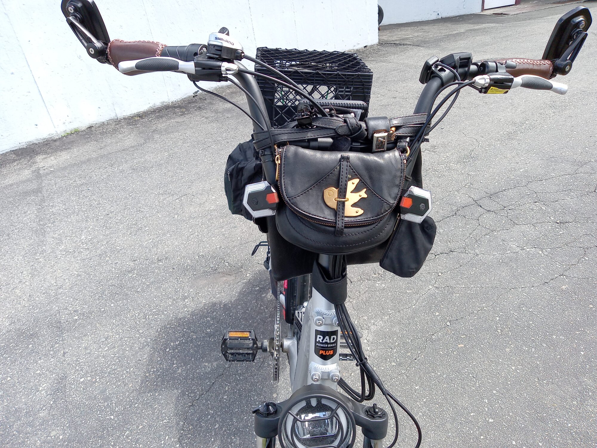

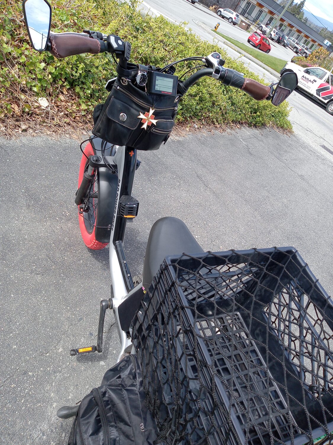

RadRunner Plus at stock today.
Security Includes: the pictured rollup lock, a UTook folding lock in a saddlebag, and a remote alarm system.

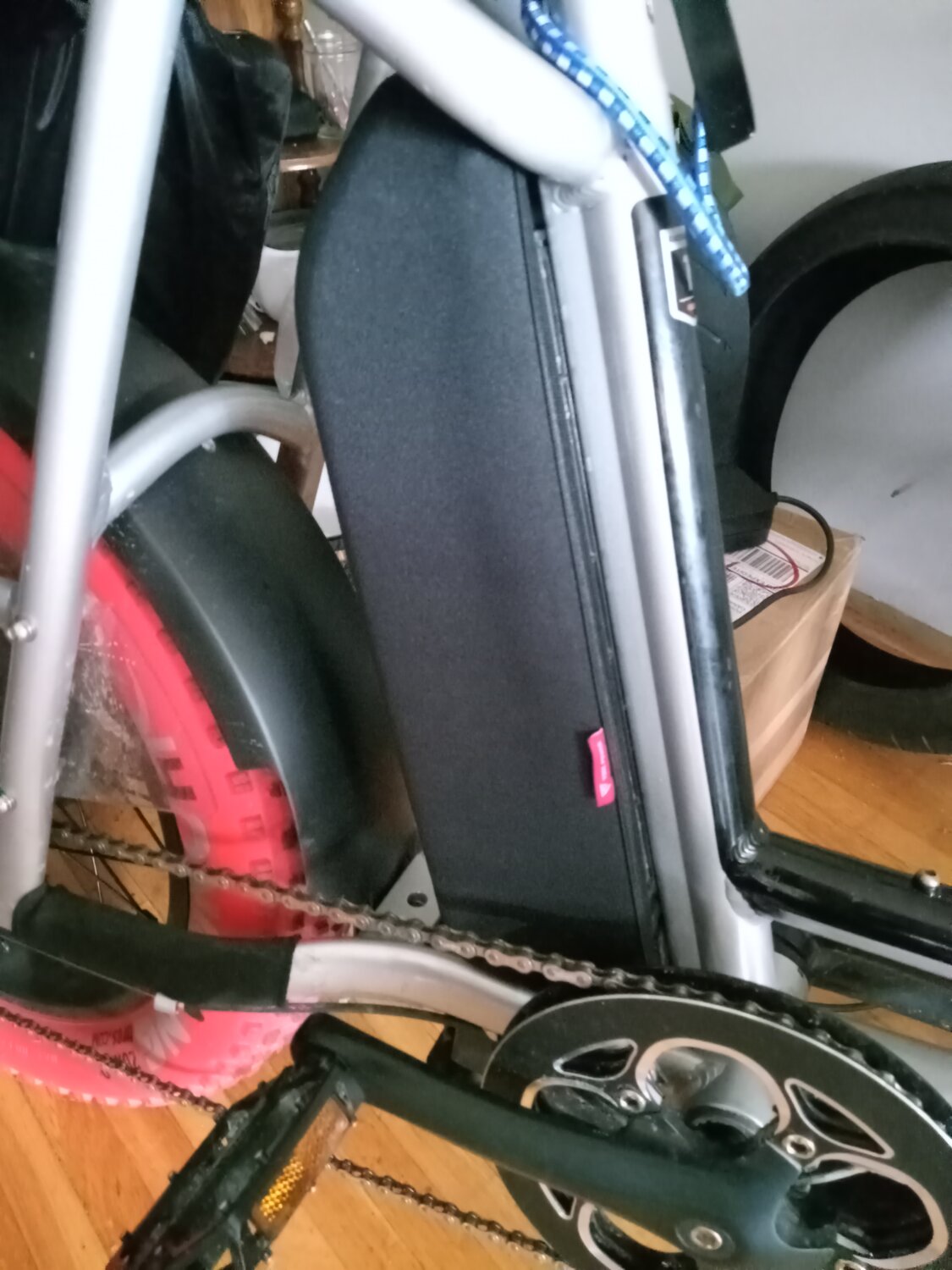

Also, I've recharged for hours and the battery bar display reading is still showing only three bars. I'm pretty certain that at 1:00AM after charging for seven hours the deed should be done. I'm concerned because, I touched my charging port socket on my battery with my key by mistake of course, and received a spark. I'm thinking that I may have fried the battery. I've just made more work for myself with one slip of the hand maybe. yikes.
🔌Battery not charging; Gonna try this:
I've removed the 5 amp fuse and will go and pick up another one tomorrow.
I bought the 5amp and inserted it into the battery with needle nose pliers.
Battery is now charging. YAY!
I will put tape on my battery charging site as a mindfulness reminder.
Update: July 12, 2022. It happened again - the battery just died without me doing a thing. Died going up a steep hill. Ouch. Had to quickly cut into a driveway for a level surface. I installed another 5amp fuse. Works. New fuses, a small knife to pry out fuse cover, and needle nose pliers have been added to saddlebag.
Update: Many days later . . . the battery wants to shut off on this one specific hill - she's a steep one - every time. I instead of assuming that it is the fuse, I removed the battery and then reinstalled it. Works. This happens sometimes now with this battery since the Rad Power Upgrade. I don't think that has anything to do with the hardware that was installed, but I may be wrong. I think that it has something to do with the battery mount.
