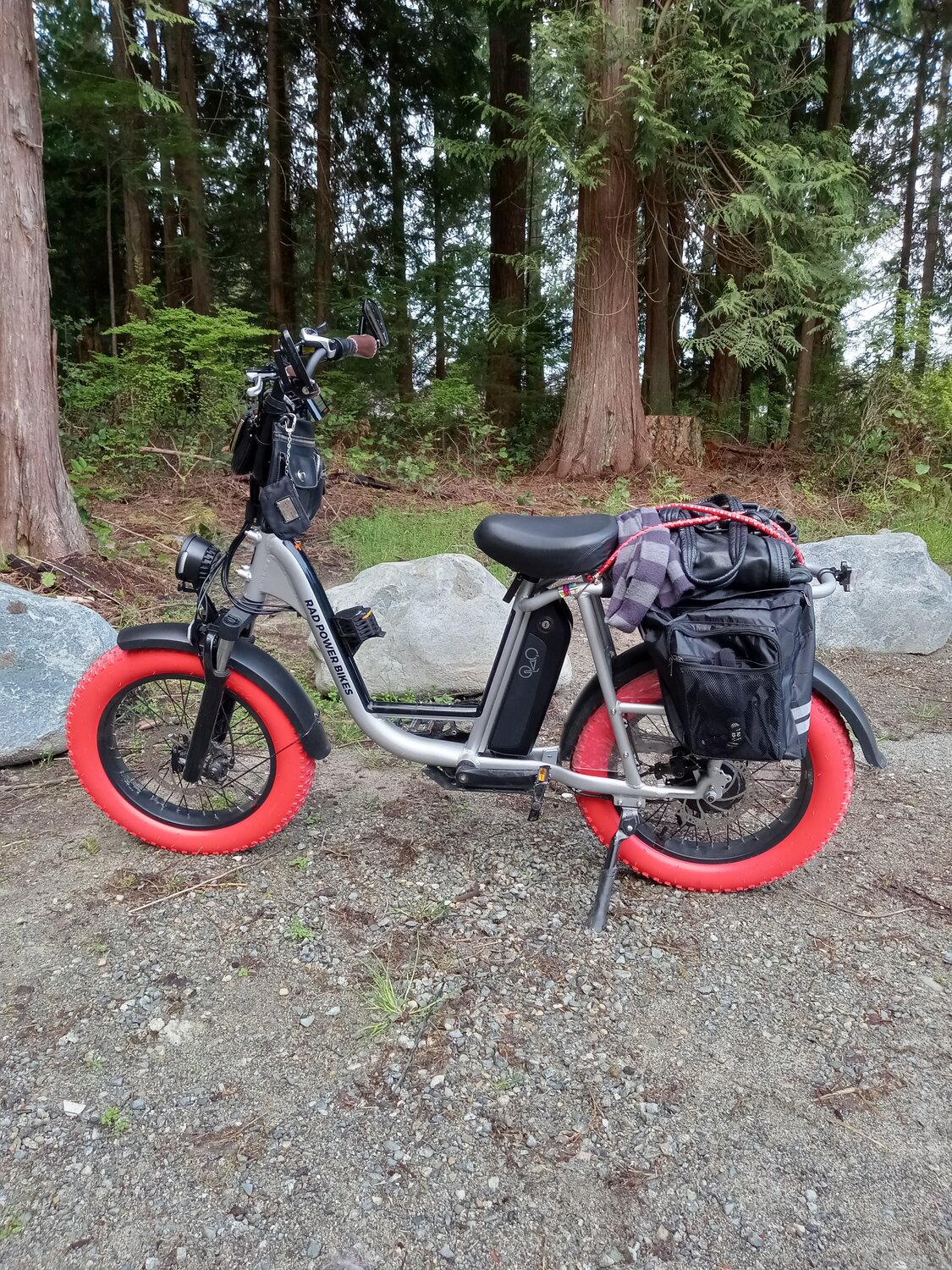

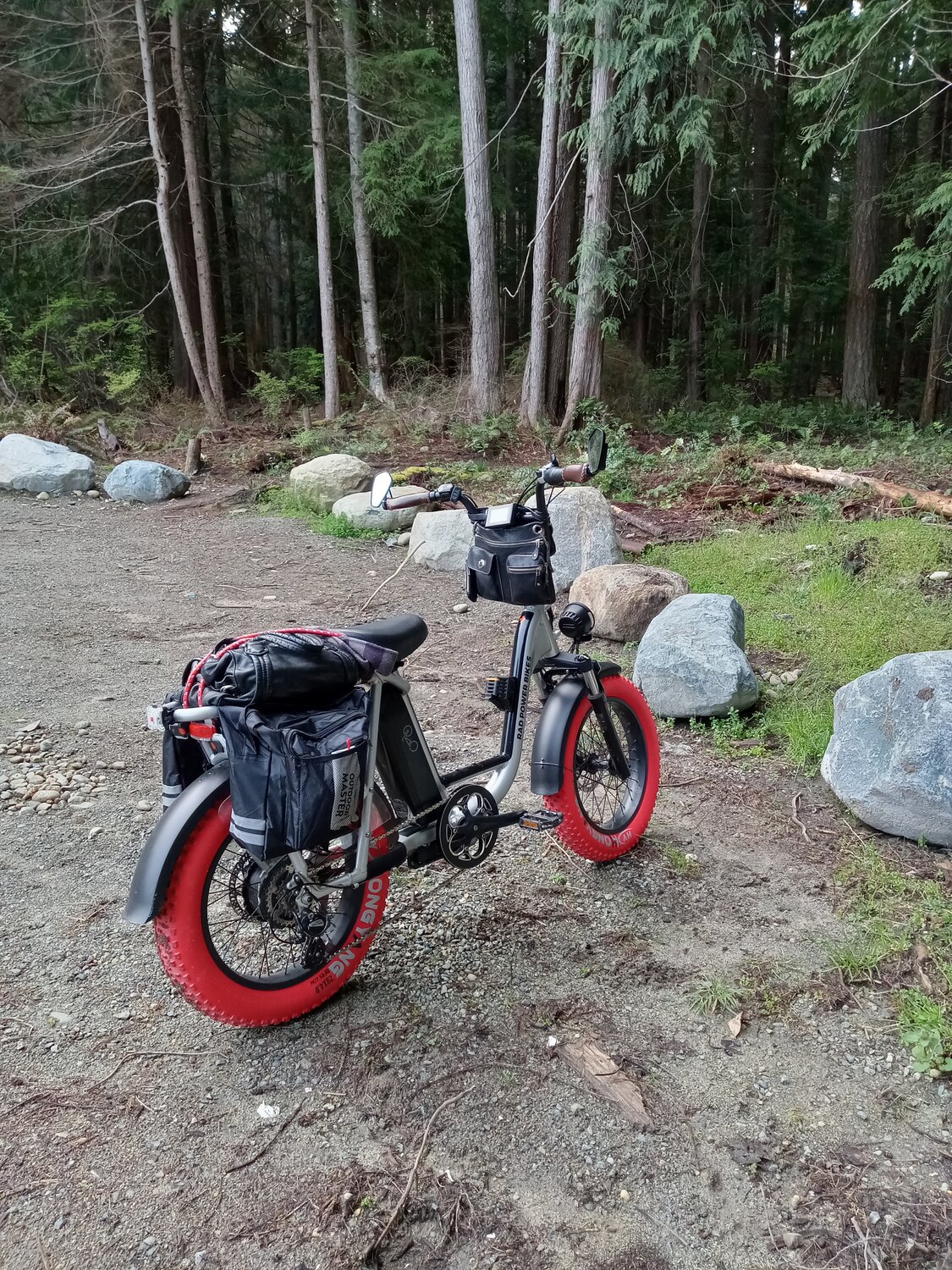

I purchased my RadRunner Plus in September 2021
I am using this thread to record my experience with the company and the bike
Main use: gas vehicle replacement, but my not only ebike in my fleet.
My height: 5'1" - height specific gear I wear when riding:
Footwear:
TERRAIN
Pacific Northwest. Coastal. Hills.
Coastal Storms = lots of roadside debris/roadside furniture
Wet = Streets slippery with wet leaves. Large protruding trail roots.
Bike Lanes = rare
Pole lines, Trails, Offroad = expect extra large puddles and washouts
Carry the right gear to manage situations

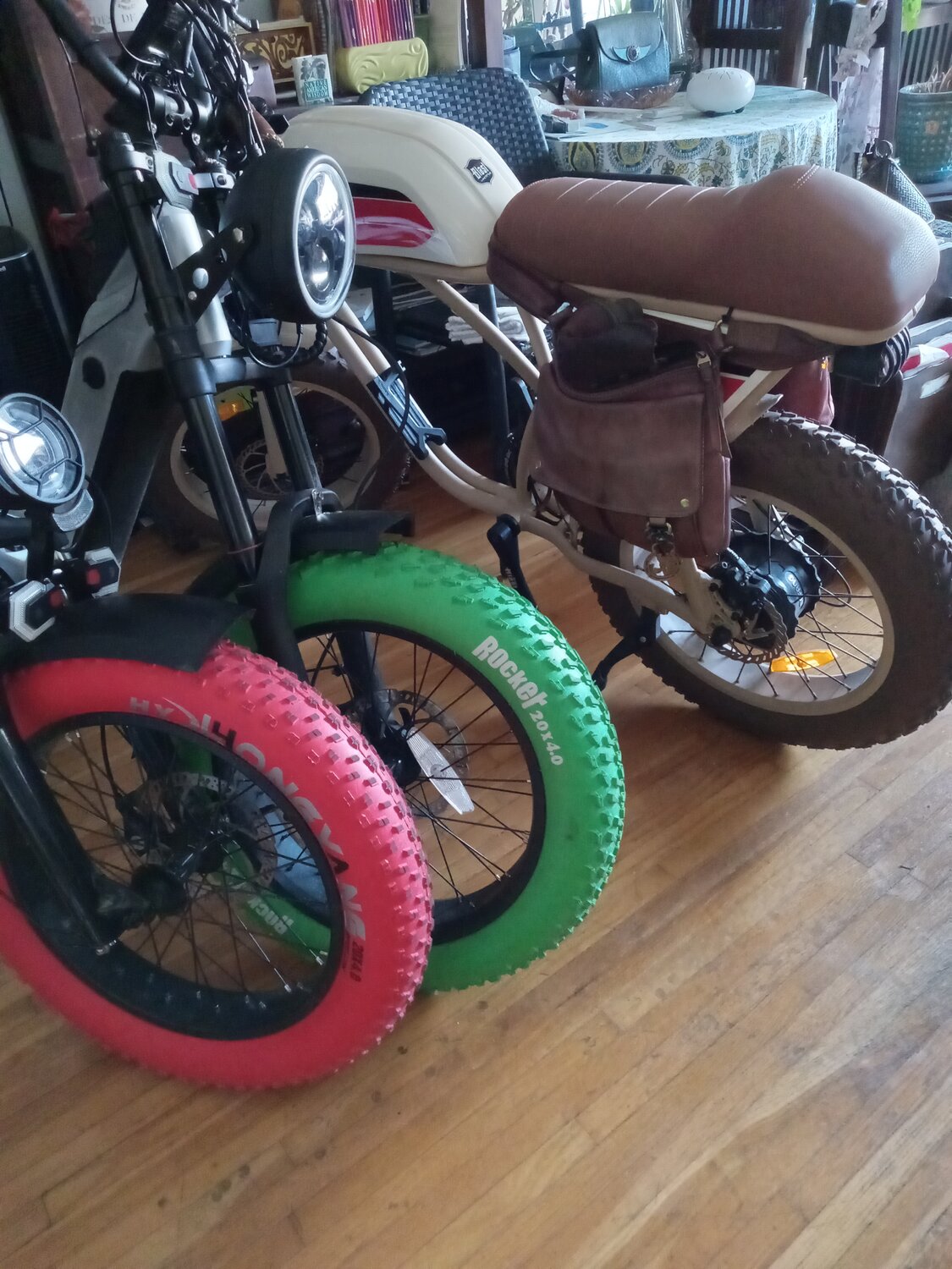

The little fleet plus an Apollo City scooter

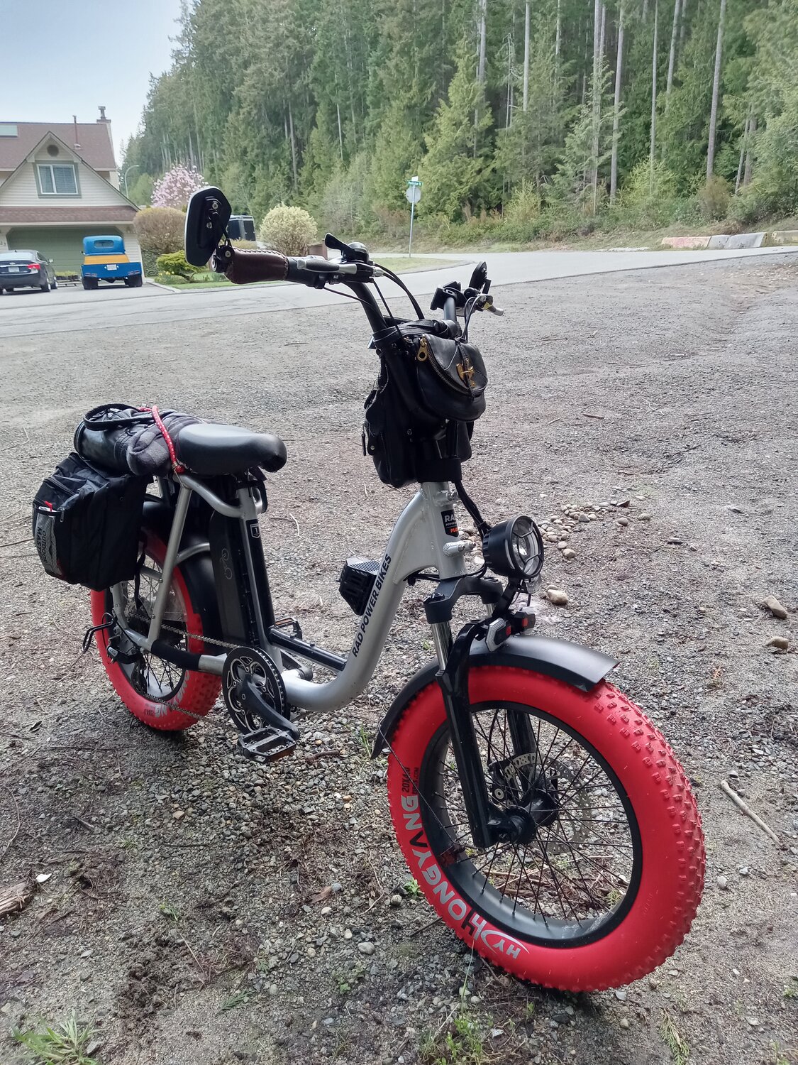

My next mod will be to make this bike more user friendly for my area as it is gutless on hills, and hills is what my area is all about.
I have a number of accessories coming in the mail. I've got a bike trailer coming and I am concerned that this bike won't be able to handle what I need to put it through for towing purposes on hills. My Rize Liberty (1000w, dual battery) will likely have to do the heavy lifting until this bike gets modded out for that work.
I know you said you're gonna focus on small things, but have you ever heard of Bolton (now called Area 13) kit?
They sell controller, display and motor.
As you can see, the stock motor has pretty small stator, and it's fairly easy to swap.
Display & Controller
Motor
(you can swap the internal, so you would not have to re-lace the motor)
Also 52V battery swap can be done too.
I've edited my post about not being ready for suggestions.
I was thinking that I would let the warranty run out before upgrading motor. etc.
But man this thing needs upgrading to give it some power on hills. It's great on flat ground, but . . .

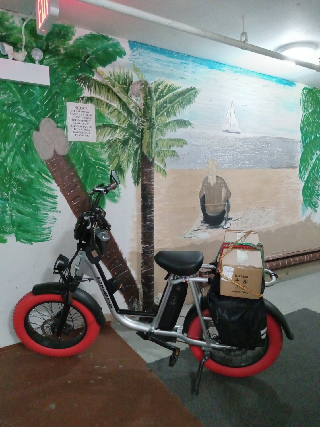

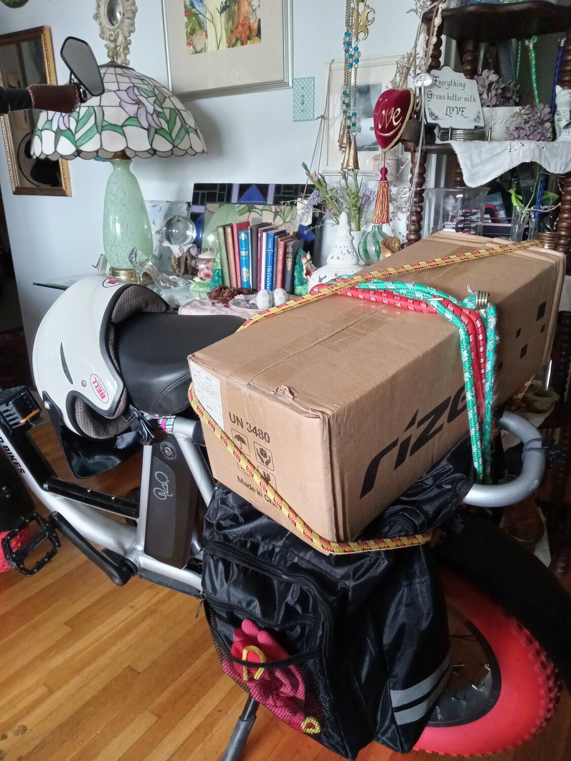

Rad doing some lifting for the Rize upgrade.

How big are the hills? Just curious. I'm in the east but we have some doozers and I've never had an issue whatsoever.
Speaking of the island - do you know Ryan Road, heading up to the ferry in Courtenay?
My hills are like that and steeper, but shorter. The community is terraced with three levels of inclines.
There are three main drags. The lower one closest to the ocean, the middle level main, and then an upper level main street.
So, I am constantly zigzagging with this 500w motor.
The RadRunner Plus at stock does not do well here. This power deficet makes for a short day and not getting everything done. My Rize Liberty with the 1000w motor and 52v battery can charge straight up the hills. I also don't trust the Rad's brakes - the cable keeps detaching. I will eventually upgrade to hydraulic but I will wait until the power upgrade is done with breathing room till the next upgrade.
There are two monster hills in town (double clutching) that I haven't tried with the Liberty yet.
With the Rad sitting at stock, I have to zigzag my way up btw terrace levels going along side roads to avoid straight up hills.
At zigzag points going up hill a short distance to get to the next level of side streets, the Rad does scoot, but it struggles after a minute or so.

The handling on big hills is a bit strange. I'm in the east now and we have some hills like that but I've never had any problem going up them in PAS 5 and pedaling. Or seen much battery drain either. Maybe it's there but I've just never noticed it. I'll have to do a run this weekend and pay closer attention. And I'll check the incline and distance and compare it to Ryan.
I tweak my brakes every couple weeks with the alan key to keep them tuned. So say maybe every 500k or so. But other than a little slippage in the setting every now and then I haven't had any issues and I've put a lot of kms on.
Definitely not the same experience with my RadRunner Plus. I'm on the throttle more than yourself. That is what I like about e-mopeds - the throttle. If I wanted to peddle I wouldn't be riding this kind of ebike. The Ryan Rd. grade of incline is common in my area and steeper. Climbing these hills on throttle is not for this bike at stock. Your mileage may vary for good reasons.
