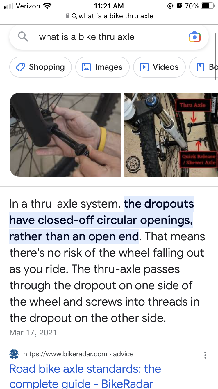

Apologies for the newbie question, but what exactly is a thru-axle and (more importantly), how do you know whether your front wheel has one? I know that my bike does because it’s in the product description, but that’s the only way I know. What I am wondering is whether my kids’ hand-me-down bikes have them. (Their bikes are 20 years old and I no longer know what models they are).
I’d think that “thru-axle” just literally means “a rod that goes through the axle.” But every bike has that, don’t they? (In the sense that there has to be a rod that goes through the front wheel’s axle and is secured by the quick release lever on one side and a nut on the other side or by a nut on both sides.) So I assume a “thru-axle” design refers to something more specific. Either that, or not every bike has such a rod; but then I can’t envision how the front wheel would be connected to the fork.
EDIT: disregard - the Google machine explained the answer. Figured I’d still leave this post up in case other newbies have similar questions in future.
usually it means a hollow rod that threads into one side. though they can have a quick release too but usually you dont have loose parts and springs like you do with a quick release. they tend to be 10 to 12mm
To amplify a bit on the response @fooferdoggie and Google gave you, a thru axle integrates the attachment mech directly into the frame and fork, so there is no chance of something coming loose and falling off, and VERY little chance of the axle coming completely loose as there are a lot of threads holding it in. Only the most brain-dead rider will not notice in time to fix, and the axle can be quite loose and still be perfectly functional. Because of the difference in mechanism between a thru axle and QR, you don't need much torque at all for a thru axle. 5 to 7.5Nm is the specification for my Bullitt's dropouts which is almost nothing... 3.7 to 5.5 ft lbs which are units of measure so small only a small size bicycle torque wrench can even be set to them.
